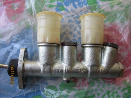

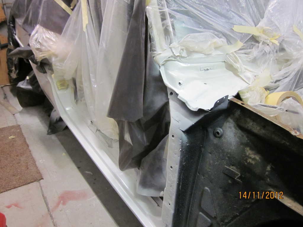

moving along, all the brake parts arrived and look good.
All but the bootlid top now painted.

Glen . What's master cylinder off . Gricey
Thu Nov 15, 2012 5:56 am
master is the late Bellett type. Not sure when they came in, maybe 1969 or 70. Thats why the later models have the cutaway in the towers, to take the longer dual master
I simply got it sleeved and fitted all the new parts in it, that came with the car. Even the rubbers between the resevoir and master were there. P/N 9-09720559-0

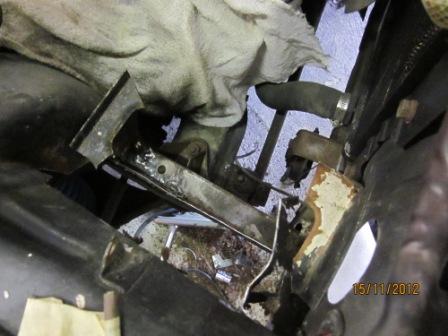

Battery box area is now fixed also. Turned out that it was a bit more extensive than first thought and had to remove metal and replace right up to top of wheel arch area. Must have been a very leaky/fumy battery that was in the car at some stage. Now has a sealed type. Will stoneguard the wheel arches next then only the brakes to re-fit.

Thanks Matt, I'm really only doing what has to be done imediately although once you start to remove things, something else pops up that has to be done or at least easier while it's apart. The end result will be a hopefully tidy Sport but not 'restored' in the true sense. Not a show winner that's for sure !
The battery area alone consumed almost 4 days. The rail area around the bolt holding the suspension was er... not there ! I cut the whiole side out of the area and fitted 1/16" plate inside and around that area. Very difficult to do with the engine in the car, not to mention care needed when welding ! As it turned out, i then had to replace more metal right up to the top of the inner guard which was mighty 'thin'. :(

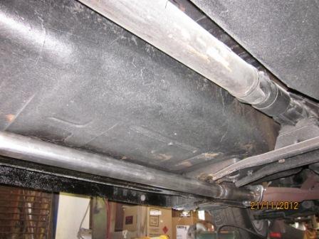

Centre exhaust pipe fitted, started the engine, but it's leaking at the rear so need to look at that a bit closer. I fitted a 2 bolt flange at the front to make it easier to fit and remove. No leaks there.

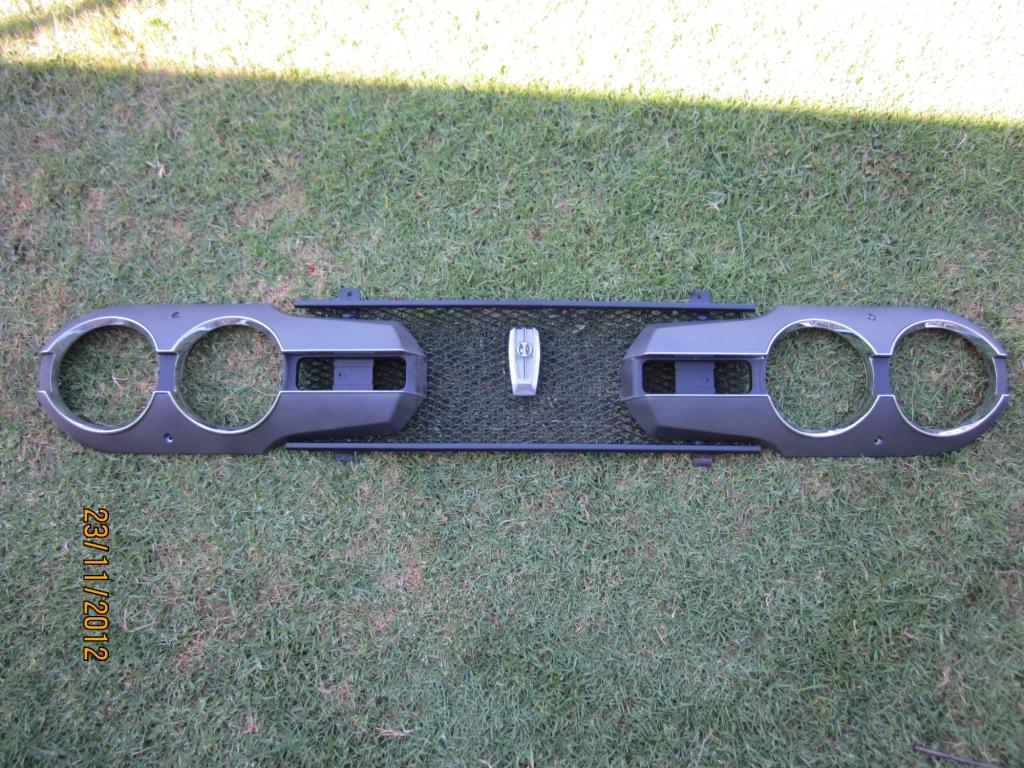

here's is the grille with re-painted centre section. I actually prefer the late 68 style grille but I guess I should keep it original !
The 'SPORT' badge fits in the left side opening. The other side is blank i think as std. ie has a blanking plate in the opening.

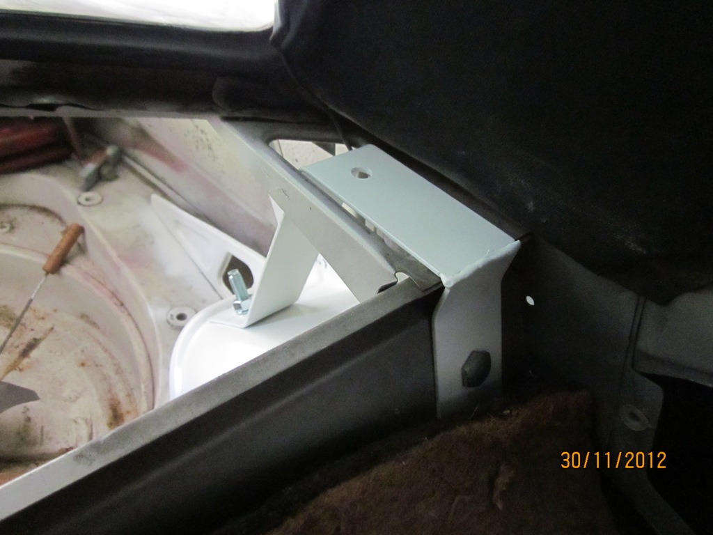

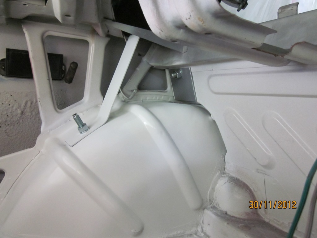

Biggest hassle is the rear seat belt mounts. Upper. After discussion with eng. my idea to fit a strap back into the wheel wheel was OK'd. (subject to actually seeeing it!) It's more or less an upside down 'U' shape piece of 50mm strap, bolted to the wheel well and back of the seat area. Backed with plates.
So, 2 days of friggin about and it's done. Mounts anyway. Like before, one thing leads to another. I wasn't too happy with the all the red :?: paint overspray in there so decided to rub down and paint the inner wheel arches also. Takes time. I had front belts from Hotrod project and can't find the stalk for one of them :(

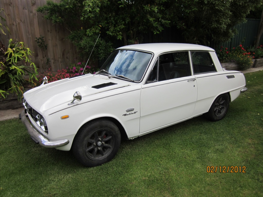

anyway, started her up and drove her out of the shed for the first time under her own power for a few pictures but mainly to sweep out the shed, which is getting pretty grotty with sanding dust, rusty crap out of the sills etc.
One problem though is the RH door restrainer. :( It does not work. Must be something wrong inside the door. ANYBODY got any ideas on this ?

Looking for more pictures Glenn, you're work is amazing, car looks great!! :o
How about some pictures of your engineering with the seats belts mounted? You certainly did well with those mounts.

Hi Dave
I will take a pic of the fitting later.....but i drilled clearance holes in the plastic parcel shelf insert then the belt ends bolts though them into the plate. I need to find a better insert though as this one has huge holes cut in it for aftermarket speakers.
