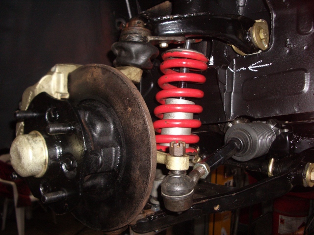

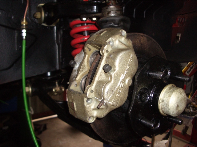

Got the brakes on now, the original GT calipers are Dunlop and are only single pot, but more importantly very difficult to rebuild, and by sheer luck we found some twin pot jobs with the same PCD as the Dunlops (which we will still rebuild at a later date, to get the FIA papers) The brakes are free at Goodwood incidently......I do like good brakes and I think these bad boys will stop Rolie PDQ.
Sorry these pics have come out a little dark.
The shocks, by the way, are duel adjustables fron an old Alfa race car

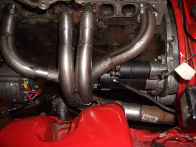

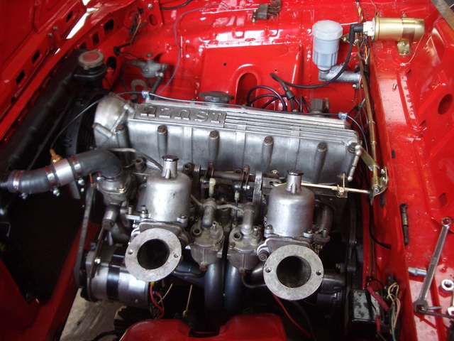

The exhaust manifold is now looking very racey.

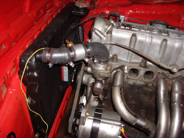

And the cooling system is up and running. And believe it or not......good brake pedal at the first time of asking.

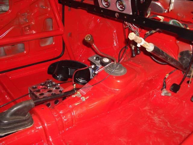

The cabin's coming along too.
You can see the battery and the brake bias bar on the other side of the handbrake and also the original binnacle, yet to be fitted, with a new rev counter but original speedo. The colour looks a little weird because of the flash on my toy camera :roll:

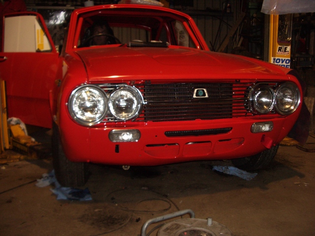

Welcome to the forum Gary. Here's a pic, of the first time your old car has touched down on British soil in his new guise.........believe or not this was a thrilling time for us all here.
It may not be obvious from the photo, but we were all pretty pleased to see how he sat, although we do think he may be a little over springed at the front....we'll see at Goodwood on the 10th.
