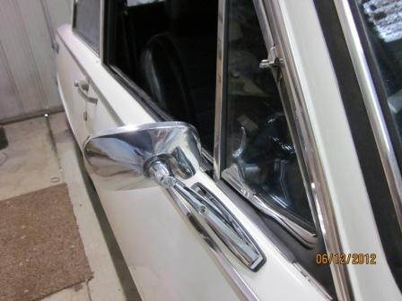

Engineered: picture says it all really. [ trying to find a mirror was a big problem ]

Good one Glenn, did you have to fit mirrors to both sides? and besides seat belts? how did you go with tail and front parking lights? what else?
Geoff
Fri Dec 07, 2012 7:26 am
Geoff
Just the RH mirror. He was concerned about rear tyre to guard clearance until I convinced him that it IRS.
