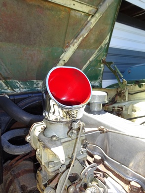

Donkey's is the early Nikki (and doesn't use an air cleaner :twisted: )
Mon Aug 24, 2015 7:32 am
Yeah same size neck as a Stromo.....
Nikki jets are interchangeable tho. U could always just bang some bigger ones in out of a Gemini or Datto.
