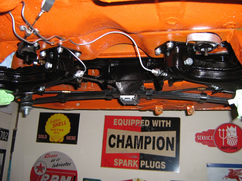

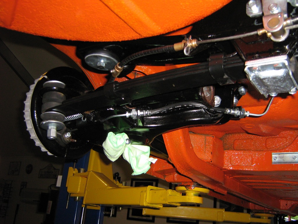

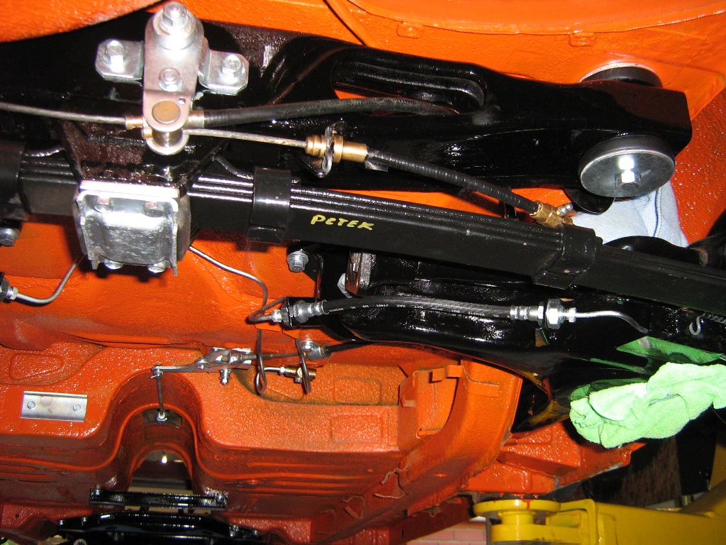

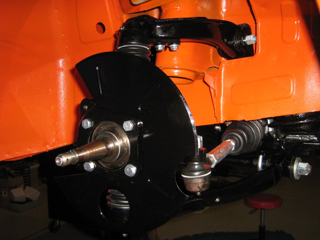

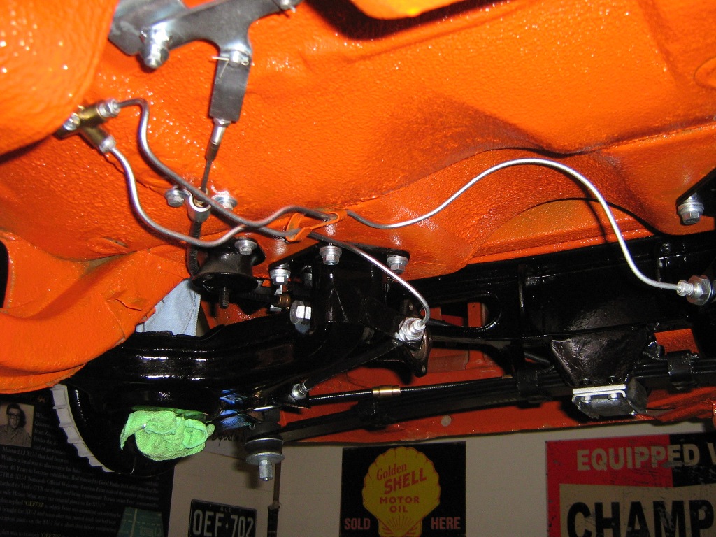

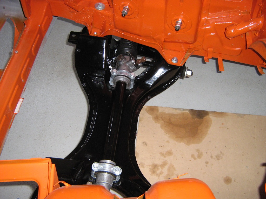

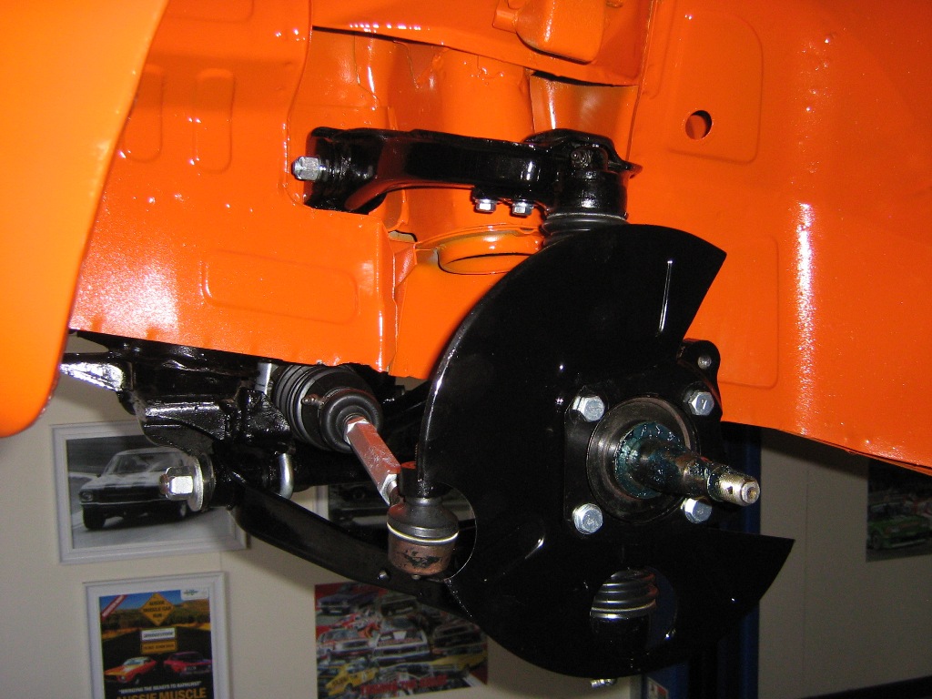

An update on the PR90. Rear suspension is almost complete, new rear leaf has been manufactured and installed, re-zincing of brake lines and new hoses also have been installed. The company who made the front and rear brake hoses actually had the details of the brake components for a PR90 on file along with pictures and a service list for each item so we were able to go through the wheel cylinders, front callipers and master cylinder to check availability of parts, they have everything needed to do rebuilds so I will be dropping those items off shortly. I know Dave had all these items refurbished years ago but sitting around it is feared they have just rusted up so we will not know until we dismantle and better to be safe than sorry.
I have ordered new coil springs from Lovells for both the front and rear. They will be married up to Koni shockers. The specs for the leaf and the rest of the suspension components were given to me by a very knowledgeable member of this forum and I thank him for all the help he has given me with this.
I have installed the refurbished bushes into the upper and lower control arms. The top ones are easy to push out and get back in but I had to make a spacer tool for the bottom arms to fit them back in. They are very similar in removal and installation process to the holden torana arms which I have had some experience with but it is not something I would recommend for the novice to have a go at as you could quite easily bend the lower arms. The front suspension is now mostly in the car except for hubs, shocks and coil springs.
Once this is complete We will be sending out the differential and gearbox for new bearings and seals and some items for re-chroming. I have had windscreen seals made that fit the original stainless strip but unfortunately they were made too long and will go back to the manufactured to have 45 - 50 mm taken out of the length and then re-joined.
Once I have completed all of the above then it will be off to the trimmers, so we are progressing.
Peter

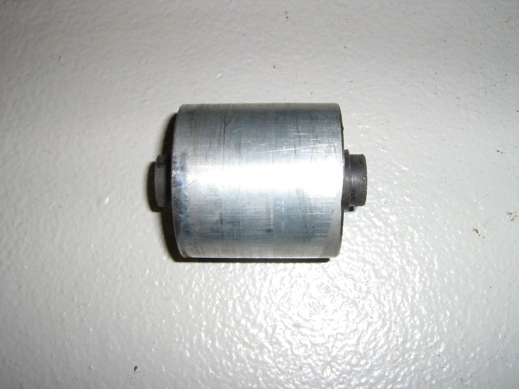

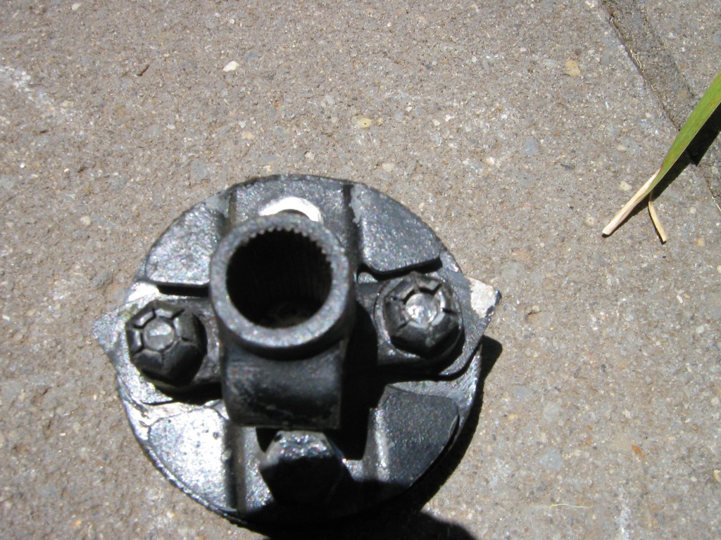

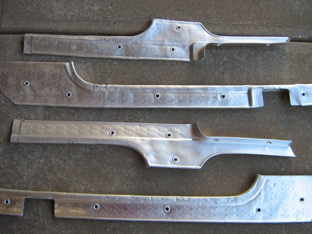

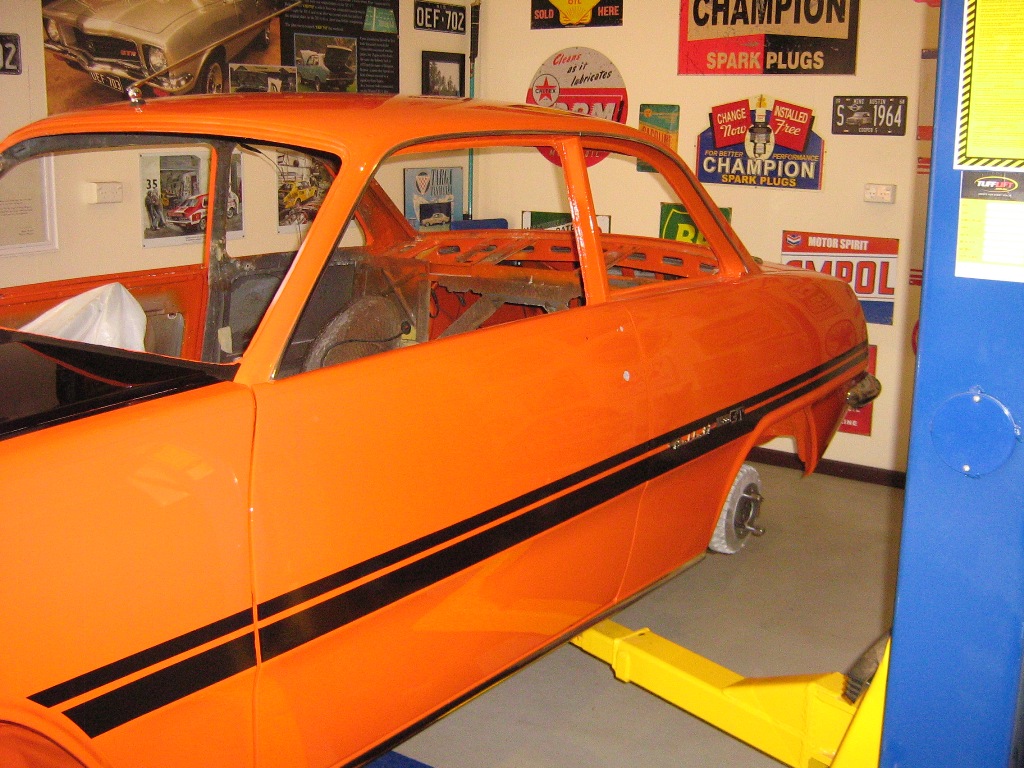

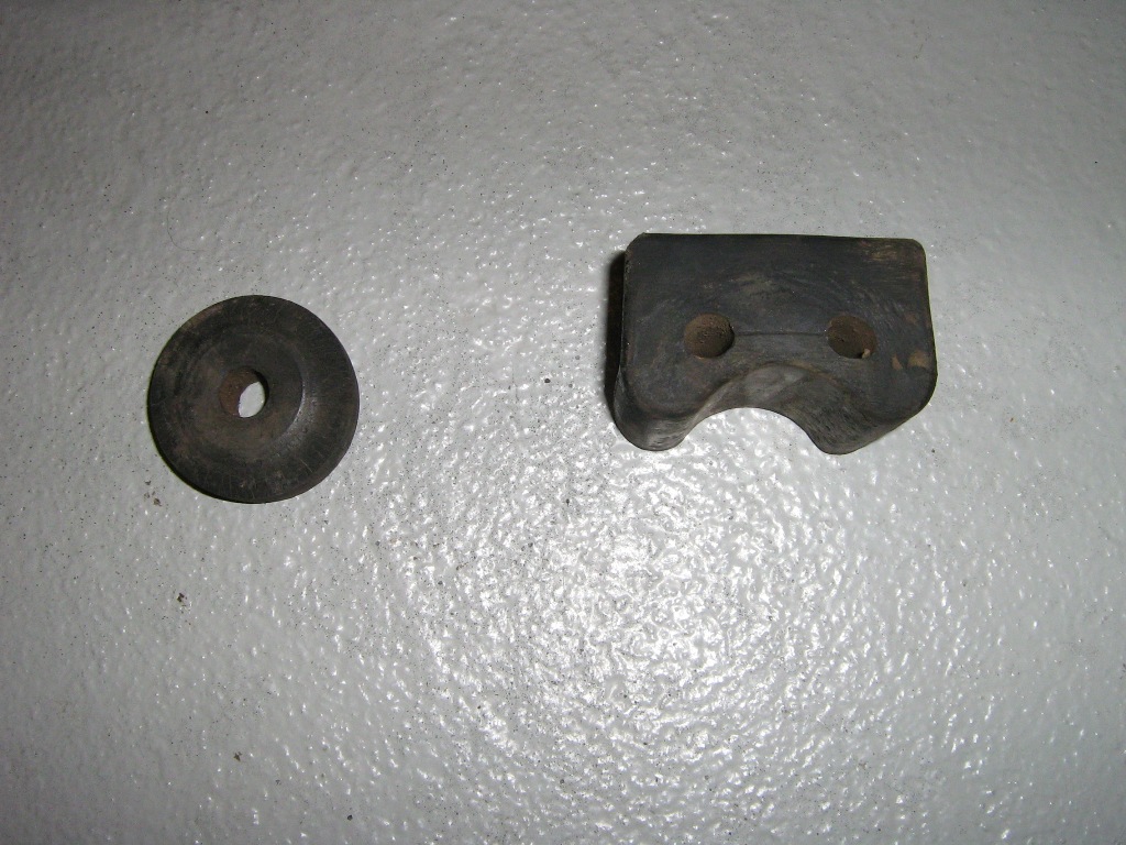

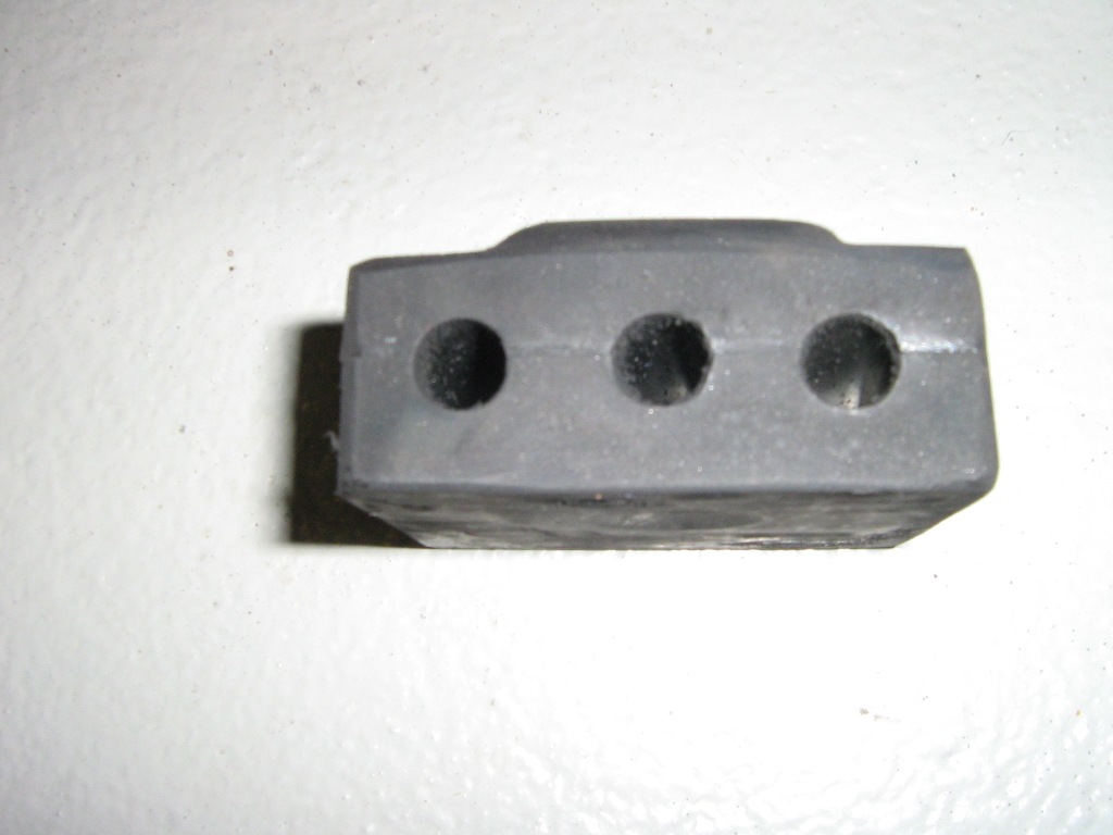

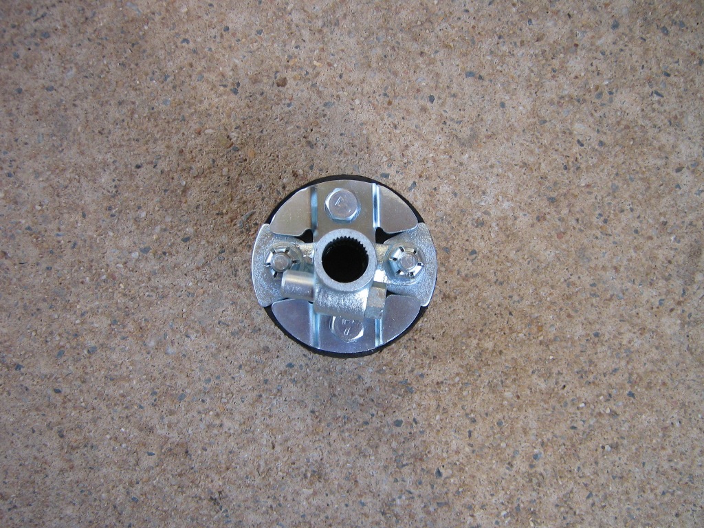

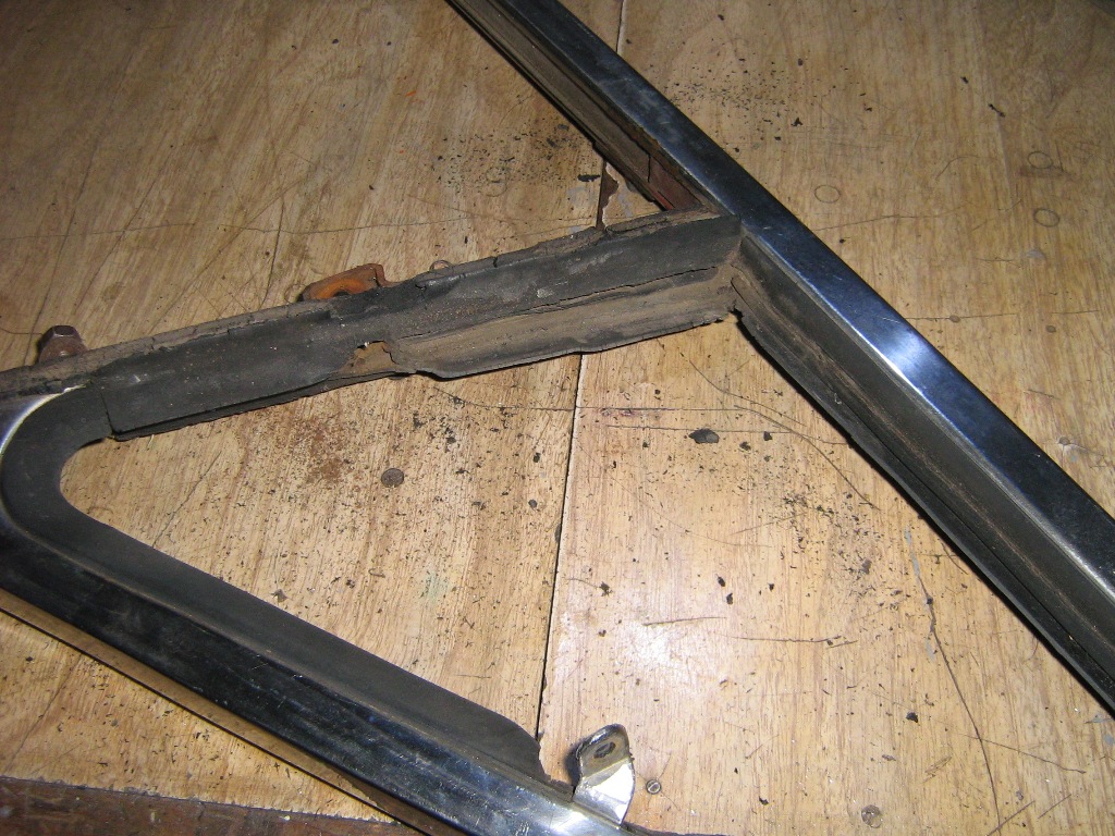

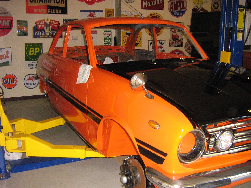

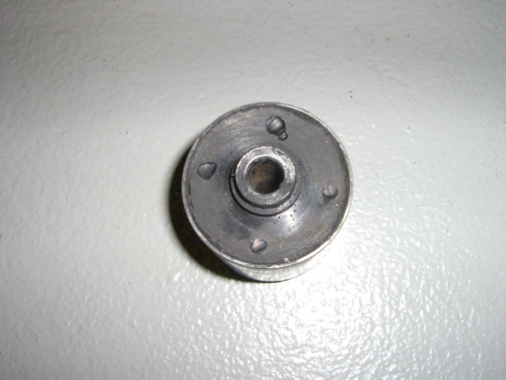

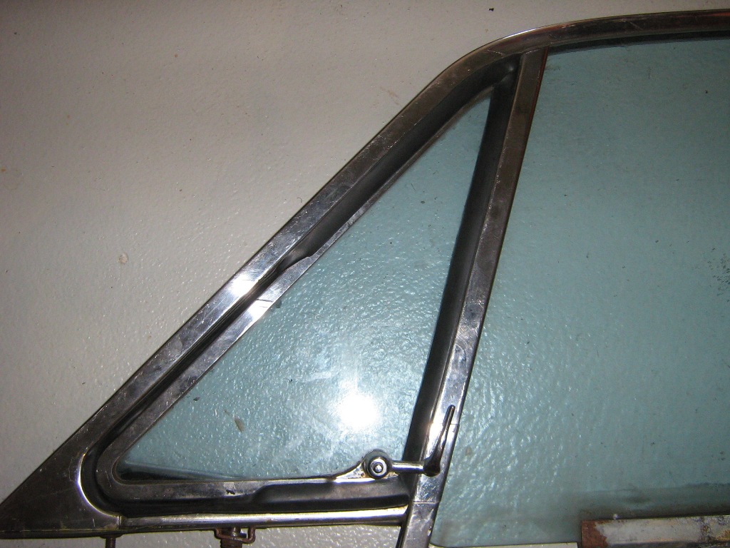

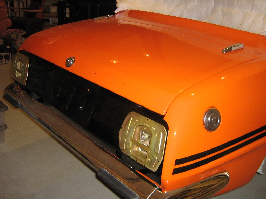

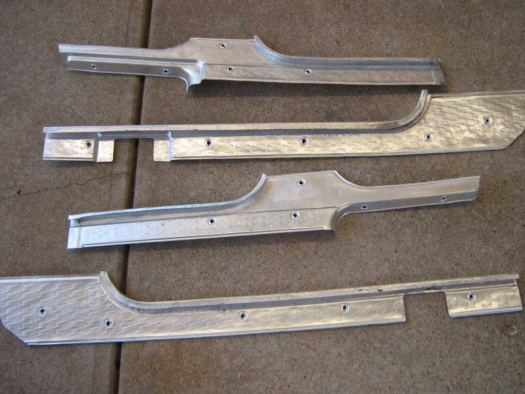

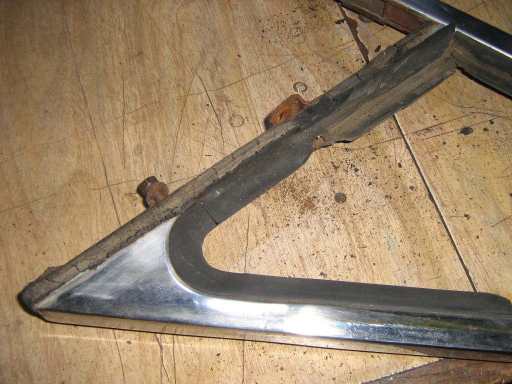

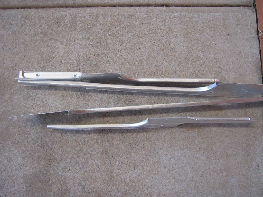

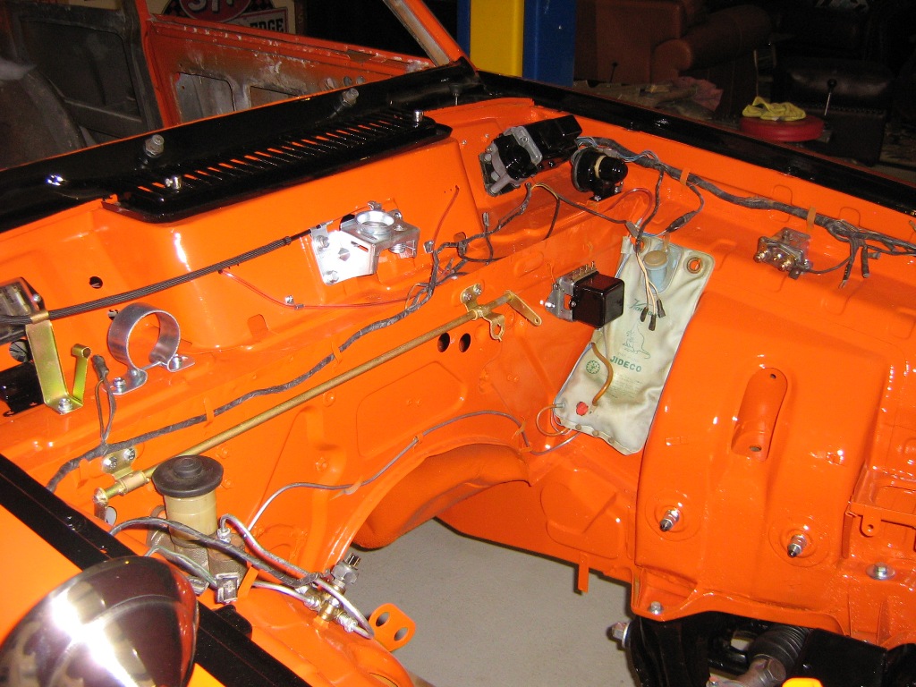

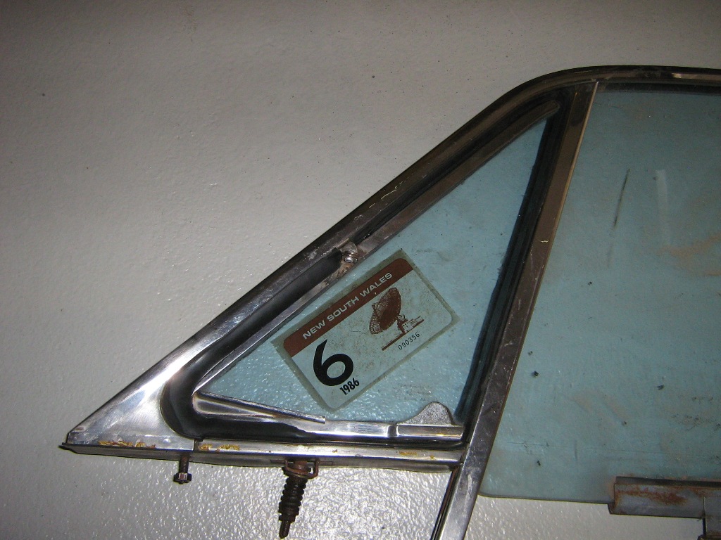

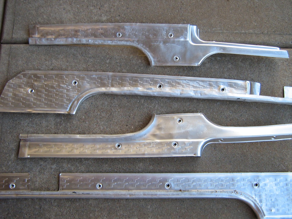

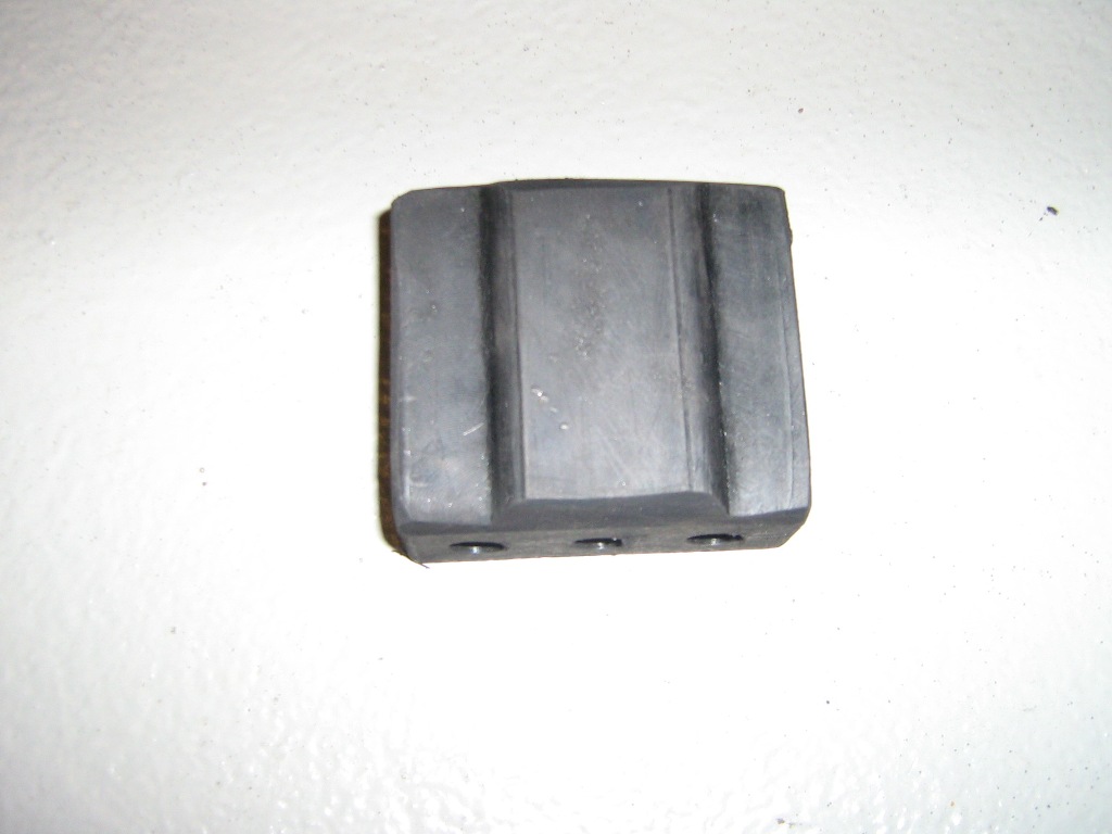

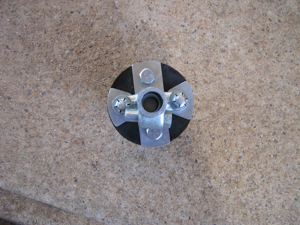

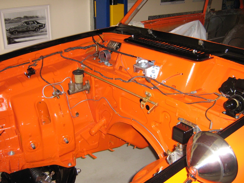

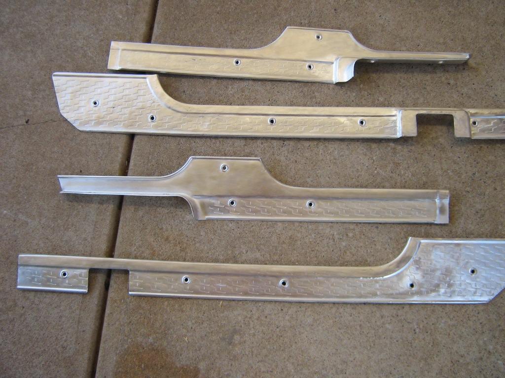

It has been a little while since my last post so I thought I would update you with the progress on the GT. More zincing and refurbishment of some parts and of course more assembly. I have replaced the quarter vent window seals with new items and of course like everything I touch at the moment it took a while to complete. The frames still have to be cleaned up and fitted to the doors. Tony Iglio has been busy making some more bushes, he has refurbished the gear box mount and made a new rear leaf spring bottom mount. If you need these parts the tooling has been paid for all you need to do is ring Tony. With the gearbox mount you will need to provide you old mount and he will refurbish that. He is busy now making the top leaf spring mount and the end of leaf spring bushes as per picture. Some of the parts had to go out to people for repair work and that has taken time. I have found a gentleman in the Barossa Valley (old school panel beater - 83 years of age) and he specialises in repairing stainless and aluminium trim. He has knocked the dents out of the grill sections, sill panel strips and the aluminium scuff plates. He also repaired a very bad dent in one of my stainless steel door trim pieces. With the COVID everything is taking longer than usual as there appears to be more people doing restoration work at the moment. I have stripped the engine in readiness of taking it to Bendigo to have all the machine work done and pistons made. The cam has to go to Clive Stenlake in Fern Tree Gully for grinding as he still has the Bellett profiles. Of course this has been delayed with border closures etc and would like to think we can get across some time in April May 2021. The coil springs for the front are currently under order with Dobinsons springs in Rockhampton but they will not be ready for delivery until the end of march. I pulled the pin on lovells as it just became to hard to get what I wanted. There are a lot of parts out with the chrome platers , they have had the bits since December and i expect to pick them up at the end of march. As I said earlier there are huge backlogs out there and with everybody being locked down for some period of time they have decided to start work on their projects, all my usual suppliers inform me that they are flat out.
I have attached some before and after pictures of some items and of course some pictures of the car in its current state.
Regards
Peter
