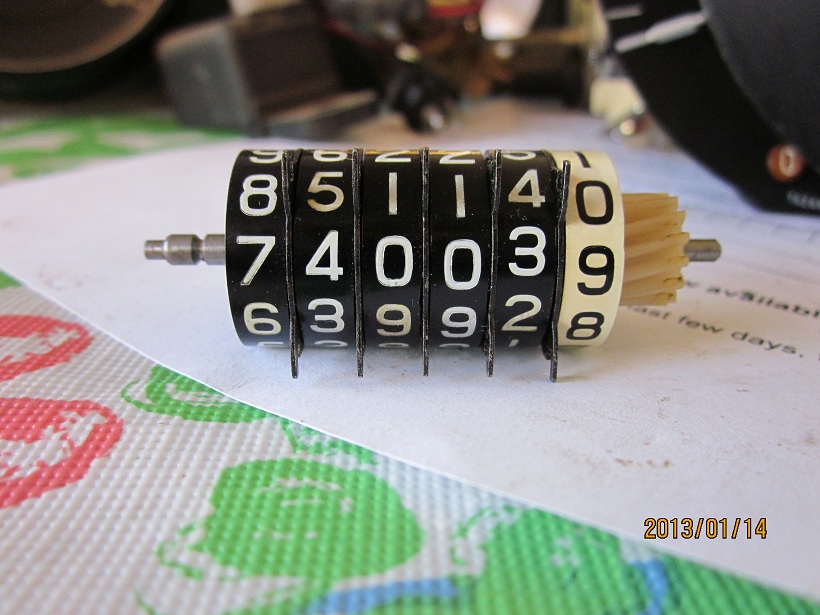

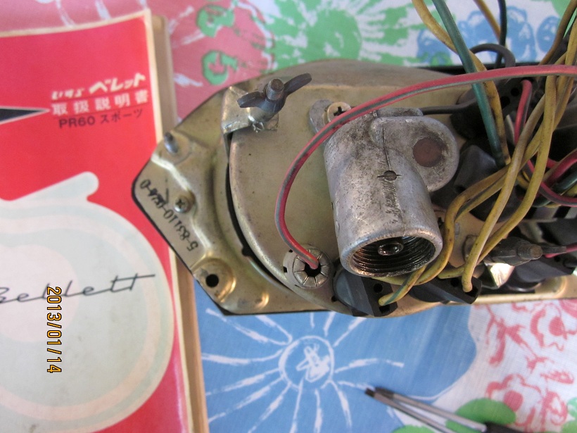

a few little things to tidy up on the Sport. ODO meter not working was one.
Pulled it apart and found the numbered wheels all jammed on the shaft so after a lot of mucking about,. managed to get them all off the shaft and cleaned and lightly oiled it, put everything back. And no, I didn't wind :) it back
Interesting on these late models, the speedo drive cable comes out at an angle. There is an angle drive adapter setup on the rear, part of the speedo. There is also a little electronic pickup inside the speedo. I don't know what it's for as the owners manual diagram does not even show it. It connects into that little box in the centre of the picture with one wire going into the main loom.

The Tacho is interesting also in these (i assume) late models. It has two adjustments in back of the unit. I assume to zero it and set calibrate rpm
My GT had no such thing.

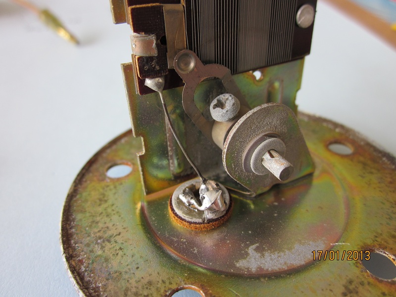

Fuel gauge not working:
might help somebody with gauge issues. My fuel gauge was not working so eliminated the gauge by disconnecting the sender and shorting the wire to chassis. The gauge should show full.
That left the sender. I pulled it apart and cleaned the contacts to no avail, then after a short drive, the gauge worked again....... but stopped after a while. [actually the short drive was to get a sender from a spare tank that was with the spare car, which also proved to be a dud. It was also different, having a much shorter arm on the float. This might lend some weight to the 'rumour' that later cars and GTR's initially, had a slightly larger fuel tank, so the sender lever would need to be longer also ??]
I found that the terminal connection was intermittent inside the sender. I soldered a piece of wire from the brass terminal, to the solder lug and it's fixed.
I also found that the sender would read empty on the guage when the float was in the 'full' position. Bending the little 'end stop' tab inwards fixed that problem. If you have an ohm meter, the sender resistance should be close to zero ohms when full, about 50 ohms in the centre and 150 ohms when in the lowest, empty position.

My GT had the angle drive on the back of the speedo head. My observation was that it reduced the angle the speedo cable when it went through the firewall. As all models have the fusebox mounted in front of the instrument panel, the cable has to traverse at an angle that is too much and in later years jams and breaks. It goes the same, for the angle from out of the speed driven gear, being a reduced radius. Creating a larger arc or longer cable will alleviate the problem on the transmission end.
The speedo head on the GT has been repaired. I sent it to Rockhampton to a instrument repairer and with the internals of a standard speedo he repaired it keeping the original face. So. I'm back to an acute angle on the cable. Got the brain ticking over for a modification. And. My Gt hasen't got the "speed sensor".
Thanks for the tip on the fuel sender. My first car, 67 PR20, had sender problems found that the terminal on top of unit was shorting out. I drilled the rivet out and inserted a nylon bush and used a fine thread screw and bolted all together.
Having trouble with my sedan,68/9 PR20, with fuel sender. DAVO gave me a sender that may get me out of trouble. Will look at your 'fix' and use his unit to repair the problem. Took the 1 out of the GT and doing same. Or should I say. Not doing anything.

Hi Dave, there is another difference with speedo in that the cable on the PR60 and I assume late models, comes out out through the flat section of the firewall. ie adjacent to the coil. Pretty sure earlier models, it comes out of the more vertical section under the windscreen ?. { or my memory is shot}
For such a simple fuel gauge system there are a number of possible problem areas. But especially if you have an ohm meter, the sender can be diagnosed fairly easily i think.
Conversely, if you get/buy a 47 ohm and a 150 ohm resistor from Jaycar or similar place, you can disconnect the sender and fit either resistor to ground and the gauge should show half or empty.

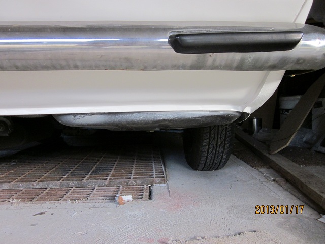

ref the tank,
if i get under the car with a tape measure and measure in the drain plug area, from the top mounting face down to the flat area where the plug is, the distance is ~180mm. Top of the tank is just below boot floor level.
Another clue is that the tank hangs visibly lower than the bottom of the rear pan. {must clean that overspray off too :) }
Maybe somebody can measure theirs to see what difference there is if any, on early cars.

the Bellett gauge is always "tricky" at the E end. I think a way to make you re-fill but actually still plenty left. The trick is to know just how 'accurate' that end is ! I was going to only put a few litres in the tank to check it out when i got the car but thwarted by the faulty sender.
But it appears to me, that the tank is in fact larger on these late models and maybe on all the GT-R's also ?

With the sender, while it was out being fixed, i dipped the tank to see the level. Then i put the sender back in with 2 screws only and checked the KNOWN level. I then bent the sender arm a little until i got the gauge to read correctly. { the actual slider contact arm can also be adjusted to do this but bending the arm a little was quicker.} In this case i had a half a tank of fuel so fiddled until the gauge ready 1/2 also. It remains to be seen now, just what happens at the empty end ! I will carry spare fuel until I know ;)
Be very carefull if you do this, NO SPARKS.
