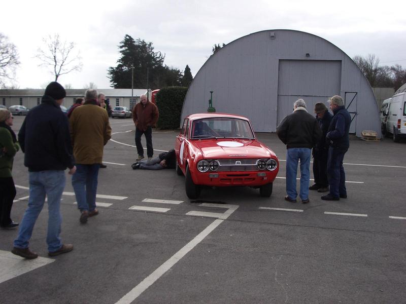

And lastly, some of you might enjoy this photo taken at the Goodwood test, it gives an idea of the interest Rolie is generating over here.....when you consider the other stuff they could have been looking at.

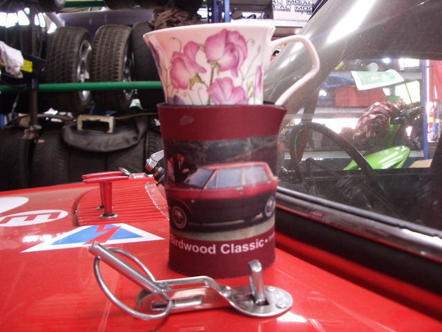

In the meantime thank you to the Forum, in particular, Dave for my gift from down under. Below is a pic of it being used as it's intended I assume...keeping a nice cup of tea warm.
THANK YOU THE FORUM
