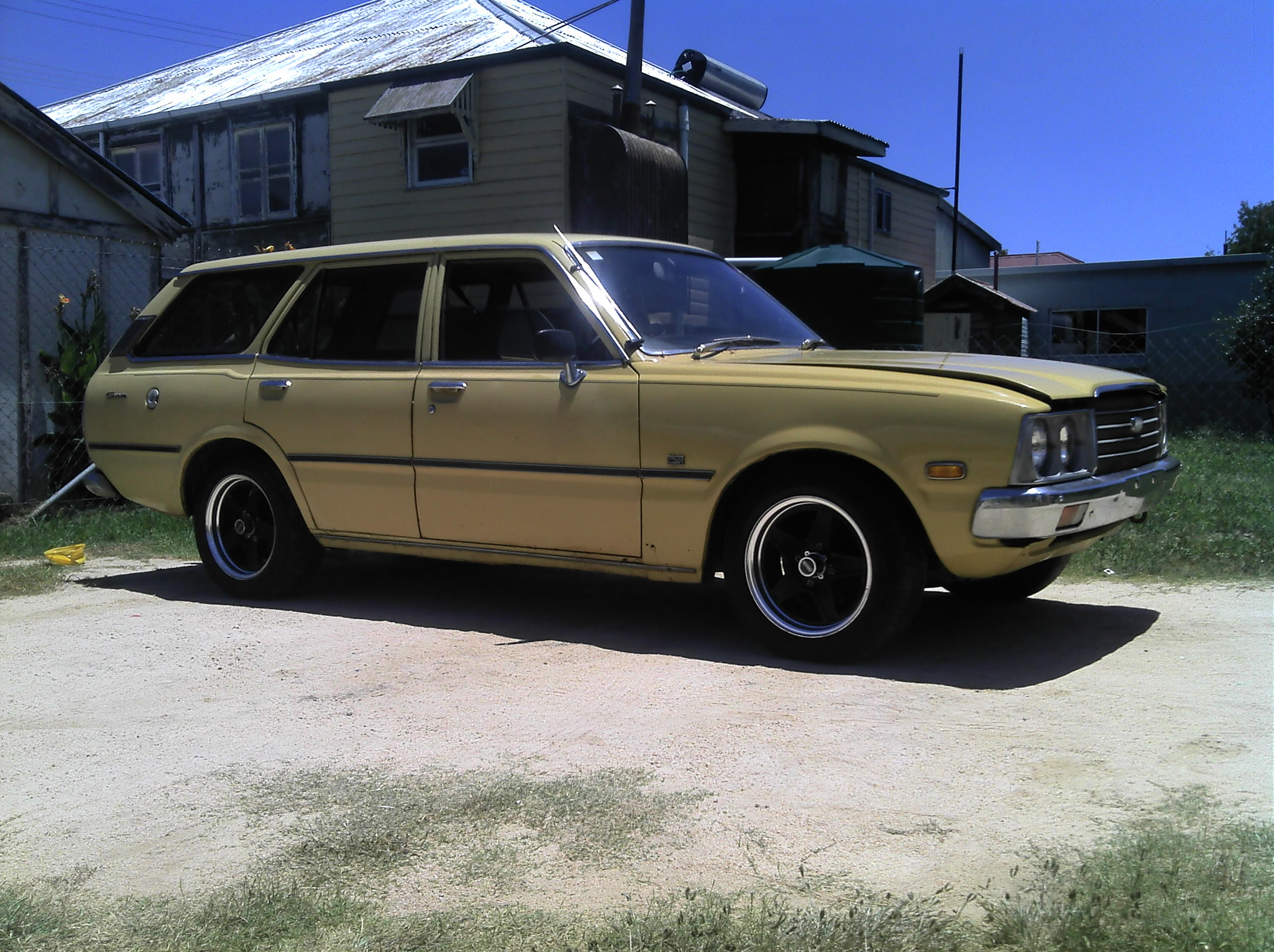

hey liz great to see the old girl coming along so well :) there is no way i would have been able to go as far as you are with her. glad to see she is in good hands, as is my new project ;)
10/4 kemosabe
