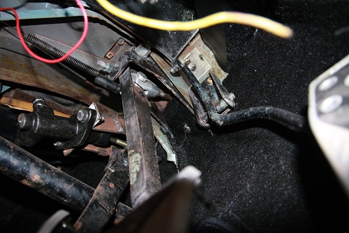

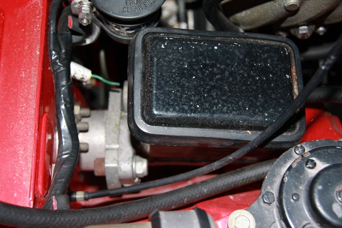

Whats the gadget on the inside on the clutch pedal ?
One thing for sure with turning a FWD engine around, the cam belt replacement should be much easier !

Hi Glenn,
The clutch on the Nissan box is hydraulic and there isn't any room inside the engine bay for the master cylinder so i turned it around and mounted it inside the car with the fluid container in the engine bay, its the small round one next to the brake master cylinder.
its a Toyota Celica clutch master cylinder.

OK, on the master cyl. I thought it was but was tricked by the reservoir on the other side !
Don't worry, I think most if not all of us, are very impressed with your work and the car.

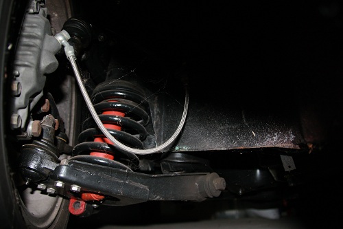

Brakes - Mazda RX7 - Series 4 (4 Spot)
- 11" Ford Discs

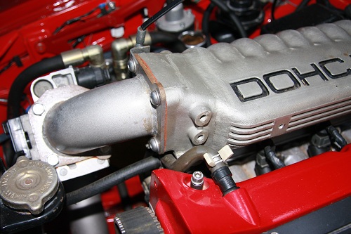

The engine cooling concerns me. I can't tell if it is the original Bellett GT radiator or something else. If the height and width are the same as the Bellett radiator, it is going to be about 2 1/2 inches thick to match the size of the JT191S or JTU07 turbo. Even that is a little undersized. No problem for street, but the Isuzu Circuit Meet guys complain that they overheat in a 20 minute track session. And the Elan Turbo, with a smaller radiator, is bad for overheating in stop-and-go traffic.
The lack of an intercooler is also a problem. You will have to turn down the boost or it will have detonation problems. You'll end up close to the non-turbo power numbers.
I want to hear how it does on the road. But before taking off on a long trip, you might put in some good temp gauges, a good knock sensor, and run some miles close to home.

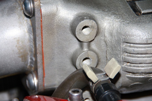

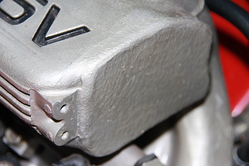

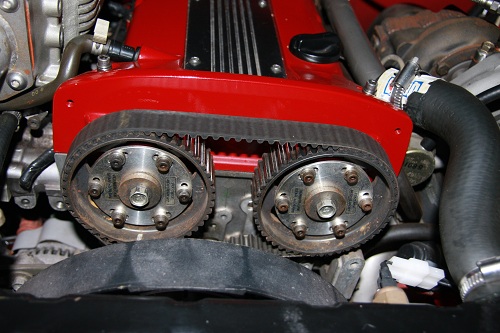

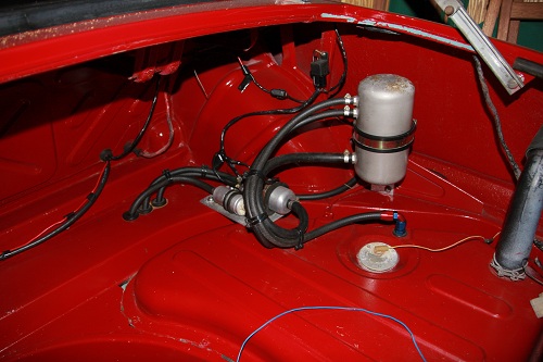

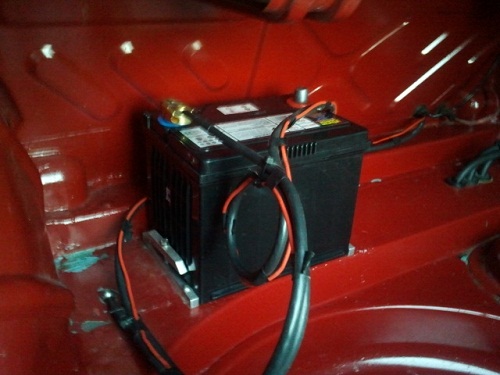

JT191 was keen to see the modifications to the intake manifold so i have taken a few pictures, i wish i have taken some pictures when i was building it all... digital life where were you 15yrs ago...
The intake manifold was cut and shut the original engine had the throttle body and inter-cooler at the back of the engine over the cam angle sensor, but this really wouldnt fit this way so i stripped it all down and started to put it back together in the car...
The Radiator is a standard one... but re-cored copper is a very good conductor of heat... and a 16" thermo fan... so i am not to worried about the cooling aspect.
ahh that right i was worried about the extra boost of the TO3 and got a copper head gasket made up for it..
The things you start remembering.
I did want to put an inter-cooler in but after the oil cooler the thermo fan and the engine there really isn't much room left.. i had to cut a hole in the bonnet for the engine. but i have made up a TR3 style shroud... like a teardrop... used one of those plastic footballs and some expanding foam to make the mold for it.. then putty and sanding.. but over the years lost it.. i still have the mold so i can make up another one.
P.S. this is fun sharing the adventures of a mad man and the Bellett the could.
