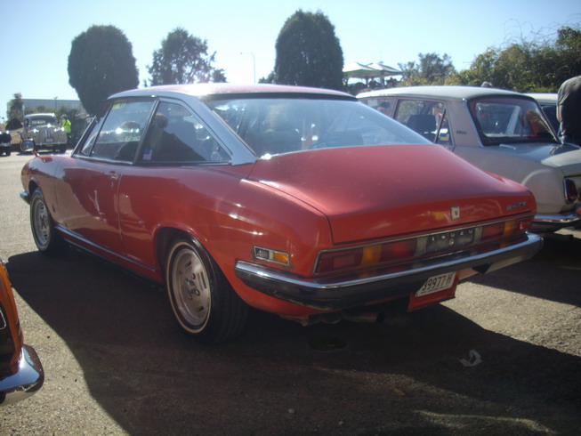

On the tyres, both my Belletts have 185/70's on the standard rims. They fit up OK & even look fairly decent. Not a problem, even fully loaded for the 2009 Nats trip.
Gary Carter has these on his 117. I reckon the ribbon walls look way better than the plains, & it's what I'll get next time. Just had them in stock in Borowa, I'll find the brand & price & post, but they were very reasonable. I'll ask about sizes too.

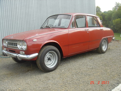

From my experiences and from what I remember, most sporting car enthusiasts in the mid to late sixties could not wait to get rid of the "cross plies " and fit Pirelli Cinturatos or Michelins XAS , both being the premium handling tyres of the time , or else Goodyear G800's ( new and un proven ) , Fulda or Vreidestein - the last 2 being cheaper although still way ahead of the Dunsafe 5.60 x 13. The wheel trims generally got hung on the garage wall and forgotten .Most common wheel colours (without caps or trims ) was black or silver or if money was not an isue - chrome . The next big improvement was when you could afford the components to build or have built a set of 6 x 13 steel "widies" and put some 175 x 13 radials on them. This last step made a dramatic difference in handling compared to the factory original set up.

AAHHH the old Michelin "X" what a tyre, all the cabbies used them because you get a million miles out of them, had them on first Bellett, and wern't they fun in the wet? :shock: didn't know where you end up, mostly looking at the road you just came along :oops:
Thanks for the memory.......nightmare.........

YEH! I couldn't wait to get rid of my Dunsafes. Ran Dunlop SP-3 's for a while. Nobody up here could do wheel alignments
successfully on my car. I later bought some 13" wheels off of the XP Falcon. Brand new they were. Going cheap because the late series XP ran 14" as well as the XR series. Fitted them up with Pirellis too. Eventually found someone who could do a wheel alignment. Best run I had was on my honeymoon to Adelaide in '75.
KB. Thanks for the pic. of the Roman Red. Brings back memories everytime I see Lindsay's, now Ocka and Trish's, Roman Red.

I forgot about the Dunlop SP 3'S and SP 41'S - both were pretty good. I ran 13" Falcon wheels with winter tread tyres for Rallies and Auto X.
Sun Sep 09, 2012 10:48 pm
cool classic picture you posted up there, Kerry.
i can remember a few Bellett's running around with Wide Steel rims
thanks for the memories
Sun Sep 09, 2012 11:15 pm
reminds me on the hot up articles in Wheels.....
Sun Sep 09, 2012 11:34 pm
Yep, that's the classic 60's hot up look, but not what I'm after. I reckon the 155's might be the way to go then, although nothing available in Australia in a radial. Tornel (Mexico) do a nice thick white wall 'ribbon', exactly the same as the old brochures...there's some on eBay in the US. The more I look at it, the more I want to keep those hubbies on there...if I can make it up and down Torrens Road without them falling off, I could probably make it anywhere. It has to be the worst road in Adelaide by a fair stretch (Foster's Road a pretty close second), no wonder so many people get killed on it.
Anyways, a local tyre shop actually gave the painted white walls a good wrap, but whatever 165/80's I select will need to have no text on the white wall area...will have to shop around again. I think there's only ~3 manufacturers bringing 165/80's into the country...amazing! 13's are slowly going the way of 12's!
Mon Sep 10, 2012 12:09 am
Yes Genn , my new Bellett in 1966 was turned into a sort of low budget facsimile of the Wheels Project car. The car in the pic is another Bellett that was bought new by a family friend at the same time that I bought mine. Mine was sold in 1971 but I was able to buy the car in the pic in 1990 - has original 90,000 mls on it , and recreate my original Bellett.
