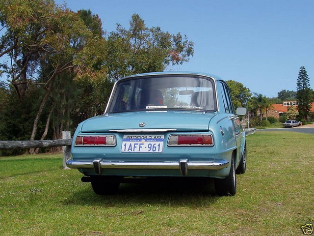

Thanks for the photo Gerry that's cool as and Donkey looks forward to his treat with much anticipation.
...and for the curiosity of Farmer Matt and all others, here are a few pics of Donkeys younger brother Billy.
His name I think is fitting for 2 reasons.....
1. I once had a Budgie called Billy that was the same blue as this car &
2. The previous owner was Bill Buys in WA

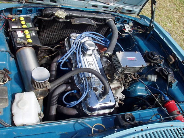

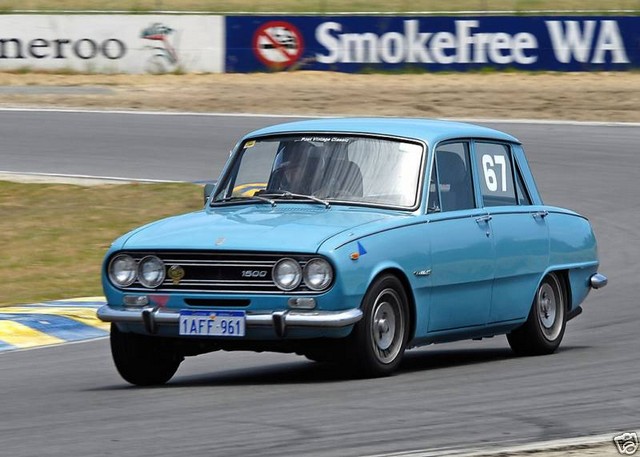

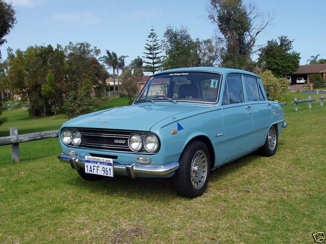

The first 4 photos are as when owned and raced by Bill and are actually the photos from when he listed it on Ebay

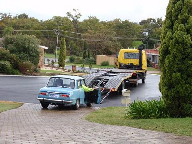

This is Billy being loaded onto transport ready for his big trip from Perth to Brisbane

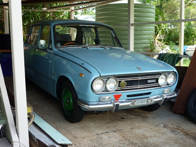

This is Billy (with Donkeys stockos) sitting under the house I used to live in, he now resides at my brothers place (as seen in pic under temporary tent) waiting patiently for some repairs/mods
Billy's towers need to be fixed, also to get QLD rego some mods have to be blue plated to meet QLD compliance ie: the Galant disc brakes need a boosted twin piston master cylinder fitted (still orig non boosted single) + I have to get the front seats either put back to std or make new mounts that comply (whats there was done by dodgy brothers WA) and get inertia reel seat belts and mounts (dodgy brothers also) replaced with new to meet compliance also.
Other than that there's not a lot needed, some minor rust in back passenger door and a clunk in the back end to be sussed out and it's happy days.
Will give him a cage and race seats and harnesses one day so that I can go out and play with GT Orph but that will be after Donkey gets his facelift.

Ah-haaaaaa, I remember the listing and thinking, "so far away....." What a nice little car, and yet another polynesian blue strip taillight. (Not that they're common - '69s are pretty scarce!)
Shame about the red tape, are they any easier on cars for historic rego? Or perhaps the mods exclude it from that?
It will be nice to see him at the nationals wunnathese days. ;)

We all love red tape but.....
the red tape isn't too much of an issue for this car though, it's more the shoddy way that the mods have been done.
A blind man must have welded the seat brackets together out of scrape steel found at the tip, seat belt floor mounts are just a couple of bits of hacked off 40mm angle bolted to the floor and the brakes although being front disc conversion may as well been left as drums as the rest of the system hasn't been improved to cater for them. No booster, just orig single piston master. Donkeys drums work better :shock:
When the Gemini engine was fitted the drivers side engine mount was butchered to clear the front mount oil filter but they still couldn't clear it properly so the engine has been fitted on a slight angle and some of the wiring is a bit dodgy too.
In WA you don't have to have an engineer certify mods like these so sometimes dodgy things go unnoticed till you pay top dollar (Violent Crumble would have been a MUCH better deal) and get them to the other side of the country.
I had a mate in Perth give the car a look over and test drive before I purchased but needless to say that these were things that I don't expect he would have noticed or known as anything wrong anyway.

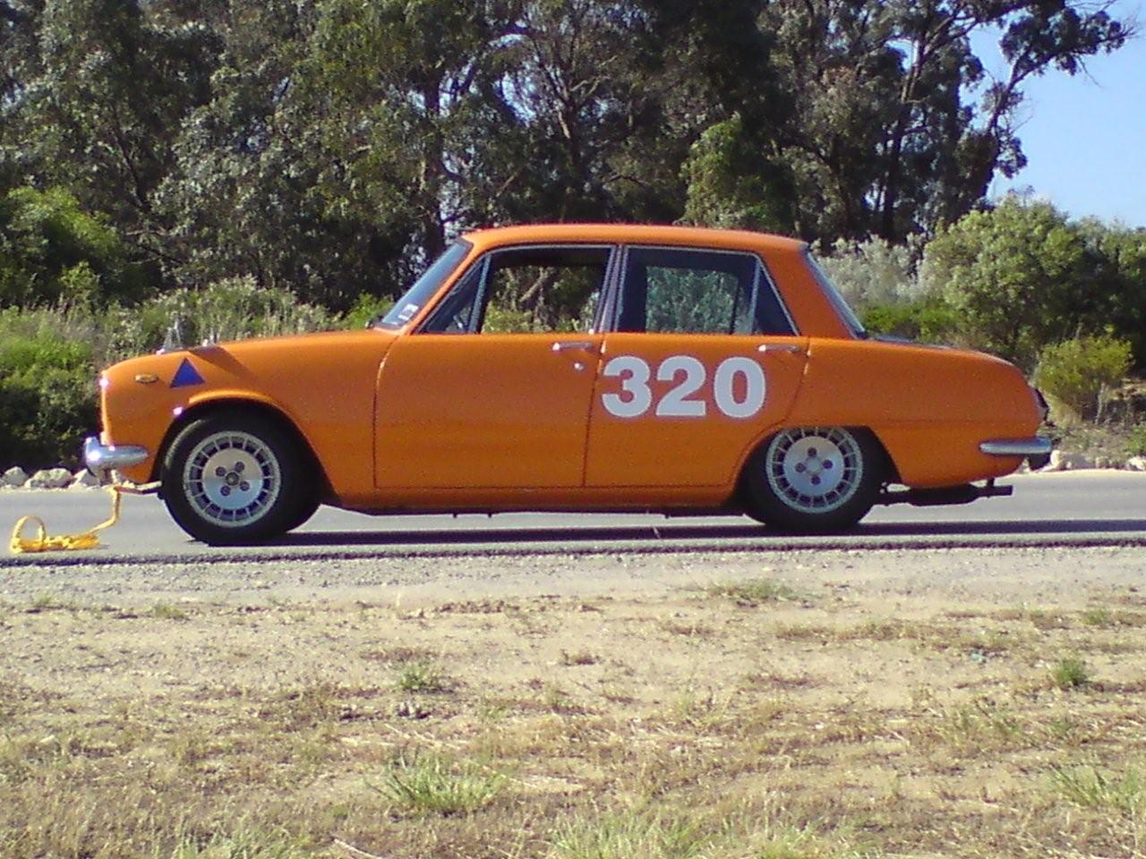

Wish I'd bought Bill's son Rob's car (orange car below) instead but I wasn't aware of it until after I had purchased this blue one (it was half the price & rough as guts - more my style)
Ya get that
Wish I bought this instead.
Rob's car - now living somewhere in Tassie (by a forum member????)

yes but still a nice looking car ...ironically the orange one did go to tassie and is owned by james darvas hes the guy who threw us off with his teardrop tailight early grille and late dash he is doing the orange one up ..see james acar on griceys ..help help help ,,,cheers davo
Fri Nov 23, 2012 11:28 pm
Argh that's who got it, might get to see it at 2014 Tassie nationals maybe.
Sat Nov 24, 2012 12:39 am
looks like deluxe stainless window frames ...........cheers davo

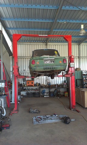

A bit of a Donkey update....
As we are all keenly aware the SA Nationals are almost upon us and Donkey has been very sad to say the least.

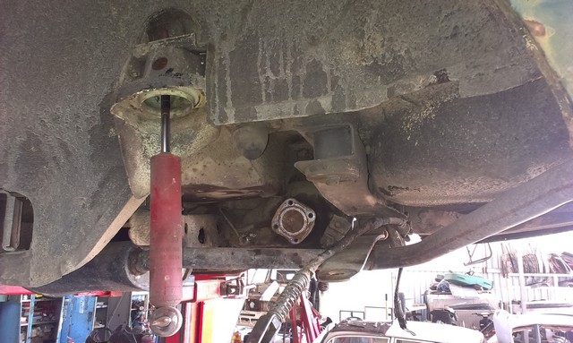

Buggered short shaft uni's, stuffed front L/H lower ball joint, stuffed front bearings, oil filter mount gasket blowouts, filter canister O ring seal issues and last but not least, he no longer wants to start at all :cry:

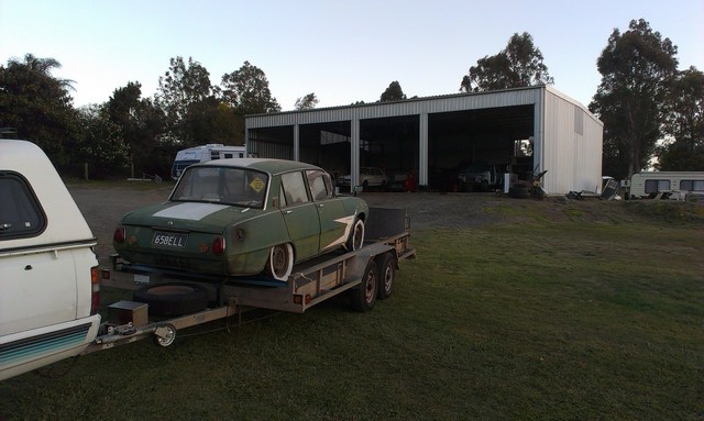

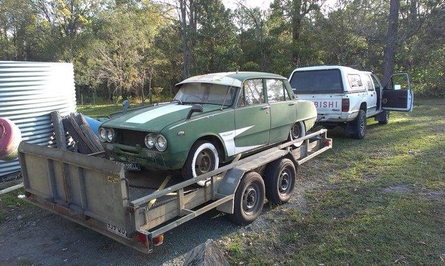

Donkey loaded and ready to go on Friday arvo
Donkey has made it to the Orphanage right on sunset

Saturday morning it's up the hoist and drop his pants for hip replacement surgery

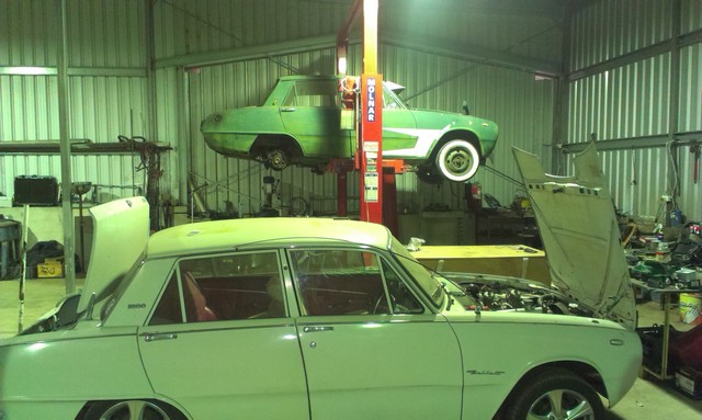

We worked and laughed into the evening while Mr Orphanage gave us his best renditions of some of his favorite songs :lol: :lol: :lol:
Myself, Russel and Adam had a ball, then dinner, then a sleep over, then back into the fun and games again Sunday morning.
The ultimate Bellett working bee weekend (Donkey wasn't the only one needing surgery) that was topped off with a flying visit from Occa and Trish
Thanks Greg and Lizzie for your help and hospitality.
Donkey is smiling again and raring to go to SA
