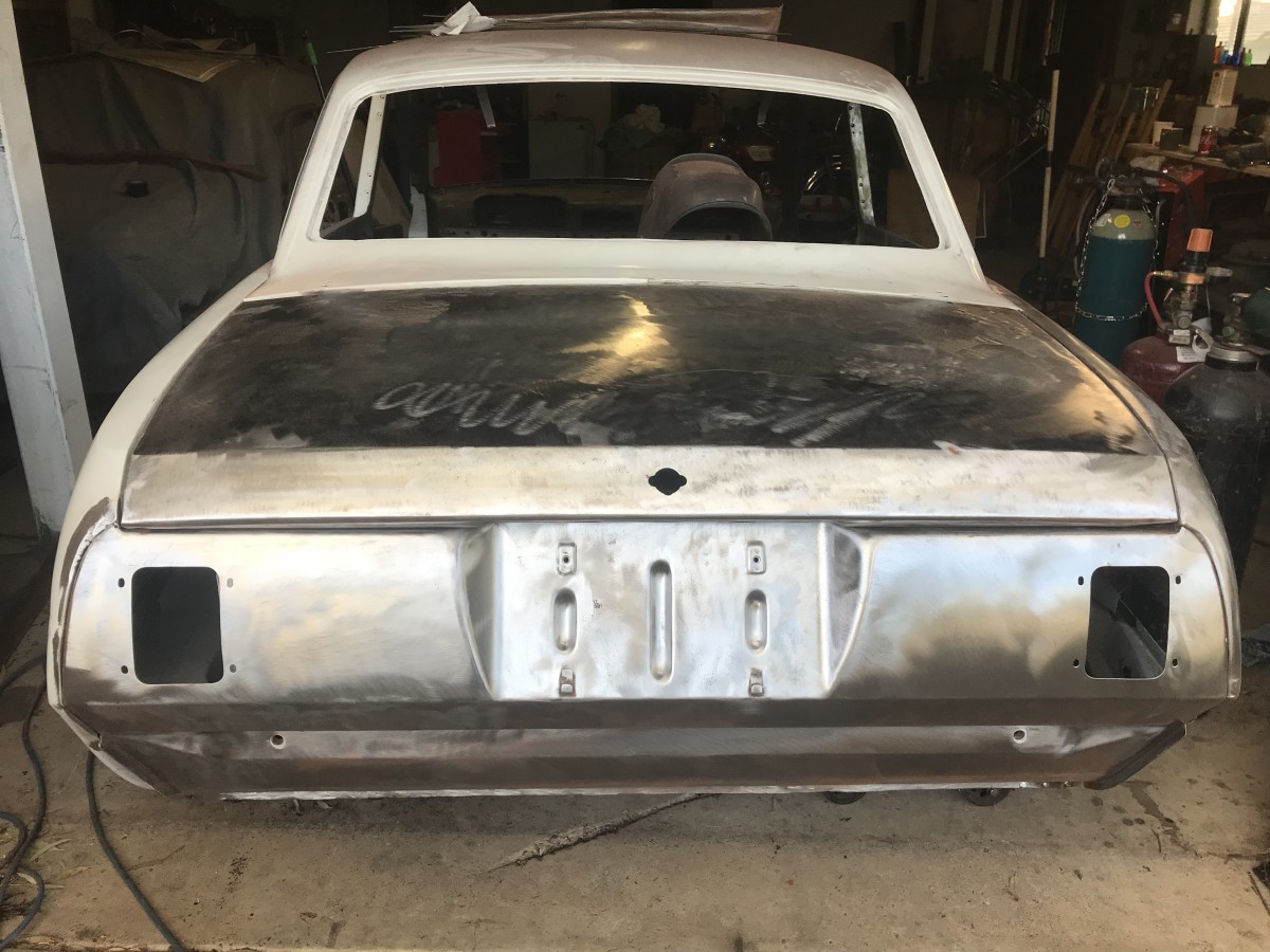

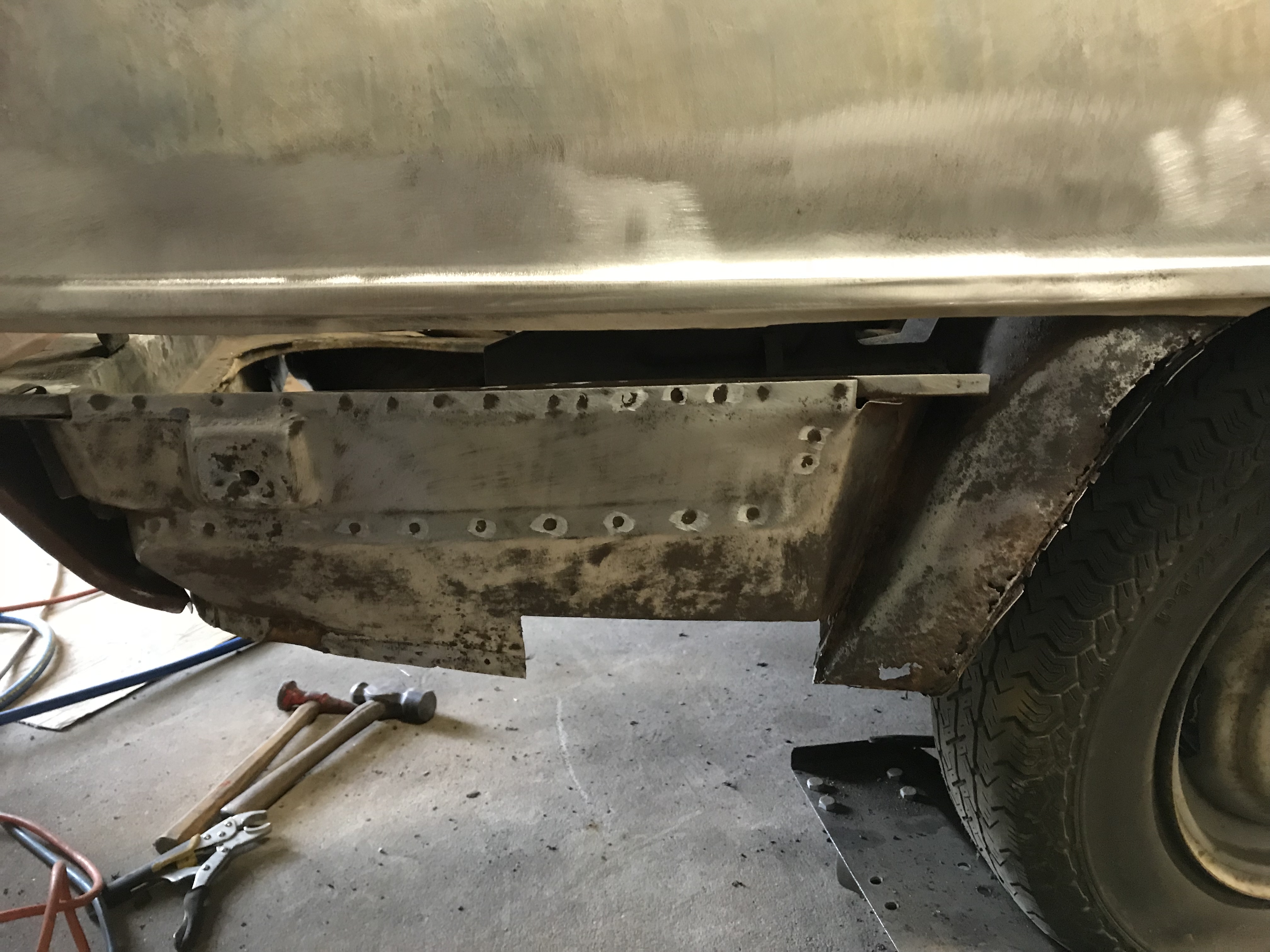

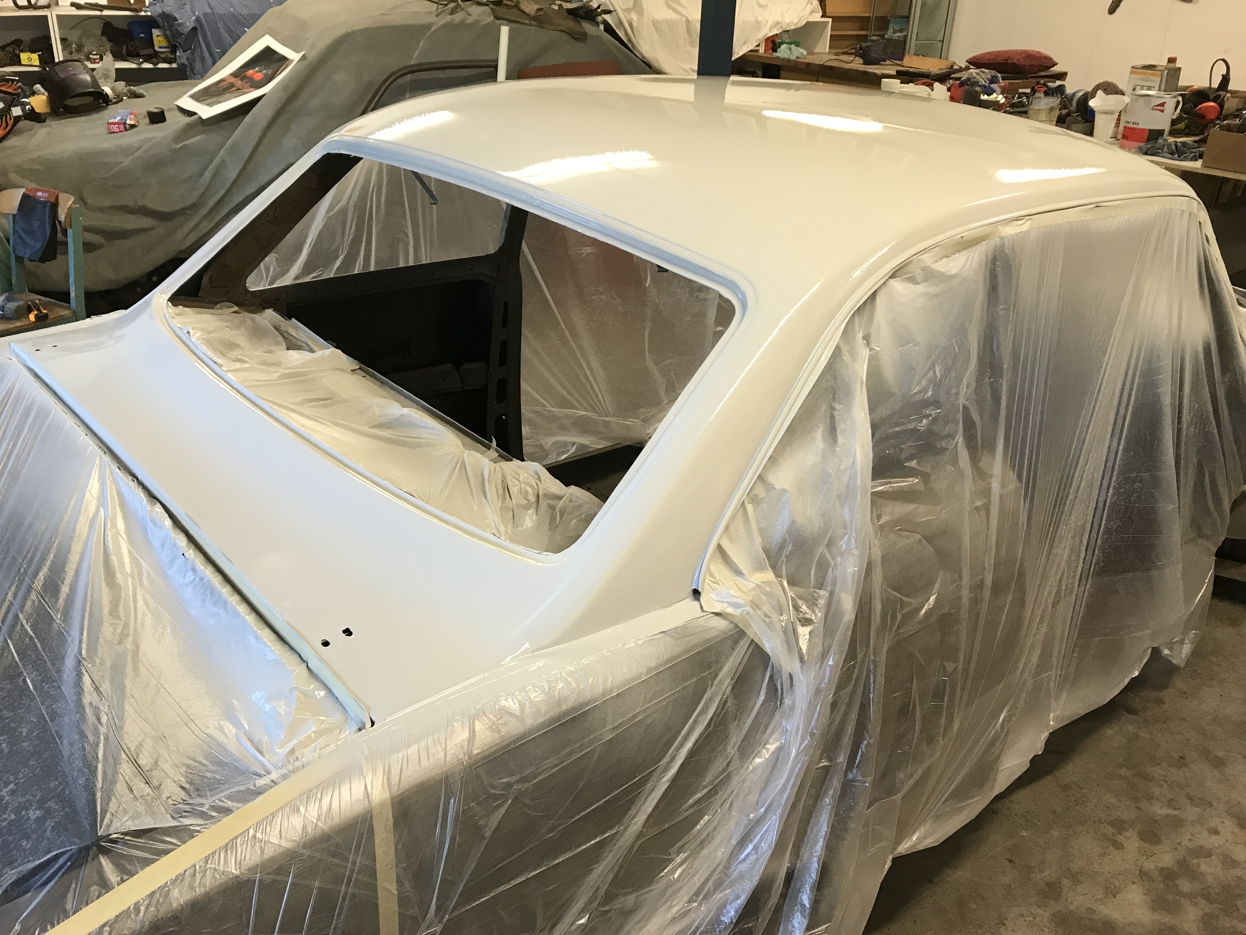

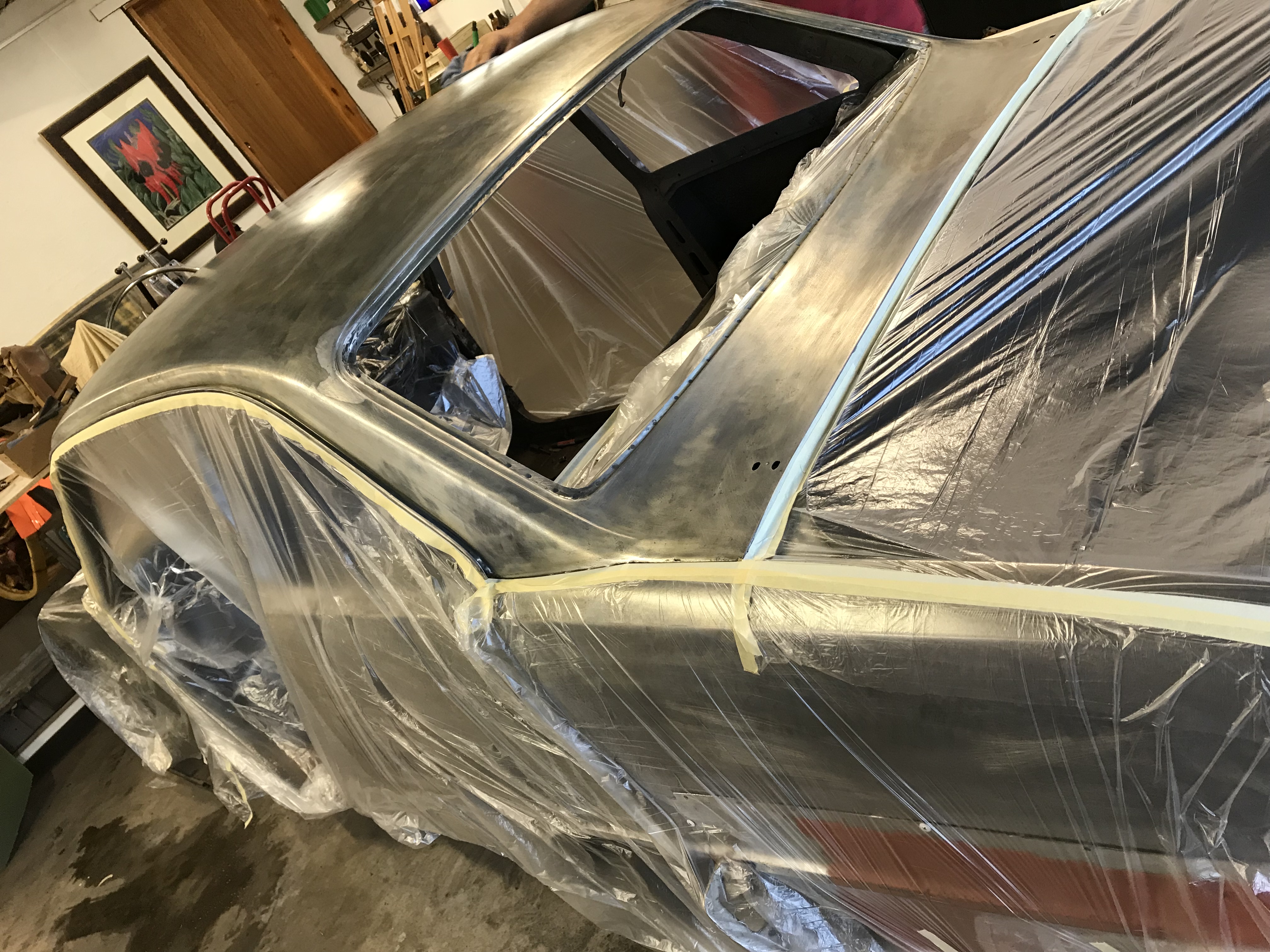

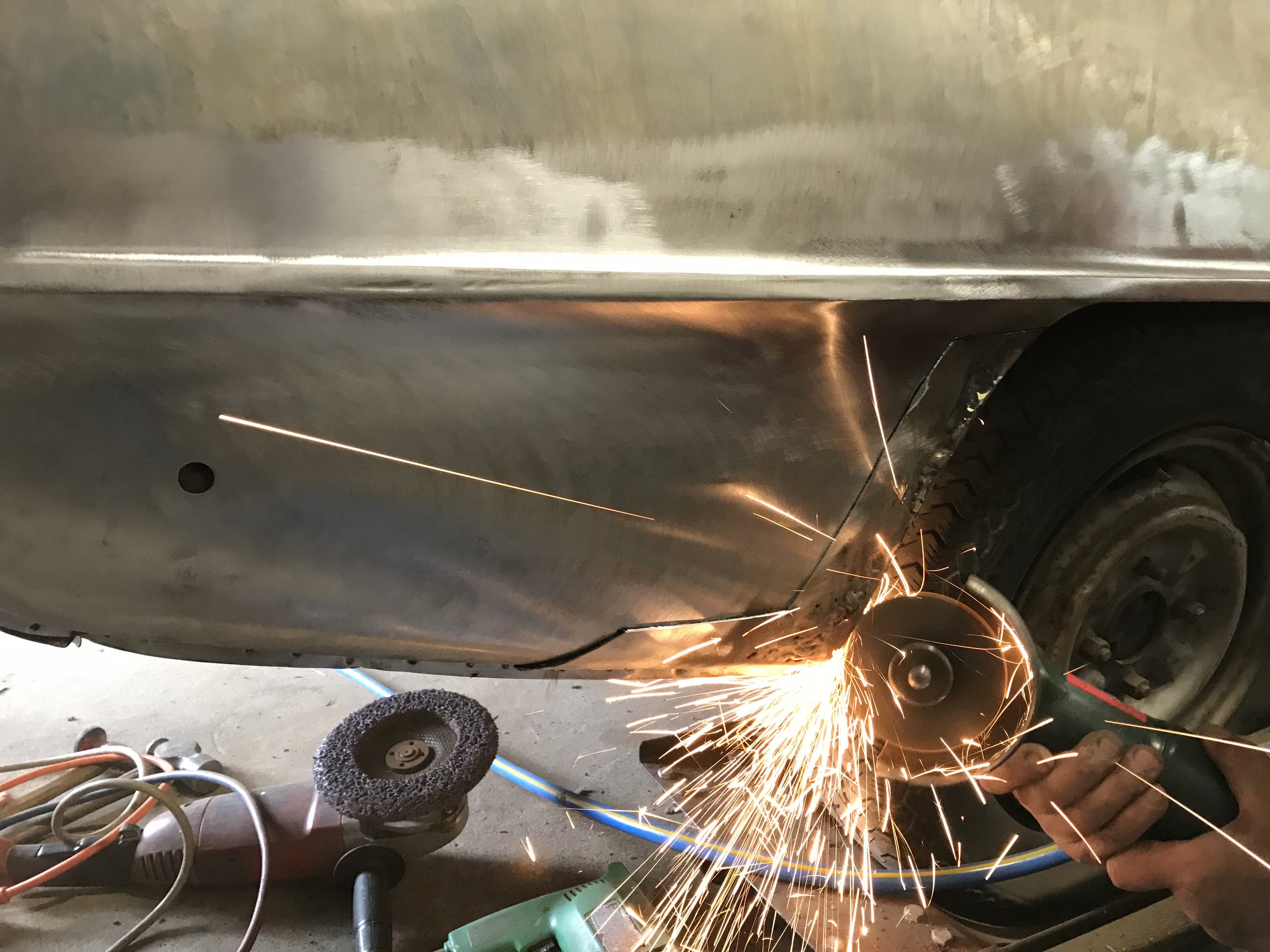

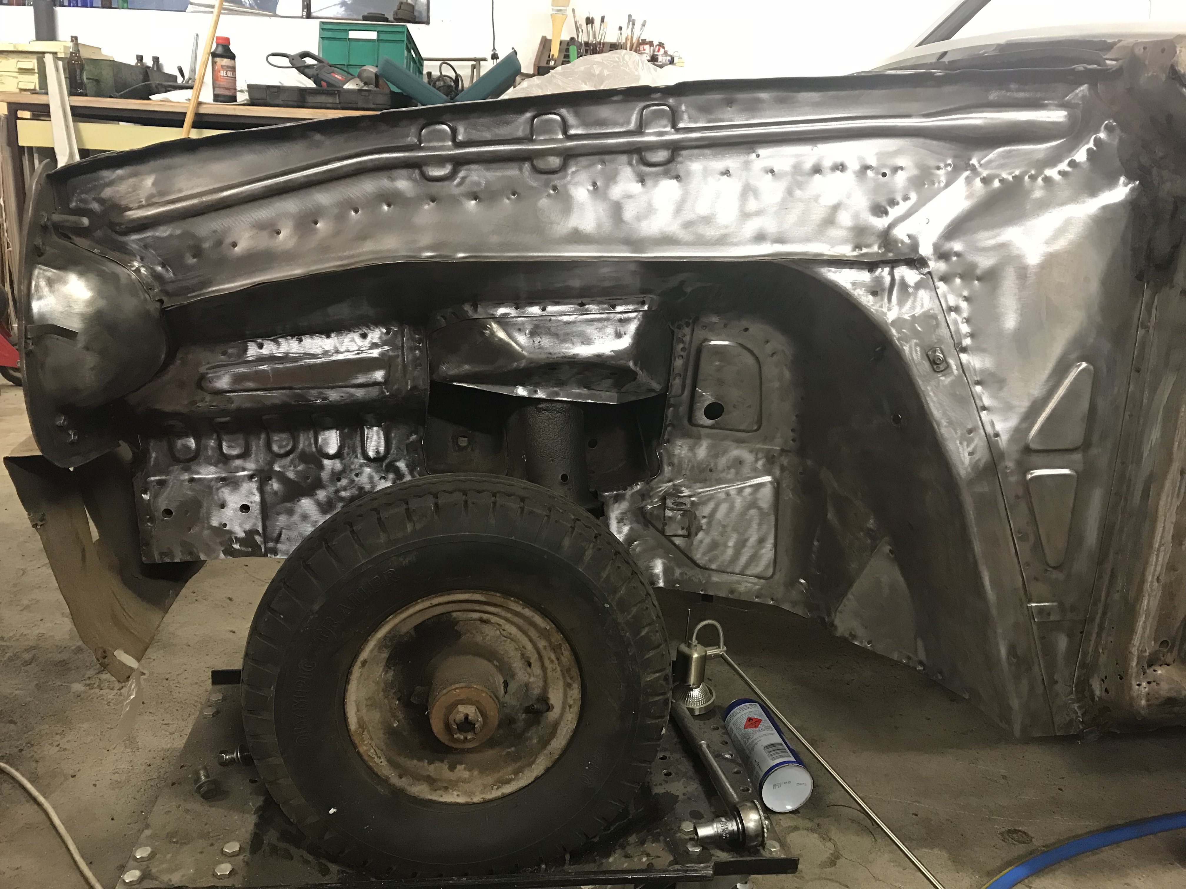

More rust found inside drivers rear quarter so rear panels not finished today.
Roof rust removal finished and apoxy sealer sprayed on.
Rear end will get welded together next week.

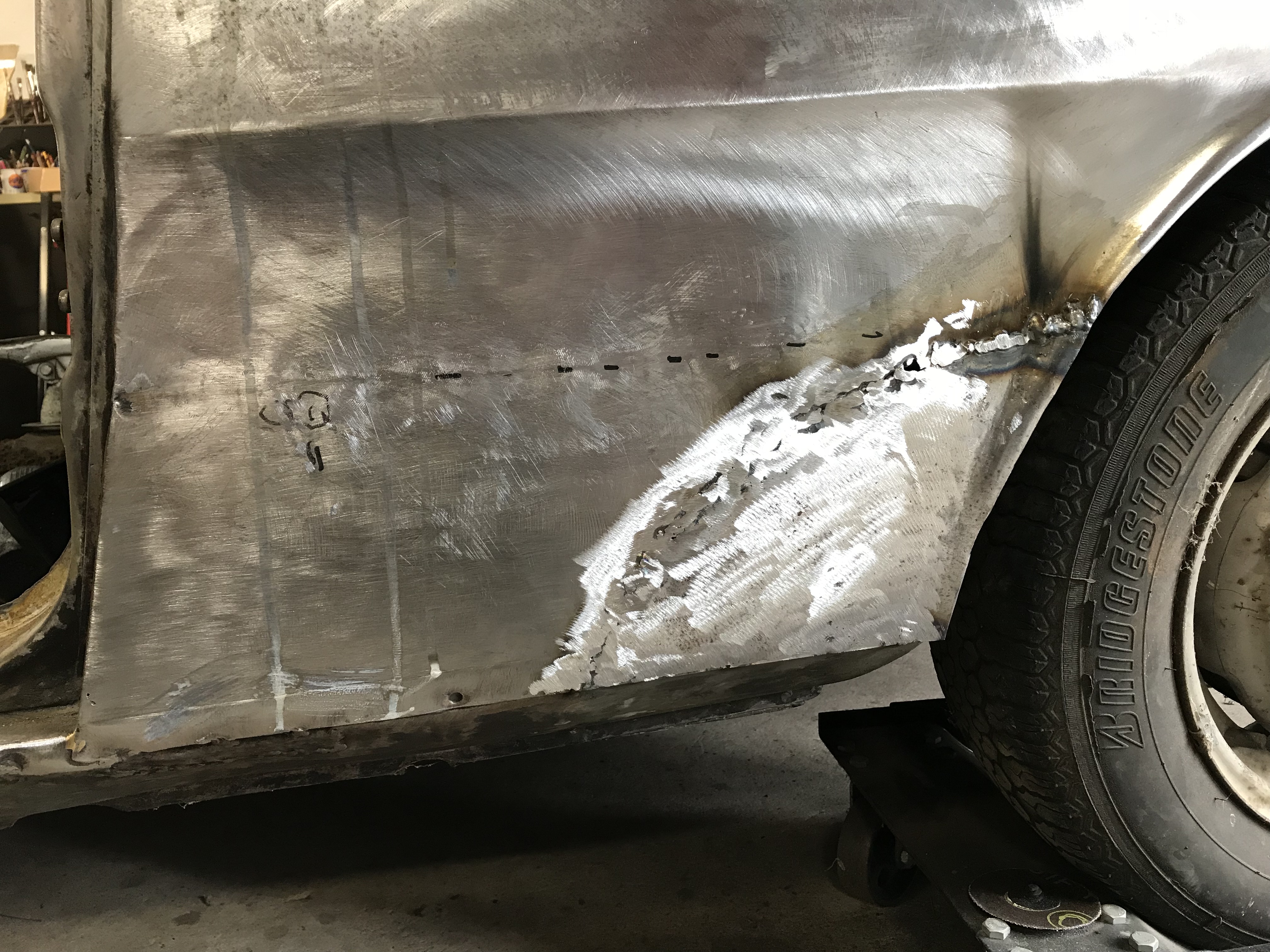

More metal cleaning today and rust treatment, ready for sealer.

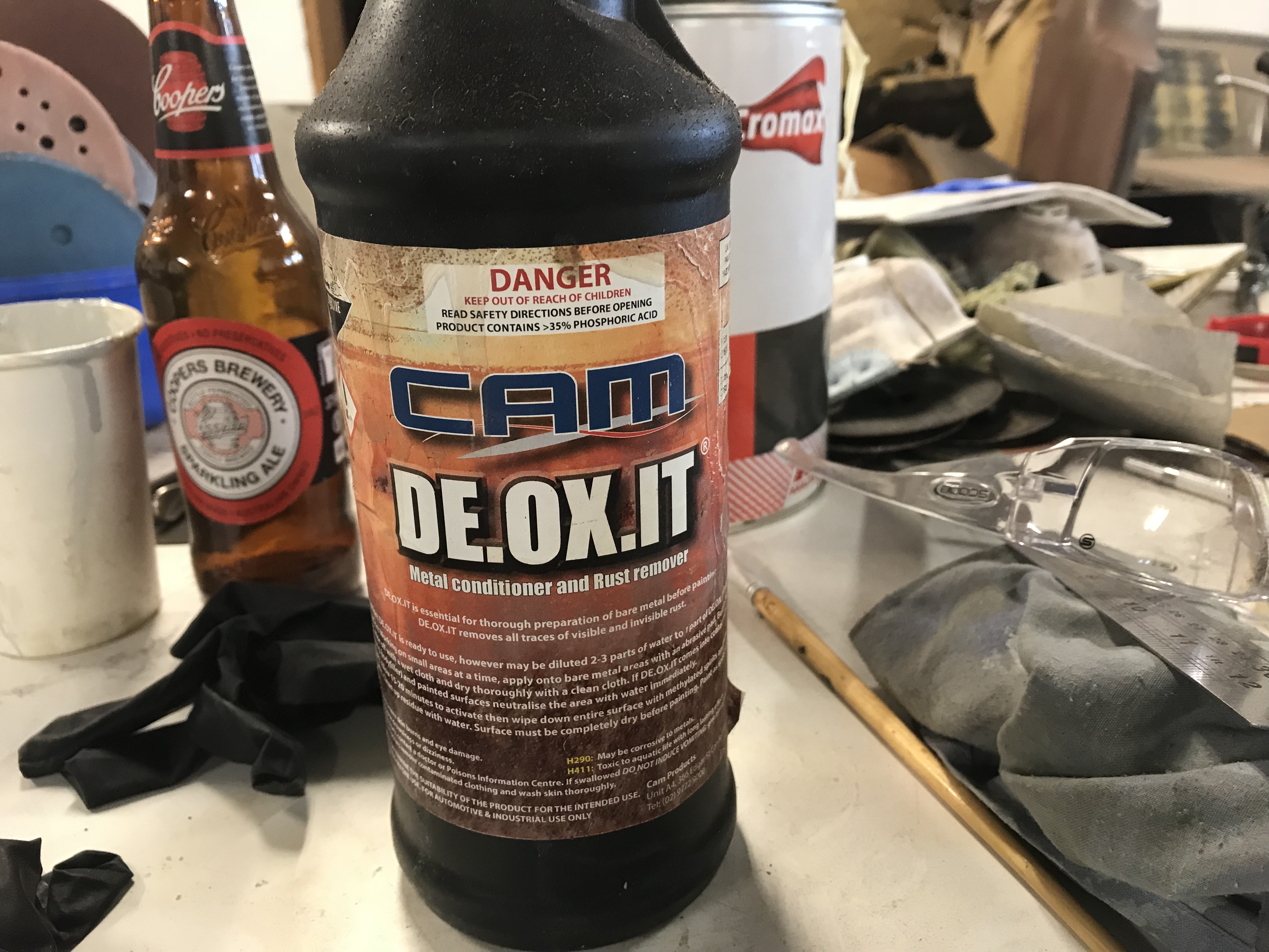

When you cleaned and treated the metal. How did you clean it and what is the product that you used.?
The reason why I'm asking is that I'm at a similar stage of prep on my convertible body.

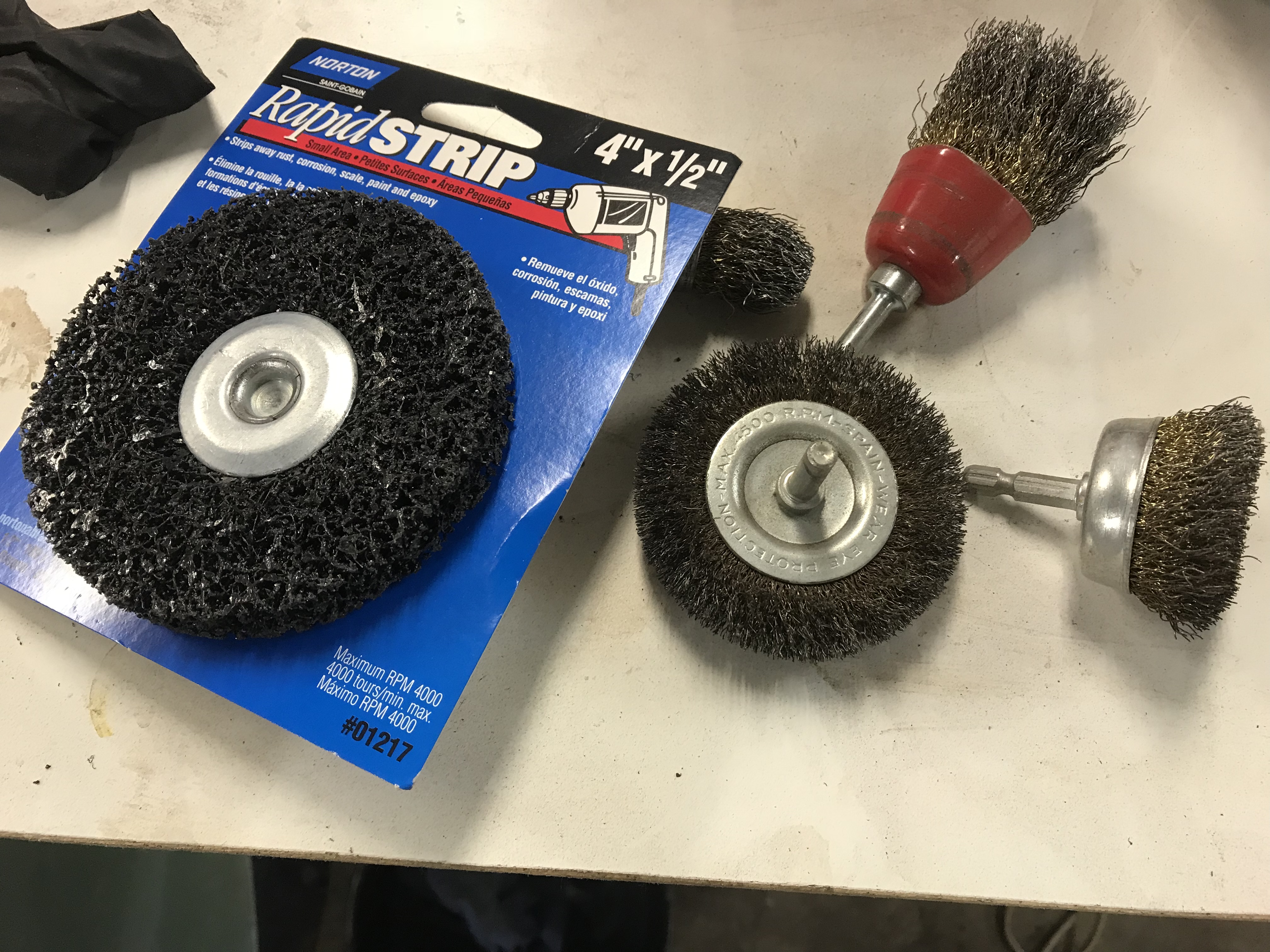

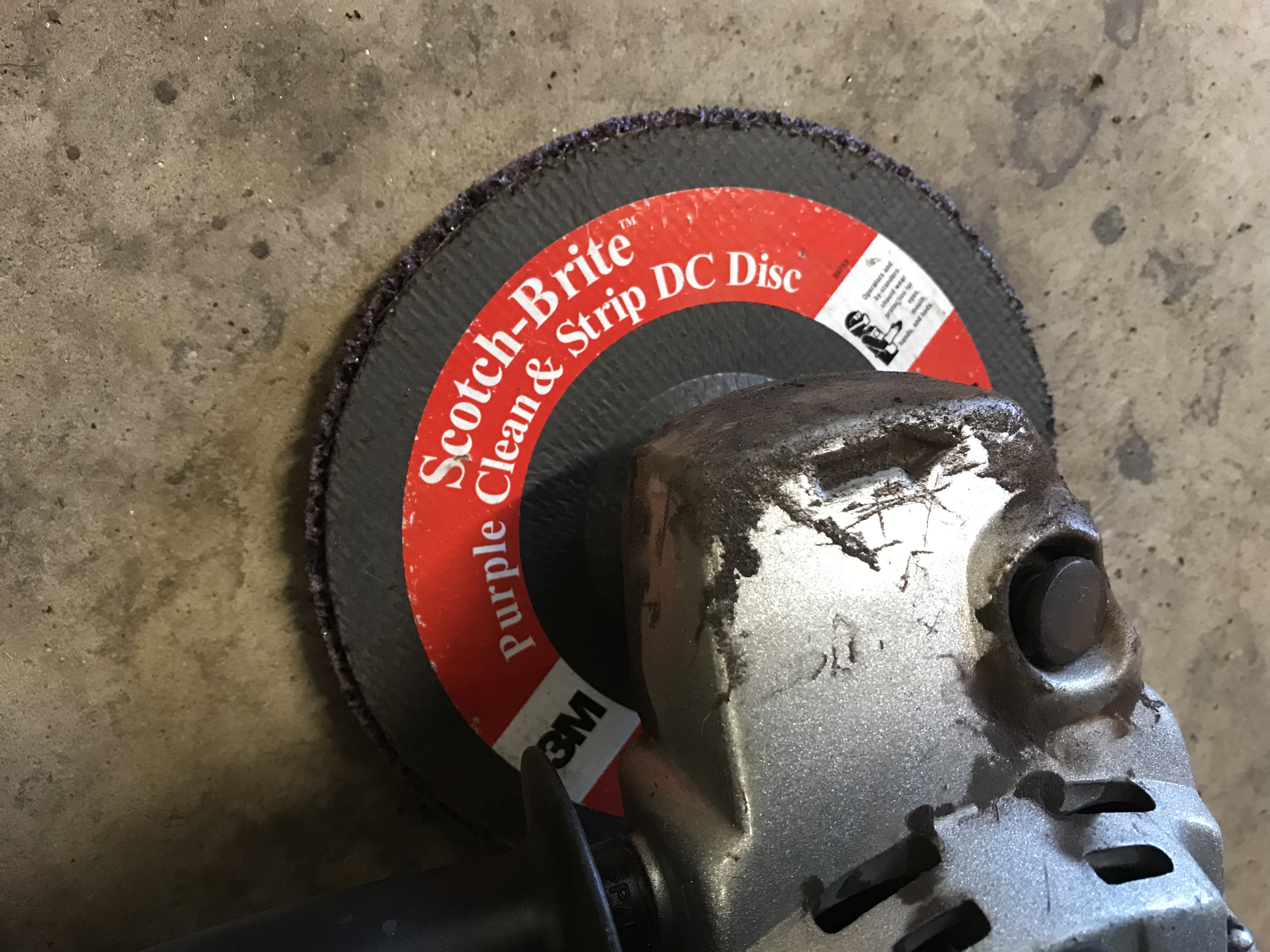

Cleaning metal started with combo of sanding discs, pads on sanders, grinders, wire wheels. Wire wheels good for getting into spot welds.
Rust treated with an acid rust cleaner, (wearing long acid proof rubber gloves)applied then rubbed into areas turning black with sandpaper.
Then wiped clean with a damp rag and dried immediately with dry rags. whole process repeated where rust still on metal. Some small bits of rust had to be removed with a die grinder.
If any acid is left on metal it will turn white when it dries. It needs to be washed off and dried.

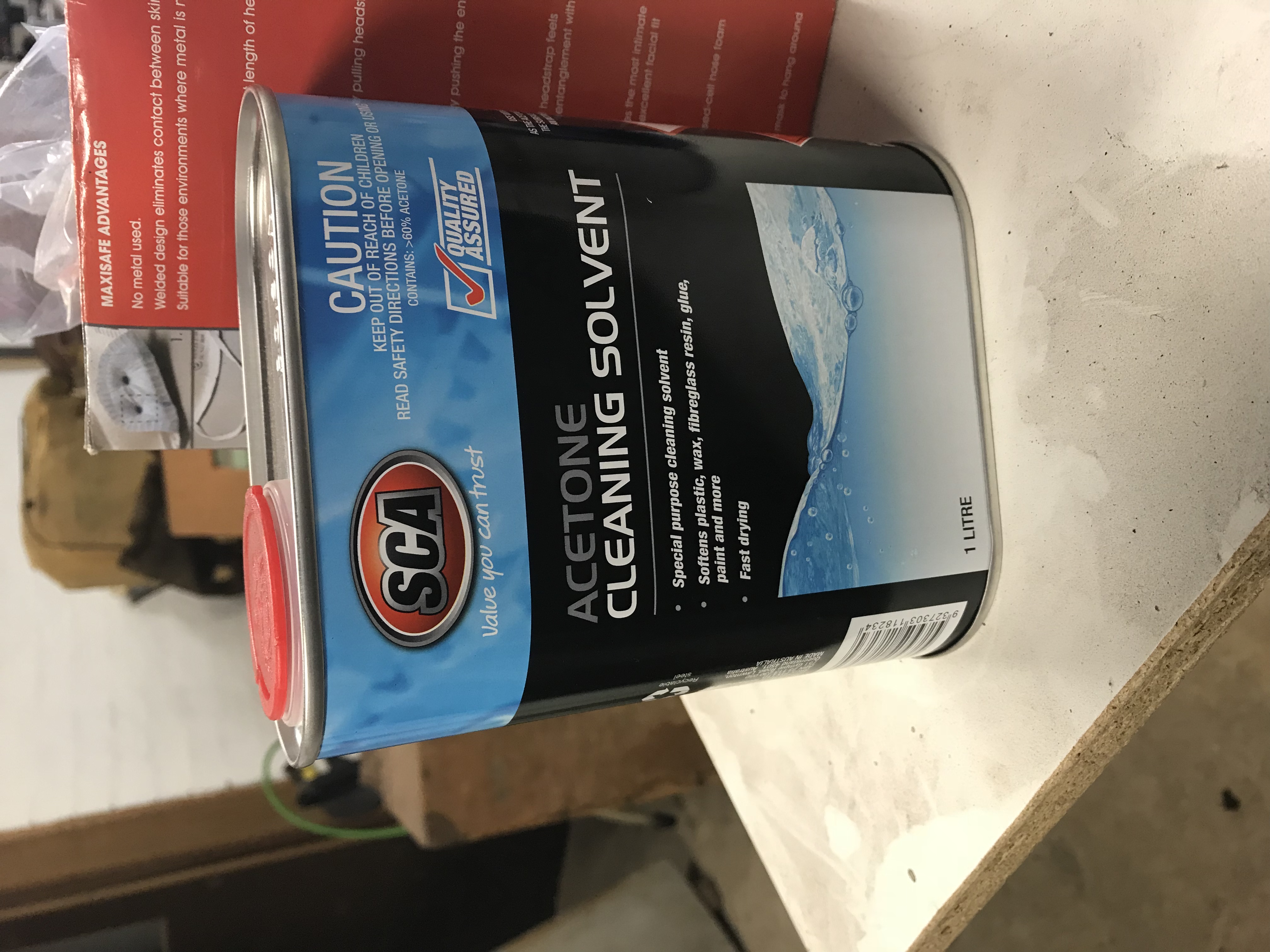

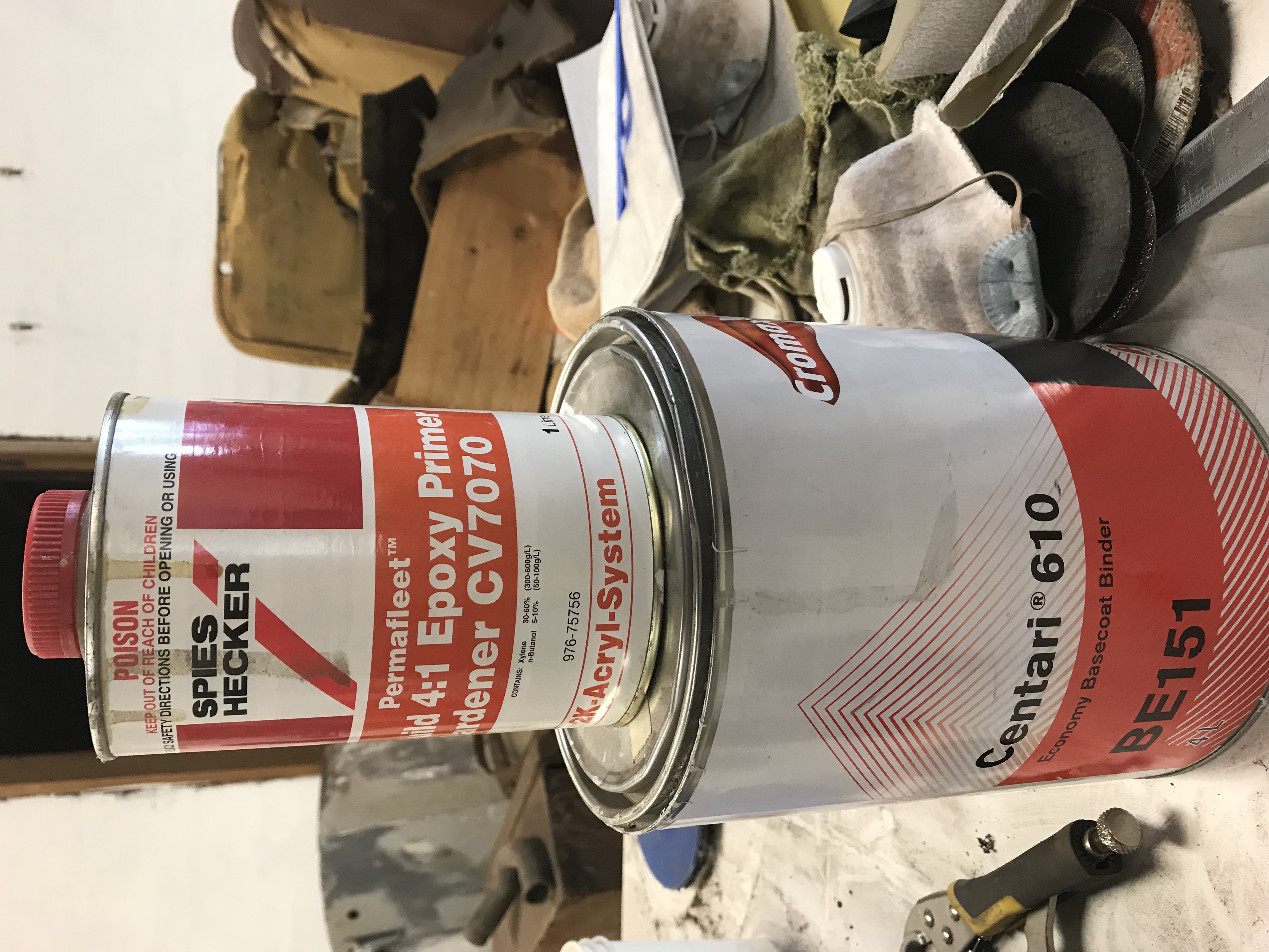

Where parts were left for a few days without sealing i repeated acid treatment before sealing and then cleaned metal with acetone then was sprayed with the apoxy coating.
I found that having as many different type and size sanding discs, pads, wire wheels as possible made the job easier.
Most of these products have come from a business called Crash Supplies in Adelaide, don’t know if that is a an Australia wide chain. I did get a few bits from super cheap auto parts but they have only a pretty basic range compared to a proper auto body repair supplies.

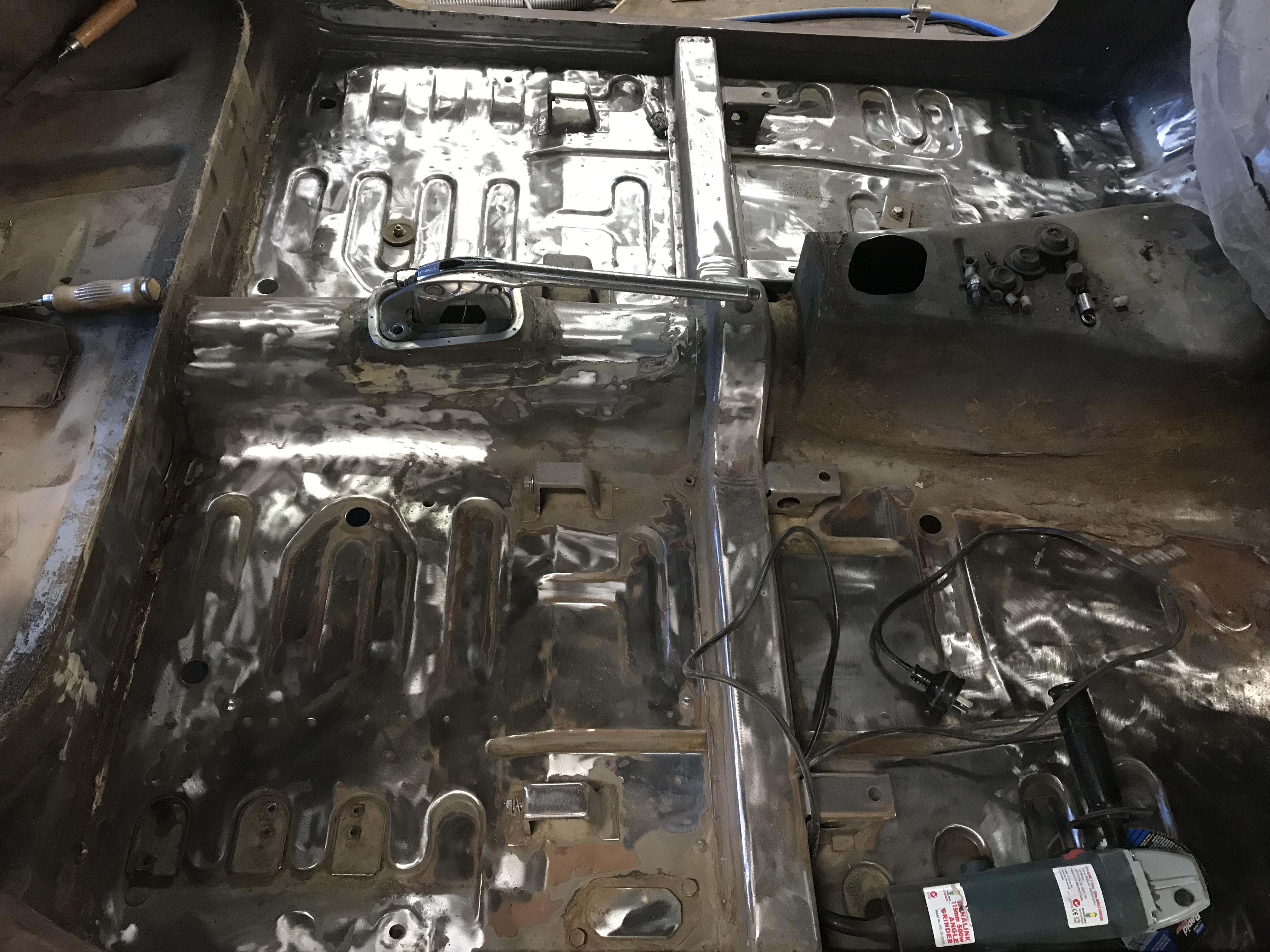

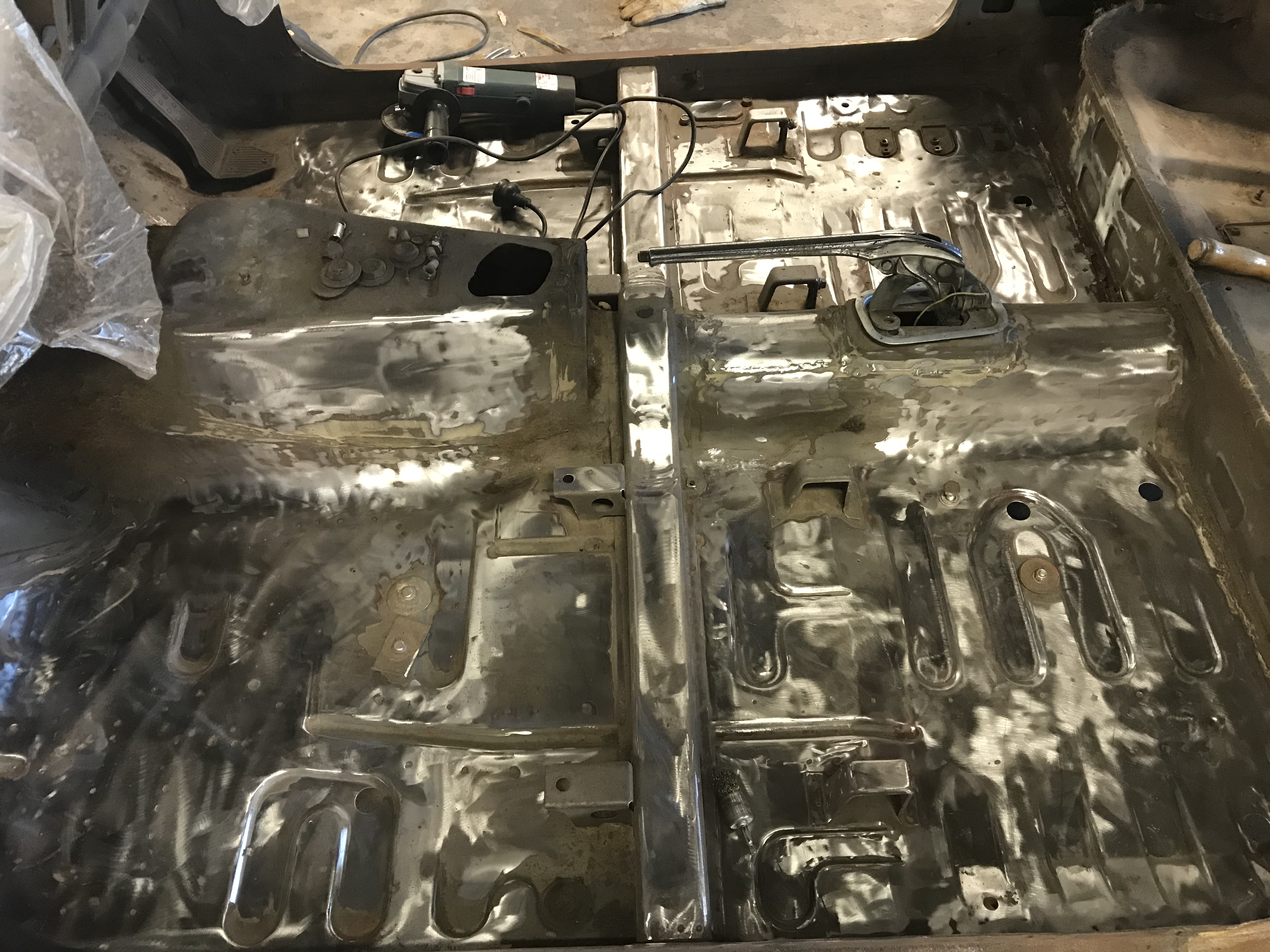

Just cleaning interior floor this weekend. This area and boot will take a few weeks so wont put any more photos up till thats done. Got sills folded by my friend Graham who is the one who is in charge of this resto. They will be going on in a few weeks.

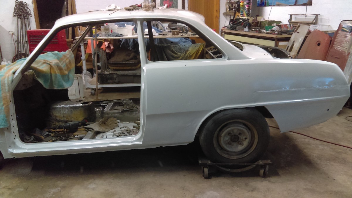

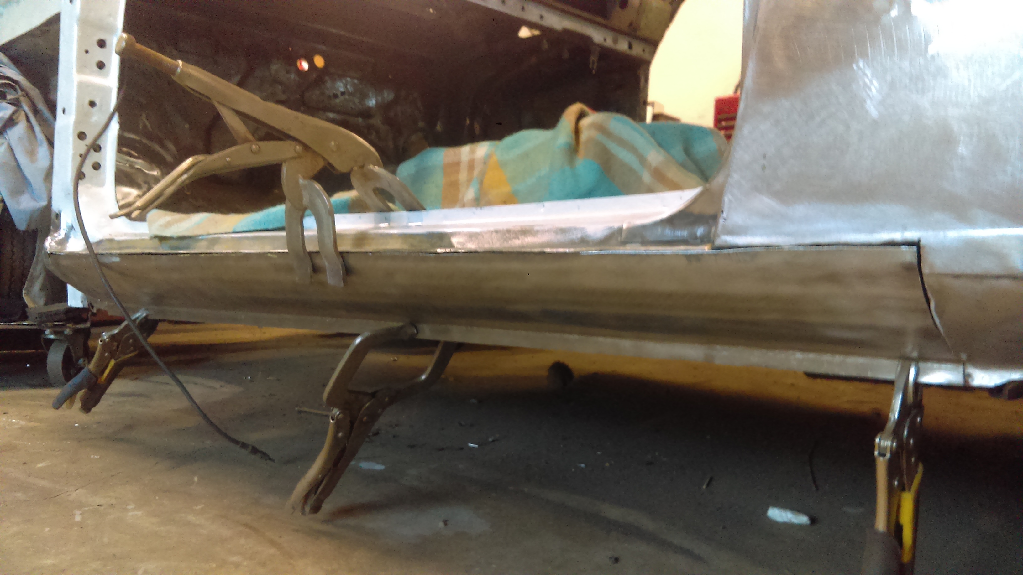

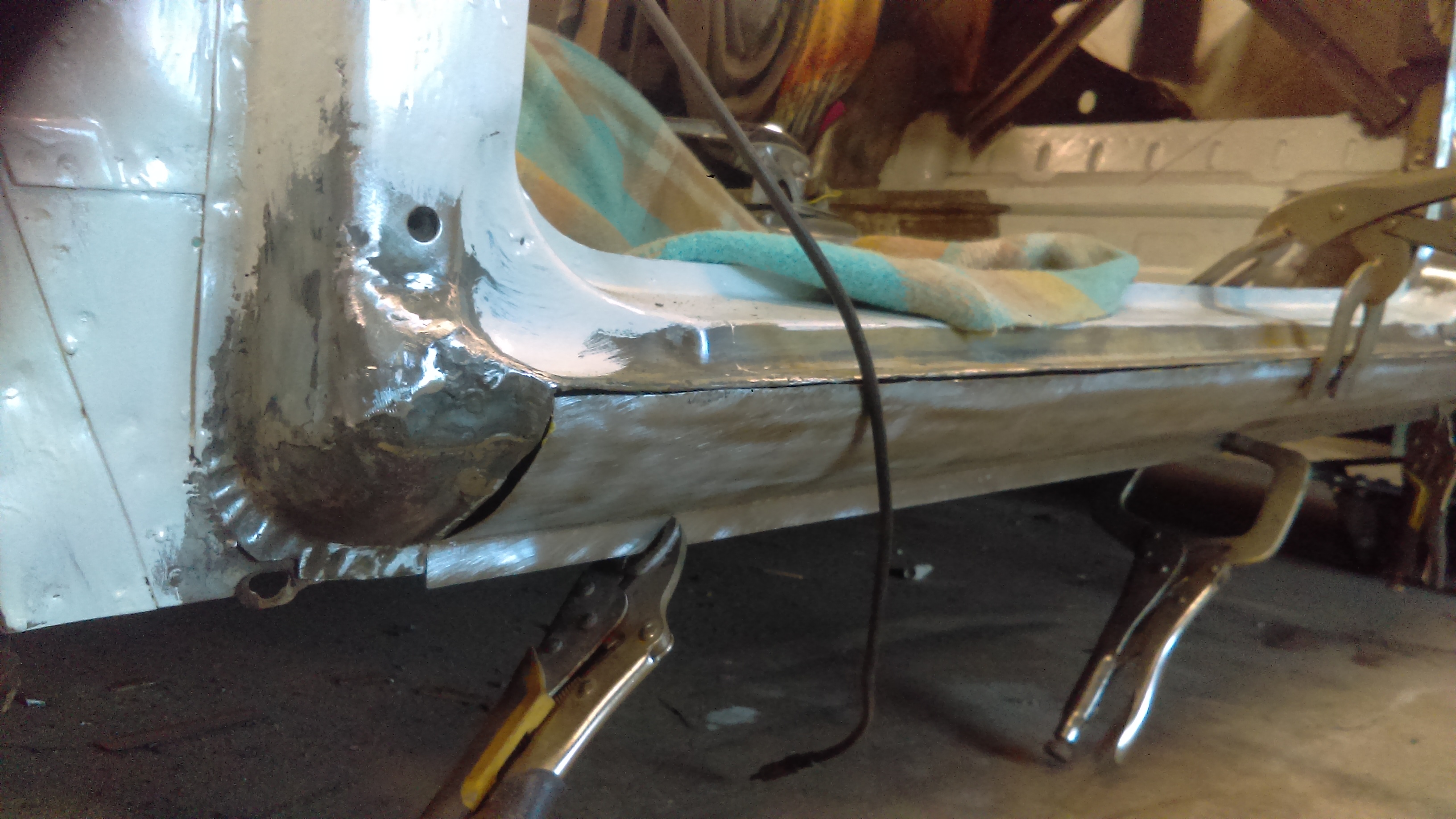

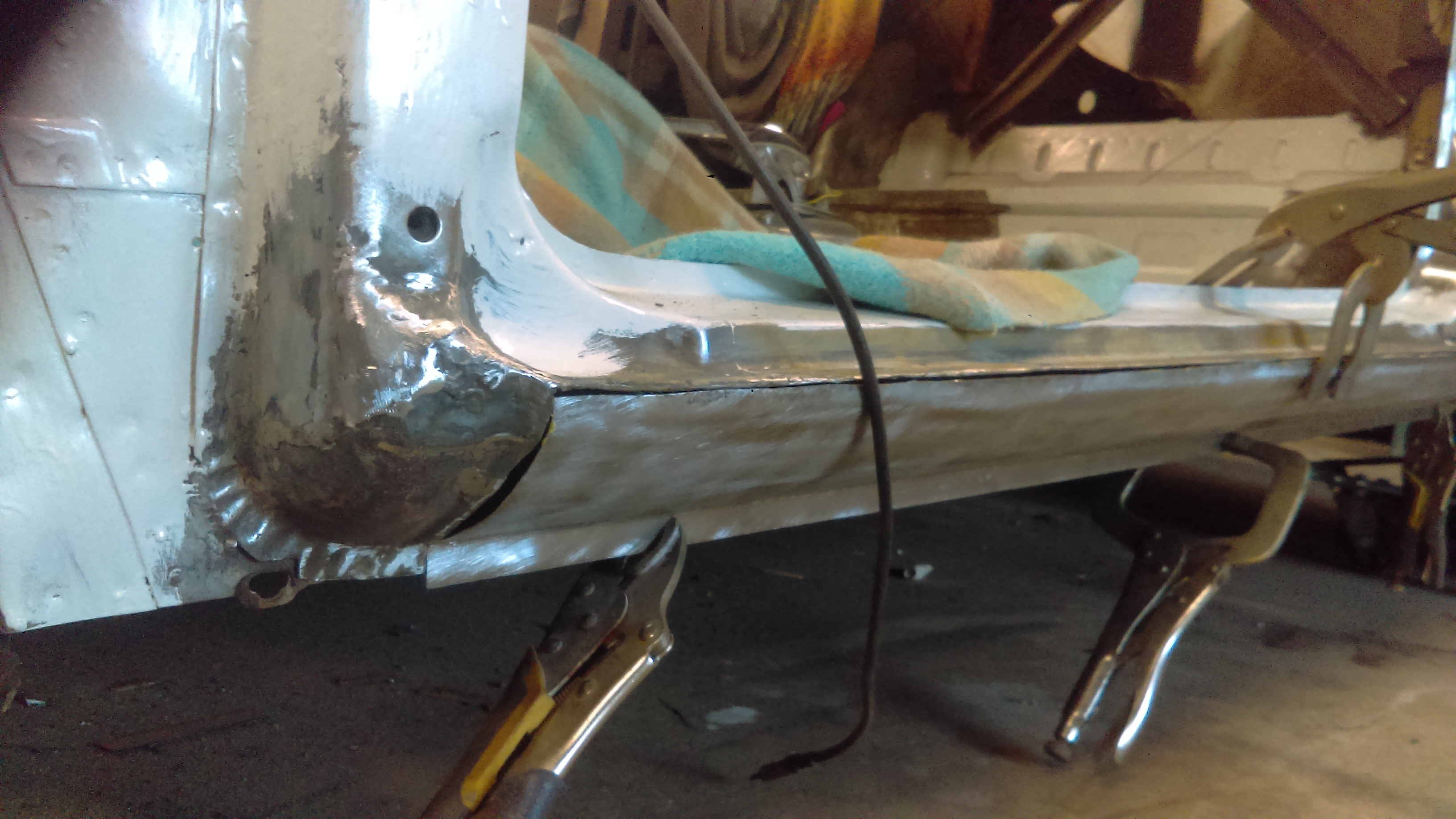

Bit of an update, new sills ready to weld in, rear end started welding on, lots of metal cleaning, apoxy sealing, more updates as weather gets warmer.

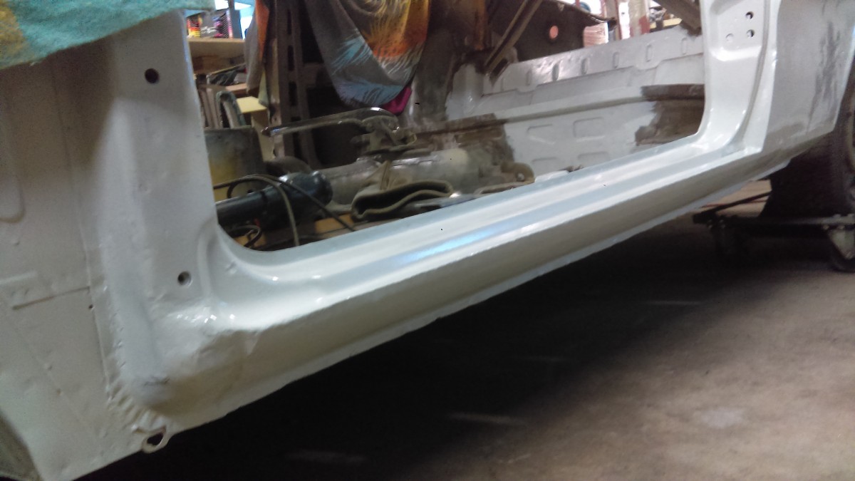

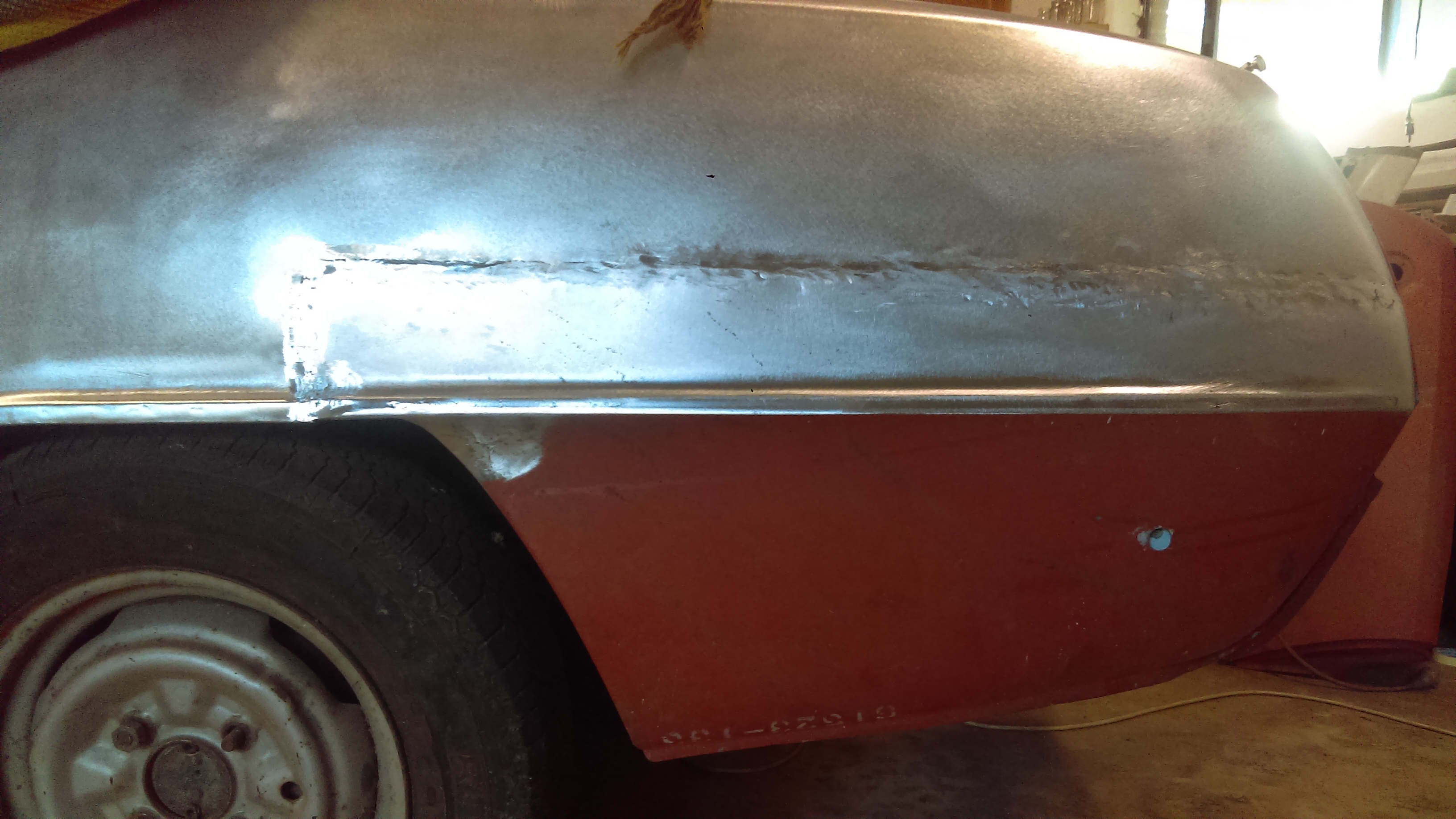

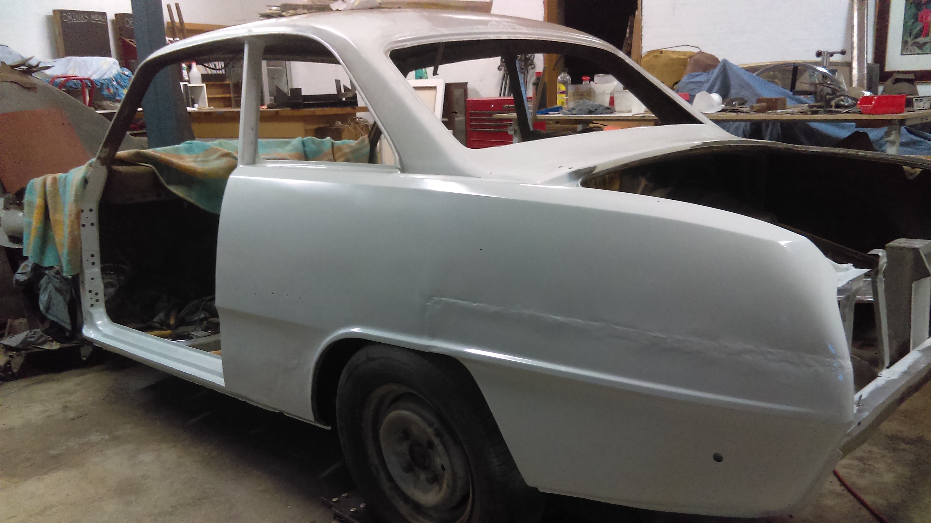

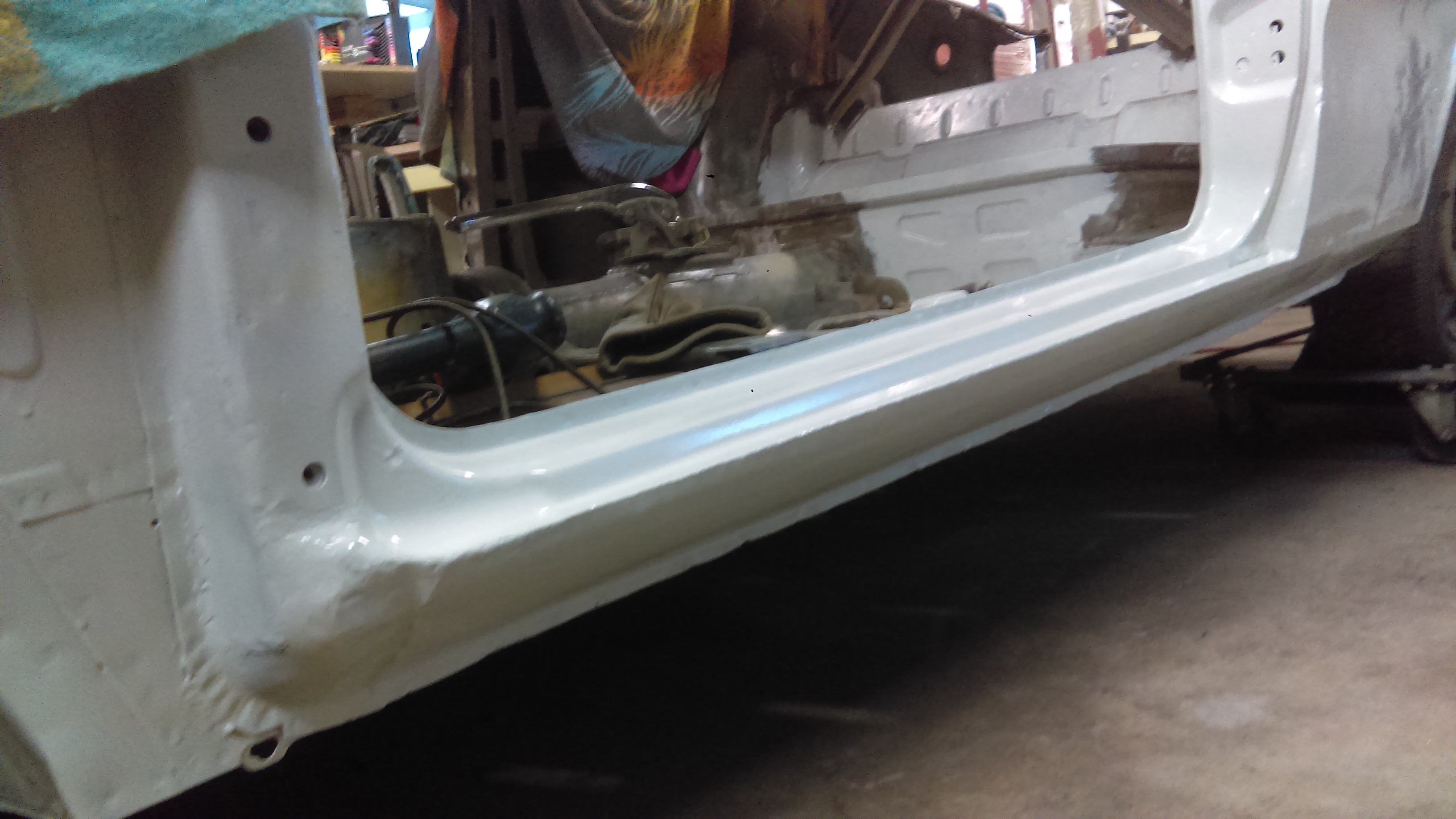

New sill welded and coated today, rear quarter coated. Will spend next 2 weeks finishing cleaning boot metal and interior floor metal before rest of rear end gets welded on.

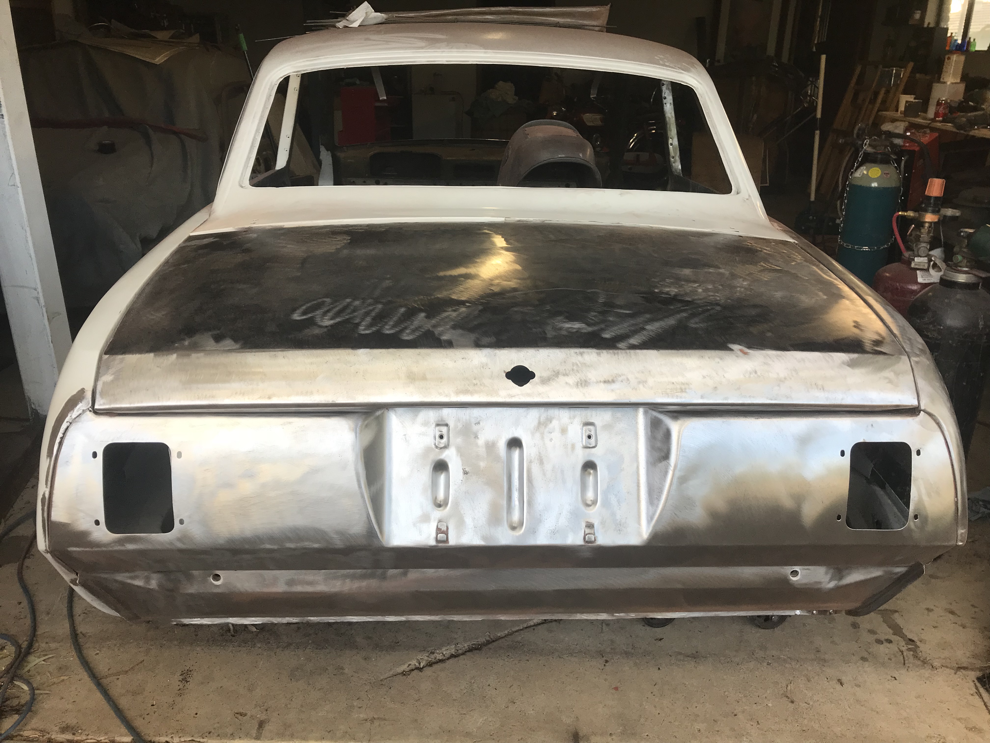

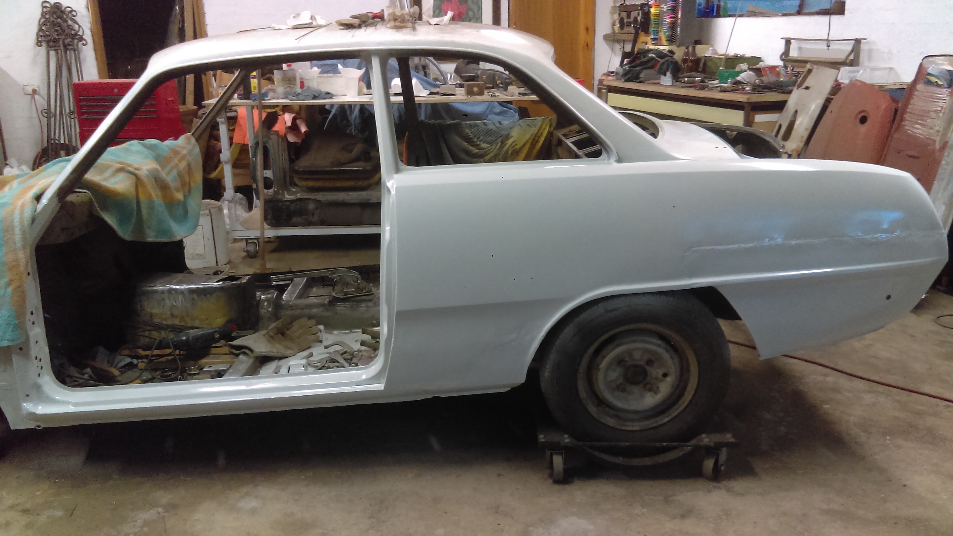

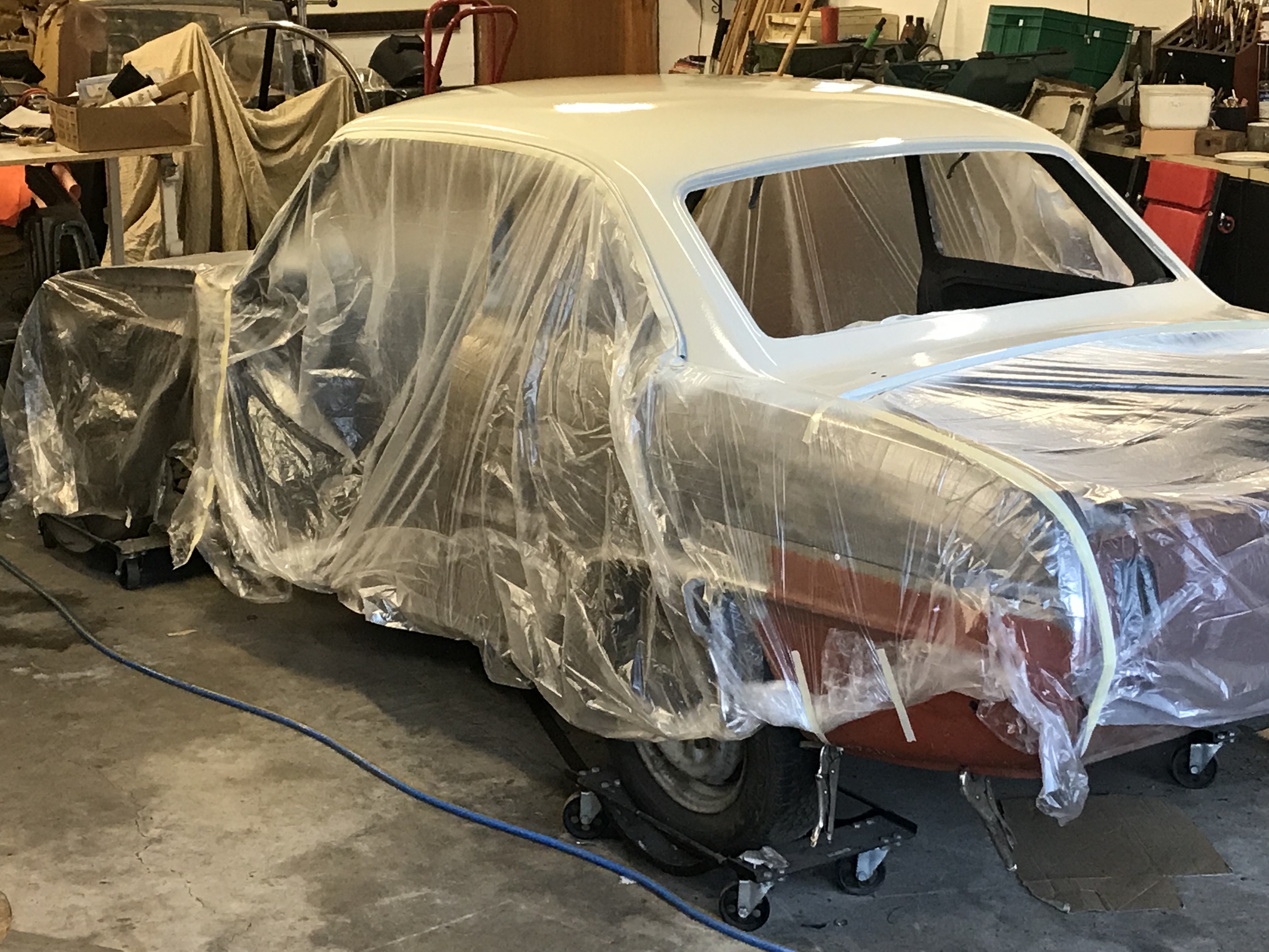

Rear end welding nearly finished, starting to look like something’s actually happening.
