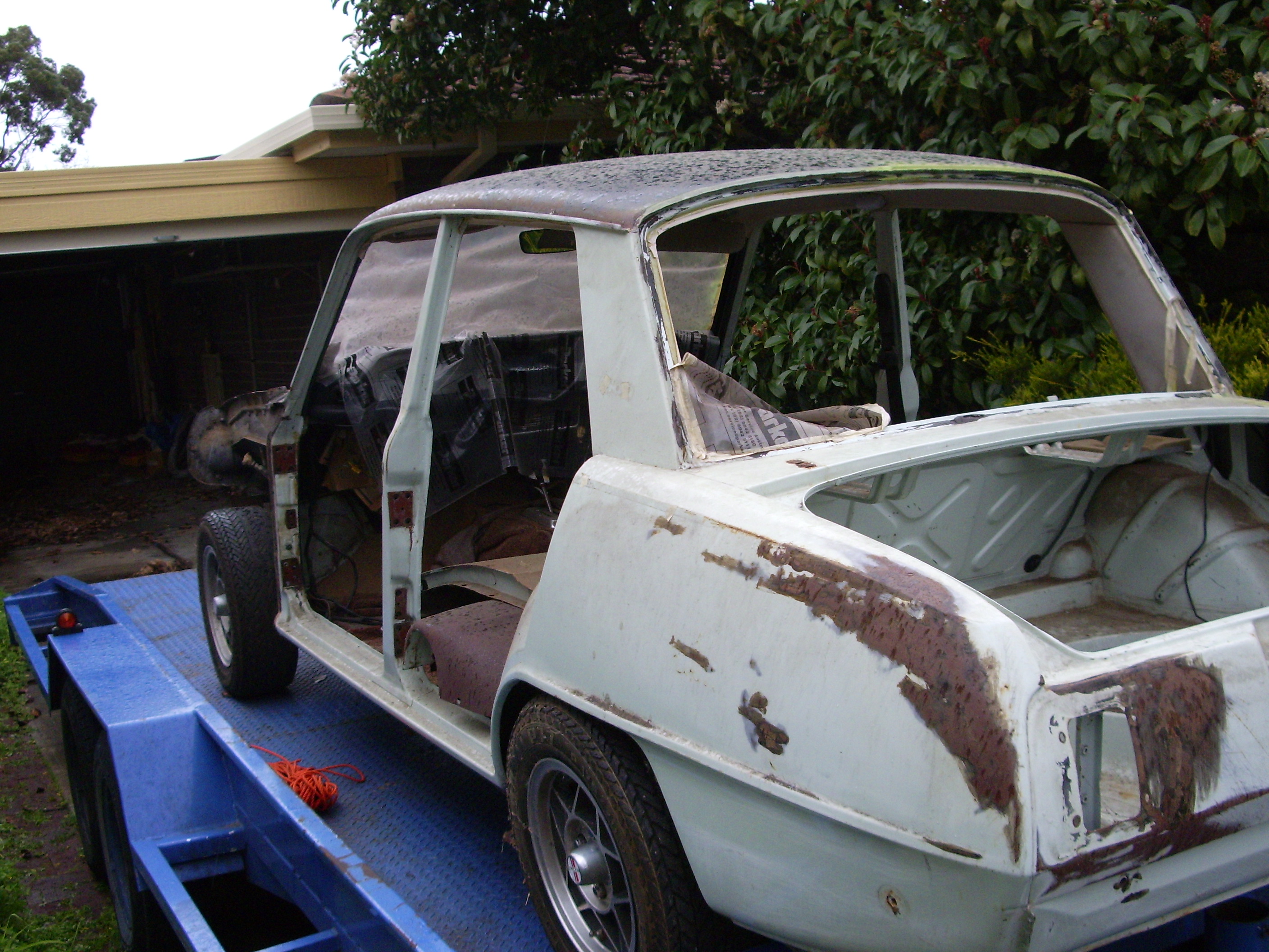

By the way,
The Li'l Darlin' used to look like this at one stage.
PR20 Auto
Fri Aug 05, 2016 7:28 am
:o :o :shock: Mate, what a transformation! I don't remember seeing her like that before.
I hope you get the problem sorted. You need to be cruising in her.
