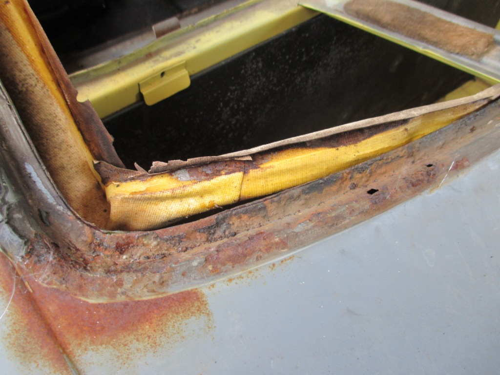

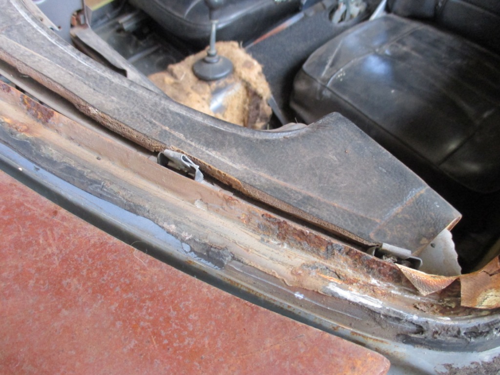

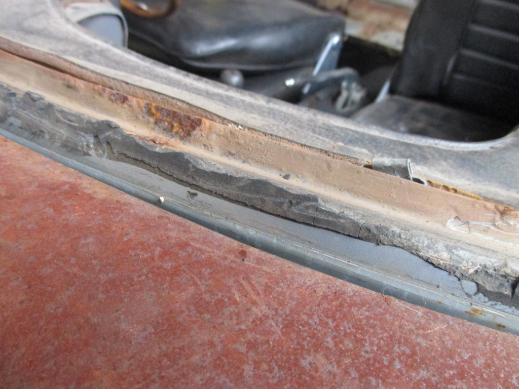

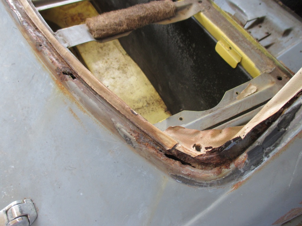

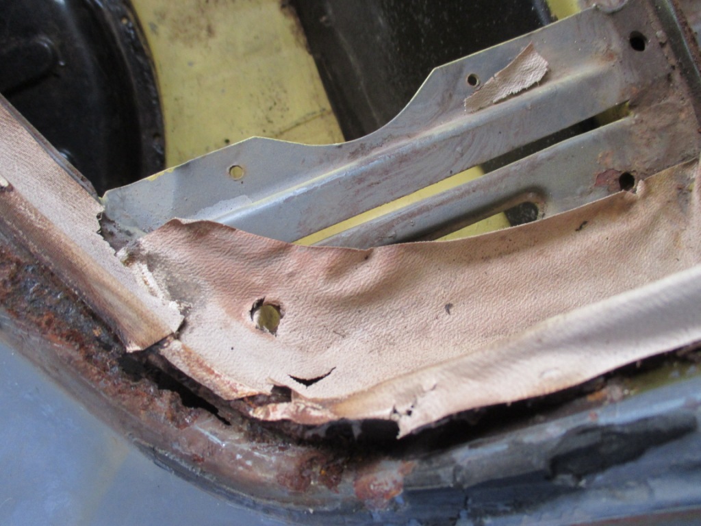

here are some pictures after the windows came out. Some of the original silver grey can be made out. Small amount of rust but nothing that cannot be fixed.

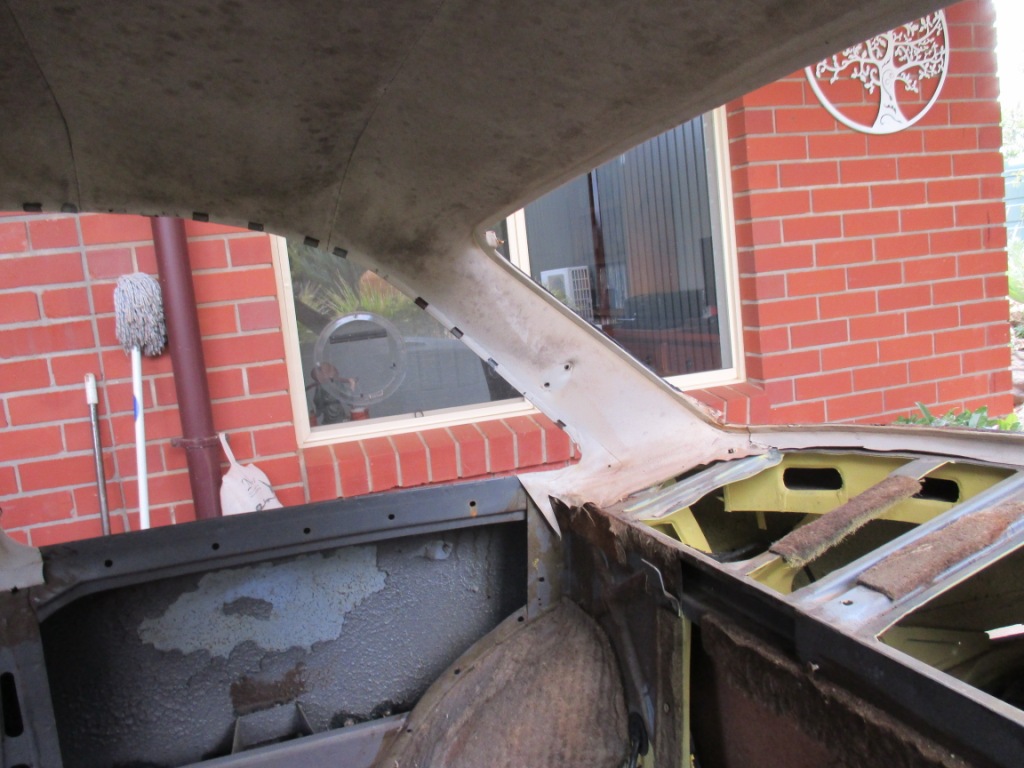

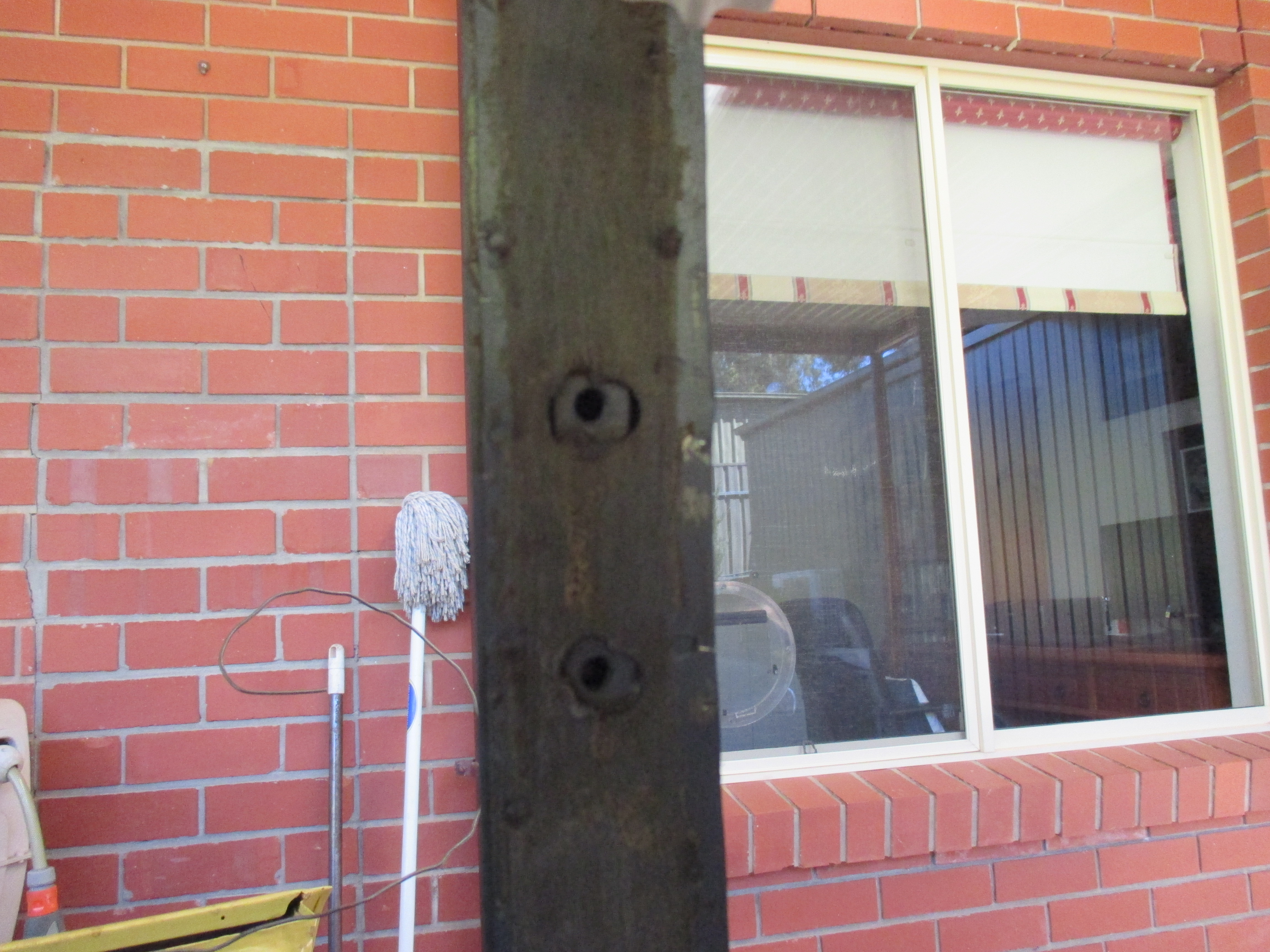

removed the hood lining today and discovered two holes with captive nuts in both B Pillar. These were covered over by the original trim, could they be for lap sash seat belts?

I've only known of 1 being there. Not 2. My first sedan ('67) had them in it. I didn't find out about them until after I wrote it off.
They look like, and I could be wrong, someone has been experimenting on the position of the top of the harness.
"B" pillar trim hides lots of things.
After the panel has been pressed the nut for the bolt is welded onto the inside of the panel and in production the outer and inner are welded together.
The hole for the nut is a lot tidier than that.
Thu Mar 07, 2019 5:36 am
I reckon Dave could be right. Holes have been "ovalled" out to let the nut slide in on its side then stood up. I could be wrong
too..!
Thu Mar 07, 2019 6:01 am
Posts: 76
That's really odd to have two positions. Maybe one for the Japanese market and one for exports. ;)
Besides I would've thought they were only lap seatbelts back then in the early models.
Thu Mar 07, 2019 12:54 pm
My thoughts are the bottom one an anchor anti the top one a loop, some 2 door yank tanks we set up this way ???

All seatbelt mounting nuts worldwide are 7/16" x 24 threads per inch. (TPI). UNF.

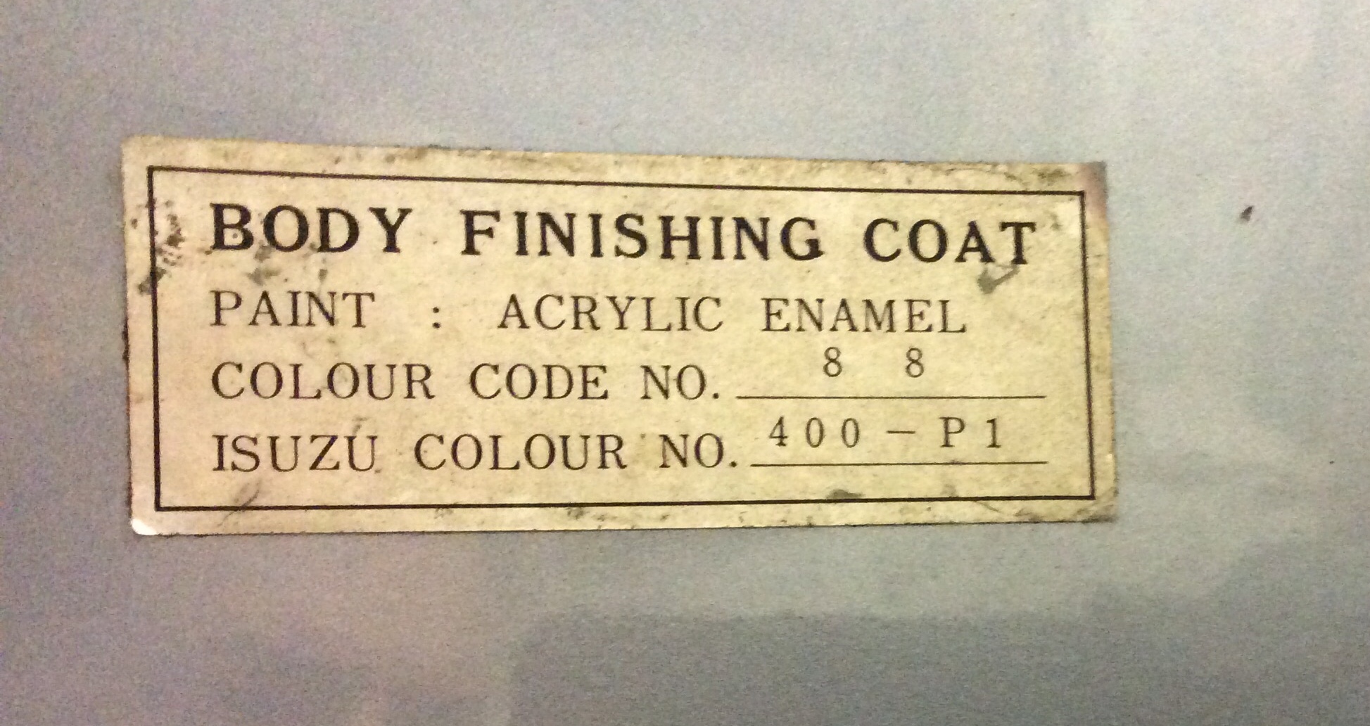

I have attached a photo of the original sticker under my PR90 bonnet ( that I carefully removed before its restoration in 1991 then reattached) showing paint code 0088 Silver Grey (as per the brochure of the 1967 Bellett Gt.. but same colours as PR90.....Isuzu White or Silver Grey)
It was repainted in Acrylic Enamel back in 1991 very close to the factory colour. I beleive the actual formulations for the paint codes were hard to find even back in the 90’s s, so a lot of matching by an experienced painter was done for our belletts and other Isuzu’s.
In 2011 after some areas of that paint job were failing and some bubbles appeared I bit the bullet and stripped the car of external bits then took it to my local panel shop who talked me into refinishing it in water based 2 pack. Not the best result for 2 reasons
1. The old repairs on a few panels, although isloated with the relevant undercoat still allowed moisture vapor to push through to create some bubbling in the flexible 2 pack layers.
2. The colour match of this 2 pack to the factory silver grey is pretty good in low light or the shade but under bright sunlight it does appear to be more silver.
I am still very happy with the even gloss finish it has after 7 years but I would definitely recommend to repaint yours in a solvent based paint .....steer clear of water based 2 pack!
I hope this helps. ;)

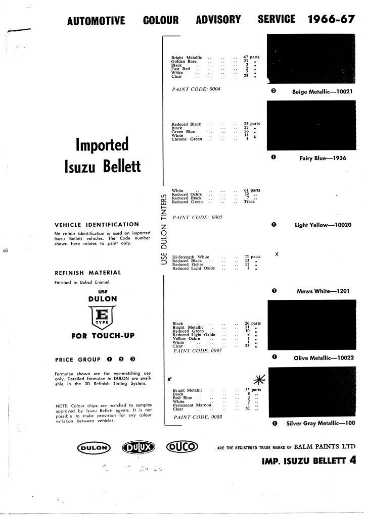

PAINT COLOUR MIXING
This is a very old colour chart with paint mixing details.
It may not be valid with up to date colour pigments but a good paint shop might be able to help.
