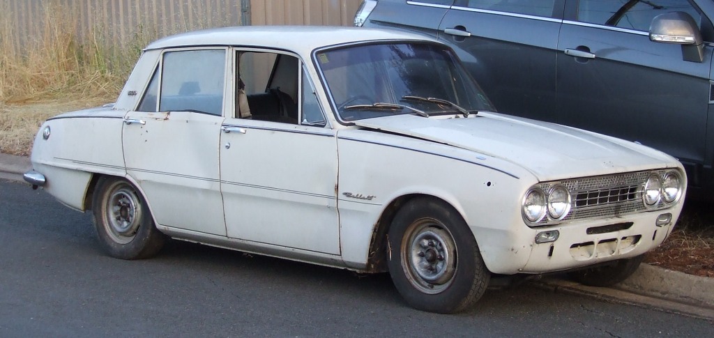

Well Bella's been on the road ... well for 5 minutes or so. Nearly there.
Ride height is absolutely awesome.
