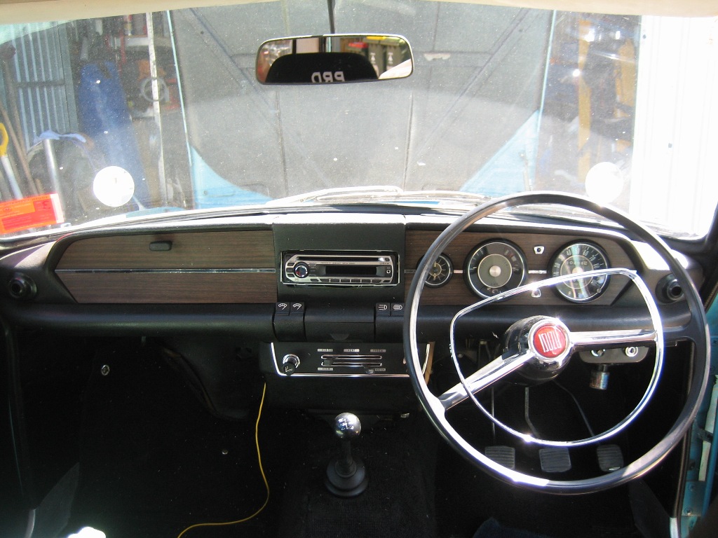

Hi guys,
Here's the dash photo that I promised from a previous post.
File comment: 1969 Deluxe dash photo
As you can see it has the older style wheel even though this is a 1969 model year deluxe. I recon that it has the '68 style spline which would make sense looking at AriNorjd's photo above. This has steering lock but the ignition is still on the dash like the older model.
Does anyone know what steering adaptor will fit the older hub? I've got a sports wheel here but I can't fit it as I don't have a boss kit to suite!

bellett65 is right.
early column splines are the same as RX4 and series I & II RX7.
the RX4 one is longer than the RX7, so the wheel is closer to you with an RX4 boss.
the wasp is the same as the early column. i have an RX7 one in my wasp.
late column splines are the same as TE gemini.
my race car has a late column in it. i put it in coz i already had the wheel for it that suited a TE.

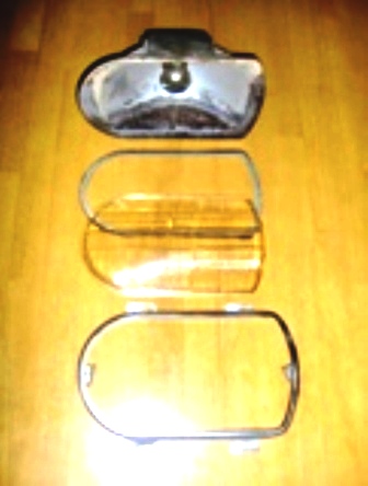

Square type headlight assembly for the pr10
Mark

BELLETTPR10,
Nice Pics on the breakdown of the "single headlamp" version. Of all the searches I have done on different flavour Bellets, the single headlight variety appears to be a rarity.
Oh yes, in answer to your question, Yes, this thread DID get sidetracked. This happens when people dont pay attention to detail.
