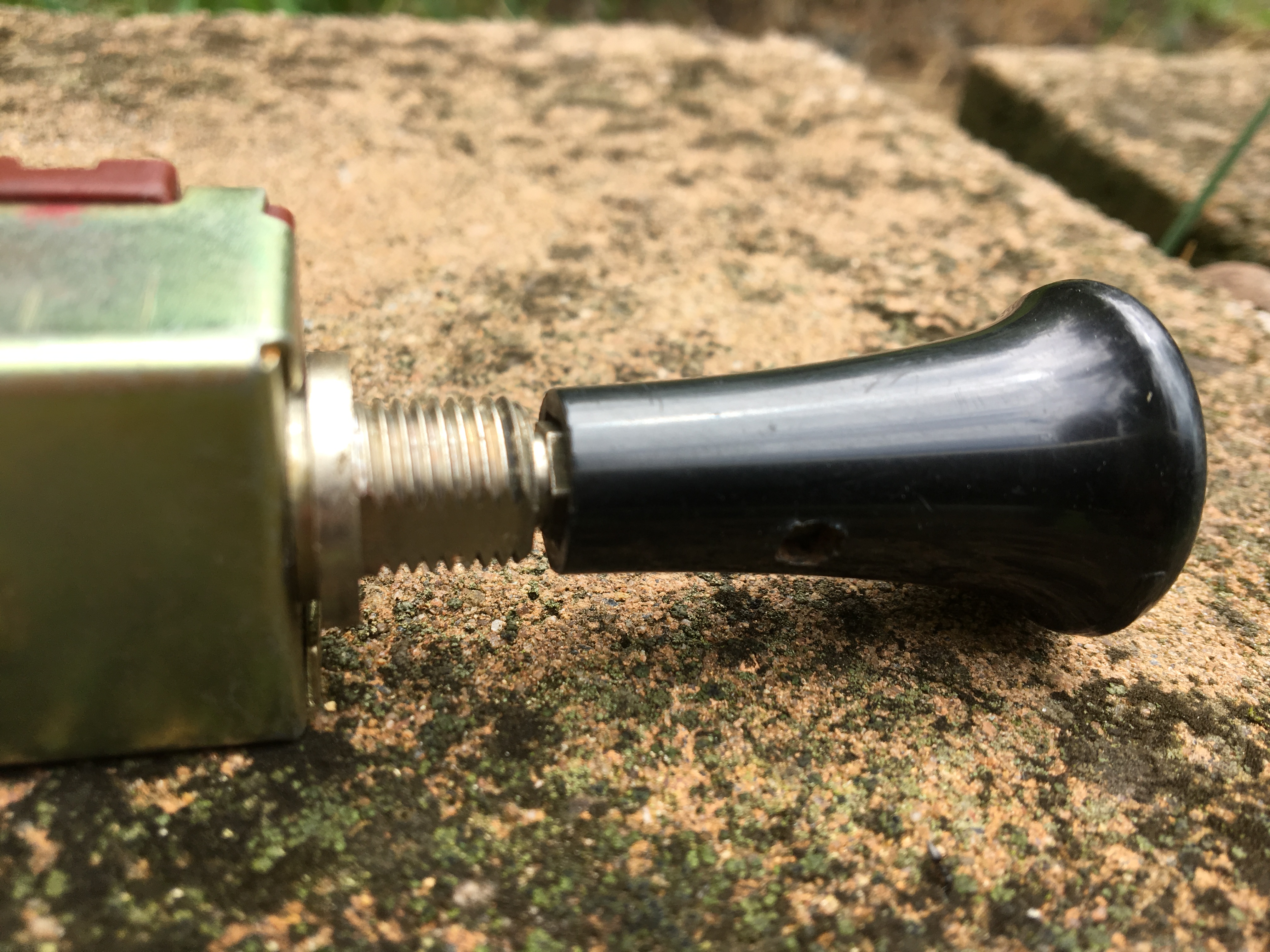

How to remove the light switch plastic knob? There seems to be some kind of a brad in the knob, but I couldn't figure out, how to remove it.

push the little button on the side under the front of the switch I will take a photo tomorrow for you all is good ..cheers dave

On the bottom of the switch knob there is a small pin that holds it on. Just press a fine tool ( screwdriver or drift etc ) into the hole and gently pull the switch knob out. Unscrew the chrome ring and the switch will pull through the dashboard toward the front.
Hope this is a little more helpful.

The push in clip is the same on the wiper switch. A nail or sharp object. Pushed in and wiggleda bit then as abivescew it out cheersdave

as warren said push into that hole and pull off the plastic piece with L see how you go on it

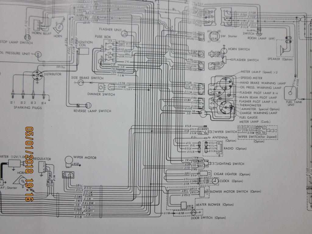

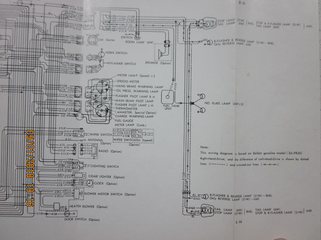

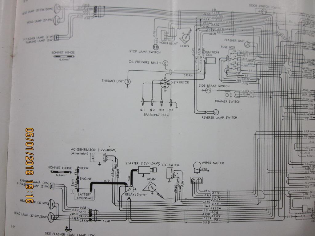

Problems keep happening with the electricity. The light main switch is in bad shape, it keeps going hot. I think I need to connect the lights through relay, otherwise the switch would burn down sooner or later.
Could anyone share the electric chart?

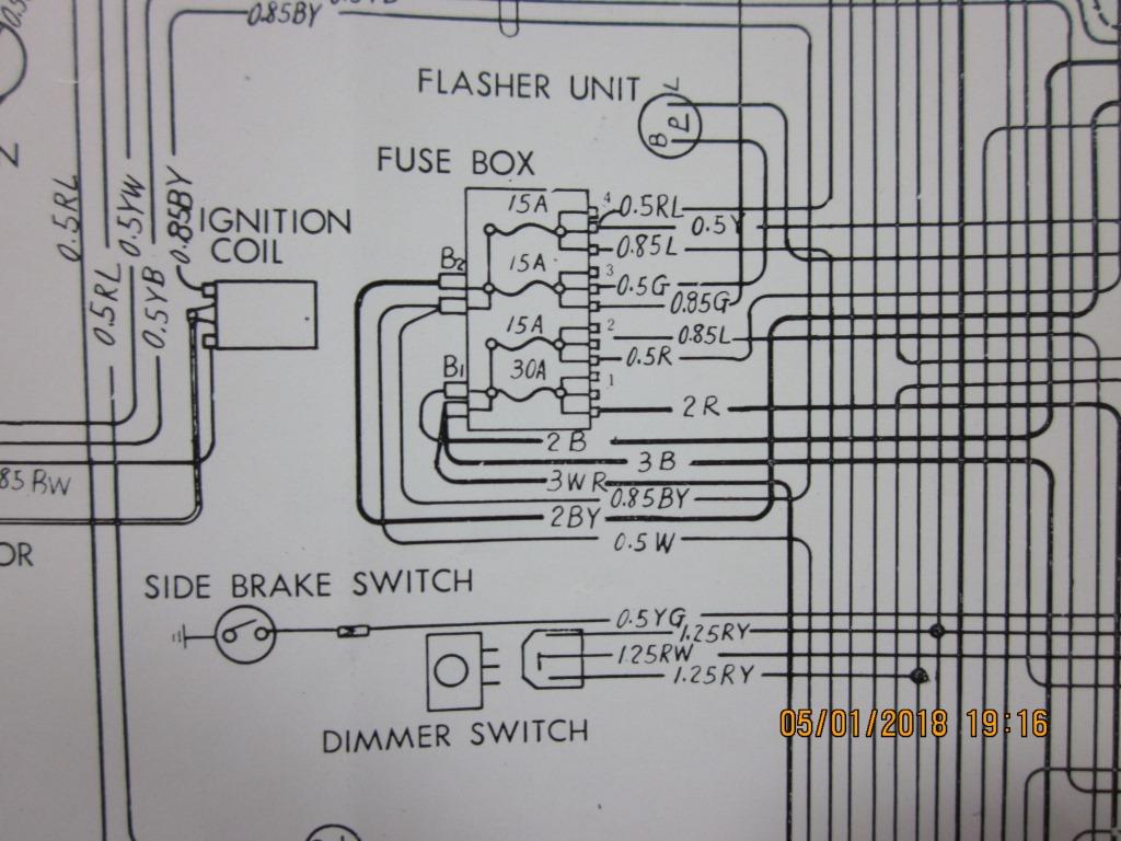

And also - what are the nominal amps for fuses? I don't know if I can find same size fuses (6,3x30mm?), but I suppose they can be replaced with 6,3x32mm. One of the fuses seems to be original, 52 years old and working. It has some kind of Isuzu logo inside.

Thanks for the wiring diagram, got what I needed.
Yesterday I completed the electrics, needed some modification. Brake light switch is broken somehow, seems to connect with the ground. After a while, I gave up and added a button beside brake pedal.
As the light switch is also worn and kept getting hot, I connected lights through relays. Both, park and driving lights. Also another relay for all the additional devices - Window washer, maplight, sockets etc. Everything but parklights are driven through ignition switch.

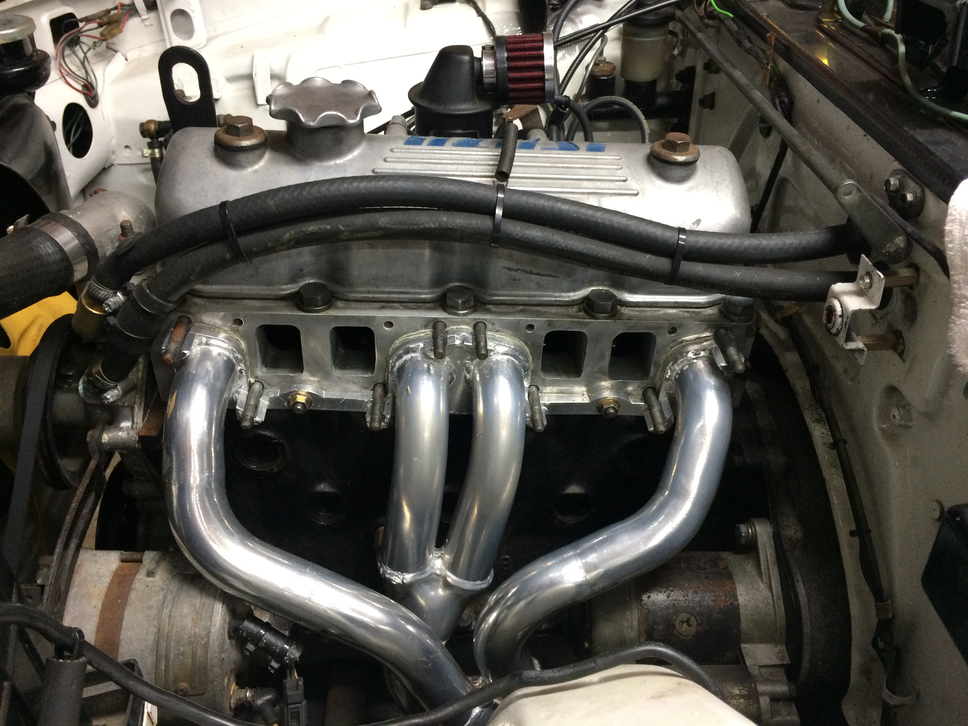

Hi from Tasmania
Well we are the coldest state here in Tassie though nothing like you so I run a constant flow through my heater
As you can see in the photo with carbies removed
Top hose return to thermostat housing on head
Low hose feed to heater from water pump
Traditional there is a manual turn brass valve at the head
Some remove and retro-fit an inline valve either manual or cable operated
Regarding levers I just move till I get what's needed where needed
Cheer
