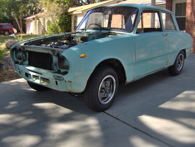

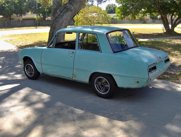

It was a great day to work on the Bellett!
Later
Mark

Sun Oct 25, 2009 7:17 pm
Those wheels look really neat.
Sun Oct 25, 2009 11:48 pm
Looking good with the wheels back on and the chrome trims :)
R.

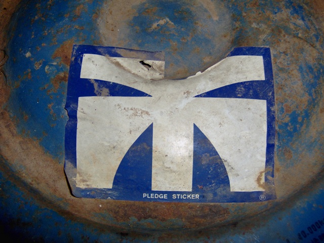

I found this interesting, a pledge sticker on the air clearer,maybe put on at a service station in Japan?
Later
Mark

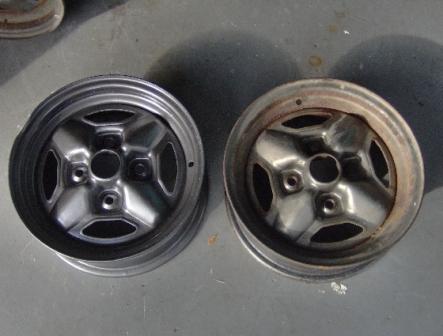

Sat Jan 23, 2010 11:26 pm
BELLETTPR10 wrote:
Hey all, the steel wheels dont have any manufacturers markings but were tagged with these stamped markings, HK325JX133.2 74/11
Thanks
Mark
I'm pretty sure those are mid-1970's Toyota Corolla rims (particularly the 1600cc Liftback or Coupe models). Didn't know Toyota and Isuzu had the same stud pattern.

Sun Jan 24, 2010 2:16 am
Posts: 54
Re steel rims. I have one in the boot of an imported 117. The car is very original. However, it is not the same as the wheels on the car so who knows what its origin is. The numbers on mine are; 5Jx13 32 78/7. Apart from that there is an N stamped on the front and a little lug about two matchsticks wide and 2cm. long welded to the rim just right of the valve stem hole. A.J.
Sun Jan 24, 2010 6:05 am
Duane
Confirmed...1976 Toyota Corolla SR-5 1600 (US market), also on Corolla Liftbacks here in Australia.
Sun Jan 24, 2010 6:35 am
Posts: 211
Location: Florida
Thanks guys for the input on these wheels,I was really trying to determine if they were "Bellett" wheels or not, since the only ones I ever saw were also on a Toyota from a car trading site, and mine are opp.of the 117 AJ described, four of these steelies and one plain standard Bellett steel rim in the boot. :)

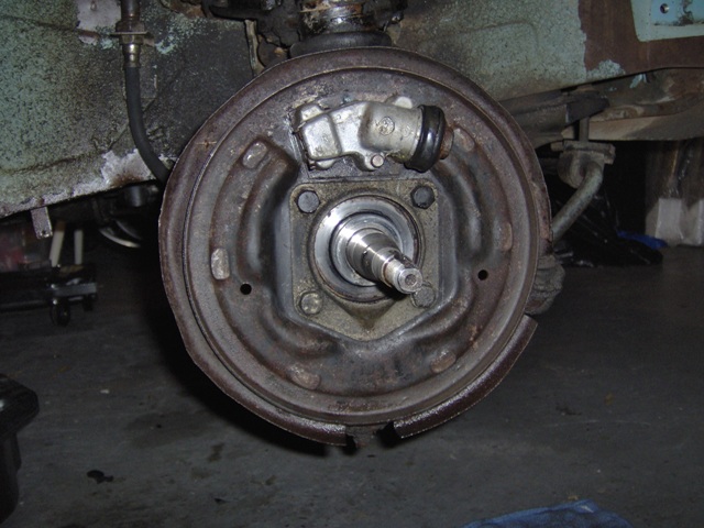

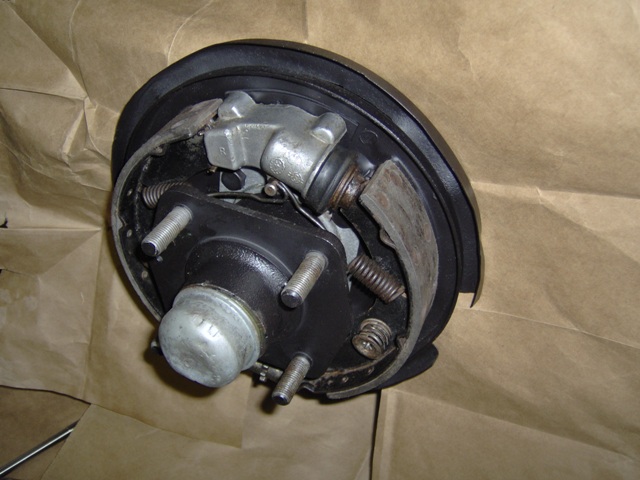

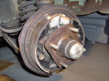

This is where we are now and appreciate everyone's input on the wheel and bearing issues and concerns from other posts here, quite helpful.
For more Bellett knowledge and trivia the wheel bearings,races,and seal on the PR10 is the same as other models:
Koyo Brand
1988/1922
LM11949/LM11910
CR17910
Mark

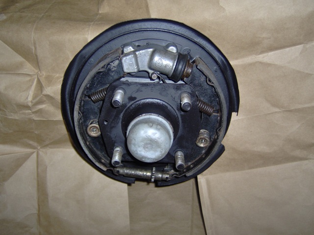

Brake Rehab
Thanks
Mark
Those wheels are from Toyota GT's models...Corolla, Celica, etc. From 1973 to 1983.
GREAT Isuzu :)
Wed Aug 25, 2010 6:16 pm
Posts: 211
Location: Florida
Hi Earthp
It is interesting and left me wondering how those wheels ended up on this Bellett. I have only been able to track this car back to it's last owner and he is deceased ..... :(
most of us here lack the history on these cars that exsists elsewhere.
Regards
Mark

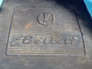

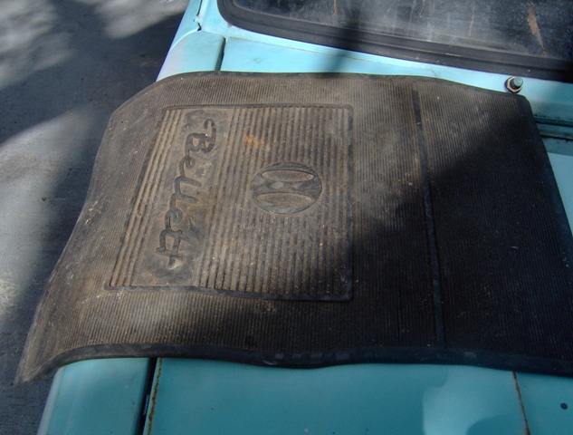

When I cleaned out the car I came across this single floor mat, was this a common accessory?
Mark
