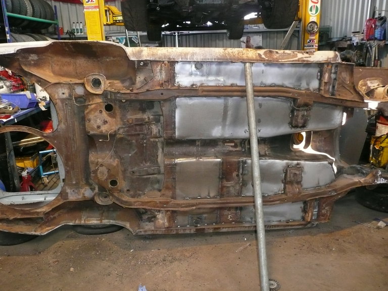

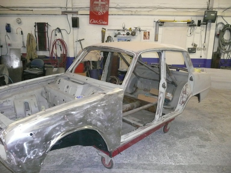

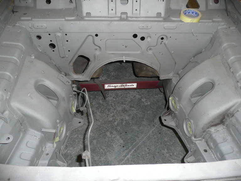

Few a more pics of the build, first is a bit of flooring, and then we've finally made it to the sprayshop.
