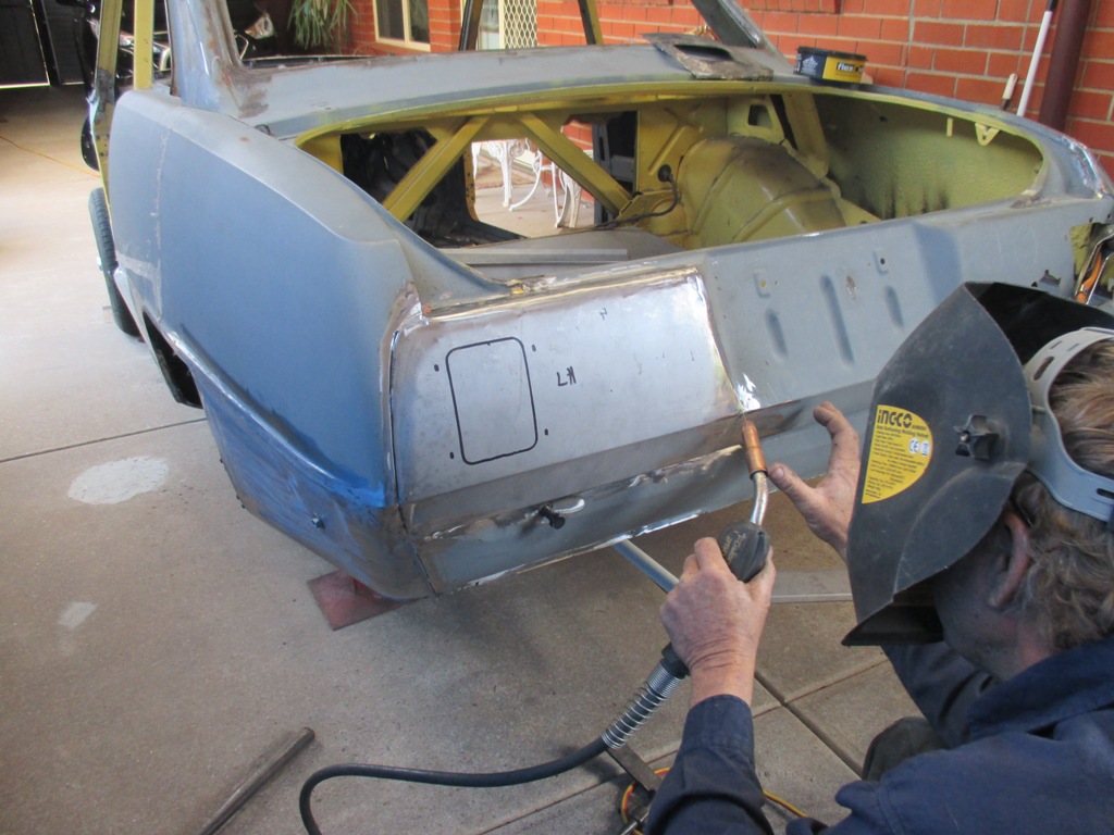

Another PR90 resto
Posts: 113
Location: Gawler SA

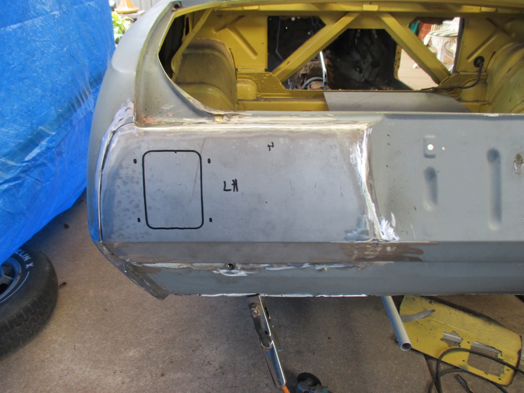

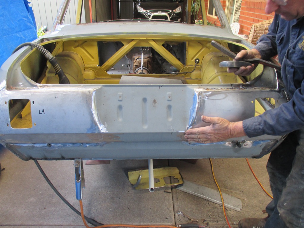

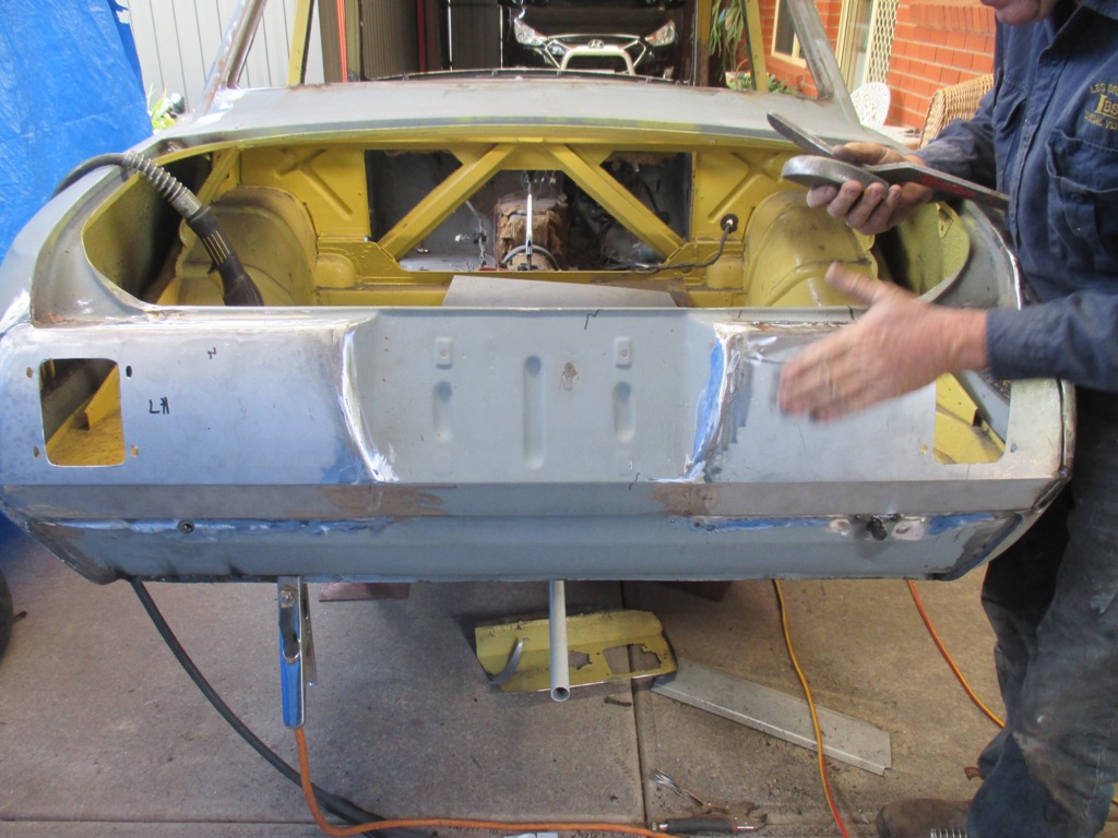

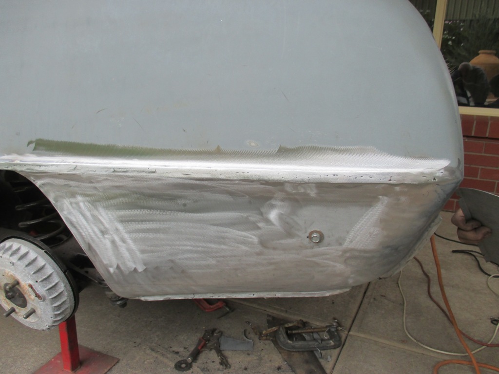

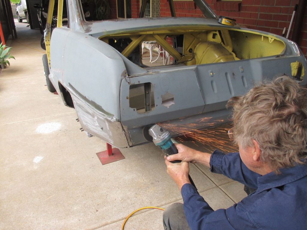

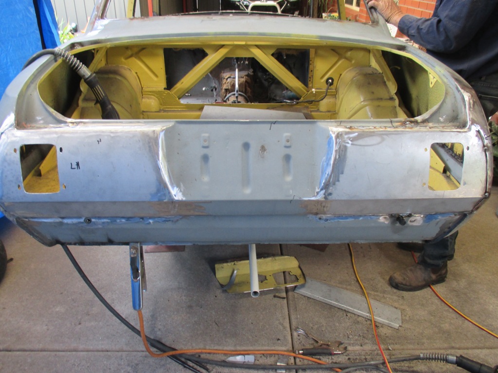

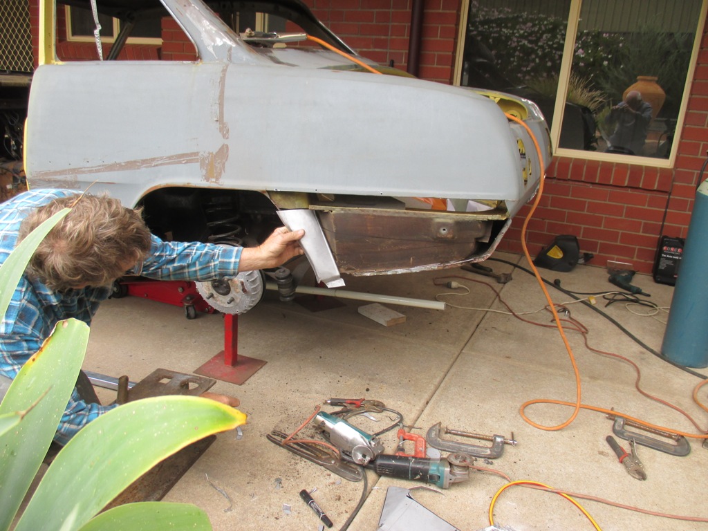

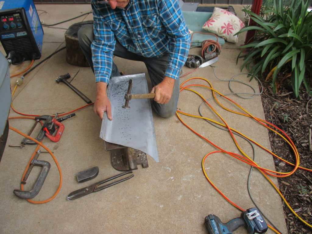

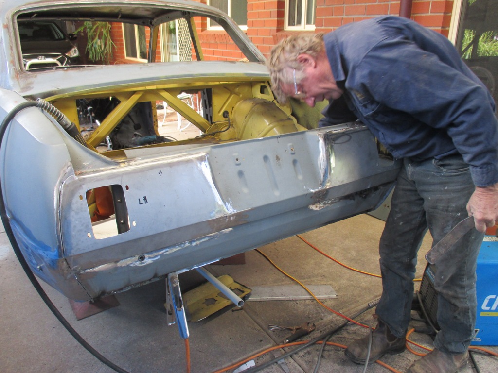

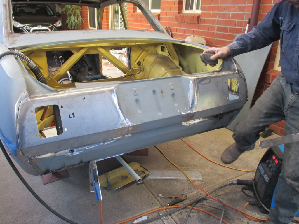

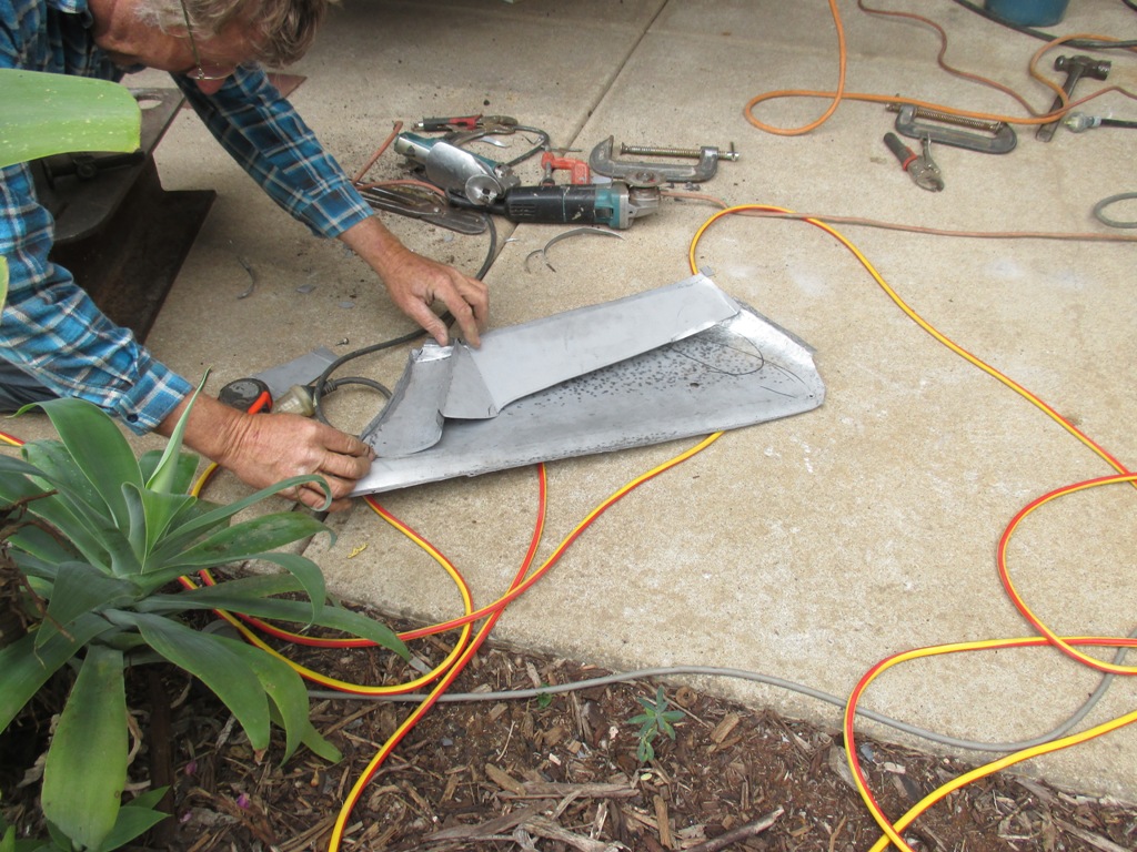

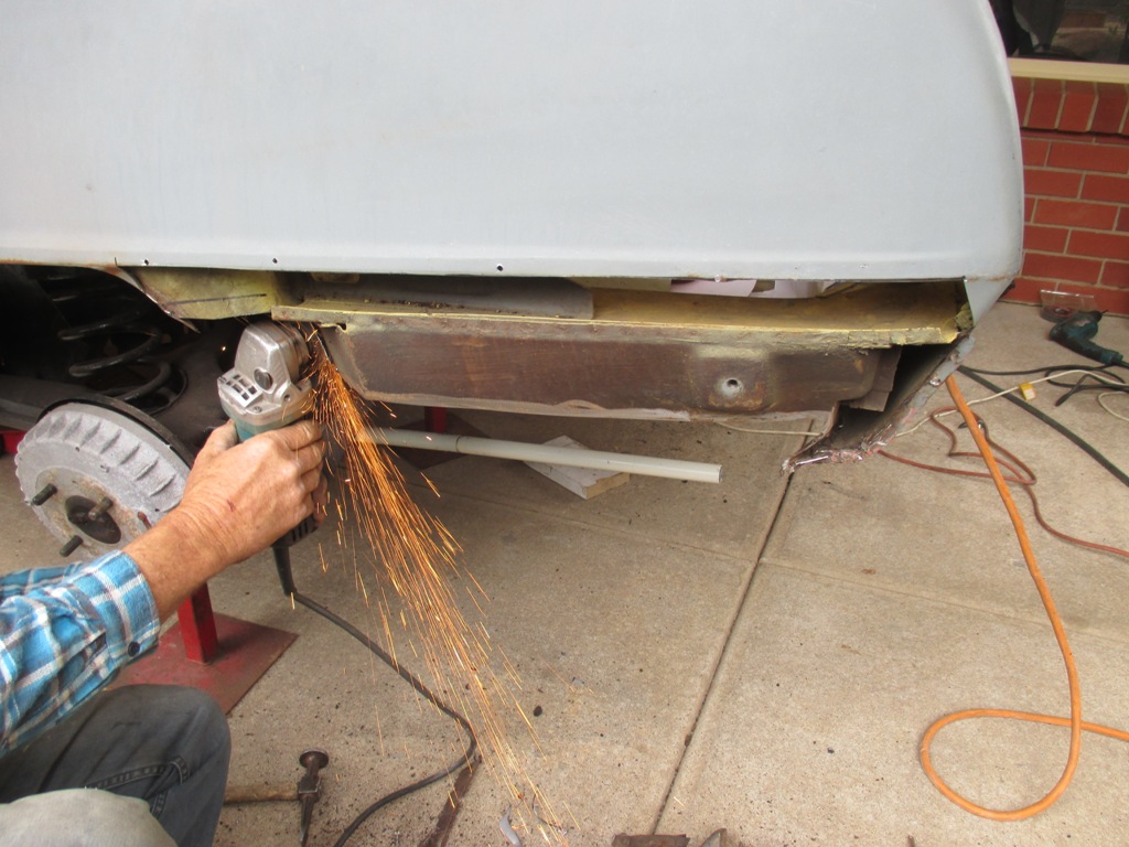

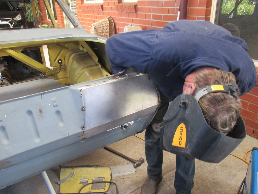

Did not get as far as we wanted today, had a lot of interruptions with visitors wanting to check the work in progress. I can say that both sides are now complete and the back beaver will definitely be completed next week so we are getting close to the completion of rust repair work.

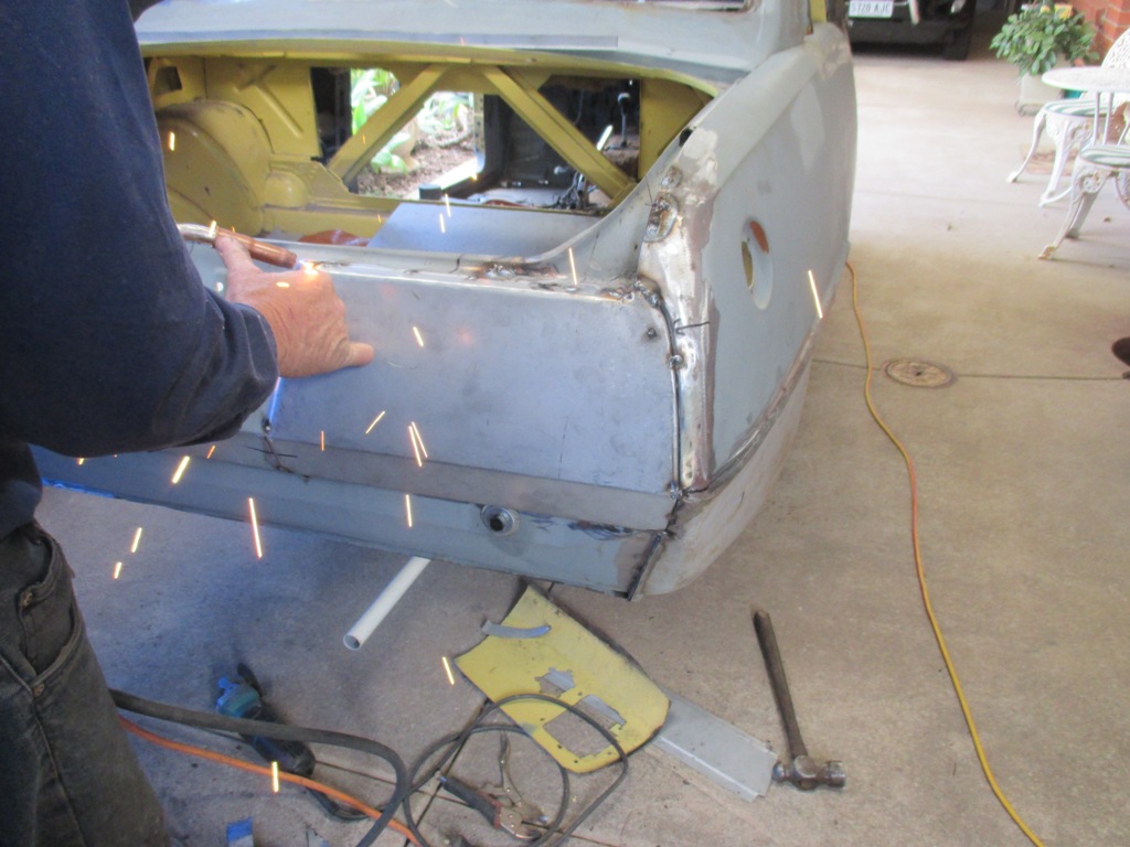

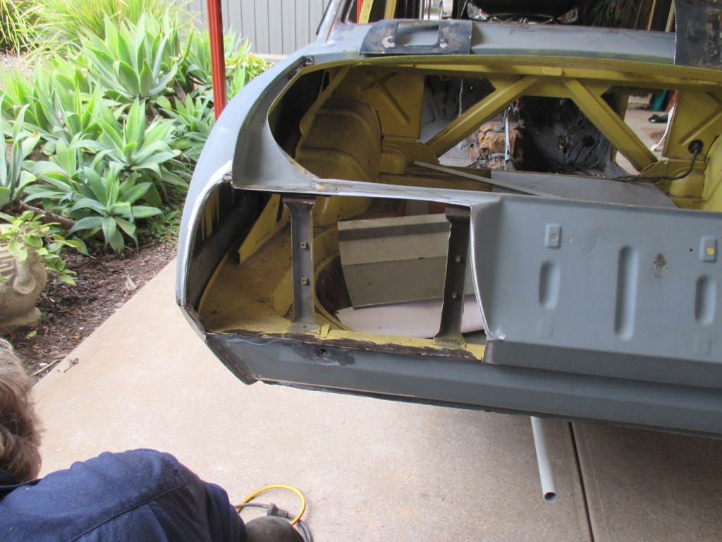

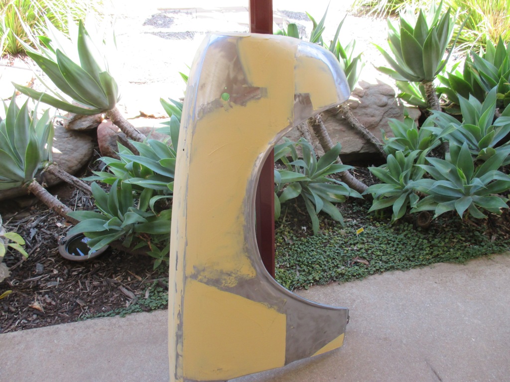

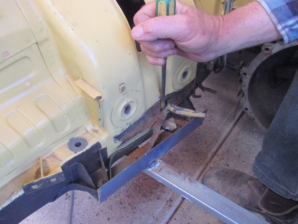

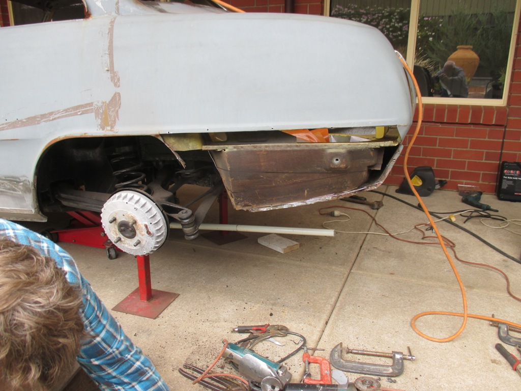

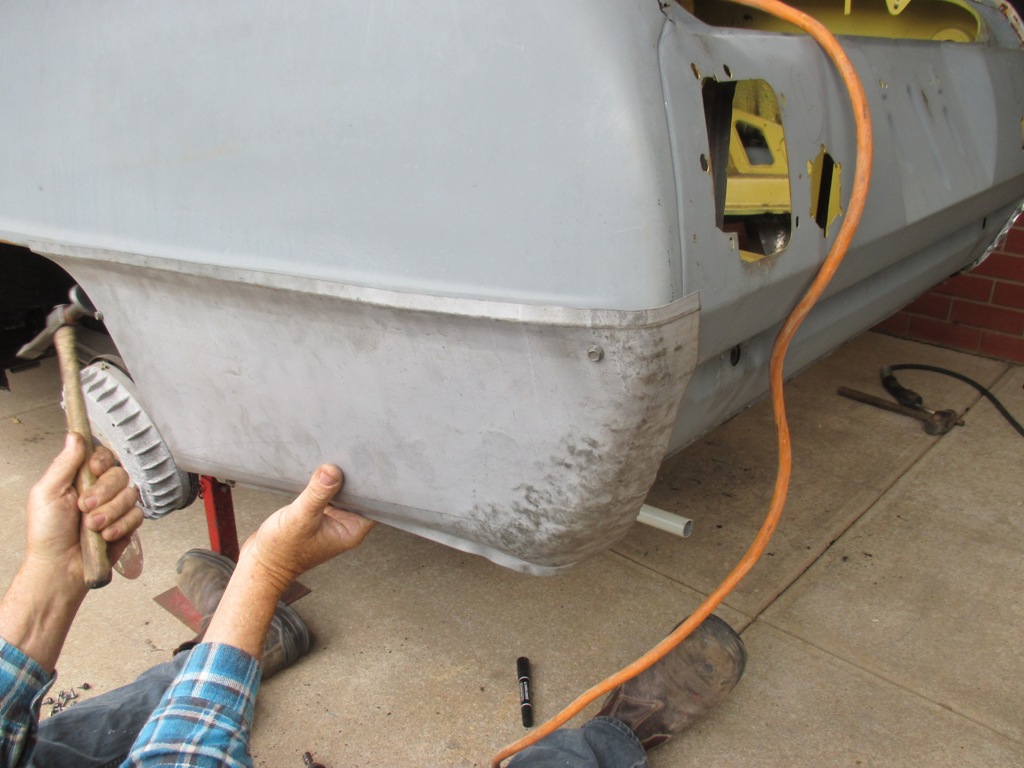

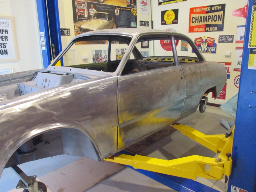

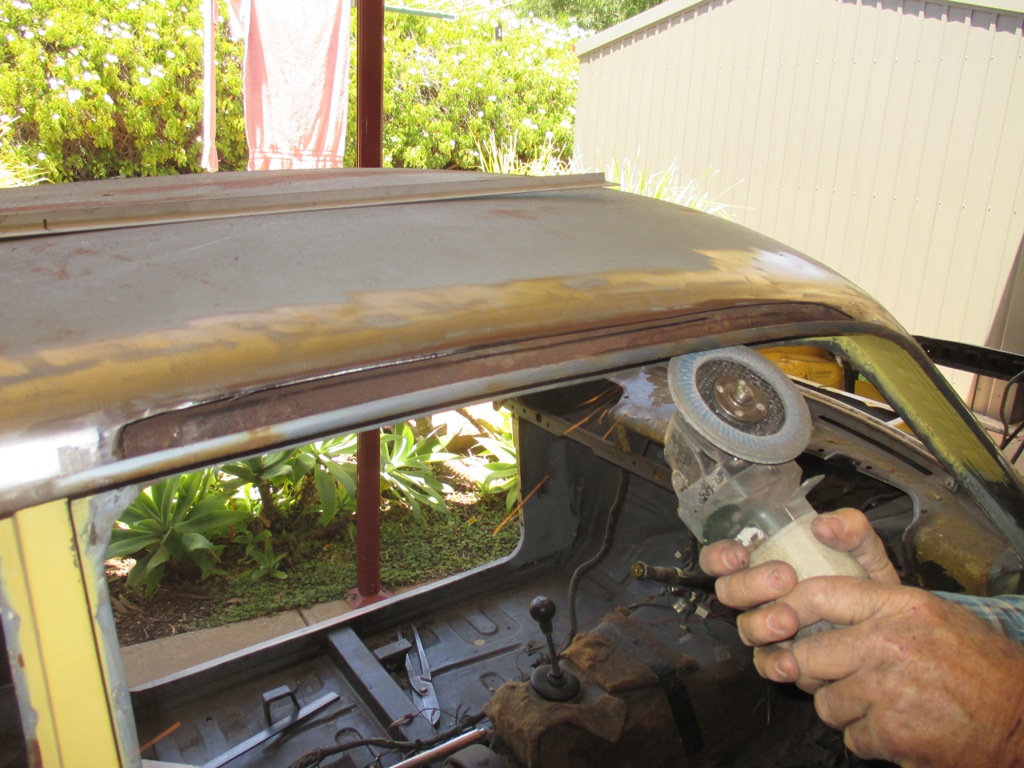

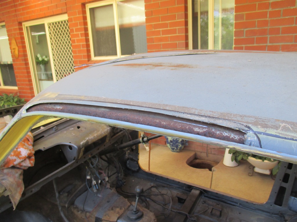

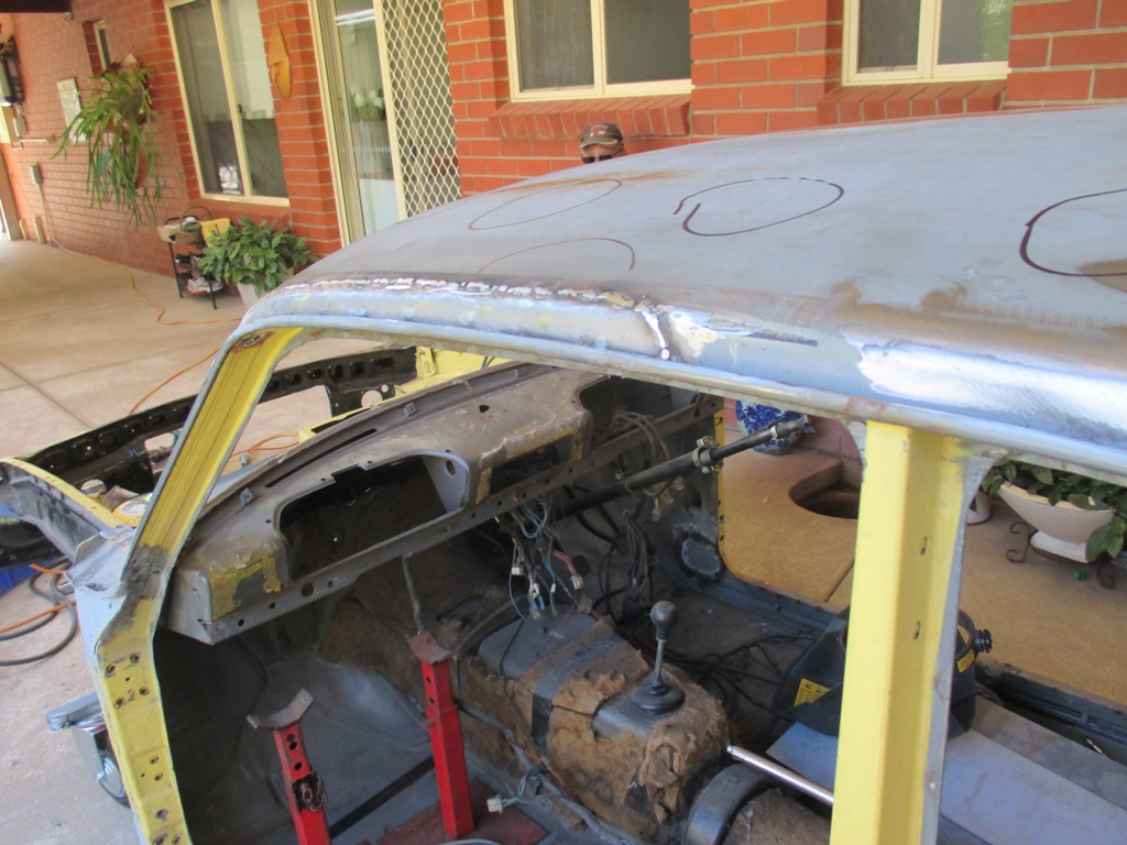

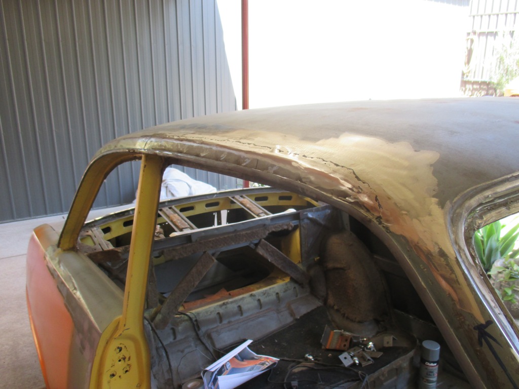

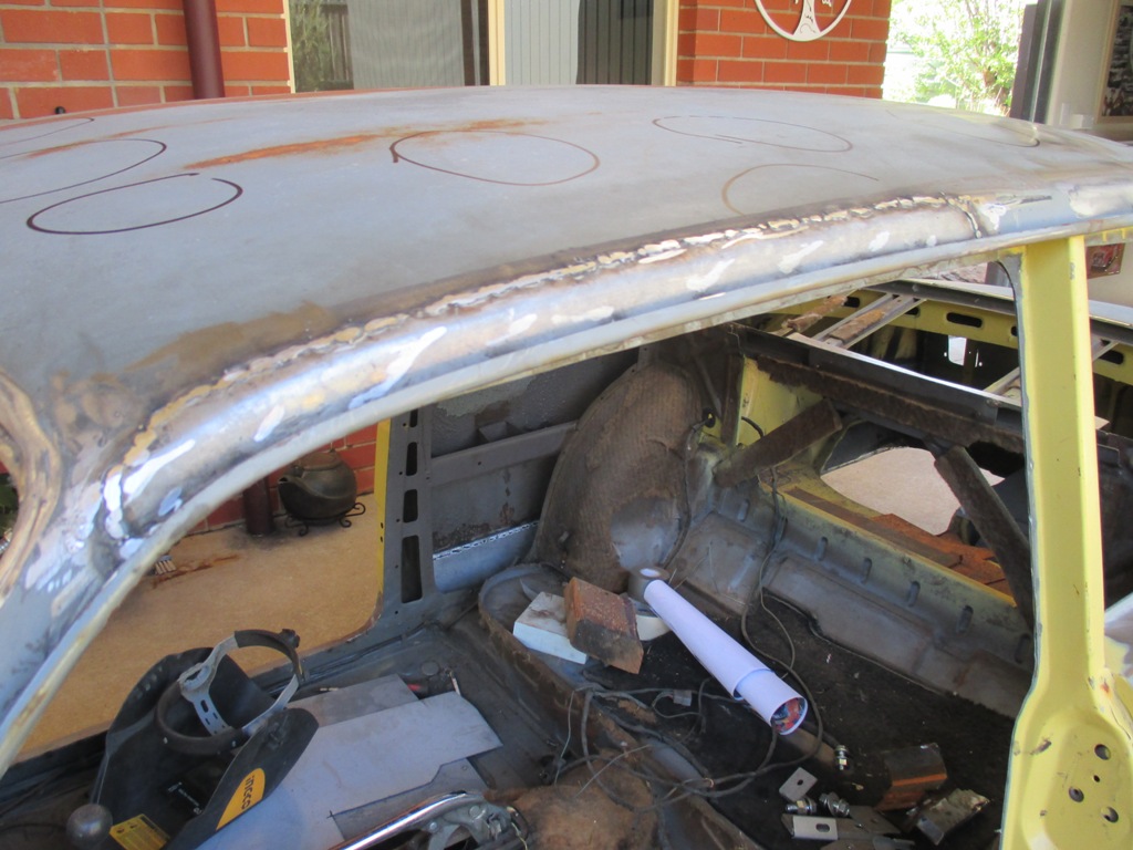

I believe we have a 95% rust free Bellett GT after today, only have to do the roof channel on both sides (about a metre each side) and the passenger side suspension tower then we start fitting back the doors, boot, bonnet, front valance and guards so we can check everything once again and then start prepping the car for paint.
There will be no work next week as I have been recently diagnosed with prostate cancer and am having a biopsy on 19 Nov 20 to determine the treatment going forward, bit of a bummer but will deal with it like we have everything else in our lives.
Enjoy the pictures
cheers
peter

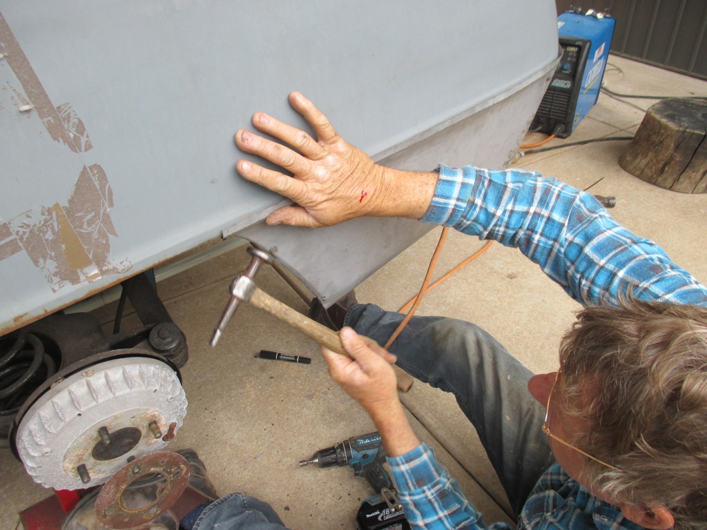

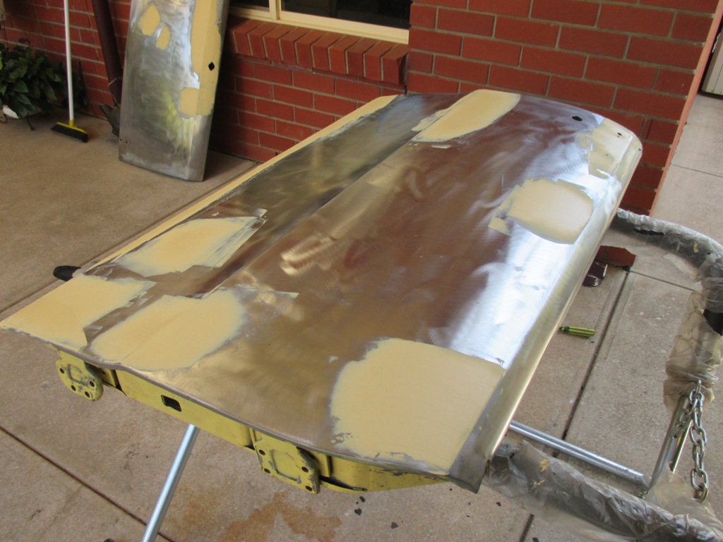

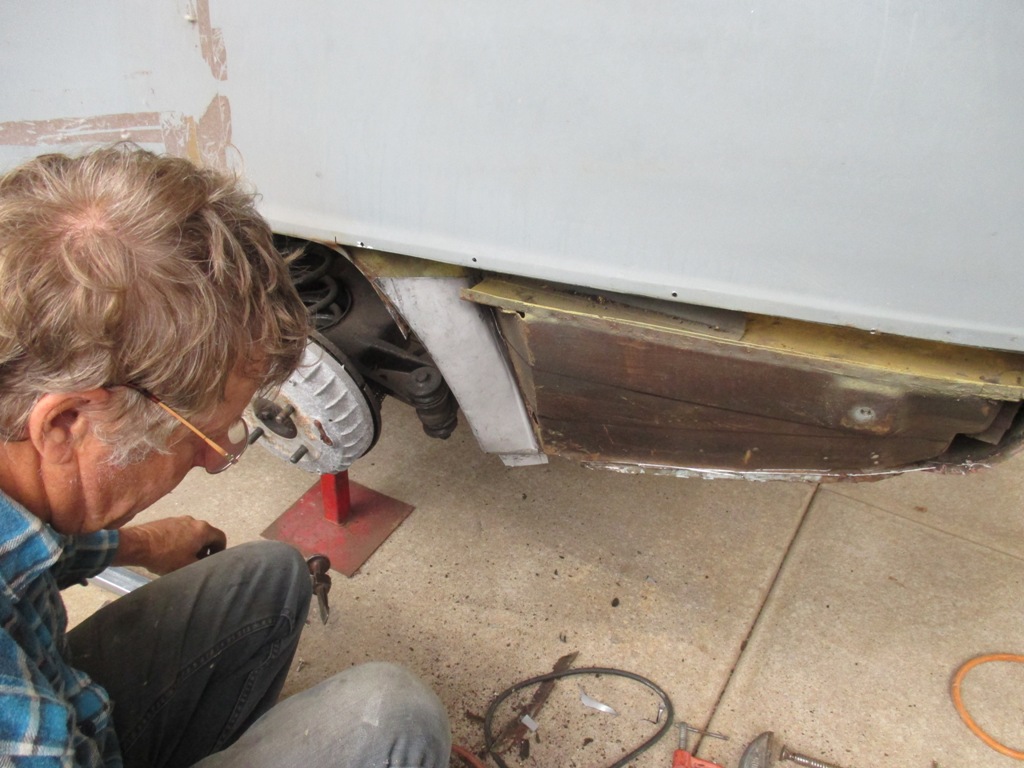

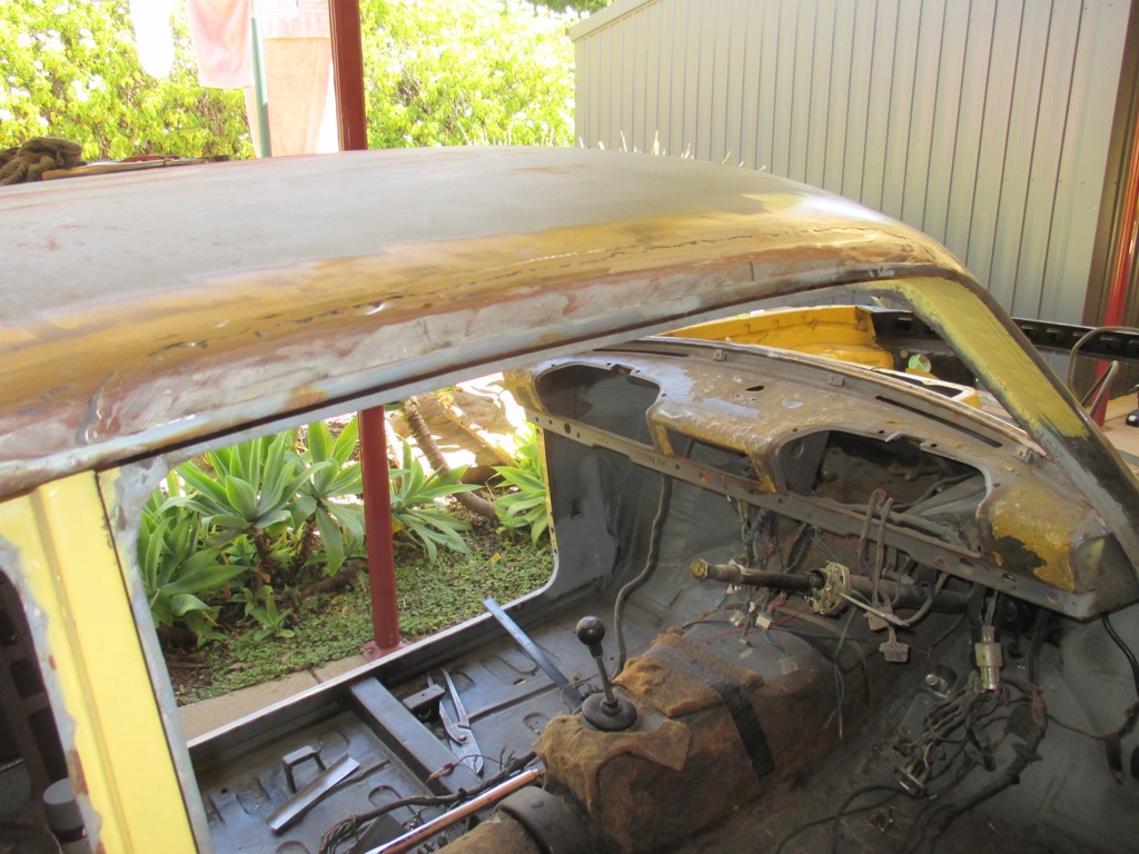

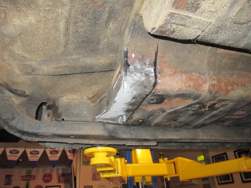

Well it has been some time since my last post and we have been on a journey of lows and highs. I put the car on hold whilst I dealt with the news of prostate cancer and of course going through the biopsy. It has been quite a ride for us as everything including blood tests, MRi etc. all pointed to prostate cancer however after the biopsy we saw the specialist to get the results only to be informed that I do not have prostate cancer but a very rare disease that mimics prostate cancer in every way. The lesions on my prostate are not cancerous and will reduce in size and eventually disappear with treatment. It took a while for us to get our heads around that but we are now moving on. The car is back in full swing and today was the first time in a while that we had done any work. She is now rust free just a little but of tidy up to do, fit the panels up and start prepping for paint.
I have attached pictures of todays work
Peter

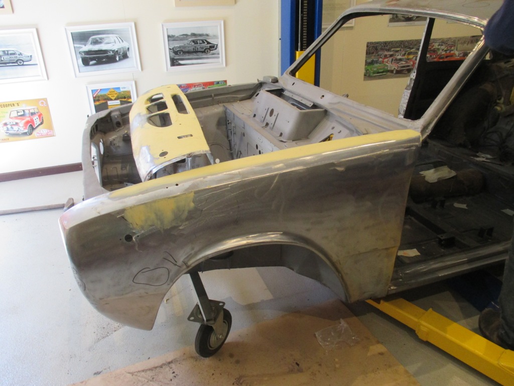

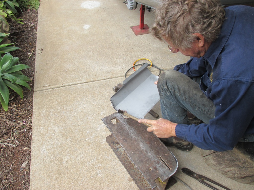

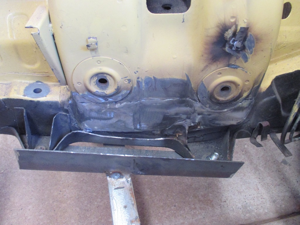

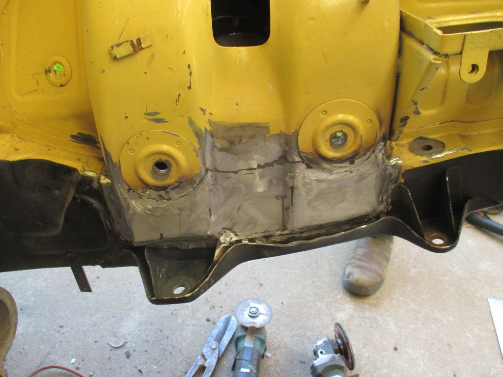

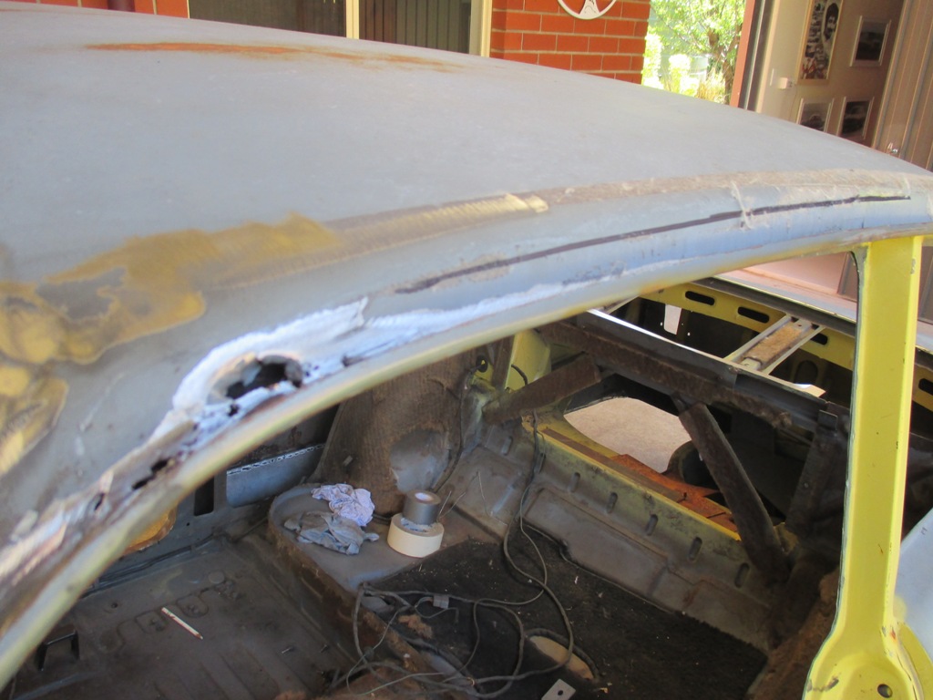

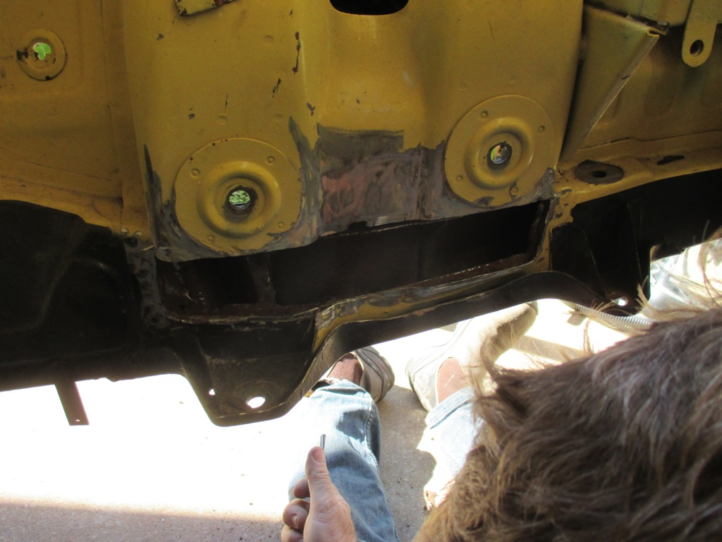

Well I thought we had got all the rust but there was a little niggle that made us look at the driver side suspension tower and I am glad we did, there was some little nasties lurking underneath but had not yet broken out. Not a problem cut it out and I think we have now got it all. Will put it up on my hoist now and remove the rear suspension and gearbox. We then need to make a rear frame with some dolly wheels to allow it to be moved around. It will then go off to the local sandblasters to have the engine bay, front valance and door and window surrounds cleaned of paint then I will bare metal the rest of the panels and start the prep work.
Regards
Peter

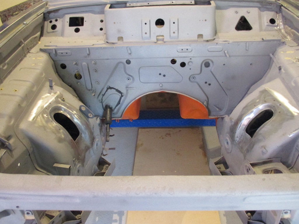

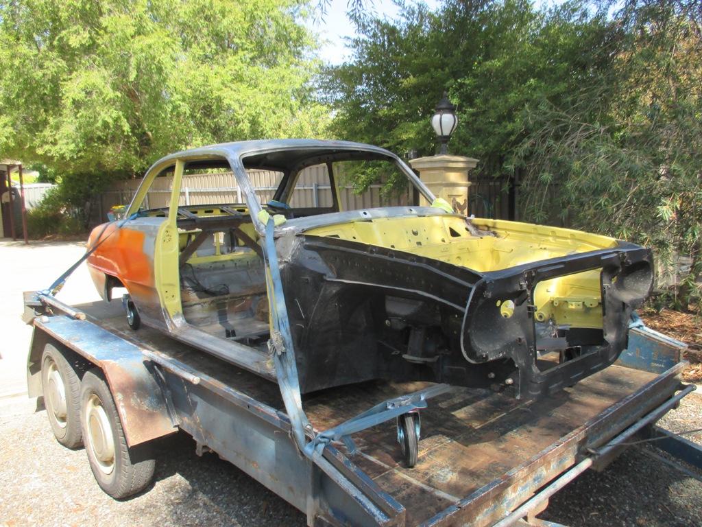

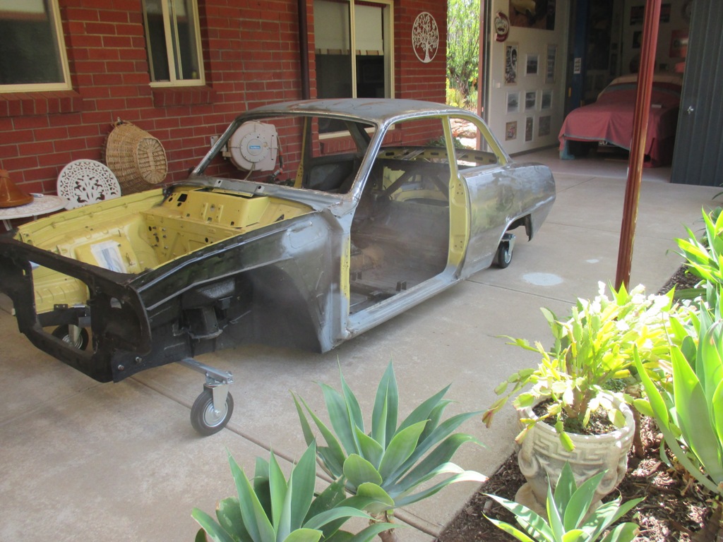

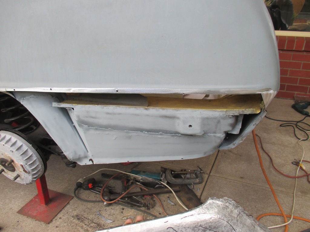

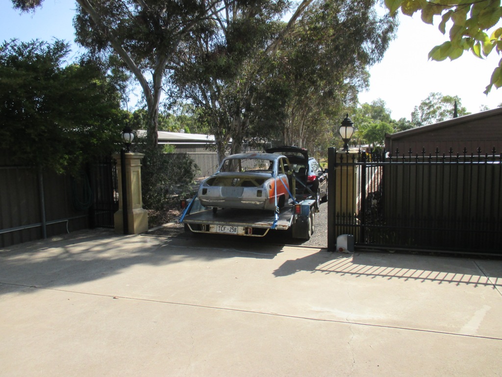

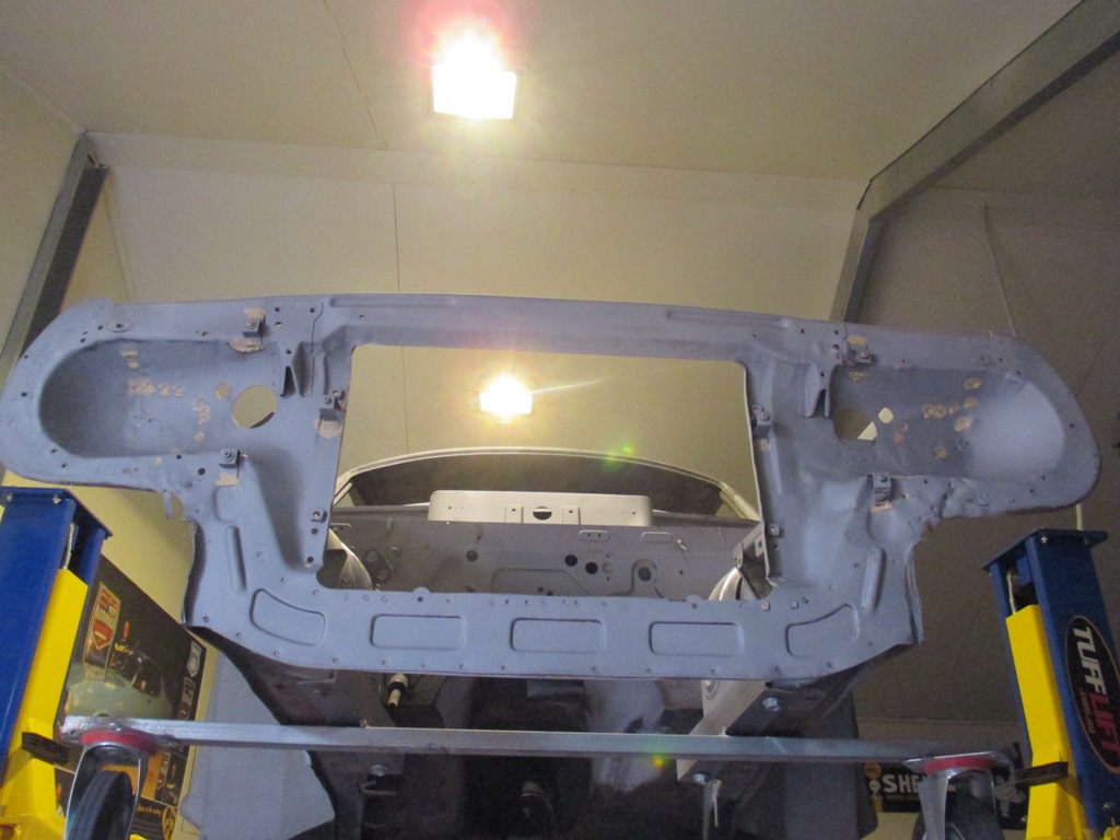

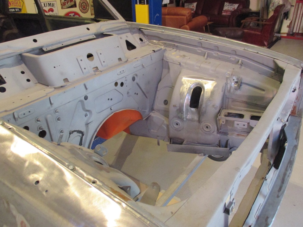

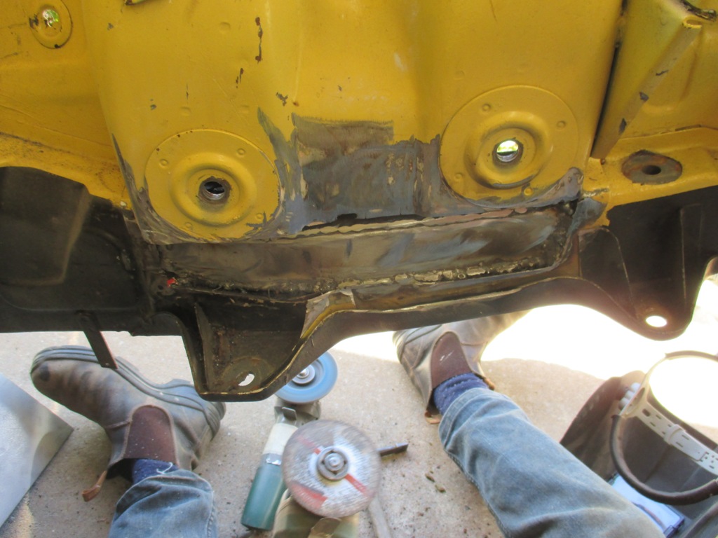

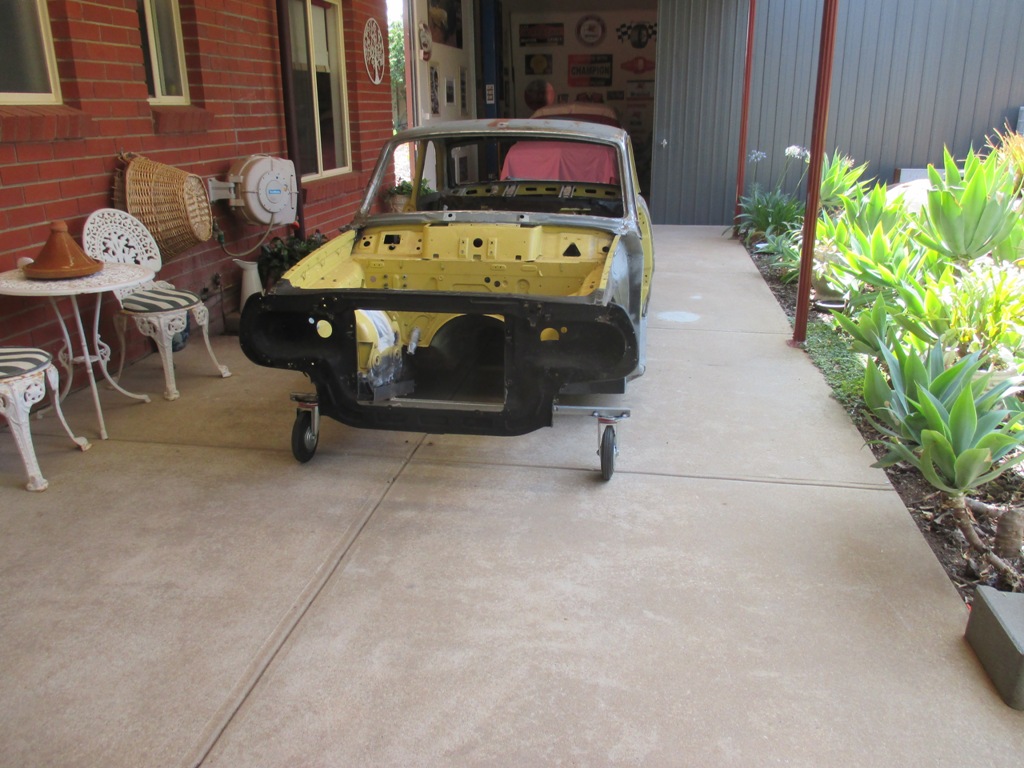

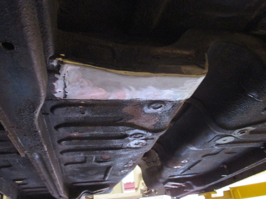

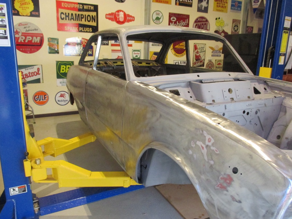

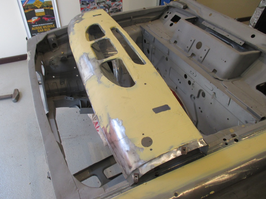

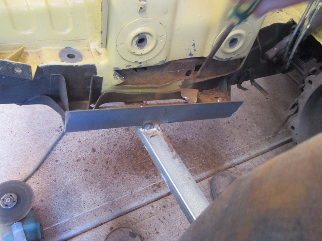

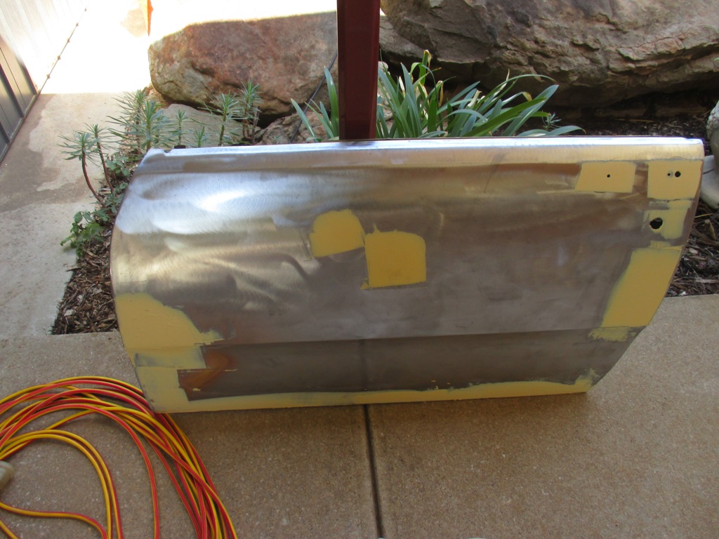

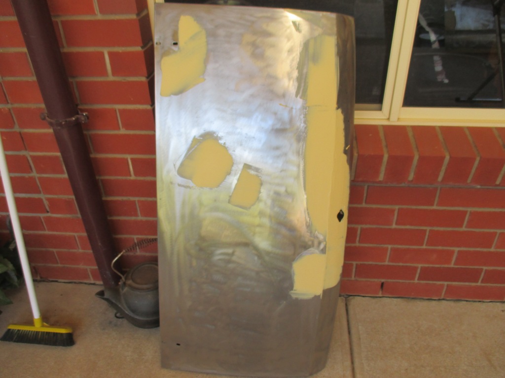

Time to get going again on the PR90, found a small section of rust in the box section of the floor and that was cur out and replaced. The car has been to the sand blasters to have the front and engine bay cleaned of paint and any thing else lurking underneath, luckily there were no surprises. On return we have applied rapsol to the under body and the car has been given the once over on all panels with a micro film of filler where required. Next step is to sand all the panels and then spray with spray putty and or micro fill rub back again and get ready for paint hopefully being in colour by mid march at the latest.
Peter
