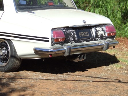

i love the paint you have lovingly aged so well! you are going to devastate me when you paint the beast!
Sat Jan 23, 2010 8:59 pm
seriously luv it rob!!
when i posted the pic of my sedan that had the stripes, i honestly thought u were going to repaint the car and do the stripes as a new resto type of thing.
but this patina idea is even better!!
you've done well!!
a suggestion tho... i'd do the window frames and "B" pillar the same way. i think the white looks out of place now. the GT-R had them black as well, so it'd suit nicely.
and yep, maybe PR20W would suit... gav has the word on it!!
Sun Jan 24, 2010 3:38 am
LOL, as I posted elsewhere, I ran out of masking tape ... the frames and pillars are next.

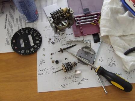

oh, speedo is out, trying to fix the tripmeter, cable to come out next and be cleaned,

Speedo !? Well I'm borrowing a GPS while I pull another one apart (thanks Chris).
Need to get some trip wheels to replace the ones that don't work anymore.

Hey Rob. A guy rolled up to me at Motorfest & said he rebuilds instruments. Said he did his trade with a company that eventually closed shop, so he bought all the gear & went on his own. I asked "How much for a speedo like that?" He said probably $70 to $120. He is in Sydney, but small stuff is cheap to post. Paul Hopfe - Norwest Instruments. Ph. 0432 389158.
(I don't have any spare late speedos, only earlys).
Fri Feb 05, 2010 11:41 am
Thanks for the info Matt.
I'll see how I go with the reassembly, it just won't have a white wheel for the tenths of miles.

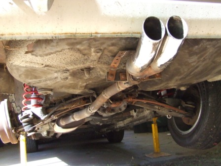

Good news is that the exhaust is on ...
FRUSTRATION !!!! trying to weld paper thin rusty exhaust tubing !!!!!
Looks cool though. The final product while not as pretty as a professional shop wood do it will suffice for now.
Sat Feb 06, 2010 7:46 am
Thats some tricky welding, Rob!! You must have a nice gentle MIG. One thing I don't like is exhaust work - always seem to get bits of rust in my eyes! I'm taking betty to Young to get a new system from the extractors back as there's nothing there at the minute. Could be a noisy trip! Oh well, only 70 k's! Bam balaaaaAAAAAAAAAAAAAAMM!

Sat Feb 06, 2010 11:41 am
Yeah, too right mate. Those curves are usually done with a bender on new tubing. Yours is a piece of art, Rob. How many sections ? :o .
Matt, I had the strange fortune of driving the rolled 66' PR90, after we had retrieved it from the paddock, and pulled the whole exhaust off way back to the extractors because it was completely twisted :twisted: On top of that it was sans windscreen, full of dirt and had every panel severely damaged (I hear some oohs out there, yep guys, very painful). But it was like low flying some half wounded WW1 Biplane. I ended up wearing a beenie, ski goggles and industrial grade earmuffs for 30 k,s, "biggles flies again" :lol: Have an interesting journey mate, sounds like it'll be worth it.
Sat Feb 06, 2010 1:17 pm
Yeah guys, the mig is a gas-less hobby one I picked up in Longreach a couple of years ago. You just gotta get the right wire to make it work. Not all wire is created equal!
The exhaust is a bit of an illusion, as it is only four sections. The first part is the original exhaust cut up (into 3 pieces) and realigned to go past the diff and spring. The rear section was a piece of straight that I ground some slots in at the appropriate places, bent and then welded closed. Would have loved to make one out of new pipe with a bender, maybe later (Might also use a bit smaller pipe and tips, twin 2 and half inch outlets are a bit of overkill- free though, thanks Paul).
On the noisy car thoughts; I've only driven one car with no exhaust and that was because the end fell off (forgot to do the clamps up). Made an awful racket as it departed the car (doing about 80kph), the car sounded pretty good without it though (360 in '74 Chrysler).

Still waiting on rack rubbers and finish assembling the speedo.
