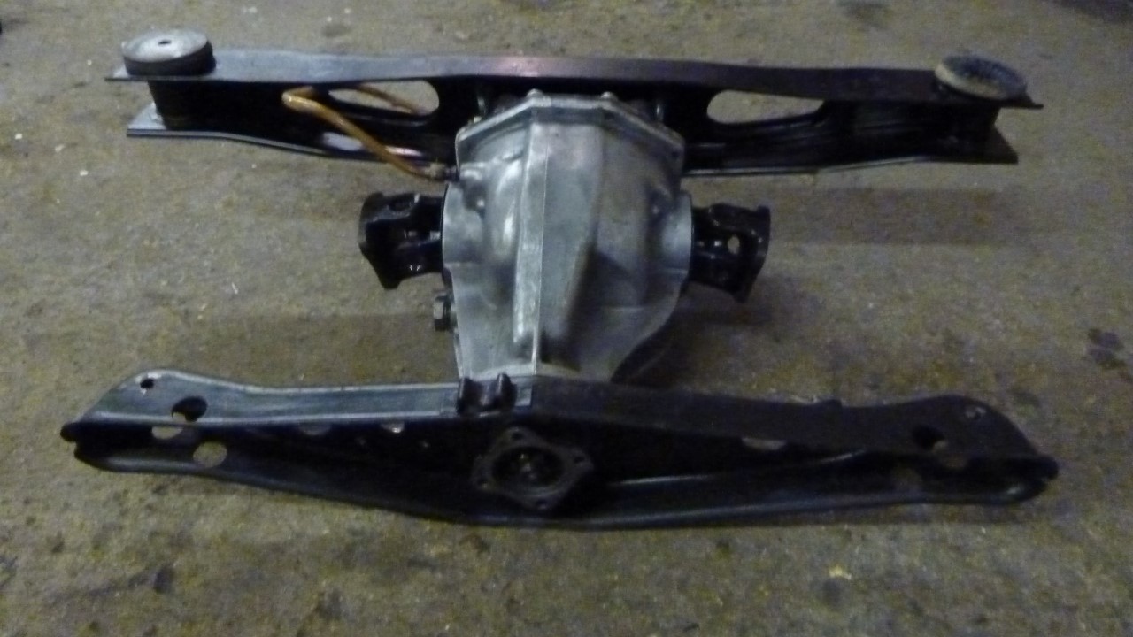

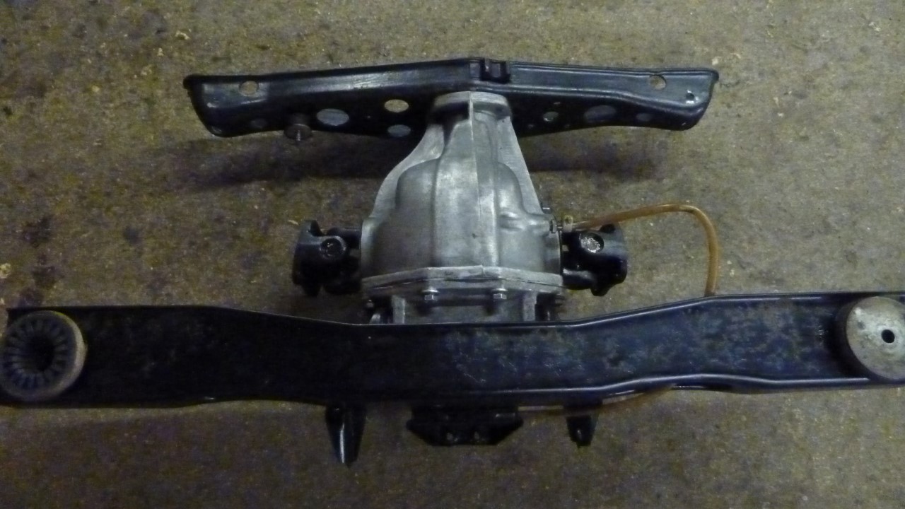

For all of you diff-heads out there, a couple of shots before re-insertion.
Tue Feb 07, 2017 1:07 pm
Pombellett wrote:
Nap, I can only dream of that sort of performance..but we'll keep pushing.
Hi Mark, you are lucky having the 'earlier' diff. On my 72 Sport, the brake lines run though the forward cross member meaning its not an easy drop down. Anyway, i hope its all sorted and ratio works well for you guys.

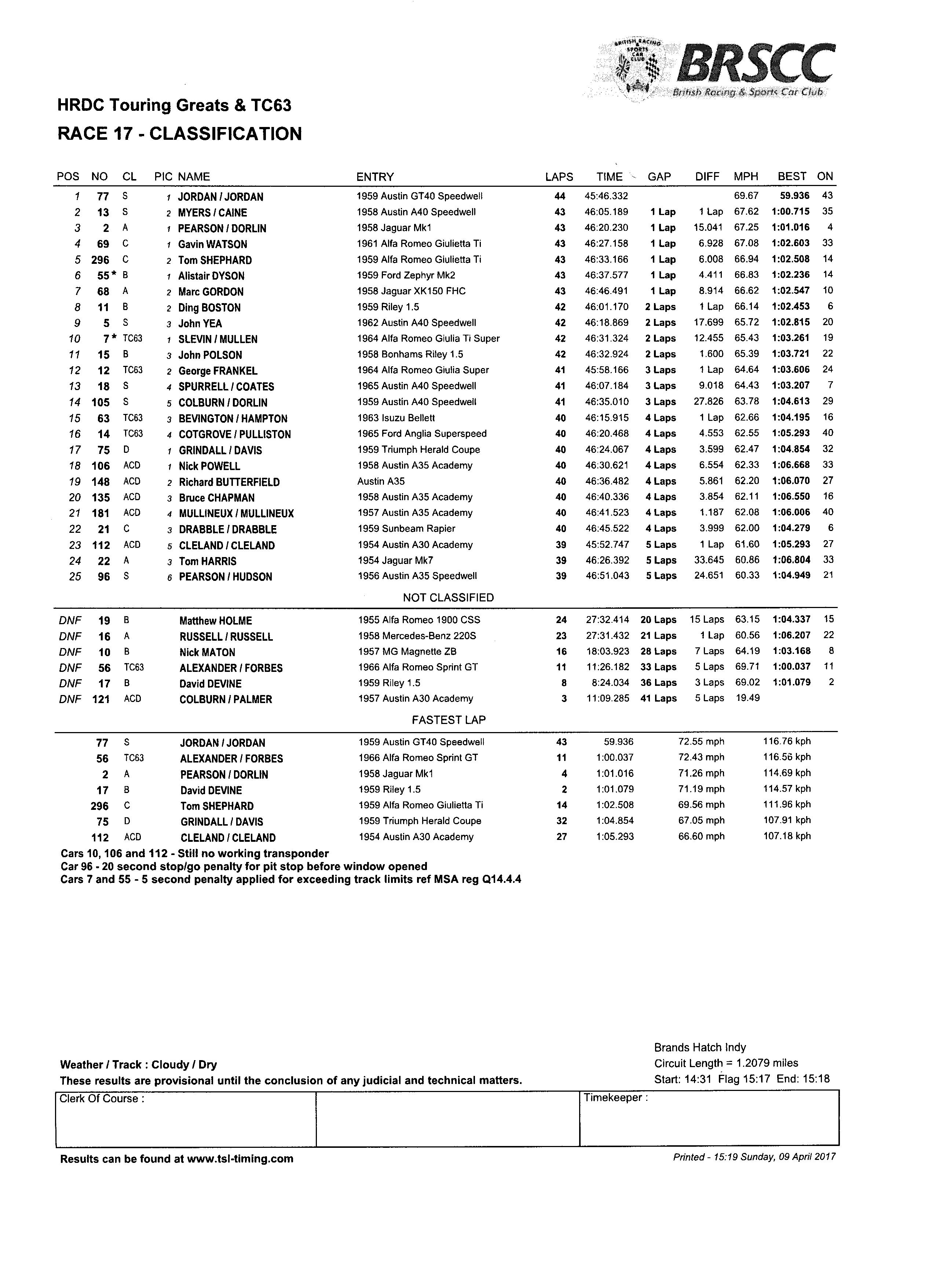

Back from Brands, and generally pleased with how we went.....the new diff is excellent, and has already gained us 2 seconds over last year...but of course, the extra speed/revs comes at a cost, and the car ran very hot....which subsequently we couldn't run at maximum attack.
We have plans to sort this though.
We qualified 15th of 33 and finished 15th.

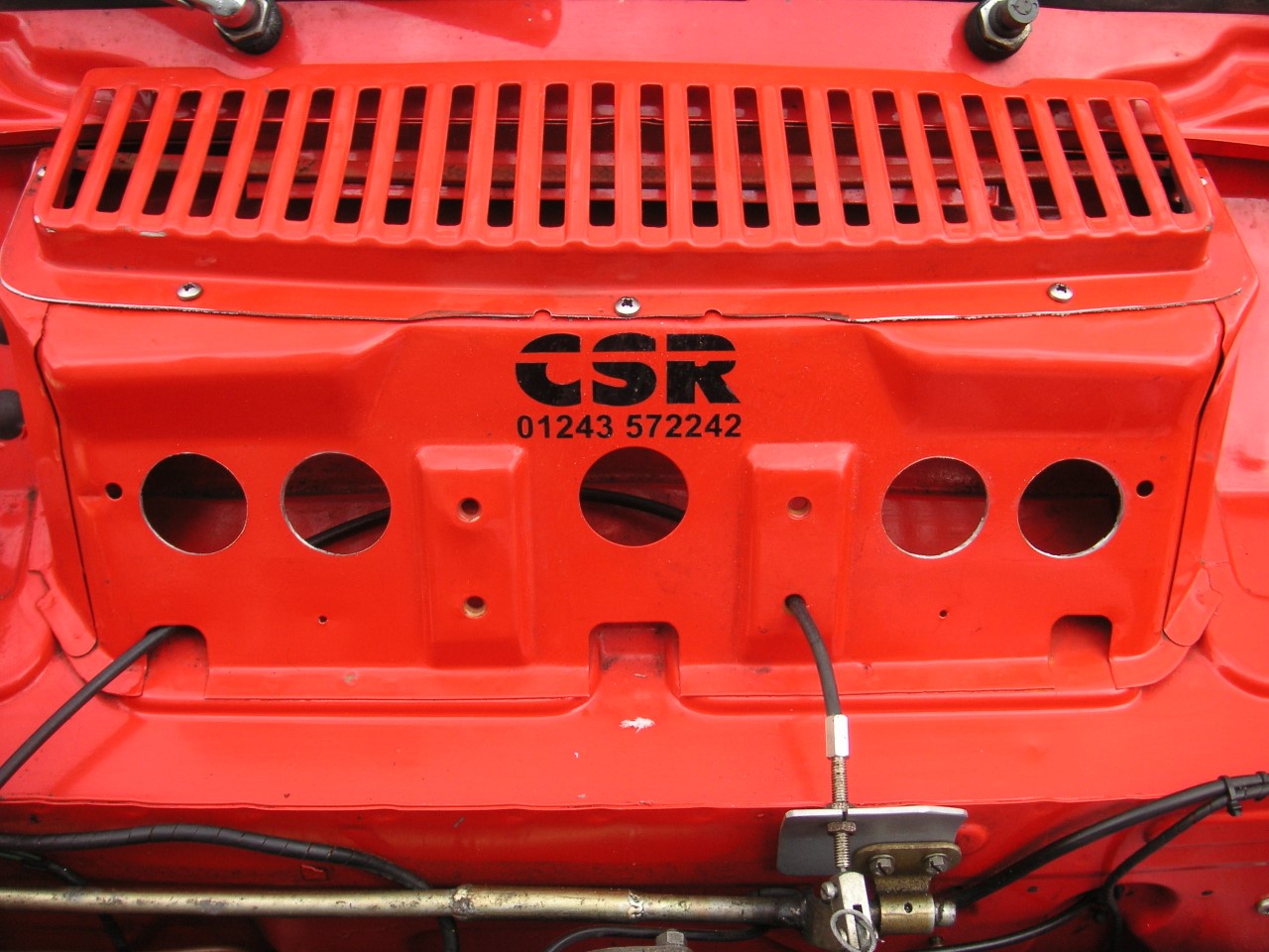

We've now started work on cooling it down, the idea is to create a lower pressure area at the back of the engine bay and increase flow through the rads.
So we've cut more air exit holes in the heater box

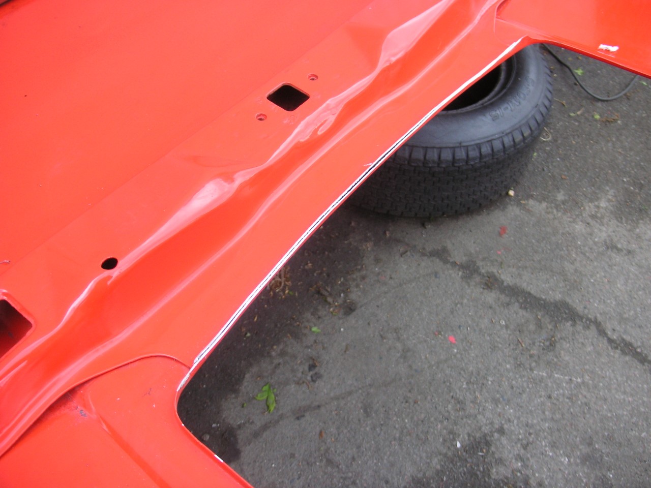

We're not allowed to raise the rear of the bonnet, so we've cut off the bonnet flange and the return flange on the grill.
There are loads of other things we can do, but this time we'll take it one step at a time, this way we can work out which mod does the job.
We aim to be ready for Castle Combe in mid July.

In your 'list' of things you can do are you able to put vent grilles in the bonnet the same as a GTR or a Sport. :?:
I had heating problems on my sedan and GT. New radiators and heater core cleaning helped it a bit. I found using a radiator overflow bottle assisted a lot. Any coolant pushed out through the cap was then sucked back in when it cools down. You know the theory. I also found that if I had the heater tap open it assisted the cooling. Is your heater hose from the back of the pump going to the fitting at the back of the head. :?: i.e. No heater and a continuous water circuit. My line of thinking is that if you had a small radiator similar to a heater core mounted at the back of the engine or in the cabin area would assist the cooling of the back of the head and block.
