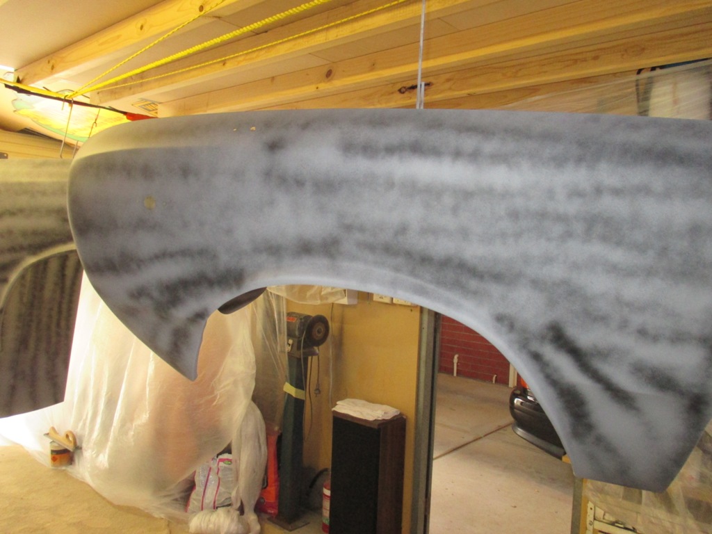

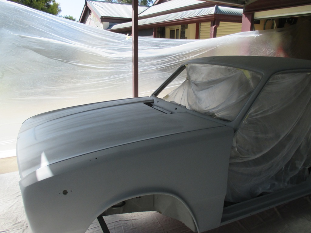

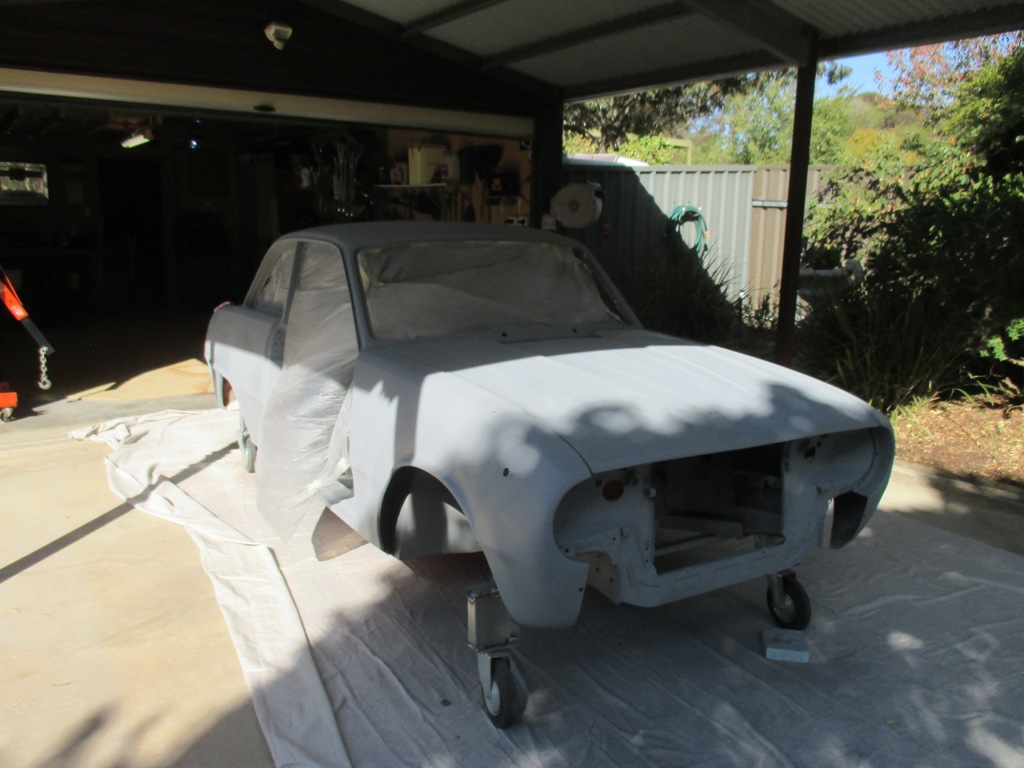

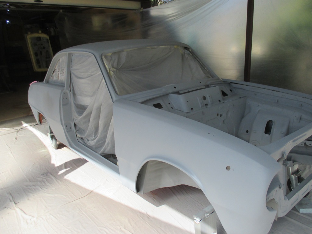

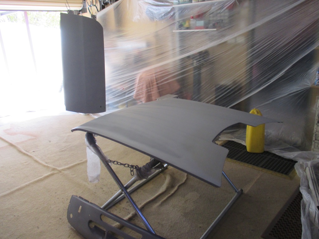

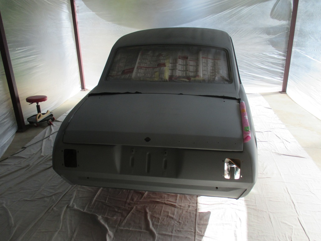

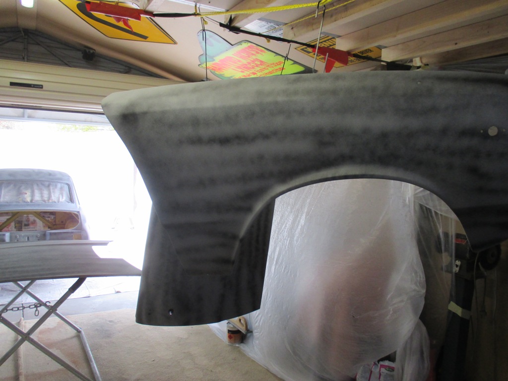

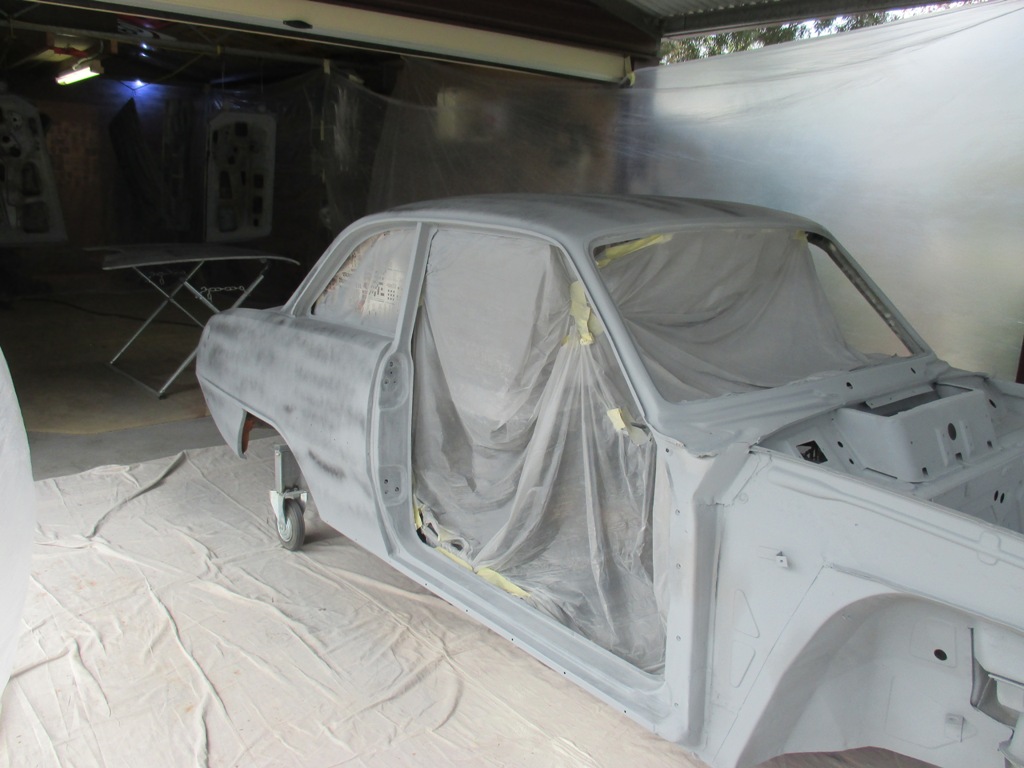

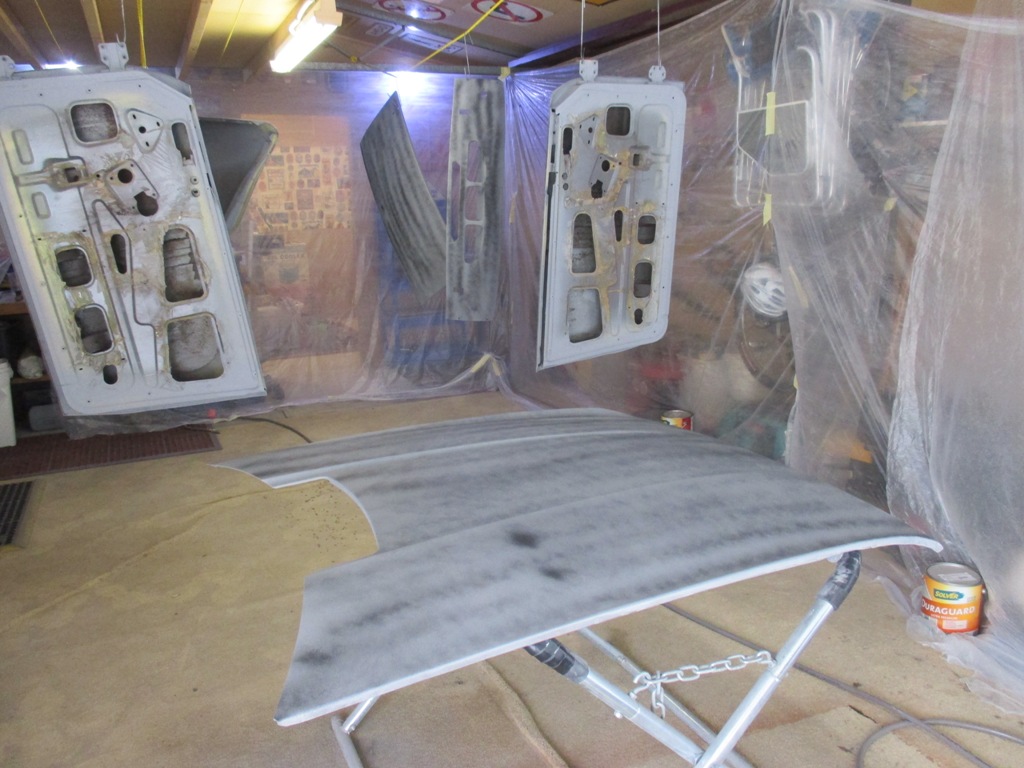

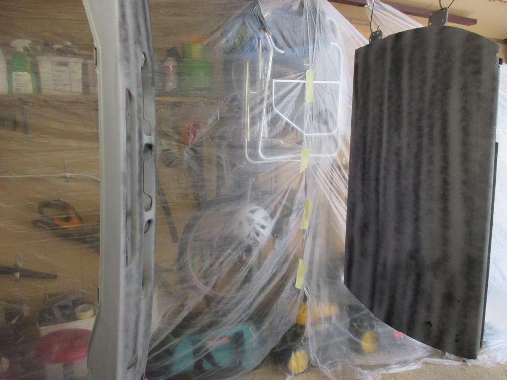

After a lot of filling and sanding we finally have our first coat of hi-build primer on. Now all we need to do is sand down and hit with a second coat. Finally we have turned the corner and it is a good feeling. I hope everybody is well , as both of us here are 71 Helen and I have chosen to go into self isolation so it is a time to get a lot of things done around the house, the car being one of those items.
Take care all of you this virus is a nasty one.
Regards
Peter

Tue Mar 31, 2020 6:43 am
That’s exciting,I can’t wait to come over and see it again. Stay safe and well Peter.
Tue Mar 31, 2020 9:51 am
Great work - it looks fantastic.
Stay healthy and at home everyone please.
Wed Apr 01, 2020 1:52 am
EXCELLENT PROGRESS.
Wed Apr 01, 2020 5:49 am
That is looking good
Cant wait to see some colour on that beautiful body
I remember doing mine in 78 and then again in 91, 2 coats on rub one off over and over - took me a month to finish
Lots of guide coat early and then block it till your hands were sore.
Happy rubbing and stay safe
Regards Flying
Wed Apr 01, 2020 11:19 am
don't forget to paint the door bolts also.

Thanks for your comments guys, much appreciated.Good advice Glenn, at my age I could easily forget. Plan of attack is rub this coat back apply a second coat and rub back. After that is completed apply colour to the engine bay,boot and all the door jams here at my place. We will then bolt the guards and doors on and take to the painters where he will do the exterior in the booth plus the bonnet and boot lid.
Maybe by the end of April colour will be completed. Going for a GTR colour scheme with black gloss bonnet and black rear beaver panel along with side stripes. Am probably not going to paint the extra inch of black on the top of the front guards, masking for that just adds to much to the job.
I know some of the purists will be turning in their graves and I will just have to live with that.
Peter

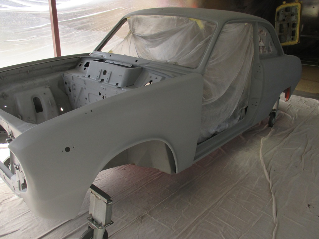

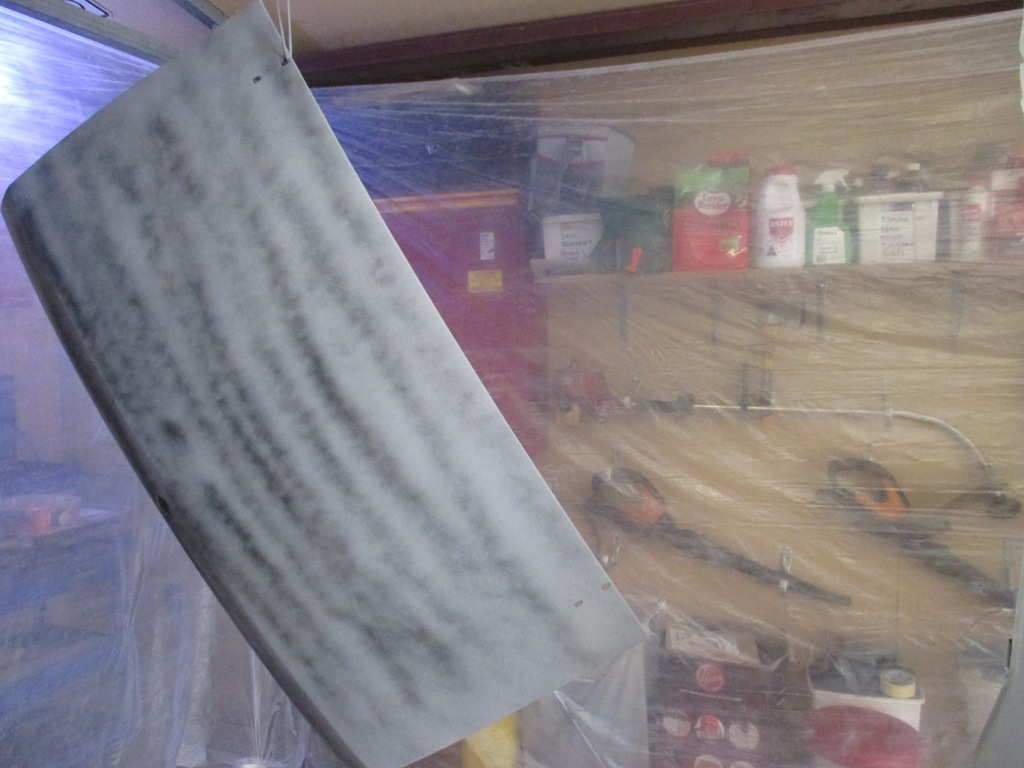

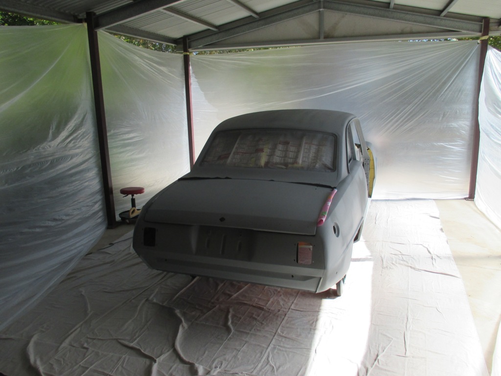

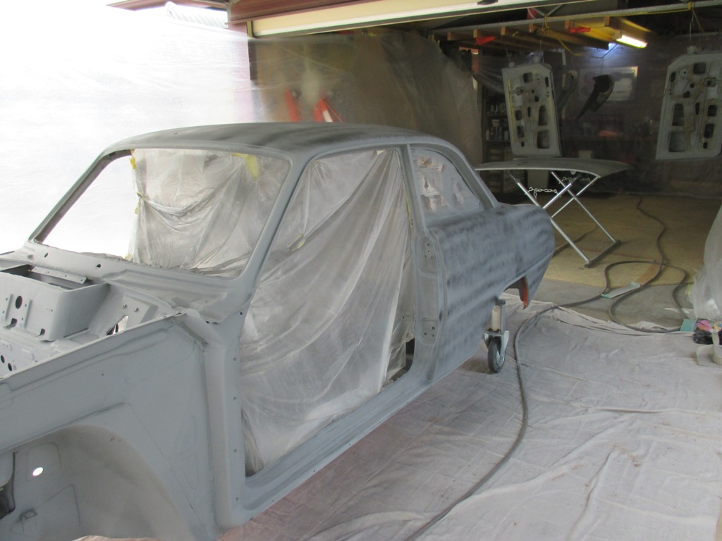

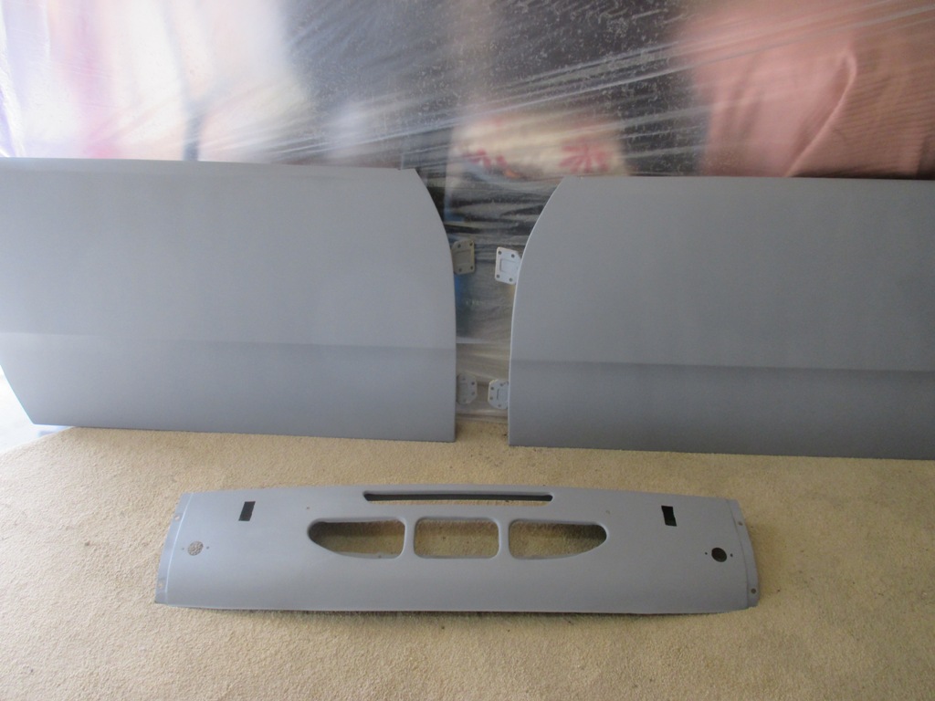

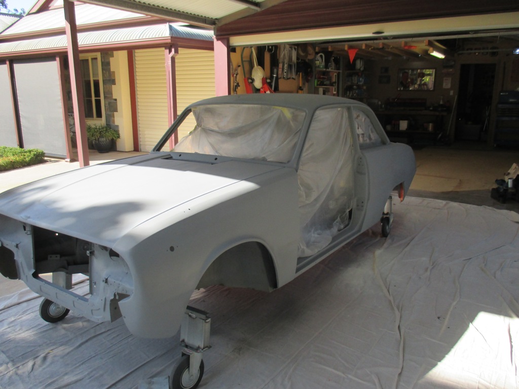

Finished sanding back the first coat and applied the second coat of high solid today. More rubbing back this week then final coat of primer, rub back and colour. Getting close now.
Peter

Tue Apr 07, 2020 7:12 am
Absolute legend!
:D
Tue Apr 07, 2020 11:12 am
It's almost like being re-born again. Keep up the great work.

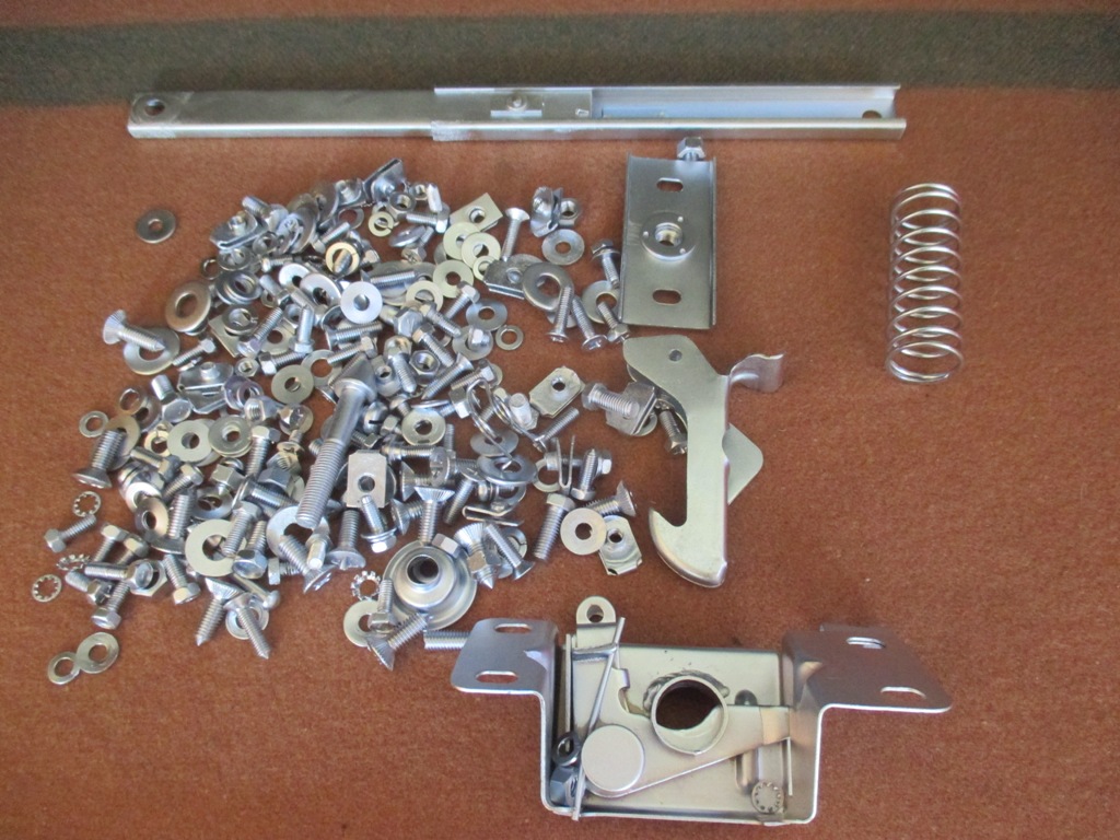

Picked this up from the electroplaters this afternoon, nice clean bits to bolt the panels and doors back on. Money well spent I reckon, cost all of $50.

Thu Apr 09, 2020 6:29 am
Great progress Peter!
All that thorough prep work is now going to ensure a beautiful skin on this PR90. :D
Thu Apr 09, 2020 8:03 pm
Bargain on the plating, really finishes them off nicely. I'm surprised it was so cheap.
Your car your colour I reckon, I'm sure it will be beautiful. Geoff will be excited to see it.

Thanks for your words of encouragement guys, I really appreciate it and it helps the motivation. I have been busy sanding back the body this weekend and it is coming up a treat. Next Tuesday we will apply the final coat of primer , do a wet rub back with 600 and then colour.

What I was thinking is the doors bolted on with the new rubbers weight in the doors that's the same as glass frame trim and then block across the door rear quarter gap front guards on and do the same
Shine the flurou light down the side to get a continual line with no zig zags
That would get it to paint without more expense on your behalf
Just my opinion
I am sure it will look fantastic
Looking forward to seeing your car up and about
Regards Flying

Thanks for your thoughts Flying,
The process we will be going through prepping for final exterior paint is similar to what you have described. On Tuesday we applied the final coat of primer and got into all the nooks and crannies including extra coats in the engine bay and boot. This week I am rubbing back all the edges of the panels, the door frames engine bay and boot using a scotch brite type of pad. We are not touching the panels. This coming Tuesday we will apply colour to all the edges of the panels including the boot engine bay and door frames. We will then bolt all the panels back onto the car and give the car exterior a complete wet rub using 600 grit. Once completed it will go to a friends spray shop for him to apply the exterior coat, this will be done in his booth. All going well we will achieve this in the next couple of weeks.
