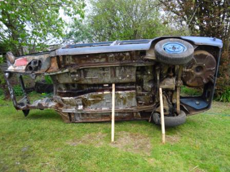

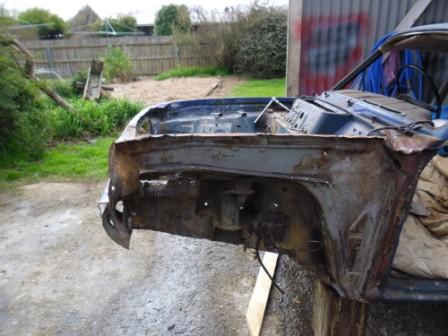

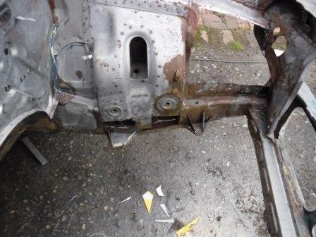

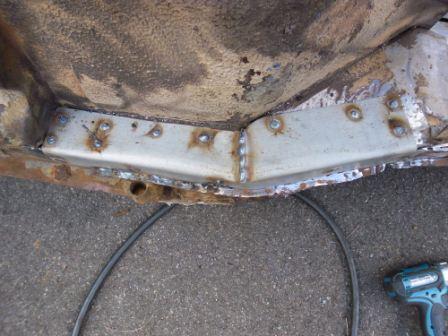

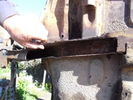

I'm still around but have been busy organising my retirement from work (i.e the stuff you have to do rather than the stuff you want to do) and have been slack in not contributing. I've kept up with the forum developments and it's great to see PR91 doing a Group N build as well. I reckon we could start a trend here Brett.
Mine is still progressing, albeit more slowly than I'd like but the body has been completely stripped to the shell and a lot of work done to fix a front end shunt of many many years ago that hadn't been fixed properly and ended up in rusted bits all over that section. Now all the cutting, realigning and welding in new stuff is done, the underside has been stripped of deadener, back to the metal and treated with KBS coatings rust inhibitor and rust seal. I haven't used it before, it is a 3 stage process but sems to work well. The topcoat comes in a self levelling paint in a choice of colours and can be sprayed or painted. It dries to look like a 2 pack paint. Cylinder head work is progressing now that I've sourced all the go fast bits from good ole USA - Mosly Mistubishi and some Datto 300z stuff which is compatible or can be machined to fit. It is currently at the (real) machinist to get the new guides pressed in and sized and stud holes re-drilled in the correct places to take the GT twin carb manifold donated by Gt Orph about this time last year!! I'm also doing the labout-intensive bit of cleaning and preparing all little bits and pieces that come off everywhere and working on engineering the disc brake set up
Sorry I can't show photos as most had been taken with my phone which had a melt down and I lost them :(

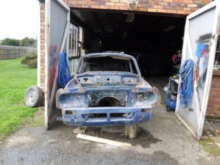

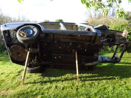

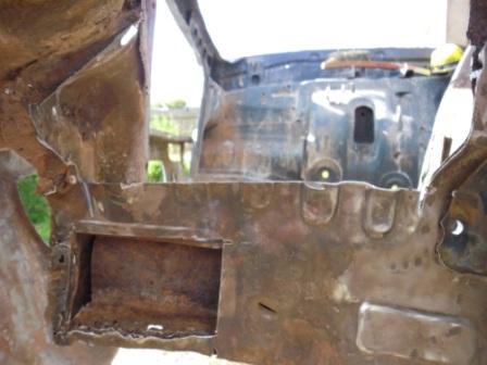

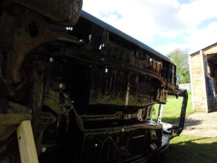

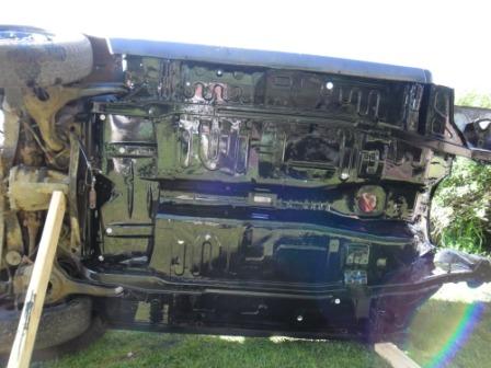

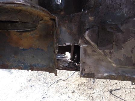

Wed Dec 07, 2011 5:41 am

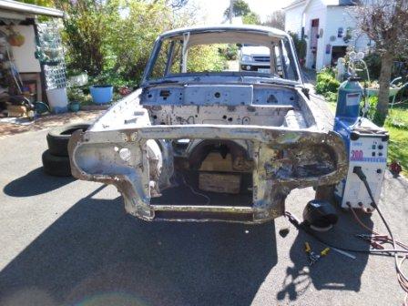

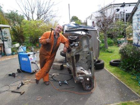

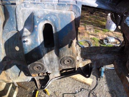

Hi everyone
At the risk of overloading you all, here are some of the salvaged photos I mentioned in the last post
You'll notice that the front LHS wasn't a happy section at all!!
I've put them up in different posts as I can only fit 6 at a time in one posting.
Happy viewing
YP
Wed Dec 07, 2011 11:33 am
The next instalment
And in this one you will notice that once again Rob SA was right . It was all an electrical problem - for the second time!!! :lol:

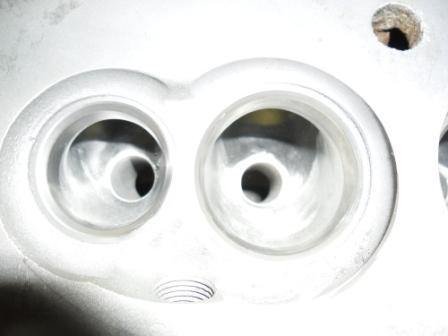

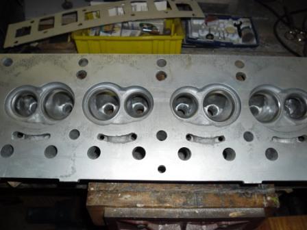

Wed Dec 07, 2011 11:44 am

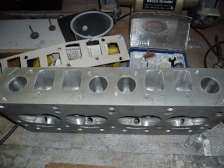

Apologies to all you IT savvy people out there but this is the best way I can think of posting photo updates right now. Besides I haven't contributed much this year so I'll use up my quota now while I'm on a roll. :)
The quality of the photos of some of the headwork is spoilt by light reflection but I think you'l get the idea
YP
