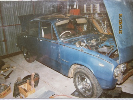

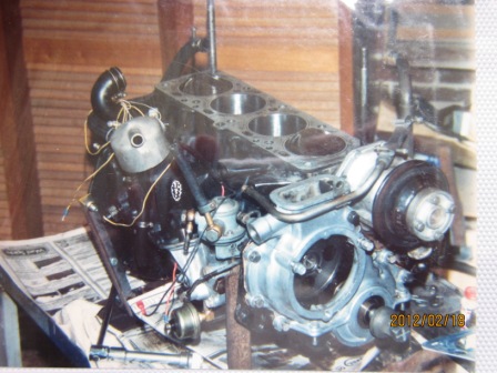

I built this car a long time ago and think it might have been the 2nd one converted to DOHC. I saw another (Warren Degnans ??) at a Bellett Nationals just after i built it.
I saw the car in a front yard on the way home from work and enquired about it. It was owned by a young guy who blew up the motor. It had chromed wheels on it at the time. His dad was glad to see it gone from the yard. Since the motor was shot, i found a 1800 DOHC at an engine importer. Craig bought one also at the time.

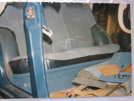

Again, it was painted at home in original colour and fitted with Gemini SL/E interior. Rear seats were done by removing the trim off the Gemini frame and re-fitting to Bellett frame with a minor mode at each end due to Bellett being narrower.

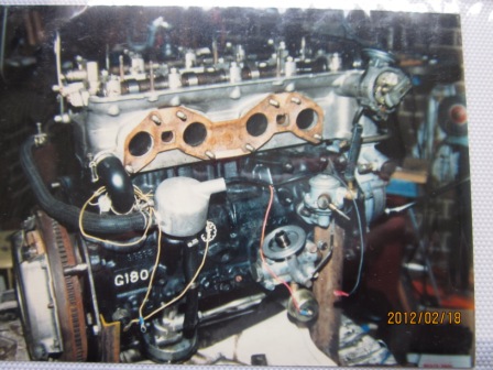

Engine was pulled down and work done to it by a local who was racing a ZZ/R Gemini at the time. Old carbs were shot so I found some 1/75" ex Torana carbs for it. Those triple carbs and manifold worth a lot of money now i guess !

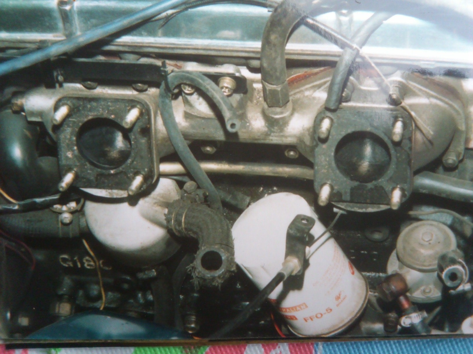

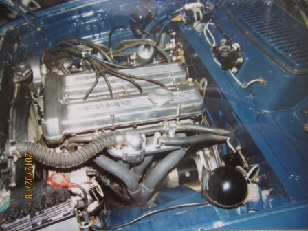

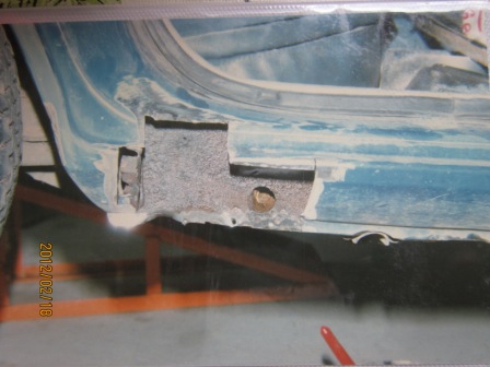

more

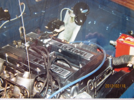

Here it is:
File comment: early DOHC conversion Sedan
Sat Feb 18, 2012 4:13 am

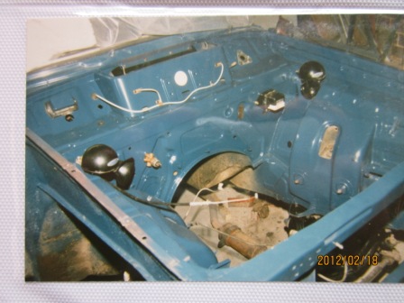

ah, yes, my car: Geoff, I ran all the wiring outside of the engine bay where possible. You can see the lack of wiring in my cars last picture.

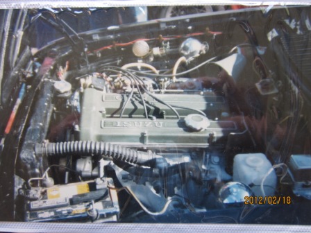

found a few more pictures of my DOHC sedan today when doing some garage cleaning.

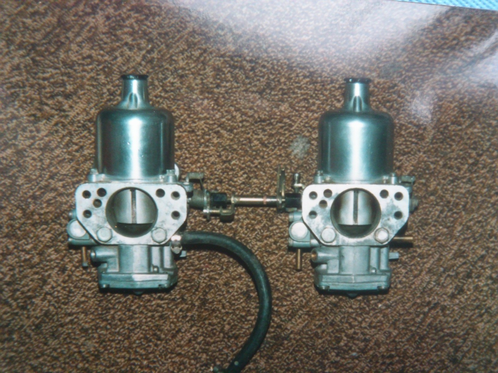

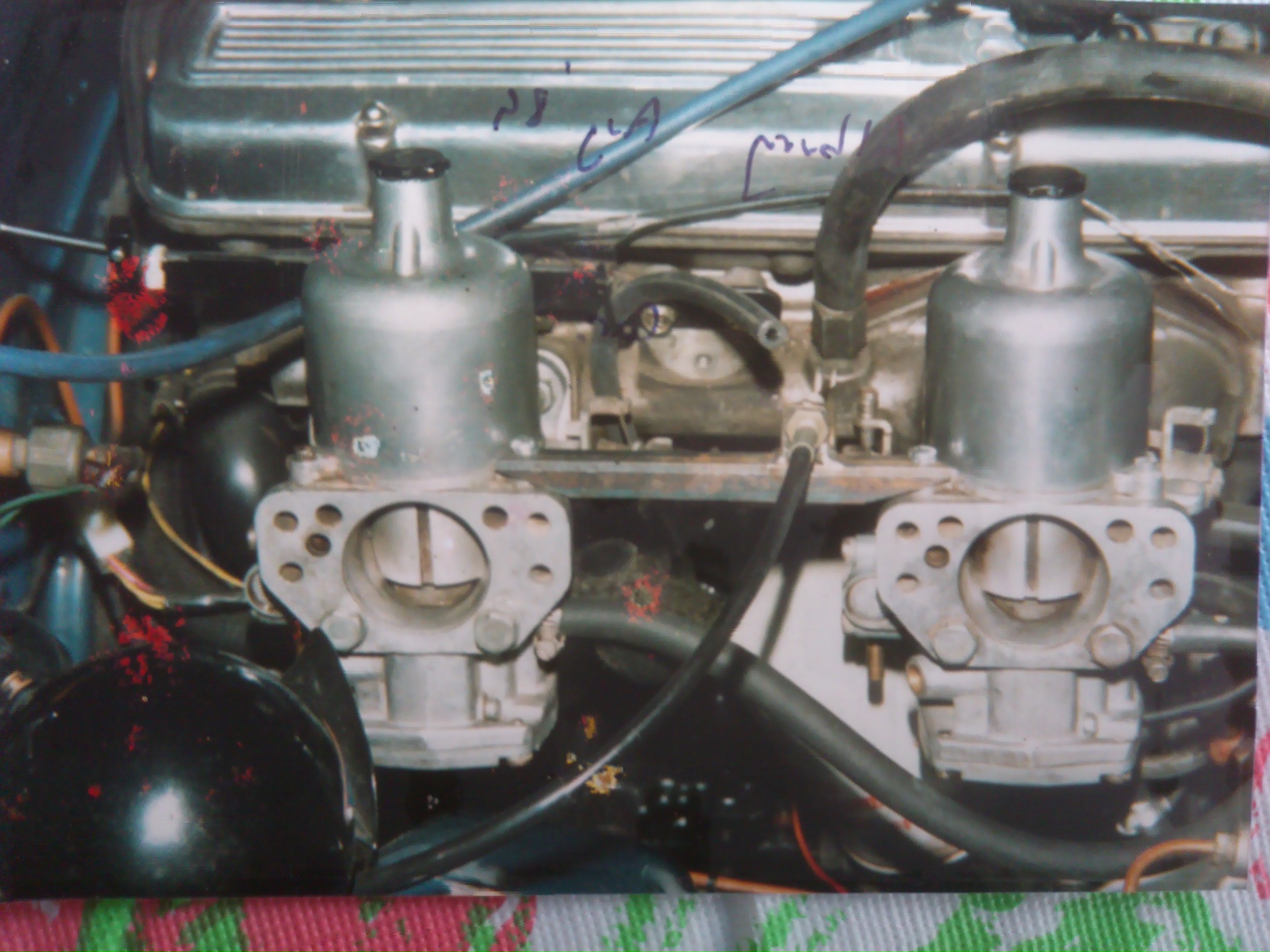

I had the original carbs with the engine but it drove poorly. I found some carbs off a GTR Torana look alike and fitted them. 1.75"
The pictures were taken in 1989.
