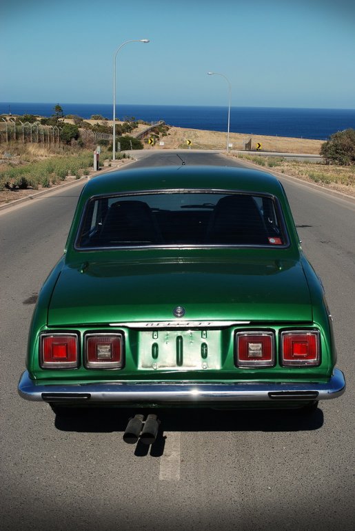

Those that received Bring A Trailer emails would have seen it; both when it was for sale and after as it was featured in a "Success Story" follow up.

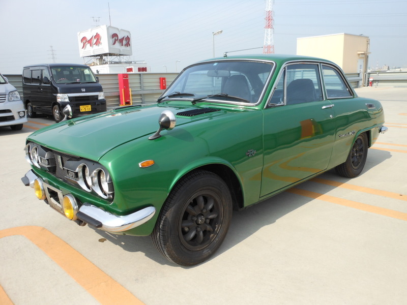

Here's one of the original sales pictures. Unfortunately, it shows an intact passenger-side bumperette... more on that later.

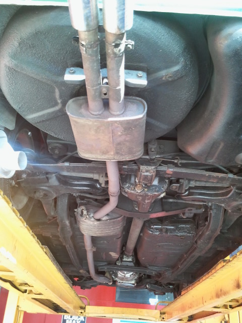

Ross tried to tune it and tune it again; much messing around occurred until he found that one of the needles in one of the Solexes had gone awry and it was spewing fuel into one of the cylinders with reckless abandon.
Ross was good enough to fix it, then I was able to take it to the exhaust place for a new 2" exhaust. The original was well buggered and yes, I'm pretty sure it was the original!
Here's a pic of the original exhaust - it doesn't look knackered in the pic, but it was rusty-as!
The next day I took it to Auto Carburettor Services where the Guru Allan was able to tune it up. He reckons there's some slop in the linkages, which explains why it sometimes gives a stutter before building up revs; the initial splash of fuel is a tad uneven, but once the revs are piling on, it's smooth.

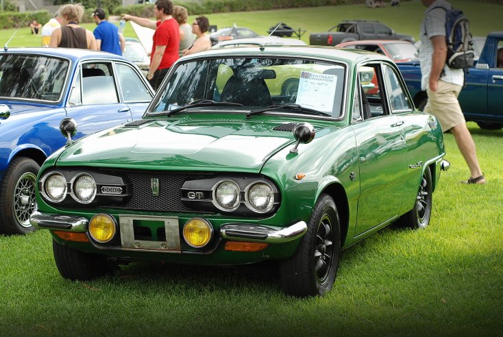

The car is fairly unique amongst Belletts in Australia, being that it was a JDM-specific vehicle. There is now another post 1971- Bellett GT in the country, so mine is not the only example to rock the Legoland tail lights! Dammit!

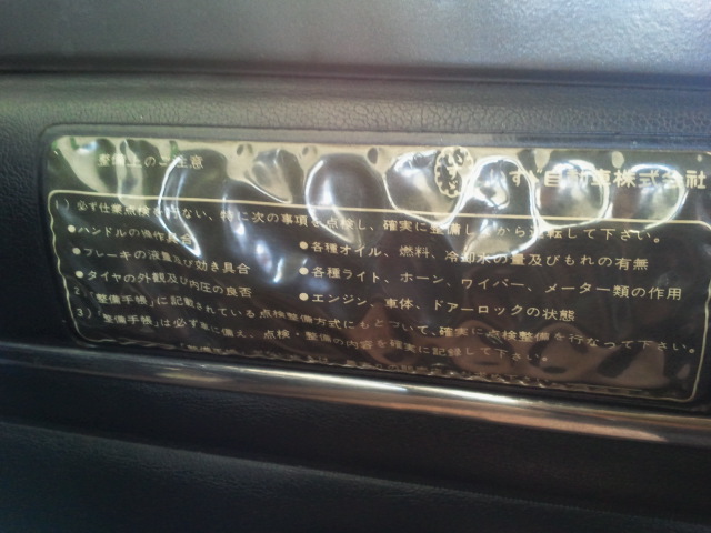

This car has some weird features; the plastic novella bonded into the driver's door trim was pretty weird; Ross says it's mainly about servicing!

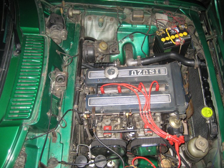

Here's the engine-bay shot again:
The chassis number is not visible here, but it is: PR91-4216574.
This doesn't really lay to rest the PR91W vs no W issue, because of these reasons. Back when the GTR came out, all Bellett GTs were 1600s, regardless of the amount of camshafts fitted. I'm still not taking sides on the W thing, but this car has none, nor does it need one.
By 1972 when the final Bellett model came out, the GT had been upgraded to an 1800cc and therefore the chassis numbers all started with PR95... but this one, as with all 1600cc GTs starts with PR91.
Then I thought to myself, 'what if it's a 1970-71 PR91 that has had the later lights and grille put in it?'
This would mean that it would appear to be a PR91 without any modification to the build number area... and it could mean it's a fake.
So I checked the chassis number against our own numbers we have on the site.
Here are the build numbers for the last few years of the Bellett GT:
70 – GT: 1,461
71 – GT: 1,858
72 – GT: 1,523
73 – GT: 436
We had some chassis numbers on that same page, including this information which is the latest chassis # we had listed with a definite date:
October 1970 chassis # - PR91-4212582
With the GTR's chassis # - PR91-4216574, it means this car was built some 3,992 cars after October 1970. Given that there were 5,278 cars built from 1970-1973 and 3,817 cars between 1971-1973, this more or less puts it as a 1973-build and one of only 436 GTs built in that year.
It's possible it's a 1972, but that's about the earliest it could be, and that still puts it well within PR95 territory.

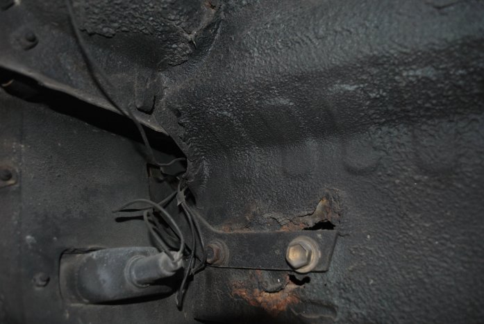

Unfortunately, it's got some rust; none of which I was told about. I did get them to take a photo inside the engine bay of the traditional shock tower, which is clean, but this has rust in about half-dozen other places and some of it is not pretty.
This is among the least-bad...
Overall it seems like a relatively un-molested car... it's copped a fairly quick respray at some stage which only has to have you look at it the wrong way to chip it.... and it's got some filler, as Oz-toffa discovered when he sat his hand on the radiator support panel for some minutes while inspecting the engine bay, only to pull a large slice of paint off when he stood up... it was a sticky day, but that was ridiculous!

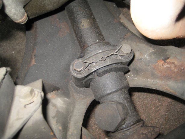

It did still have what appeared to be the original lock-wires for the rack...
... which I have removed in order to try to tighten the rack down a bit. It will need to rubbers there and in other places; the rubber at one end of the front swaybar is just plain gone.

:D Love the car great set of photo's,colour is great,glad you show
the under body photo,save me checking,have this thing about rear
ends of Belletts,4 leaf springs,me too,mine look thicker probably after
market wonder who,enjoy a new toy

The mask grille is even starting to grow on me. Mmm, and the taillights - thems is big-arse taillights! :shock: But is just says "1970s". (I admit that in the '70s I considered fitting an EXTRA pair of '67 style lights to my '66.5. If I wasn't so lazy, I would have! :roll: ) Big lights were the go back then.

Gerry it's got 3-leaves, I'm certain, which was one of the optional Isuzu Motorsport rear ends... PR91 Brett may correct me on this, but I think they had an optional 3-leaf and an optional 5-leaf set up.
Strangely, though for the GTR, neither was standard!!

yep, was an "Isuzu Sports Kit" option.
there was a heavy duty single or a 3 or 5 leaf option as part of each kit, but i think they could be bought separately too.
the stage 1 kit was HD single leaf.
stage 2 was 3 leaf.
and stage 3 was 5 leaf.
oh, and the HD single leaf was part # 51300-276 and cost 2,050 yen.
3 leaf # 51300-351 costing 3,300 yen
5 leaf # 51300-278 costing 3,560 yen.
there's some more useless info!!
Wed Mar 07, 2012 11:43 am
My PR95 also has 3 leaf spring under it,and it looks like it has been there for ever.
