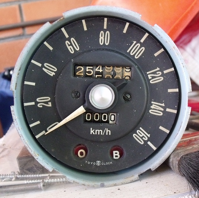

Was finding bits to tidy up the dash on the wasp and hopefully get all the gauges working when I came across this ( pic below )
Its out of an early series bellett and to me looks to be original Km/h.....Is that possible :geek:
Reading the workshop manual it looks like Japanese Cars were Km/h
Did any make it to Australia or is this a mock up :ugeek:

I have no idea really. Not Yazaki though.
Tue Oct 30, 2012 1:16 am
I remember reading in an early road test that the journos had been a bit thrown by the km/h speedo fitted to the test car... of course this was at a time when we were still well and truly in miles.
But I don't know how many cars came to Australia with those dials; possibly only the test car, perhaps an initial batch, although Gary's 1964 has a mph speedo, I'm pretty sure.
I will check my Wasp gauge, which is definitely in miles, and see how it compares to that one.

Yours is a Yazaki Dave which is most common.
Stranger is I just had a look at my wasp and both are marked Toyo Meter and the speedo has been converted to Km/h.
I searched the forum and there was a reference to another wasp with Toyo Gauge but as to Km/h.......no clue!
Whats worse the workshop manual describes a change in 65.

My Wasp speedo is Toyo Clock and is Imperial - max. 100 mph.

Thanks KB
To me it looks like Toyo Clock were early 64/65 and in that same period Yazaki were being phased in!!
Hence both types apearing accross that time!
As for the Km/h, it looks original and by the sounds of it a bit unusual!

both of my Wasp's are Toyo Clock'd in MPH, ala KJB's.
every other one i've seen amounst us is the same, so yours is the rarity.
i'd hazard a guess that yours has been replaced with that KMH one at some stage.
i know some very early sedan's had Toyo's in them and have seen a few around in the past, especially deluxe's, but Yazaki's are the common type in the ones we got.
and again, in MPH.
cheers.

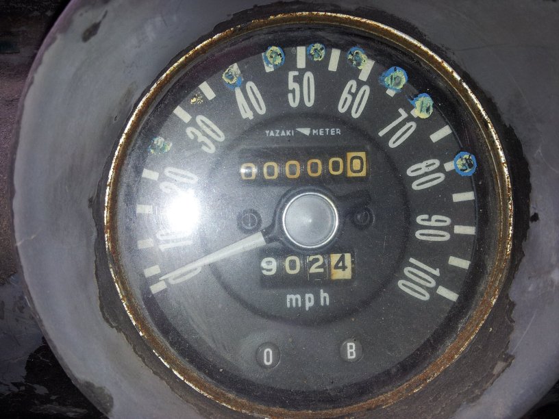

Yeah as you already know, mine is a Yazaki gauge.
Here it is earlier in the year ticking over from 99,999 to 00,000!!!
According to 'Dave' who now owns Bruce A Ruston Signs... when they sold it, it had ticked over 9 times, so that should theoretically make this an unproven MILLION!

Hi Josh, just to add my experience, all Wasps I have known have been Toyo Clock. I have one (only) spare guage cluster, if your guage doesn't work.
I reckon that km/h speedo is a genuine JDM Wasp one. SO very rare!
