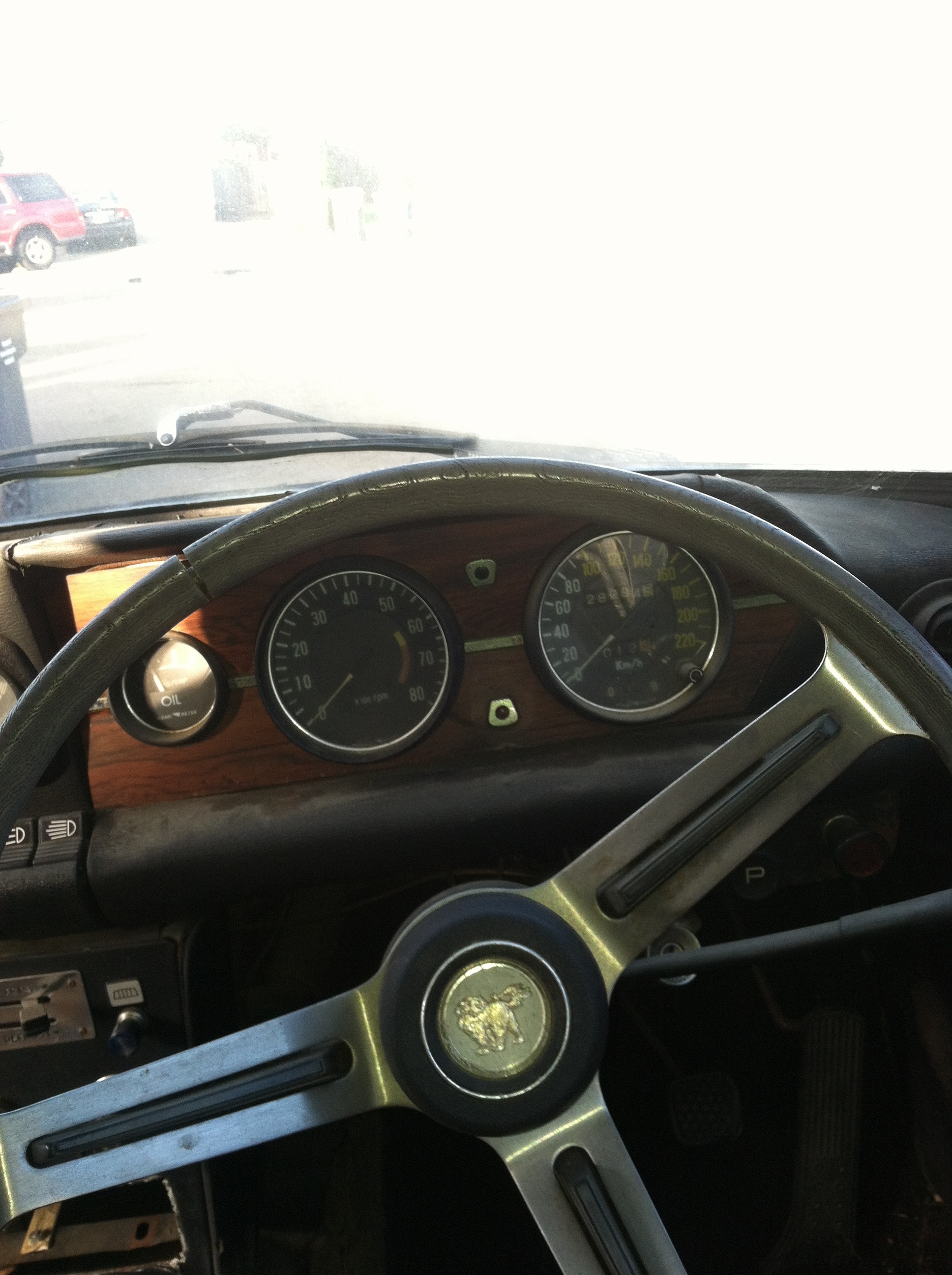

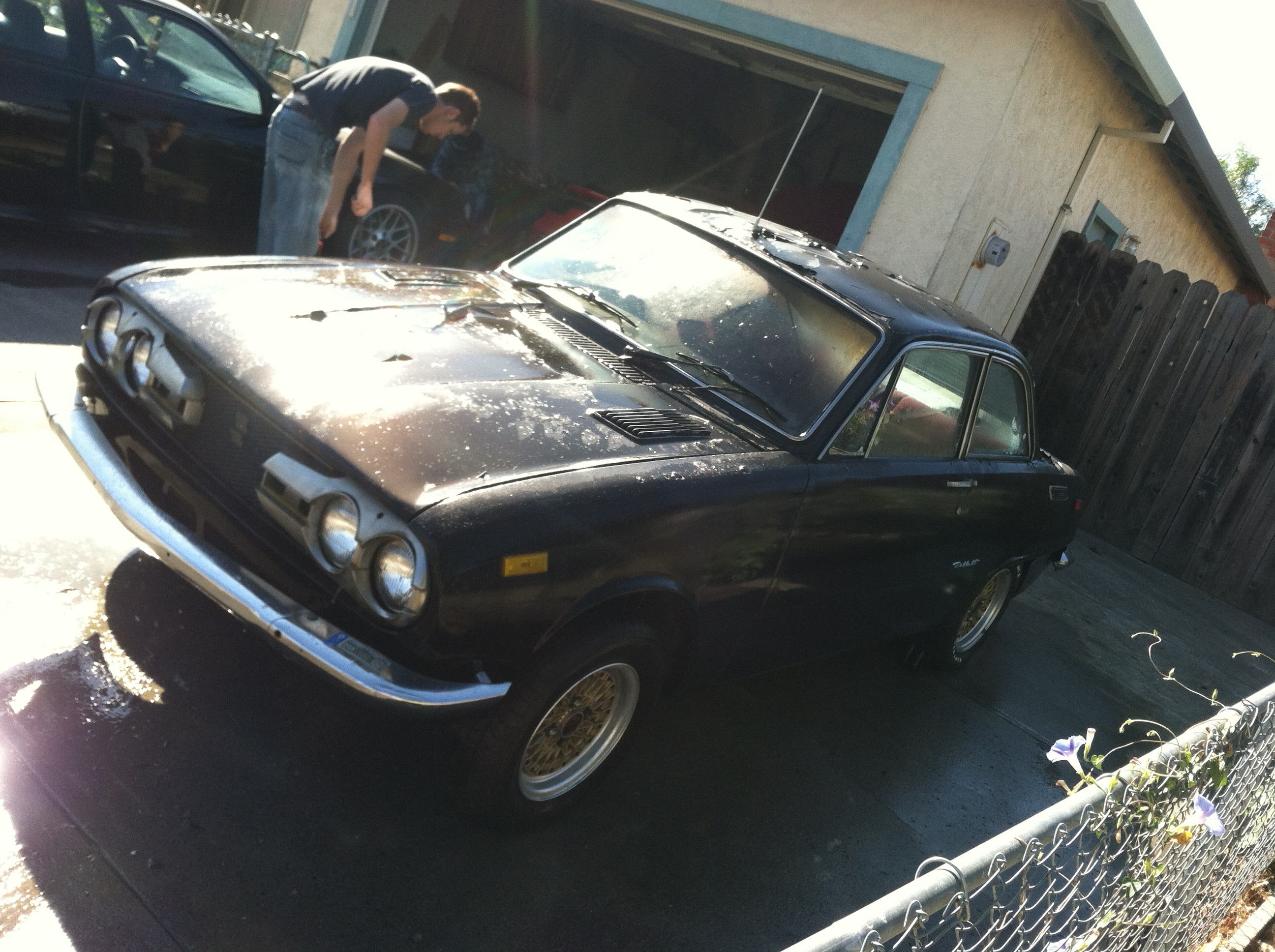

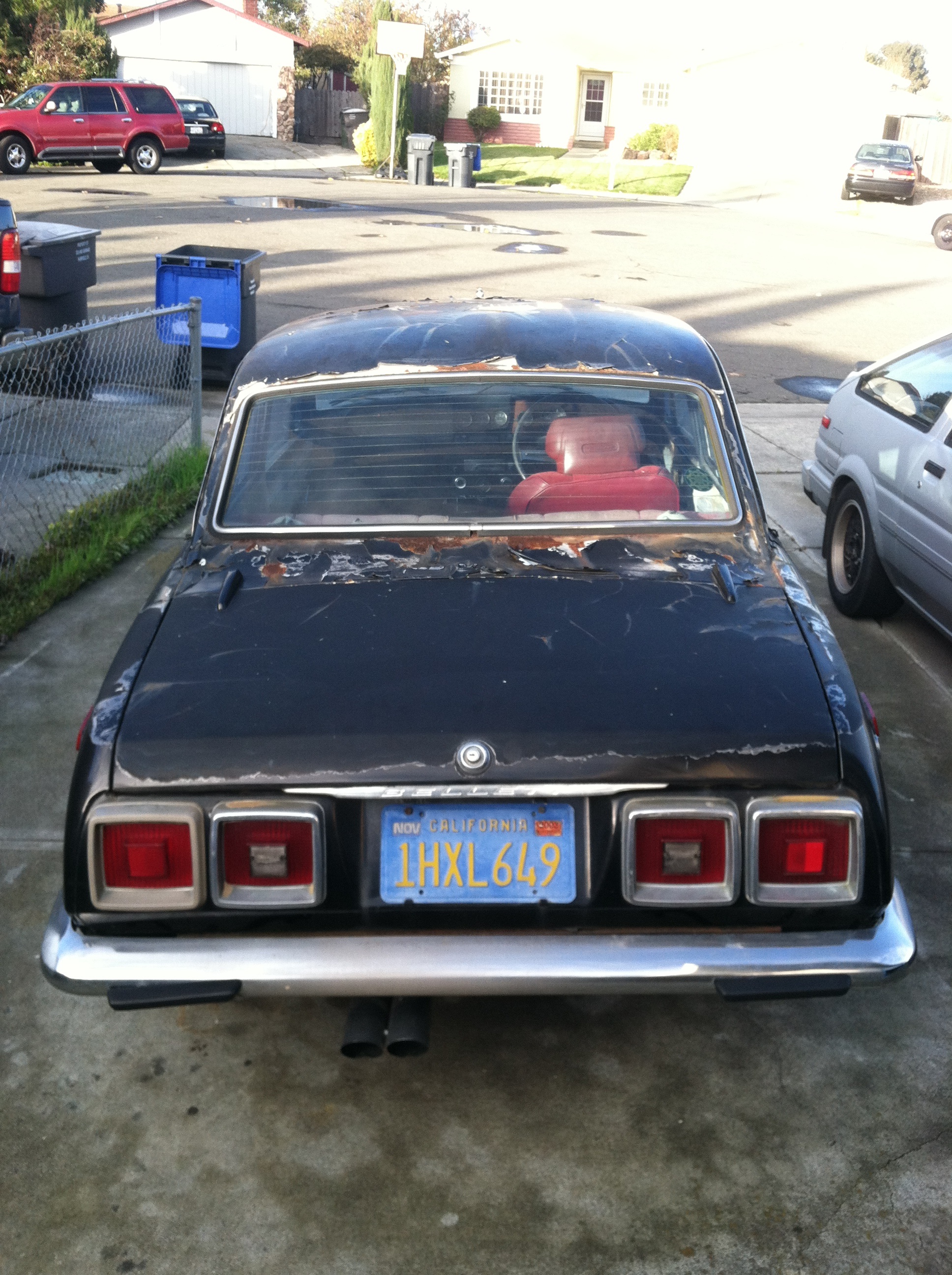

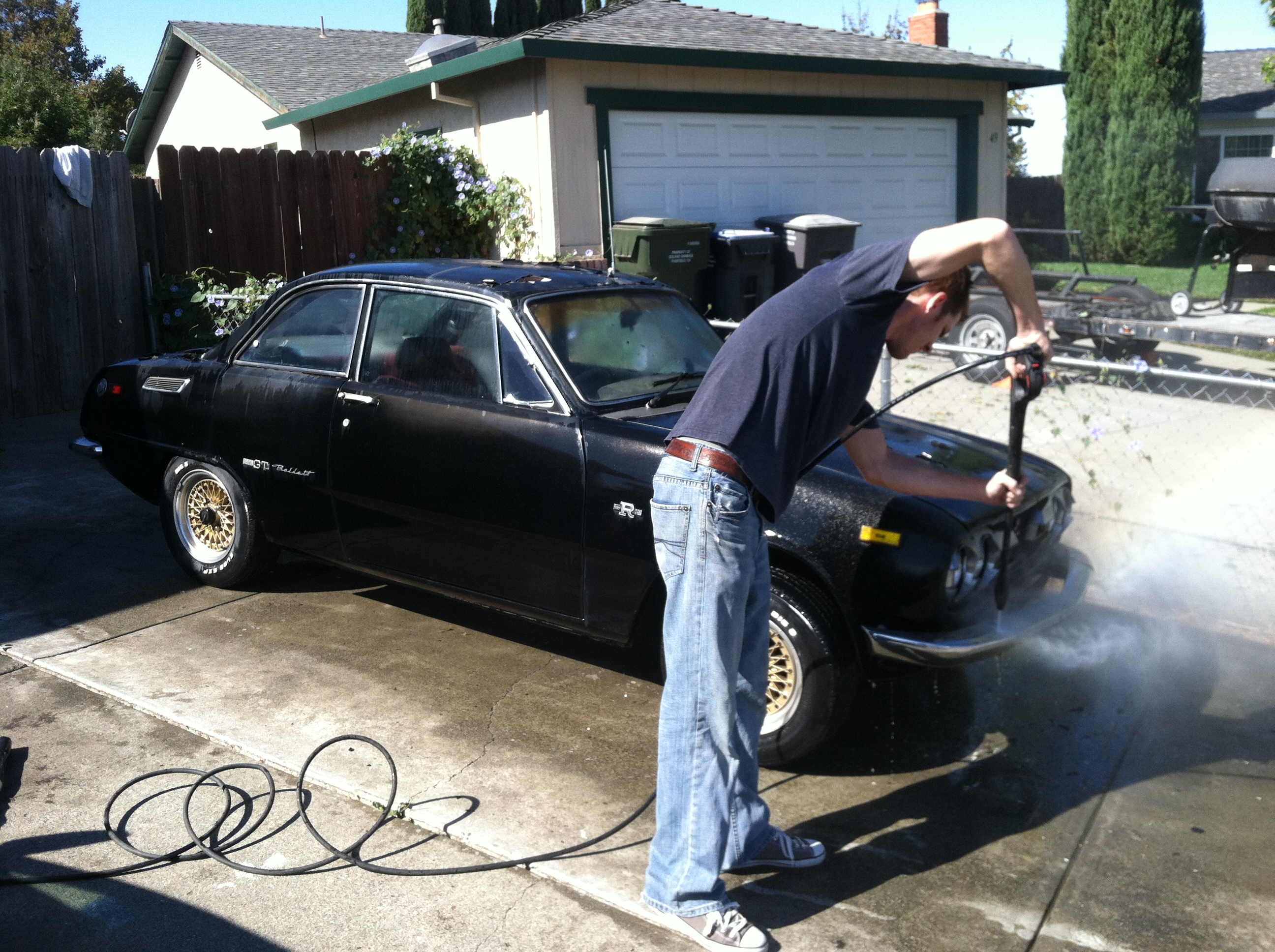

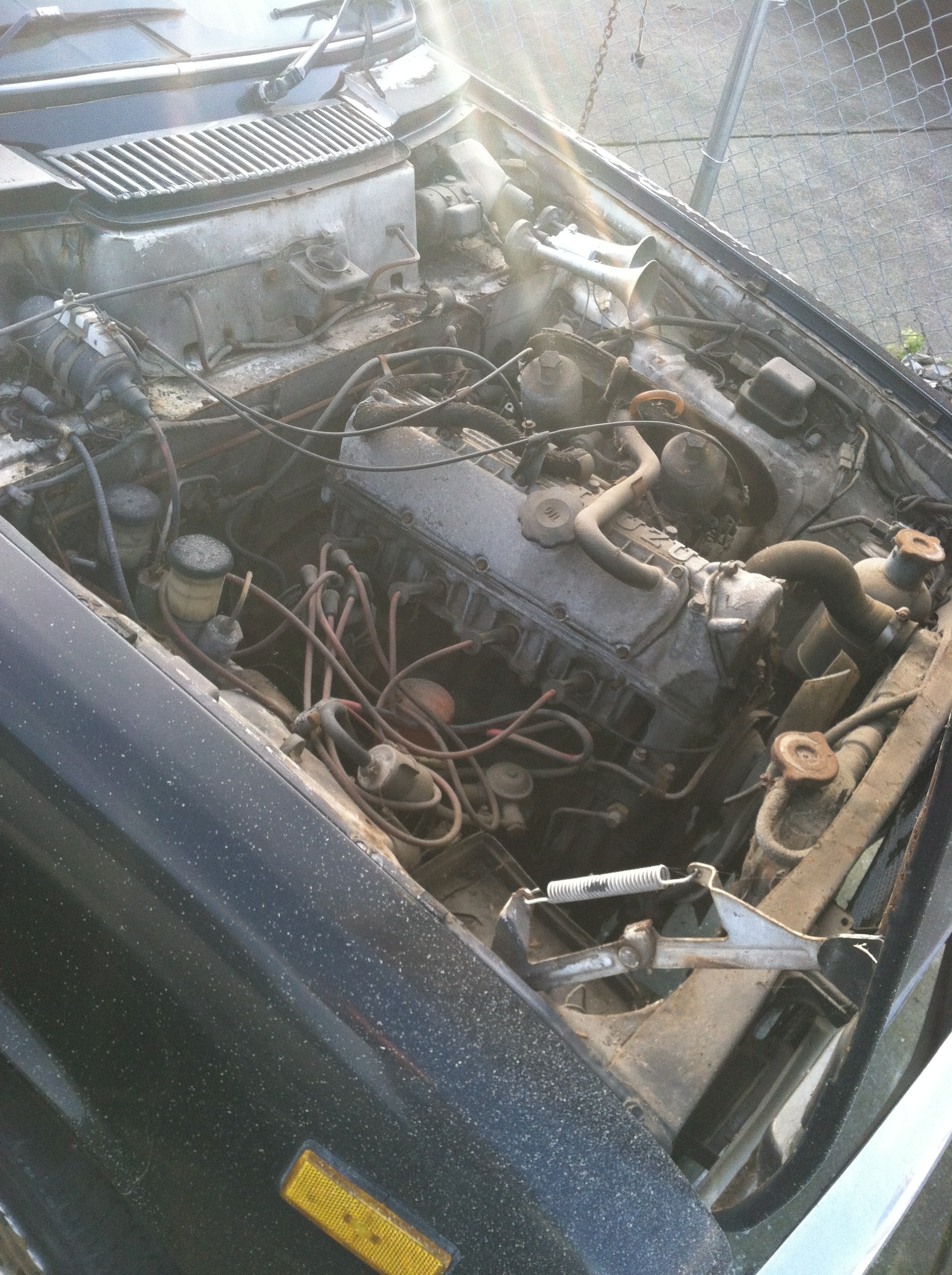

Picked up a pair if 72 gt's from my neighbor earlier this year. I don't have the best of pics yet but they are both in fair-good shape. Some rust on the orange one is pretty nasty but we'll see for sure once it's all blasted.
I do automotive repair and restorations for a living, so all work will be done by myself. I have even been contemplating turning my own polyurethane suspension bushings on the wood lathe at some point. This should be fun.

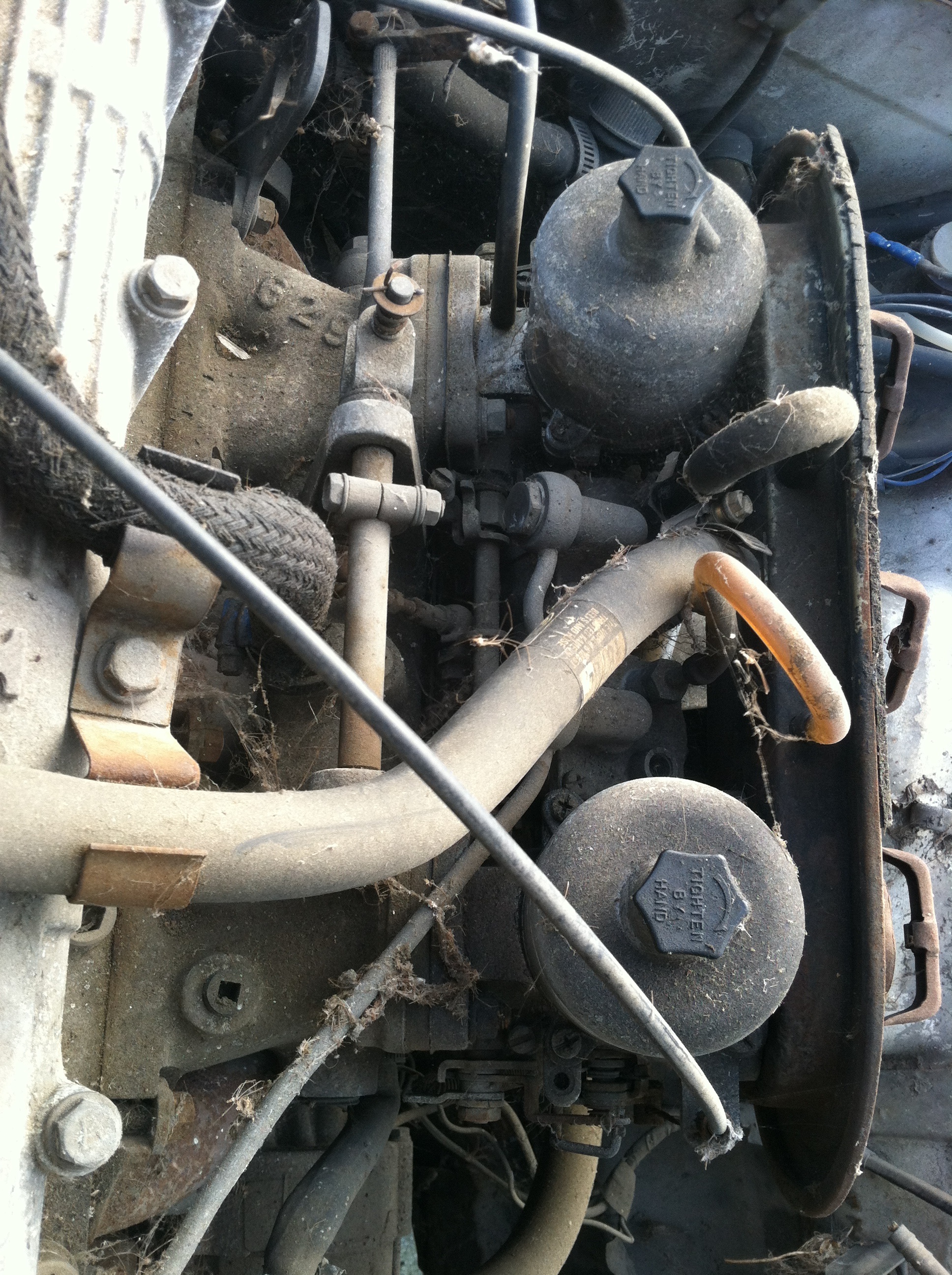

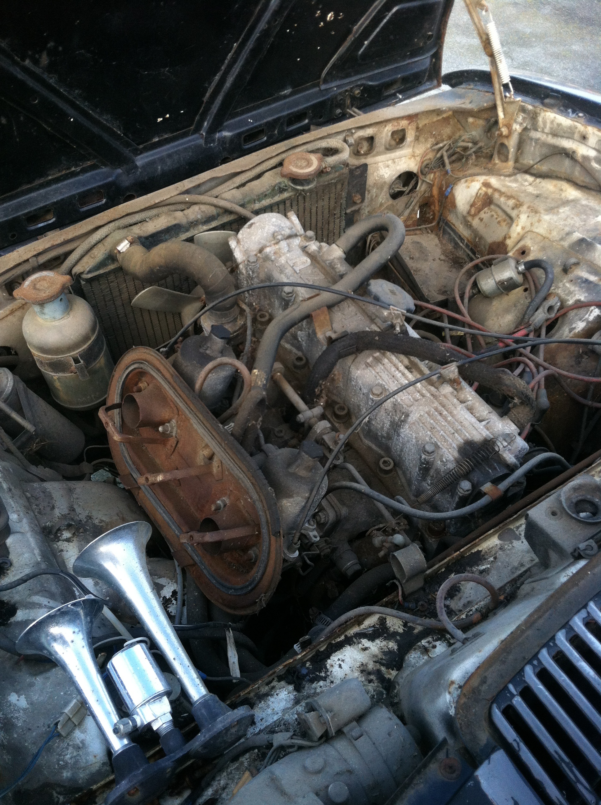

Both cars are complete. The black one has a g180 sohc with the sidedrafts, while the orange vehicle has the downdrafts. I have a feeling that the orange car is going to be restored to as close to factory as possible. The black car was owned by my neighbors family in japan, and if I decide to keep one for myself it will be this one.
I will update pics as they come and look forward to sharing these builds with everyone here. Especially since no one here knows what these are.
If you believe you have any links or info that would be helpful to me please forward them to
thelateralline@gmail.com
Thanks All, Safe and Happy racing
Joe Perdoni

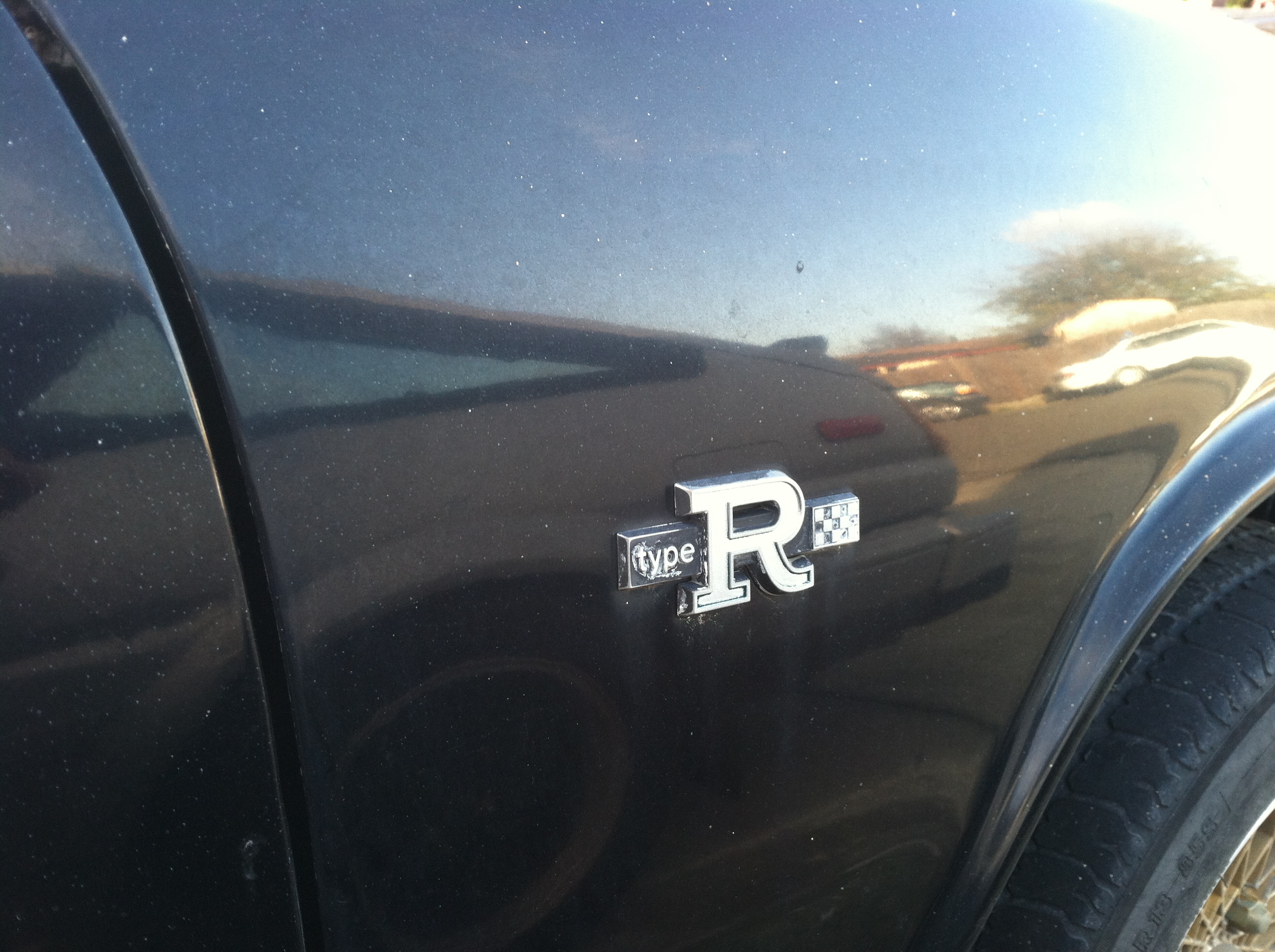

*the black car has (1) GT-R badge. The owner always said it was a gtr, his father says it was sold to him as a gtr. Its a PR95 vin and it only has 1 cam. So I am assuming it is not. It may end up with a CA18DET in the end. Also I do have the original front bumper and lights for the black car, at the time it was imported the feds required that celica bumper be attatched instead.

Hi Joe,
Welcome to the site, and for the photo's, looks like one left hand drive and one right hand drive, nice find and would be rare in USA. I have one same model, and there only 2 of that model GT in Australia, 1 is Type R, other is SOHC 1800GT, and 1 two door sedan(sport). if the black one has spot lights and 2 bumperetts does point to it being TypeR but should have twin cam motor.

nice finds mate, i like the gold wheels on the black one. be sure to have a look through the sight here and ask any questions as there is lots of knowledge to be had here! they are a great fun car!

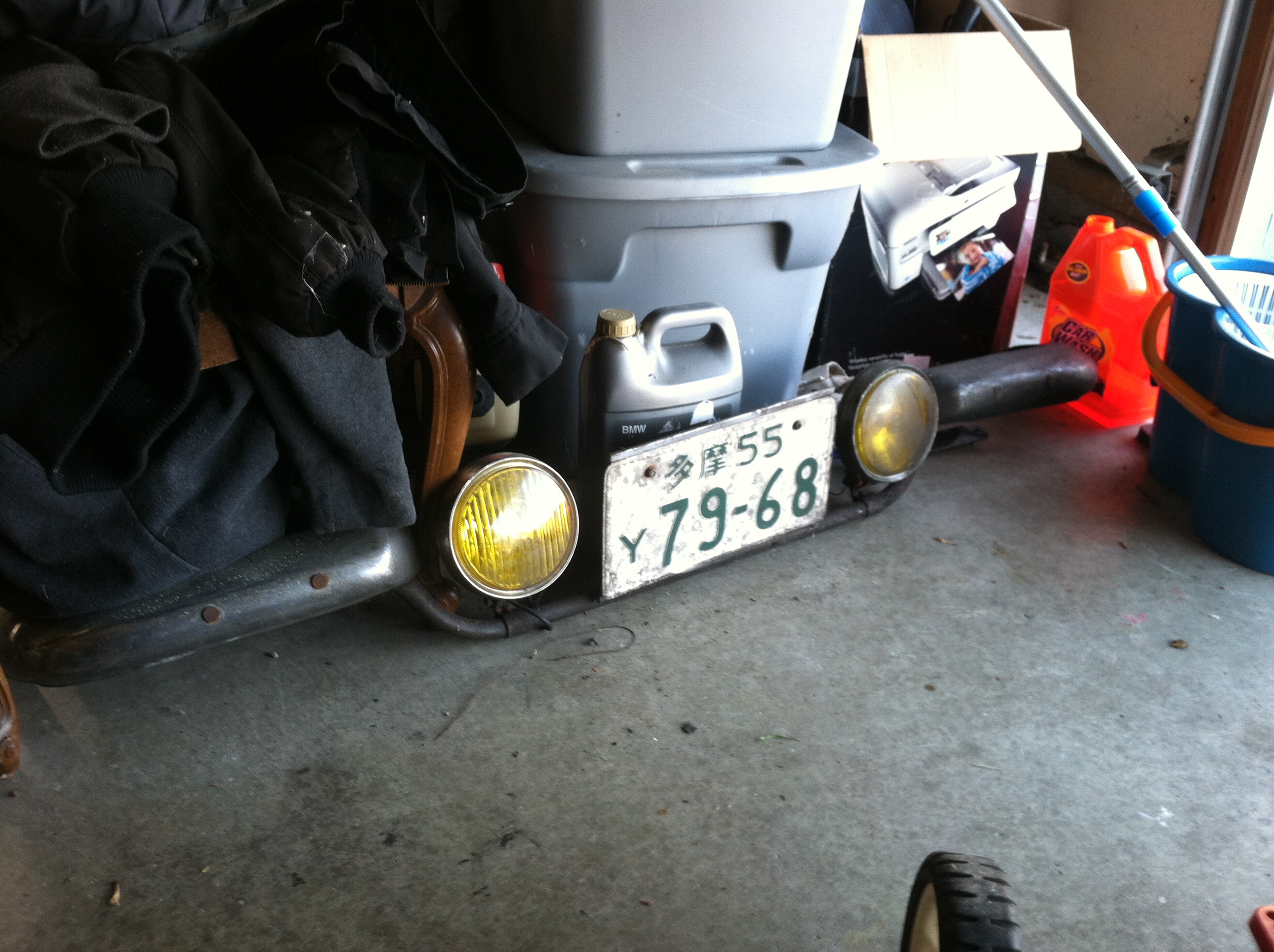

Yes the front bumper for the black car is the dual bumper with the fog lights. I have not picked up the original paperwork from the previous owner from japan however, and I will post any info I find from that.
Both are RHD. Both are 1972. I seem to read that after they went to vin PR95 it gets confusing as to prove GTR or not.

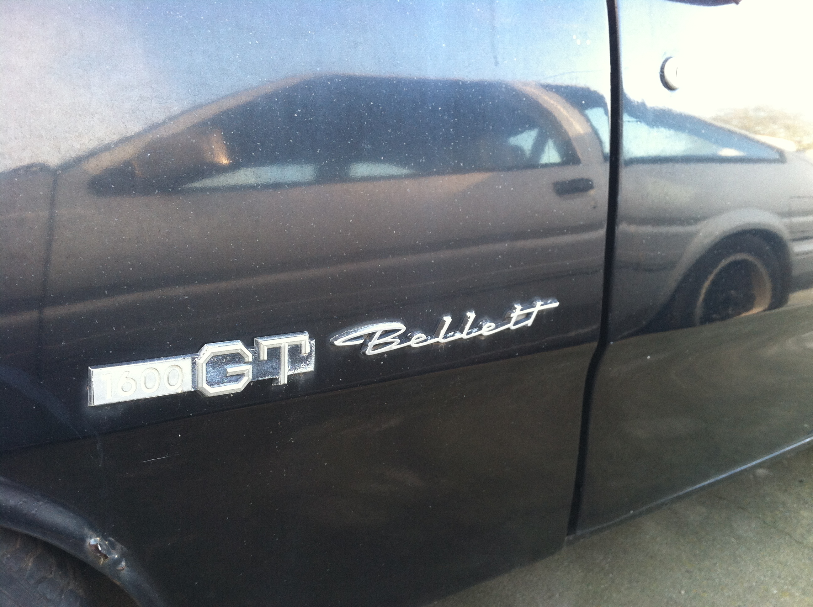

It does have GT1600 badges on the quarters, but definitely has the 1.8 single cam in it.

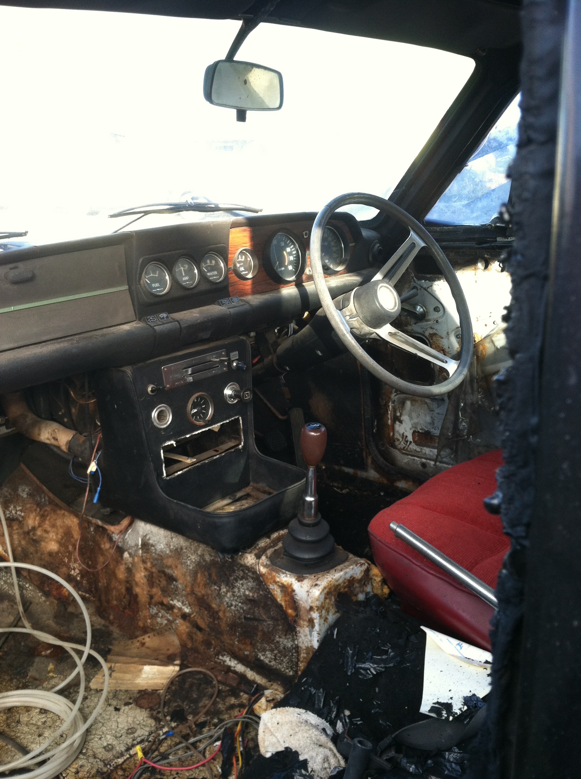

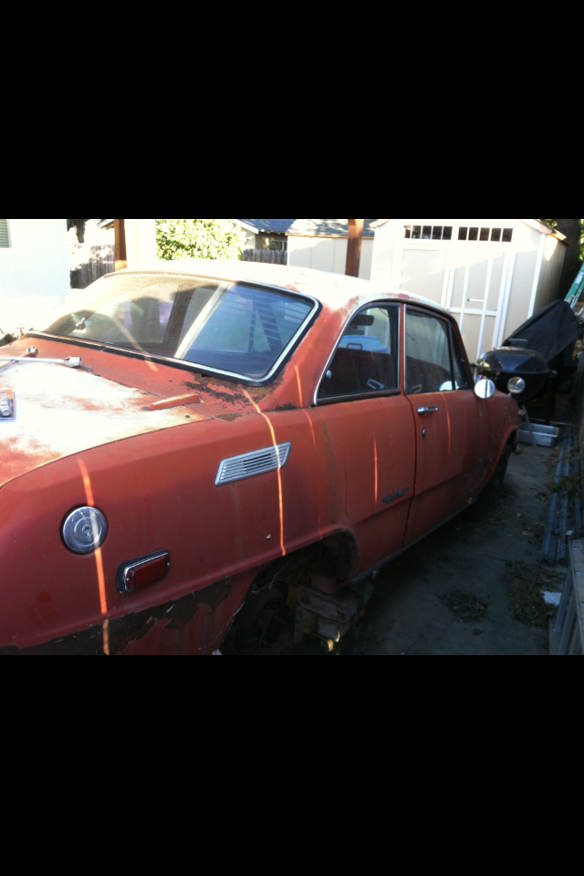

Orange car is still in storage and I haven't been able to dig thru all the goodies in that one. It appears to have quite a bit of stuff inside. Like I mentioned this one does have some rust but after looking at some of the other bellett "before pics" this one isn't that bad. It was purchased from the local airbase sometime in the 90's.
I have 0% belief that this black one is a real R. Im not shy about sharing date codes or vin numbers if anyone has resources to verify, or rather discredit this claim. I will say that the original purchaser is VERY adamant that it is real. They say that in japan it is/was a big no-no to misrepresent a vehicles model or trim level. Either way theres no dual cam under the hood.

Took a few more pics of the key spots before it gets dark. The black car is still in my driveway as I wait to move to a new shop next month. The interior has been swapped between the cars for unknown reasons. I believe I have a complete black interior for this one and the orange car gets the red interior.

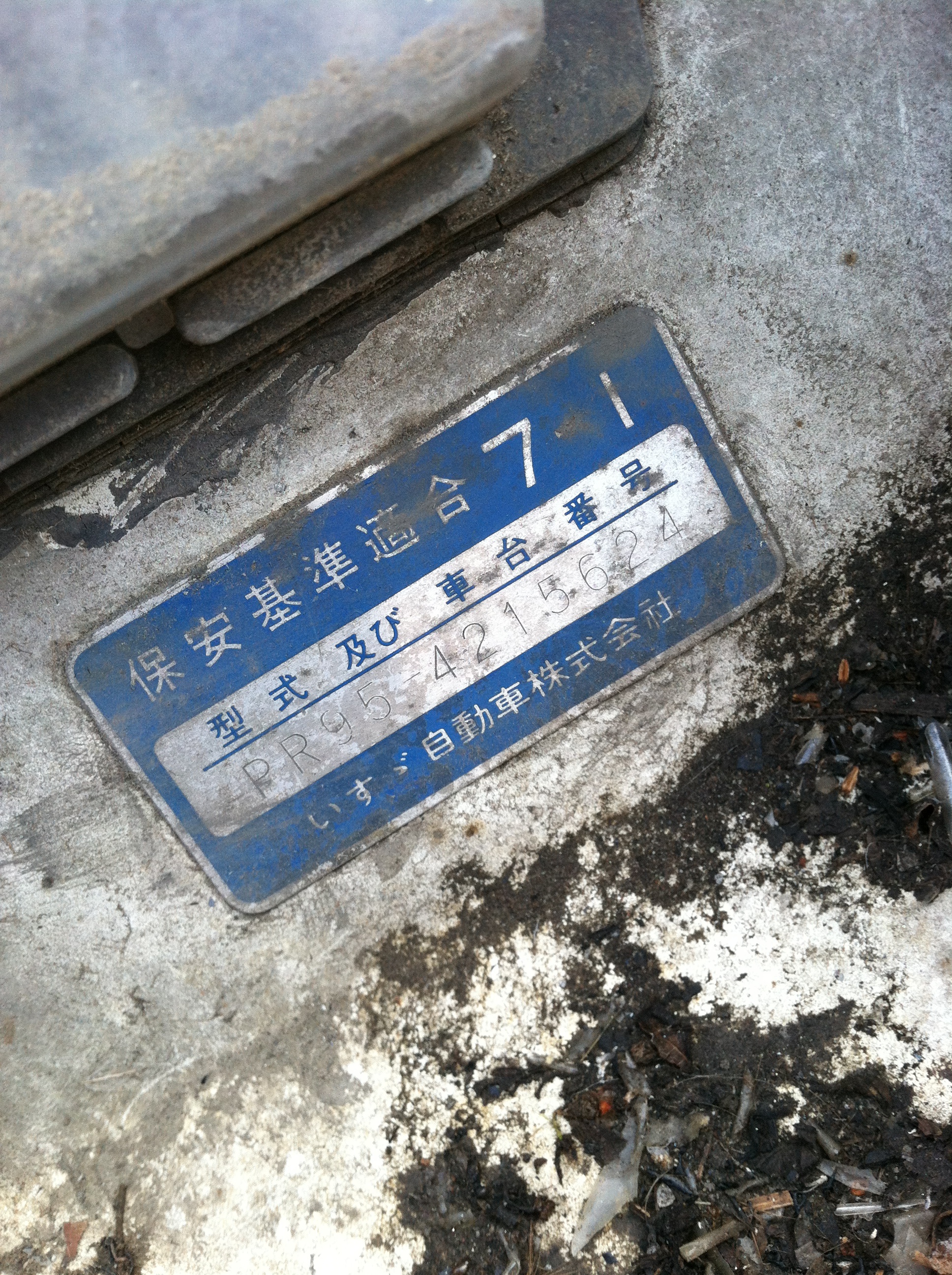

last of them. I wish i'd wiped the junk away from the vin.

Hi Joe,
Your car is 229 cars before mine, PR95 4215853, mine has the early type grill, the emblem on the first steering wheel looks to be 117, 2nd horn button is correct one, and I doubt that your car is Type R,as all the mechanics under the bonnet are the same as mine. doesn't matter much as is still a rare car, and is a GT1800. Windscreen rubbers are no problem and are available in Australia, and some parts are available ex Japan. Engine parts are available USA, as is the same motor that is used in early Chev Luv.

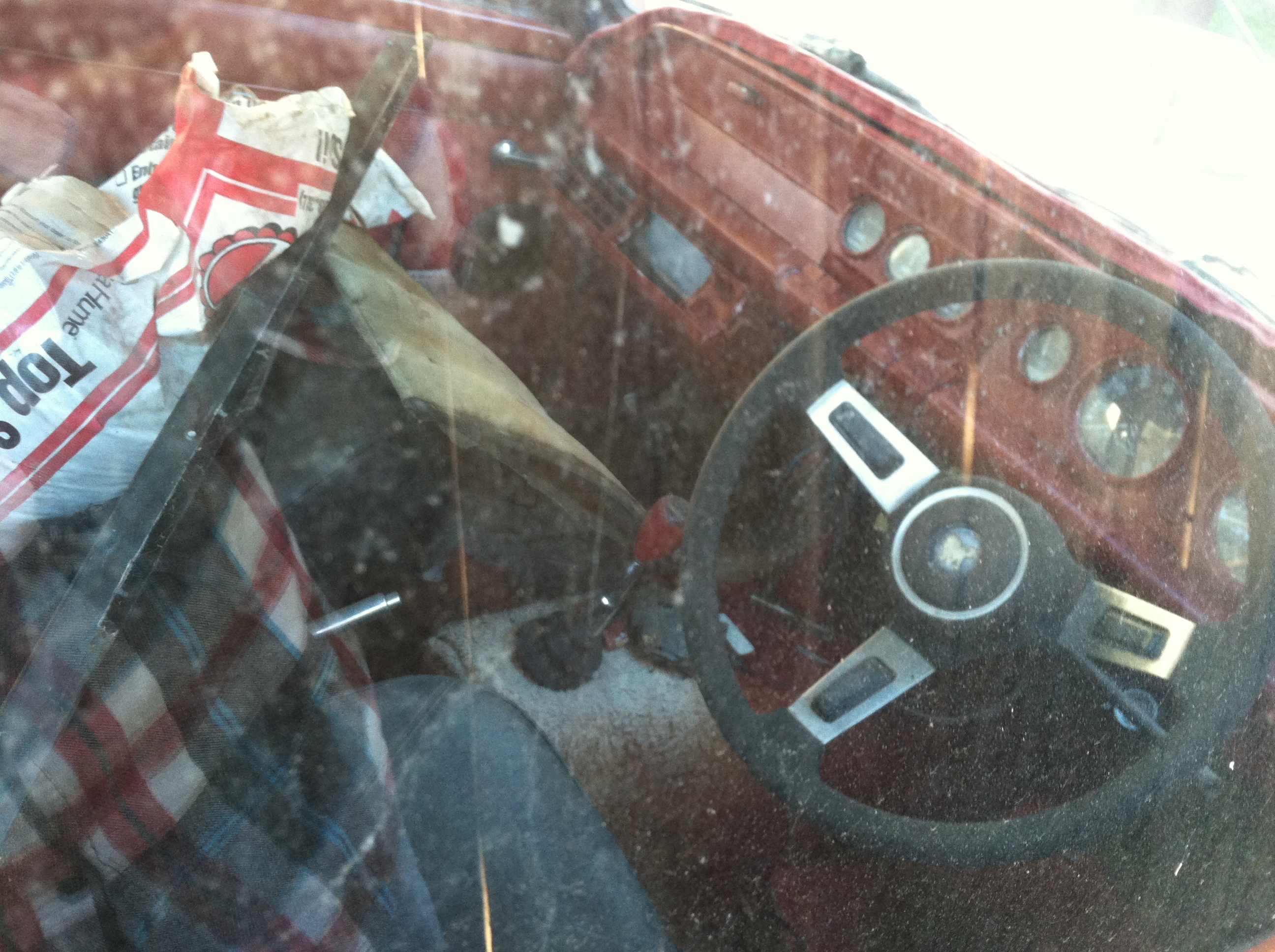

Thanks Geoff. All of the pics are of the same car except the one obvious orange car pic.
The steering wheel is the same one in both pics but I was going to ask if anyone was familiar with the gold lion/griffin on the horn button. The orange car has the same image but the steering wheel is different. I have a slightly horrible pic but you can see the wheel.
Also the orange car is PR954215399. I am noticing the giant 71 in the corner of the vin plate, are these in fact 71's and only registered as 72's?
File comment: orange car interior, yes thats house paint on the dash. hope it peels easily

I think that may be the case with 71, mine is april '72, but doesn't have a plate like yours, the number is stamped into fire wall. Has it still got the original lap type seat belts? If so should be date stamped on them, or if it has a standard rim for the spare, that should also have a date stamp on it also. Another way to tell, is if you check the main wiring harness,near the headlight, just peel back some of the binding and you find that also will have a date on it. Doesn't matter much anyway. Sorry I thought they were different steering wheels, the griffin is a symbol for the 117, the centre of the horn button should have like 2 half circles, the Japanese refer to them as PIG nose. We refer to these models as Short Bonnet, as the earlier models have a longer Bonnet and windscreen wipers work the other way.
Cheers Geoff
Tue Dec 18, 2012 7:21 am
My thoughts and i am happy to be corrected but the pr95-xxxxxx is 1800 and pr91-xxxxxxx is 1600 gtr's were 1600 so based on the above i would say you do not have a gtr on your hands :?: The two late gt's imported to aus with the late tail lights have Daves pr91 1600 twin cam and gtr bumpers and probably a genuine gtr and pr95's car is 1800 based on this fact :?: The later ones of yours have some suspension changes from what we have from the early days to these newer cars that Dave,pr95 and Glenn have so you have to be a little carefull taking some advice and part listings :?: the fact that nobody has had to do anywork on them here to date we don't know what is interchangable either just a little advise you need to keep in mind :?:
