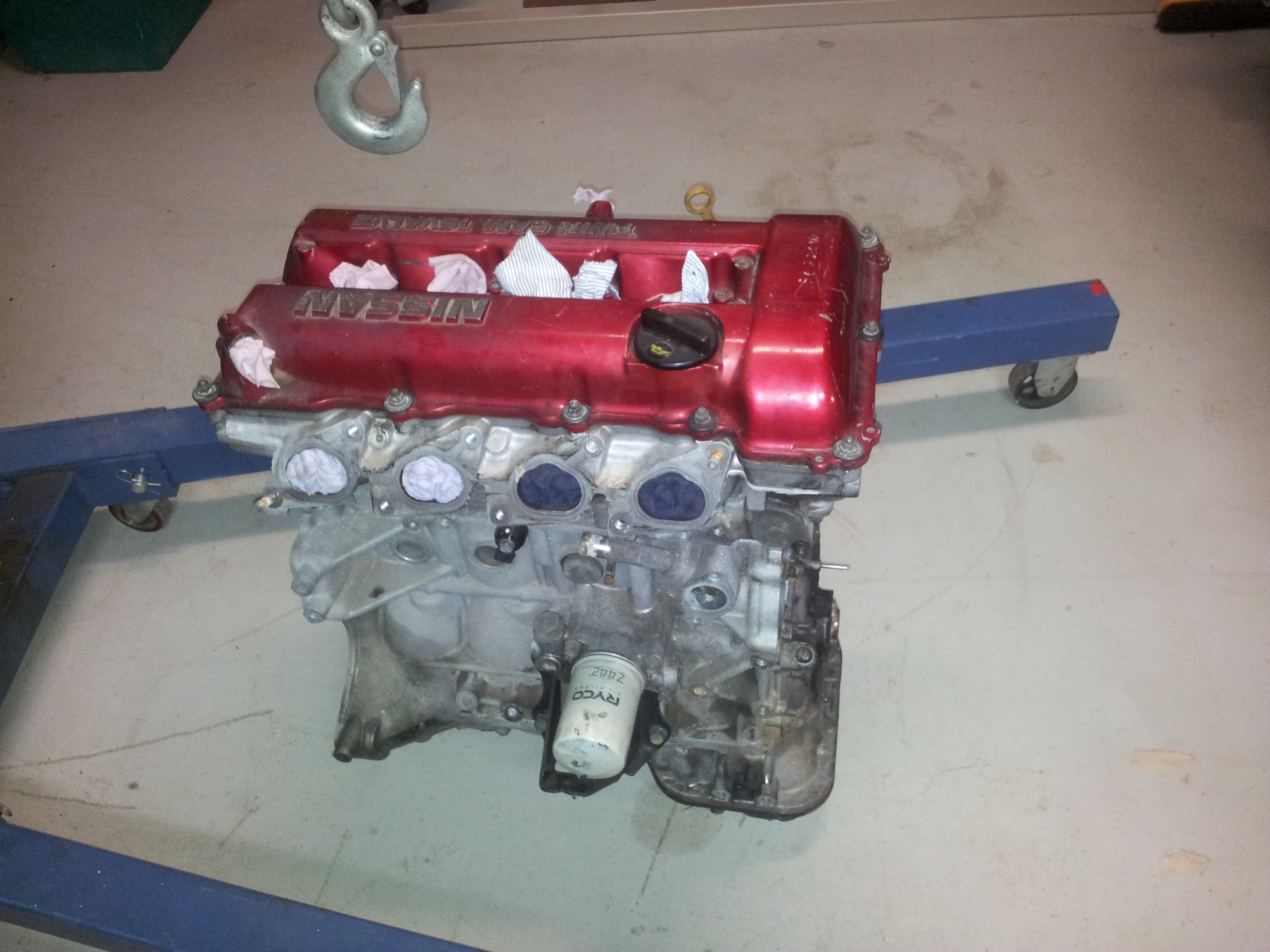

I am finally getting a GT thanks to a couple of members on the this forum, so in a couple of weeks I will be a new owner of a GT Project.
Here is a pic of the new engine which will be the basis of the project as the GT is not complete at all so I have free rain to do as I please, so please don't crucify me too much wavering away from an original car.
I will keep you informed as the project progresses.

:o that looks like fun

especially the Sump clearance.
Many years back I put a DOHC Toyota (gasp) 2TG, bored to 1750cc, motor and 5 speed into a GT.... the white GT that was mine and been around a little bit since departing from Vic. ..Vic, QLD, SA, back to Vic
In those early days getting an Isuzu DOHC was a dream but later it did come about. The toyota had the same problem and although I did a lot of mods to the sump, the oil pickup was a big problem.
Perhaps there is some mix and match available though for the Nissan, to move the pickup rearwards?
Look forward to seeing the GT project here.

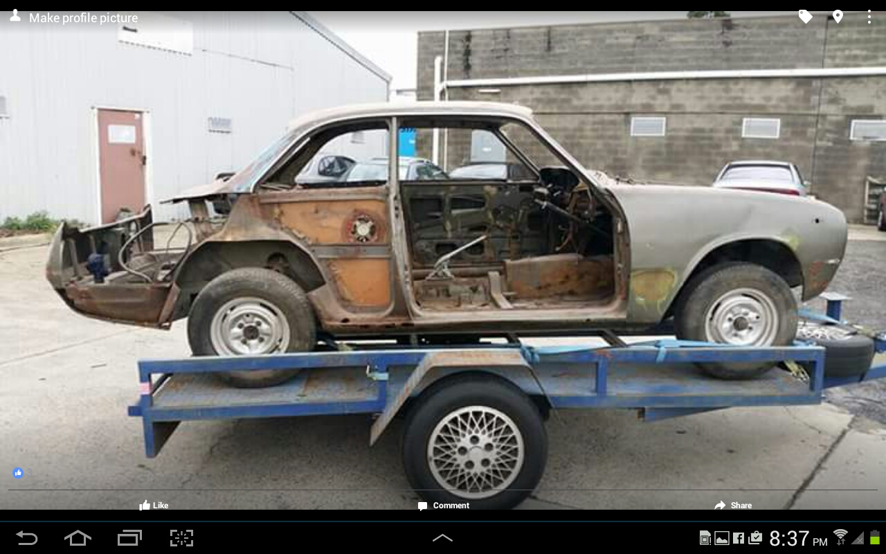

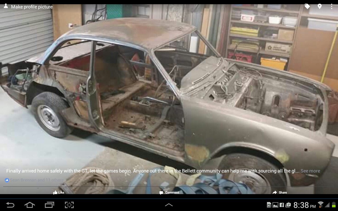

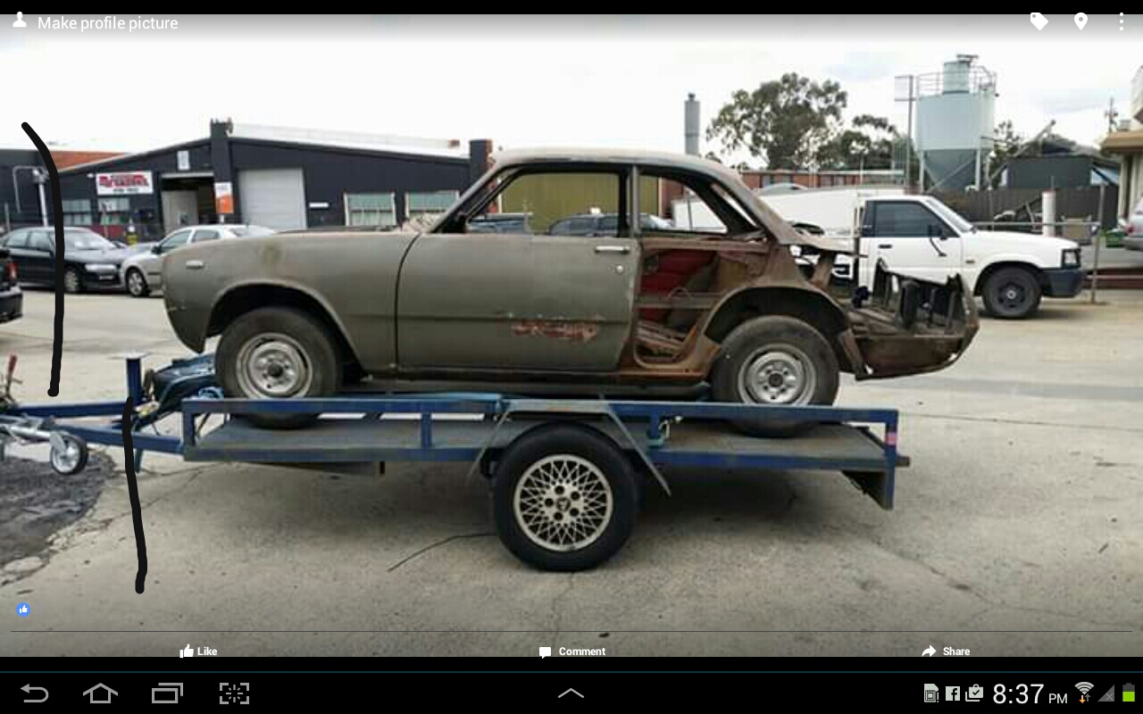

Finally picked up the GT shell so the fun starts. I just need the quarters now to get it looking like a GT again. A big thanks to OZ & Craig.
If anyone can help with glass for the whole car as you can see there is none. I have been searching on Yahoo Japan and have found glass but not sure how successful it would be to ship home.
Pick up my gearbox on Saturday so will post once I have the engine sitting in the bay to see what issues will arise.
