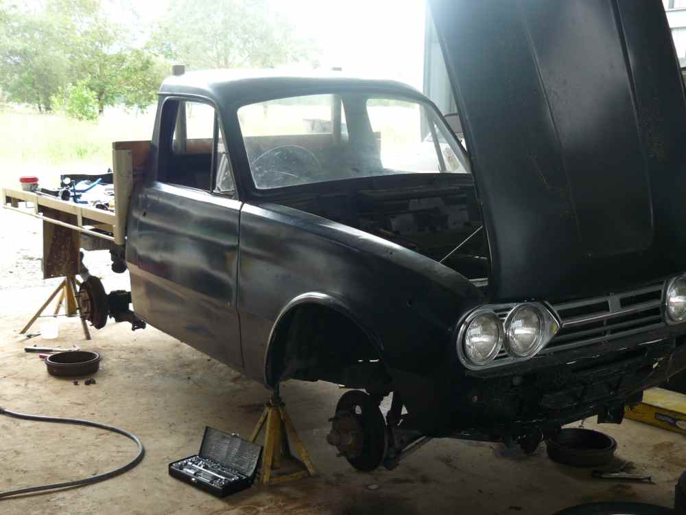

Well she may not be perfect(yet) but shes all mine. I finally got the brakes finished. All new brake lines,wheel cylinders and rebonded shoes. I have a few bits and pieces away at the powdercoaters and the dash mat is at the restoration company.(If i only had a button for my glove box).....Haven't really decided what to do with the tray, tossing around a few ideas...and the colour, well theres another argument..discussion.

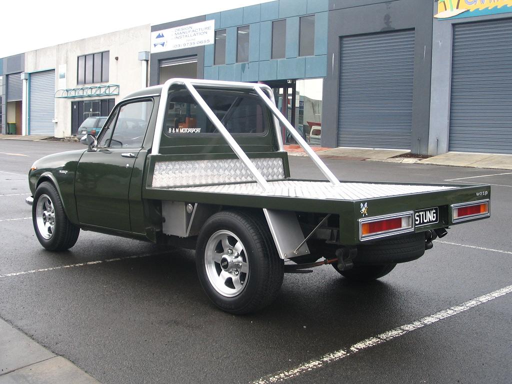

liz, here's mine:
was done in 1994.
i wanted to do a jarrah timber type of thing, but back then, the timber alone was going to cost over $1k, before any frame was made to hold it, let alone tailights, etc, and on an apprentices wages...... :lol:
steel prices have since gone thru the roof, so maybe the timber vs steel/alloy comparison might be better these days.
mine uses a 2 inch and 3 inch steel tube frame, with alloy an checkerplate floor and bargeboard as a result. the fact that a mate owns an aluminium fab business helped that decision!
the tailights are 1978 ford LTD, and are mounted in a heavily worked piece of 6X4 steel tube.
we made it the same width as the tray, as i think the whole 'tray wider than the cab' look was far to 'tradies ute' for what i wanted.
it stayed that way (in that, i flat tray, no roll bar) for about 10 years, but a always thought it needed something on the tray so it didn't look like a bellett had been cut behind the front doors and a tray whacked on the back, so we made the roll bar, which is actually just 2 inch exhaust pipe, hence just for looks, not strength.
hope this helps.

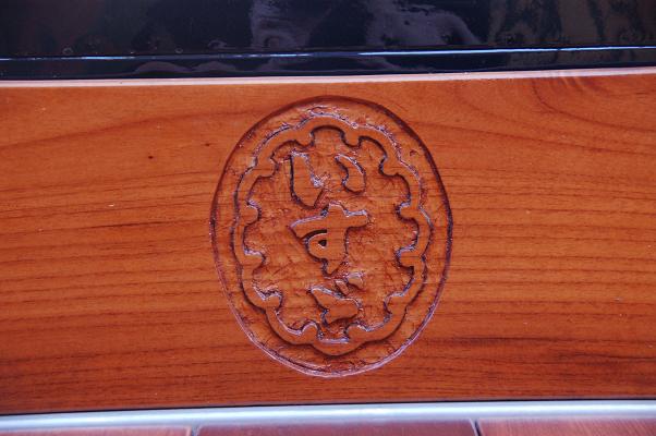

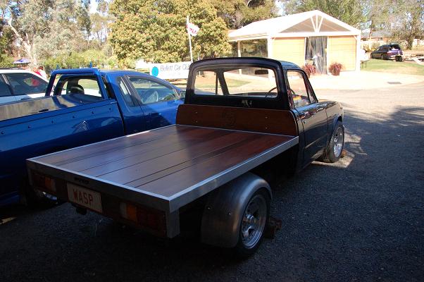

have a look at user "ocka"s dark blue Wasp in the 'nationals honour roll' thread. he's done a beauuuuuuuuuuutiful job with jarrah(??) on his tray. even has a hand carved isuzu symbol in the bargeboard behind the cab. really looks good.
after looking at the pic in that thread, i then realised it doesn't show the tray area....... good move brett!
as 'ocka' is a really nice bloke, and a good mate, i'm sure he won't mind a few pics posted og his beautiful, but unfinished at the time of the pics, Wasp resto.
i hope i have the details correct, but the tray surround is hand formed stainless steel, and the recessed floor, bargeboard and tailight panel are polished jarrah(??)
as u can see, the awesome old style isuzu symbol has been hand carved into the bargeboard. really really nice too!!
the rear guards are a work of art too. they are stainless again, hand rolled, and actually mounted to the diff housing, so as the wheel travels up and down on the suspension, the guard travels with the wheel, instead of moving with the body. this same idea is what is used on many hotrod's with 'cycle' guards. very very unique idea for a Wasp, and looks great on ocka's example.
the tray:
