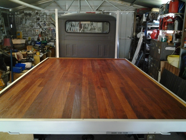

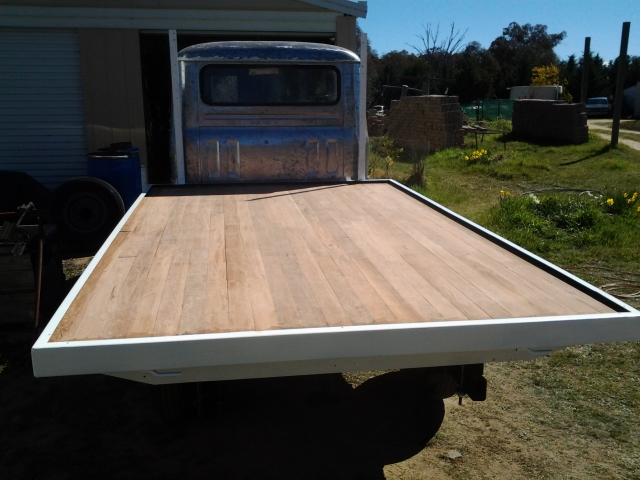

Sanding the boards, ready for oiling.
I filled the faults with clear epoxy first. The boards are back out to be sealed all round.
Step by step.

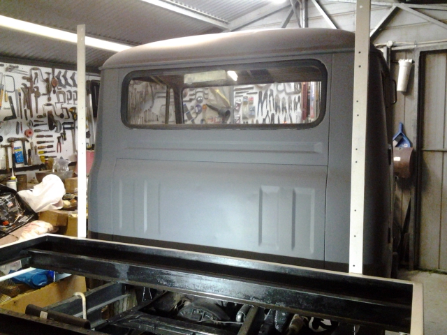

Had a fine day with no wind, so whipped the tray back off and put some primer on that bare metal.
Then back on it went, ready for the boards to go back in.

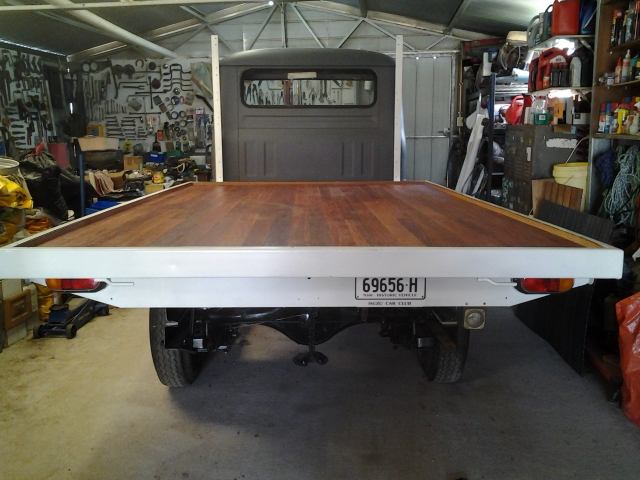

Finally got those boards all oiled up and fixed in place. Joy!
Lights all sorted and everything works, even the original reversing light! Just had to solder the wires back on to the switch in the gearbox.

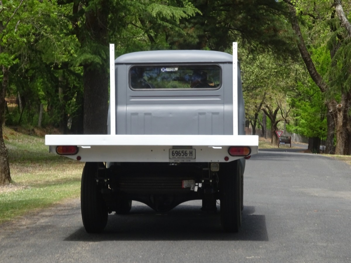

Waterpump fitted and all good. A few more odd jobs and it was time for a run to town for some tyres.

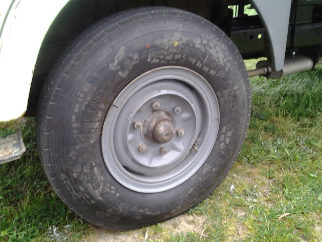

Its amazing the difference new radials make. The trip in was pretty steady as the old rags were pretty hard and crackly.
Now it rides better, steers better and goes better.

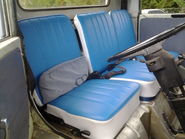

Got the re covered seats in there.
Yeah, they're bright, but Dobby likes bright colours. And like Dougie the tyre service guy said, they'll bed in. Just needs a few thousand kays worth if bums.
So he went great all the way home, but then he wouldn't idle. So tomorrow brings a carb investigation. Ah well better now than on the road to Mudgee. ;)

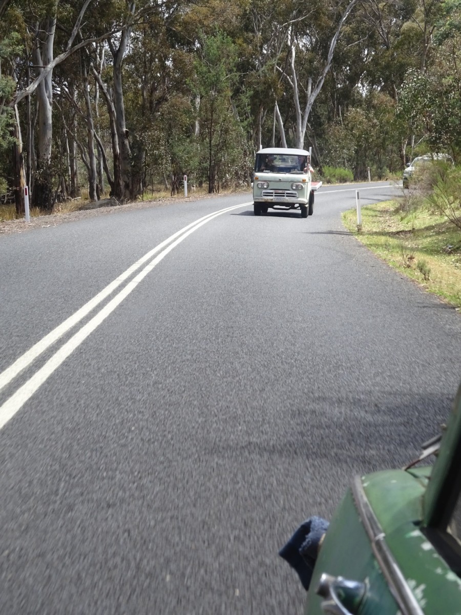

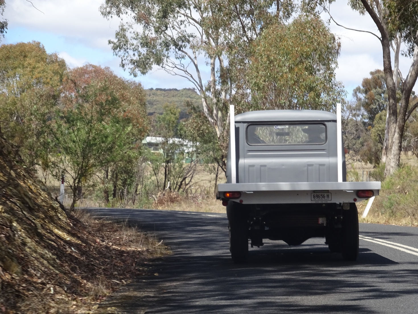

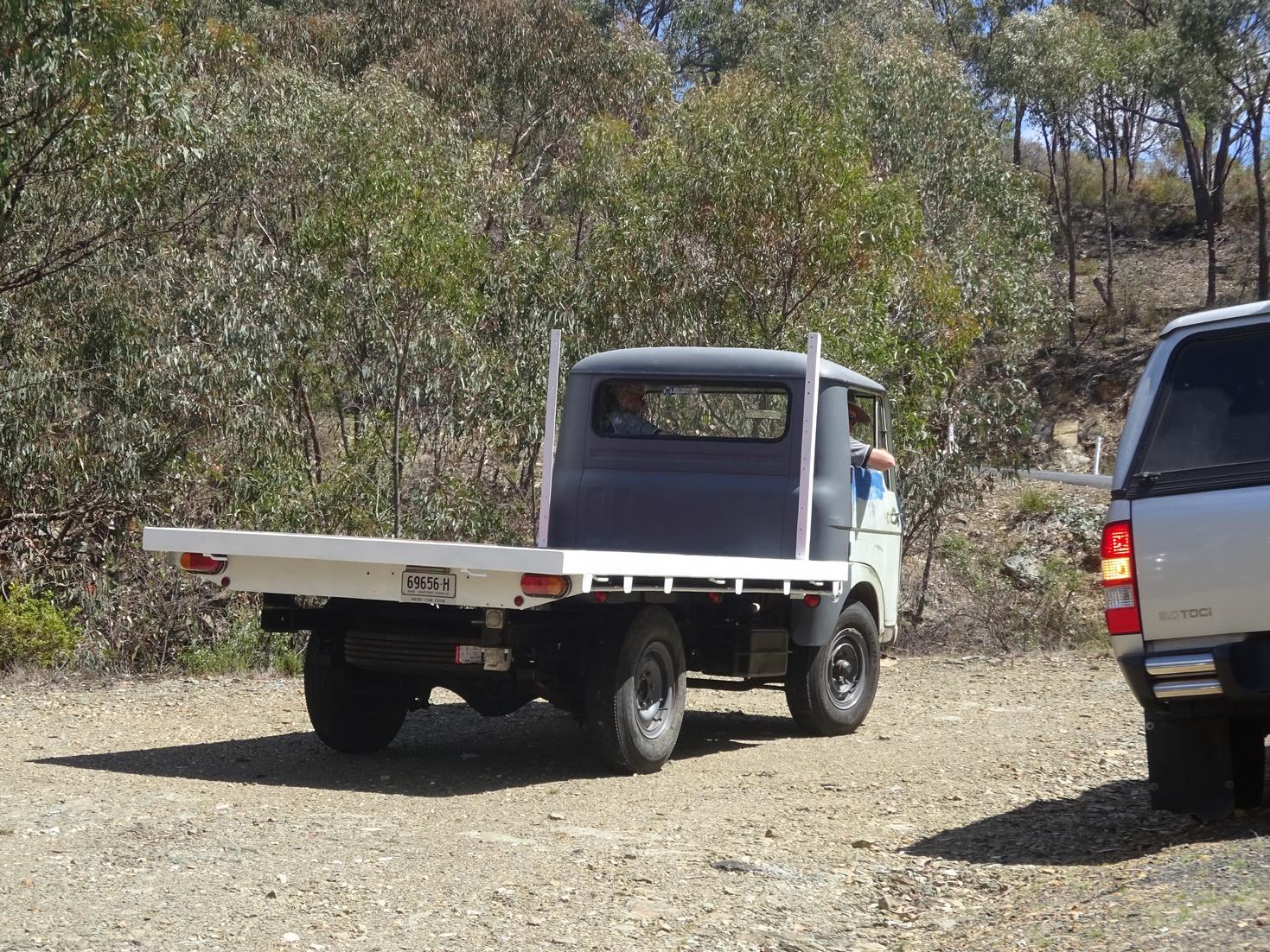

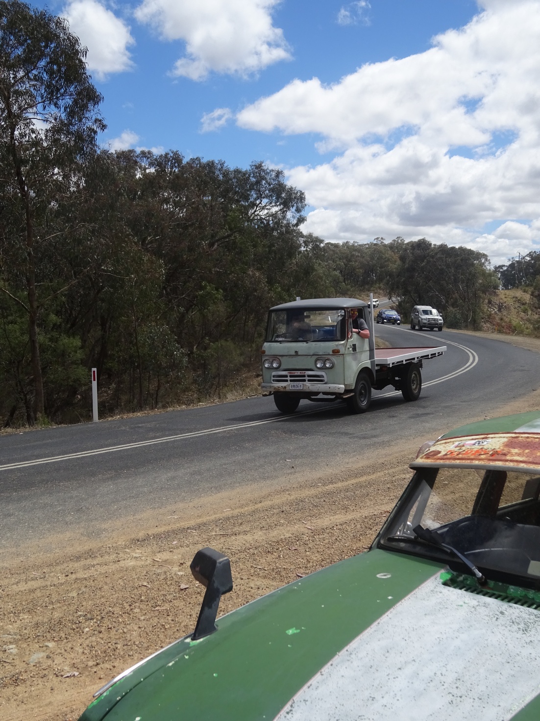

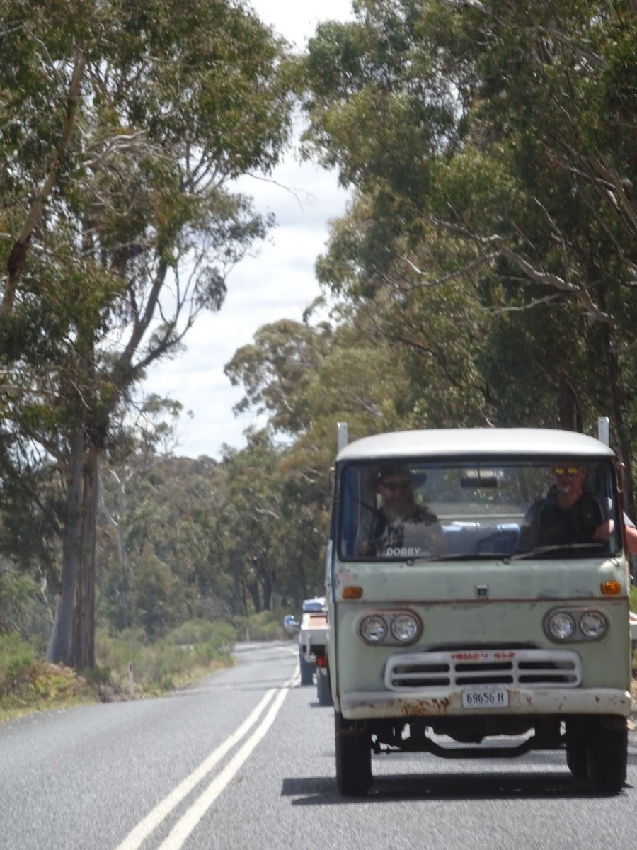

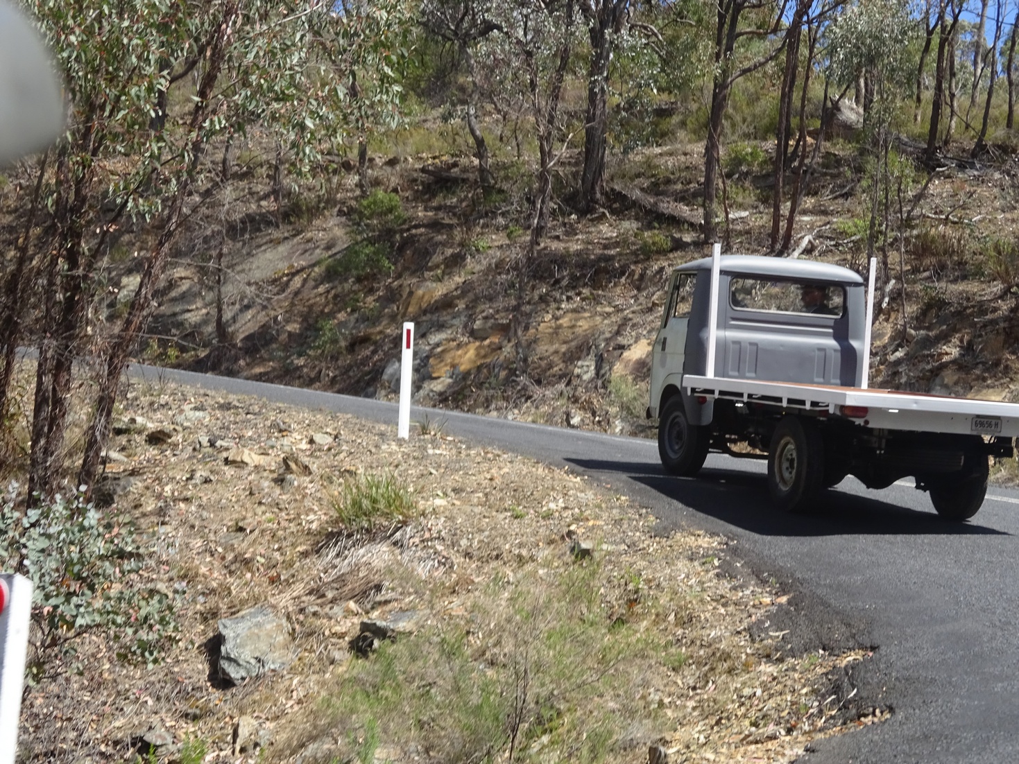

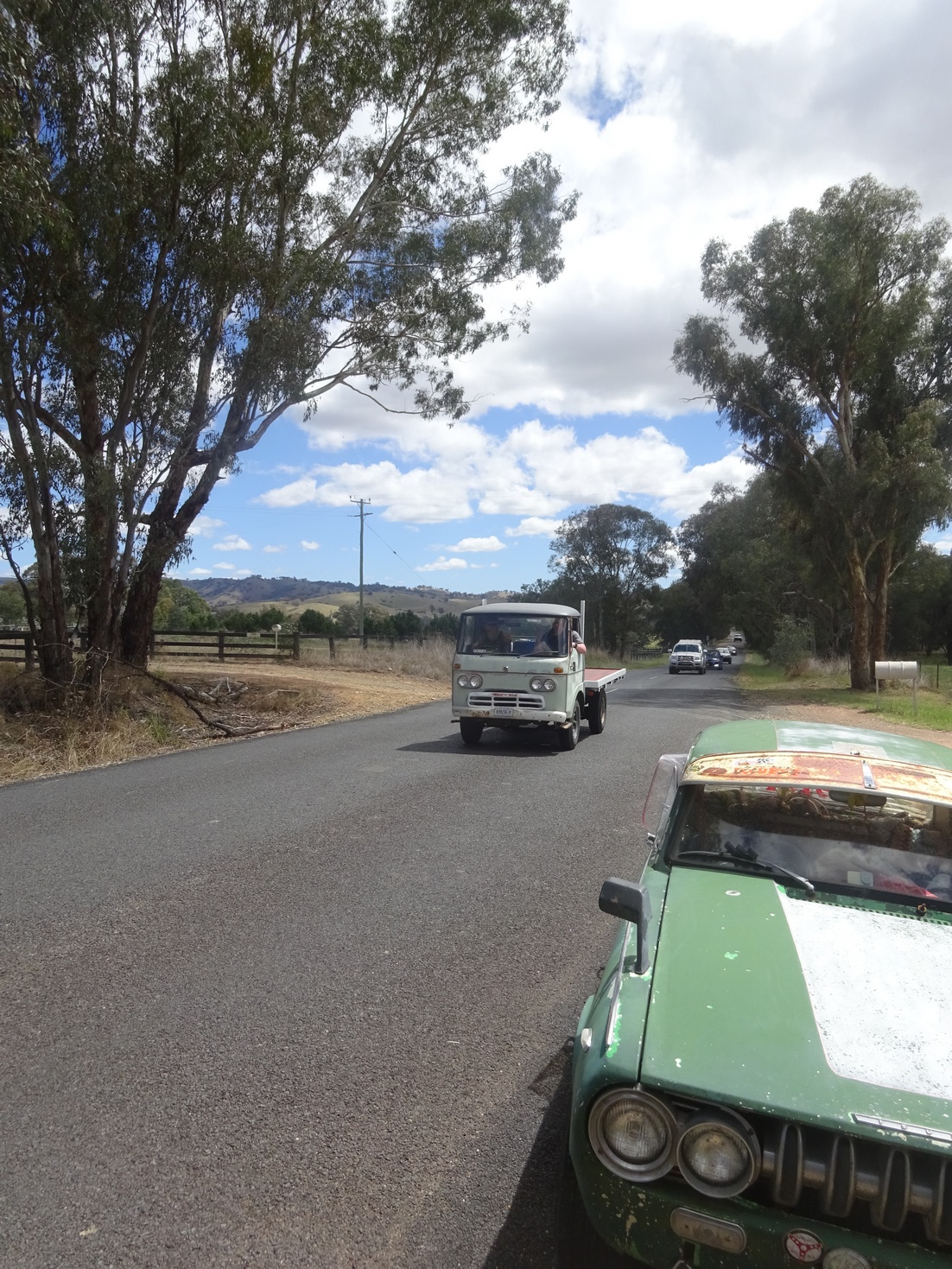

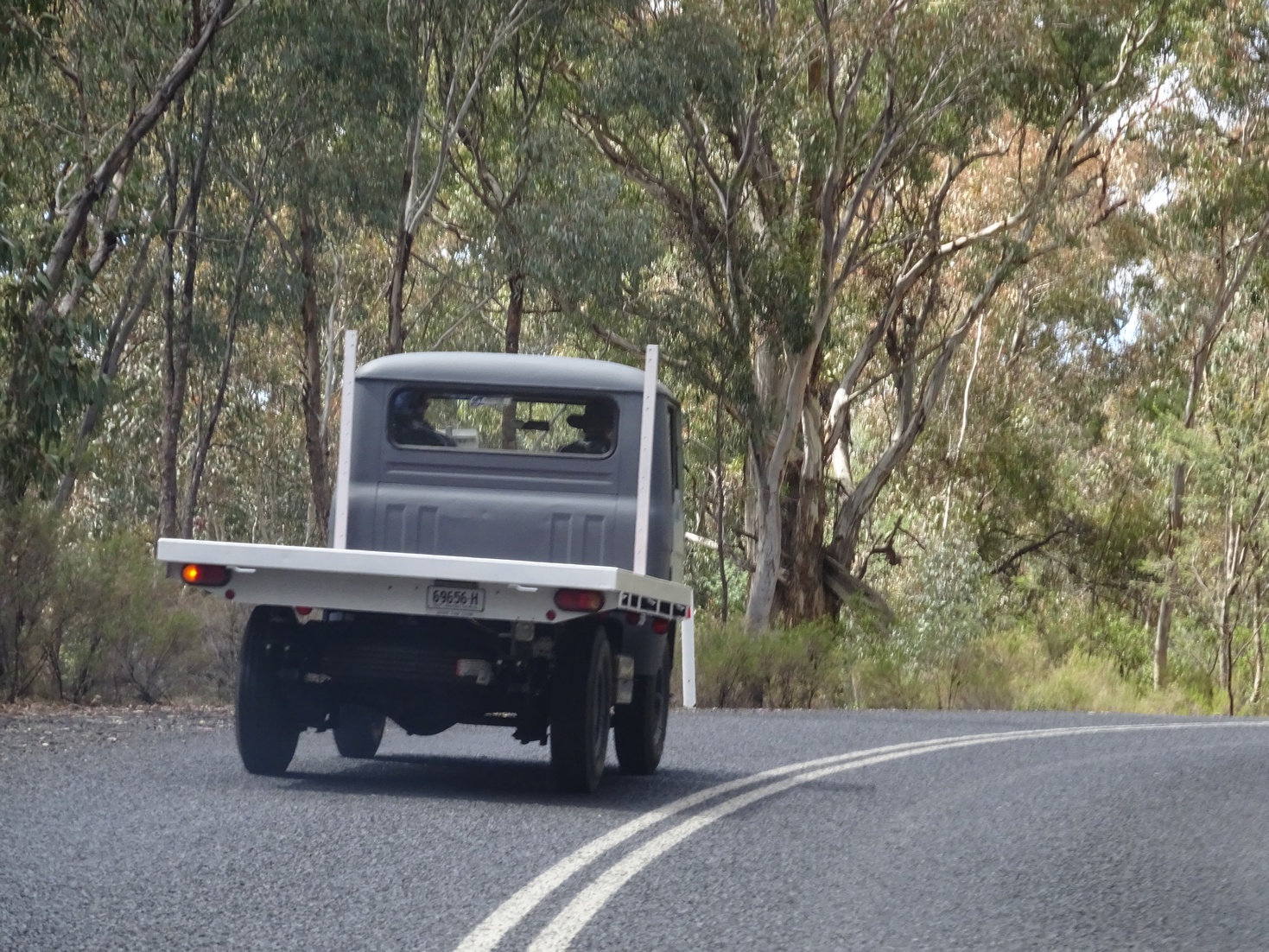

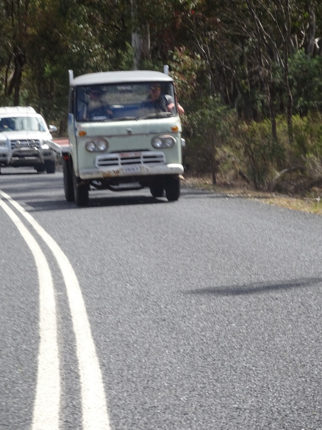

Pictures of Dobby on the road to Hill End
........and HEAPS of 'em :D :D :D

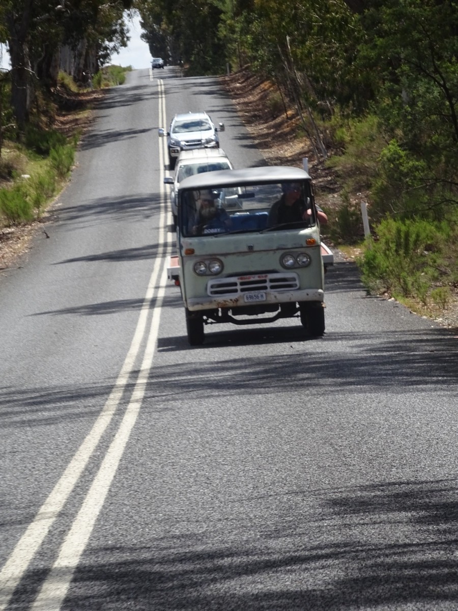

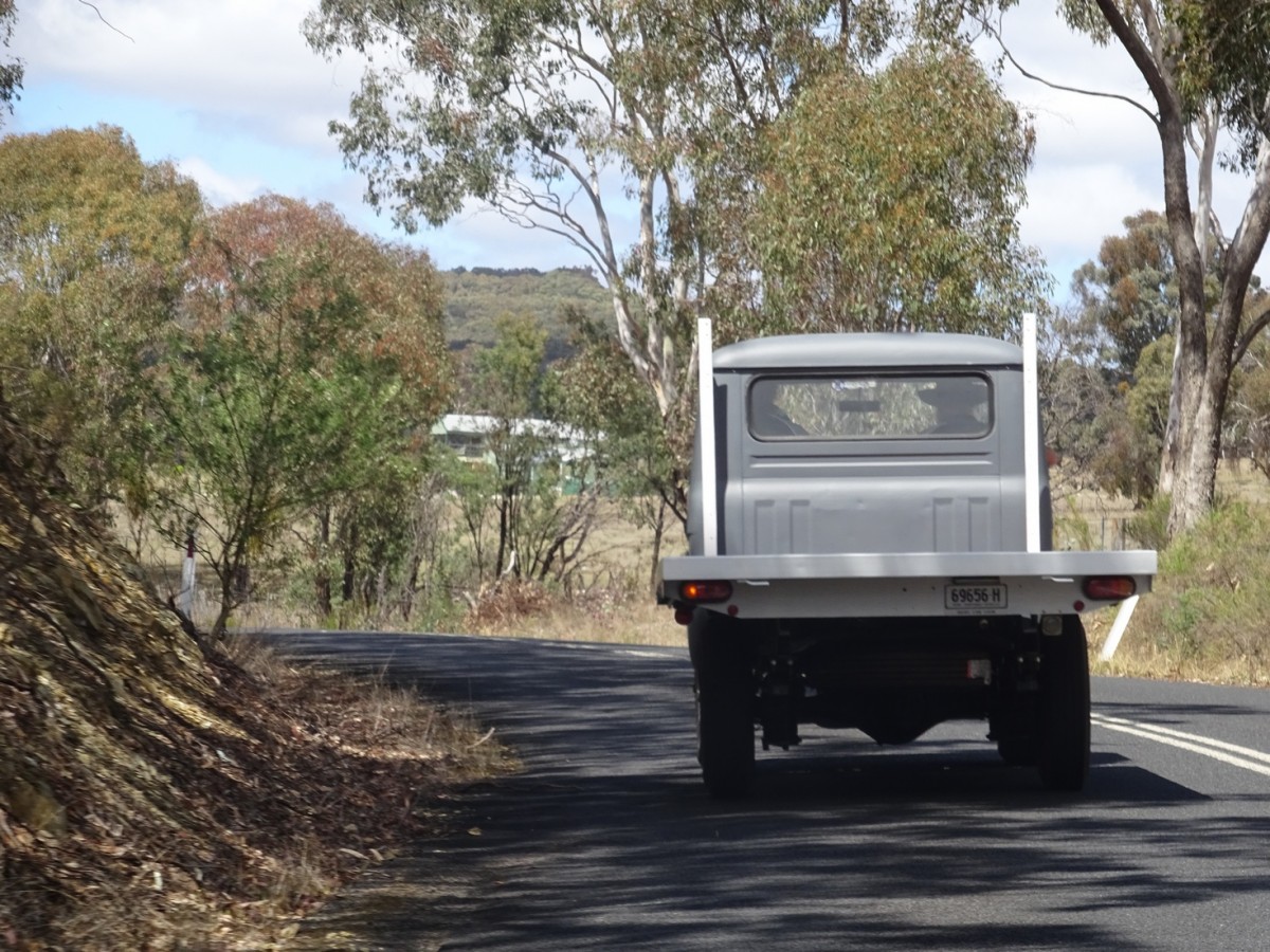

Mon Oct 16, 2017 9:16 pm

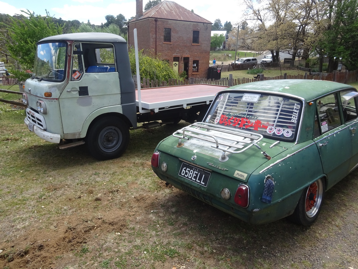

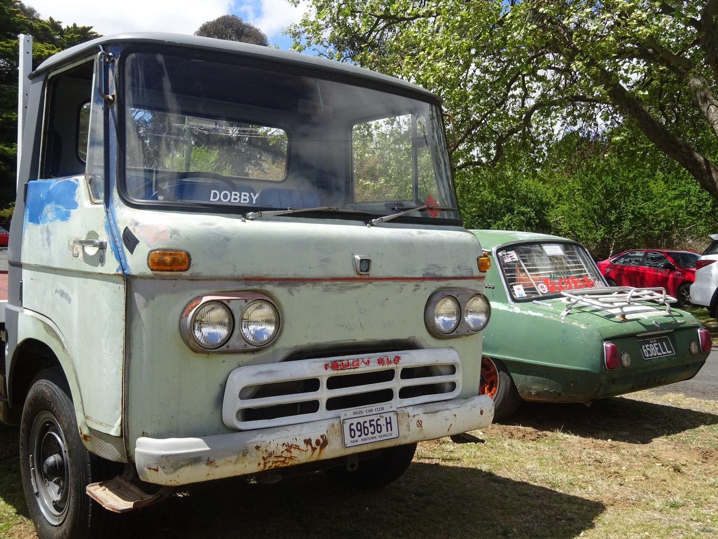

When Dobby pulled into Hill End it was to the applause and cheers of all his adoring fans, none more enthusiastic then Mr Terry Hill

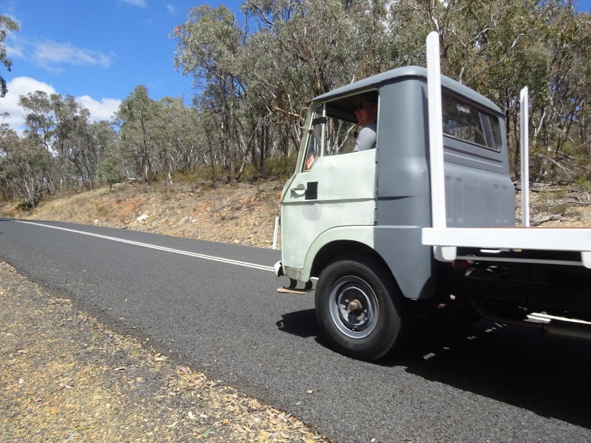

Stickman, that is a lot of pics of Dobby! Thanks for taking and posting them all. I have to say I like looking at him, and driving him. It would be nice though, if everyone else on the road liked driving at 80 km/h, because thats his comfort speed. Over that things get a bit loud and a bit bouncy.
My next tasks with him are to make the exhaust quieter and get some padding in the cab.
Highlights of the weekend include seeing Dennis sit in him, 48 years on from the last time I saw him in his one, and seeing you in there too. You just look right.
Fun weekend!
