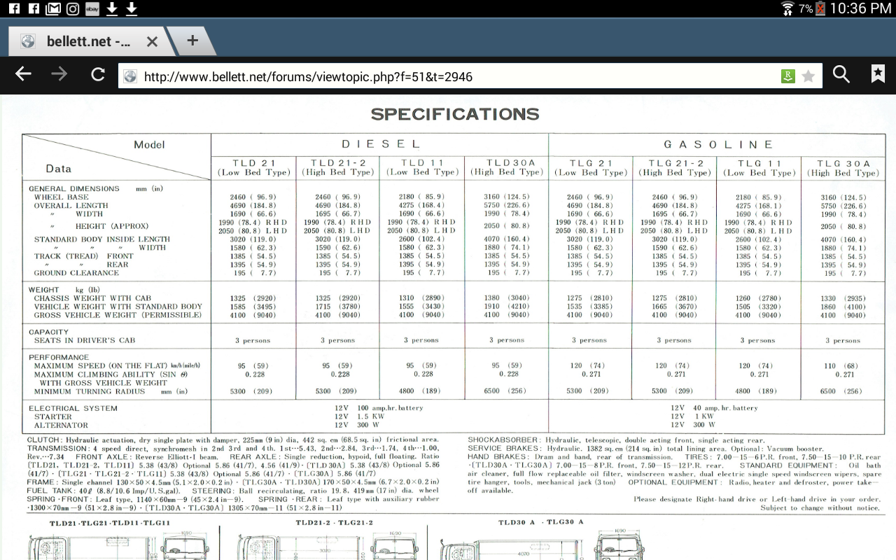

what weight is the Elf rated to carry ?
Hey Glenn.
According to the brochure......
He is legal at 4.1 tonnes gross. The cab & chassis weighs 1330kg, so he can carry 2770kg including the tray. I reckon the tray will be well under 770kg, so a full 2 tonne! More than 2 Belletts!
I will get a weigh ticket once he is done to be sure.

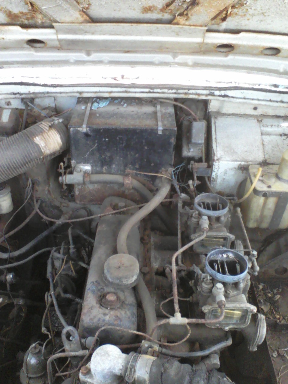

Matt do you want to build a "hotrod " ?
I picked up a motor to put in a Wasp - it didn't fit without many modifications - all too hard .

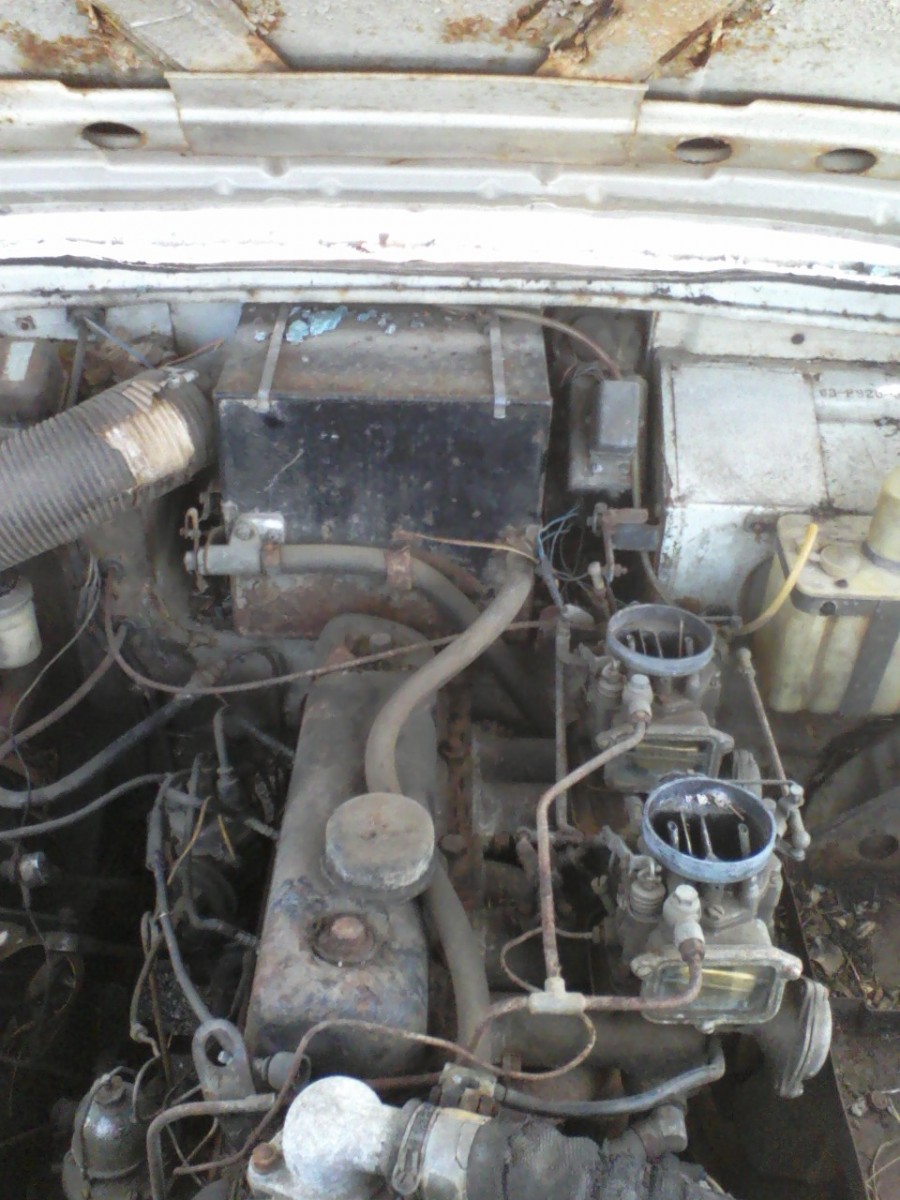

If you are doing up a G201 motor , how about using this one ?
And then I remembered the truck motor has a lowered carby manifold to get it under the seat - maybe it won't fit . - Craig
Mon Aug 14, 2017 6:37 am
Wooo, twin carbs! They look like Chev Luv carbs, with the vacuum secondary. Where did you find this? In a Bellell? Yeah, hot rod!
Yeah, the motor I have does have the lowered manifold, but uses an oil bath air filter with steel induction tube. There is a rubber tube to the carb which has been modified to suit the 2R, thankfully just with gaffa tape. It has some problem, it turns about 350 degrees then stops, and tye same when I turn it backwards. Hopefully just a stuck valve, but it will get to that later, I just want to get him on the road.
Is your motor a runner?
Thanks, Matt.

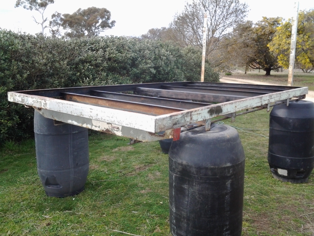

Tray frame now painted.
Yep, its white! Well, safest to see from behind. And it will match the roof.

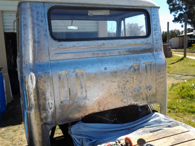

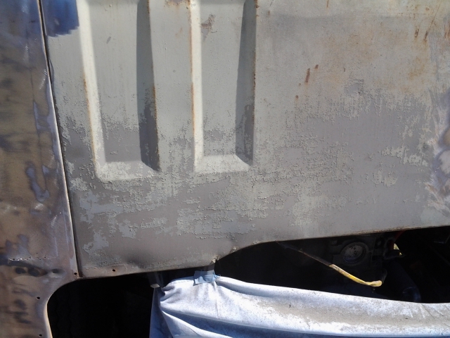

The original grey is pretty ordinary, and the pale green over it is falling off, and the colour test patches don't help, so lets try the strip disc.
Boom!

That's one very tidy looking cab :P
Fri Sep 01, 2017 11:40 pm
Thanks mate, yeah its not too shabby. A few little dents and a couple of rusty spots, but should fix easily. The roof is a bit like the ocean though, I reckon its been hay carting and people walked on the roof! But the rubber hammers came out, and now its a bit closer to the shape it should be.
