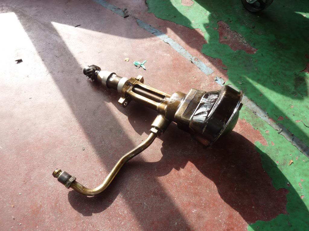

Here is my oil pump I have:

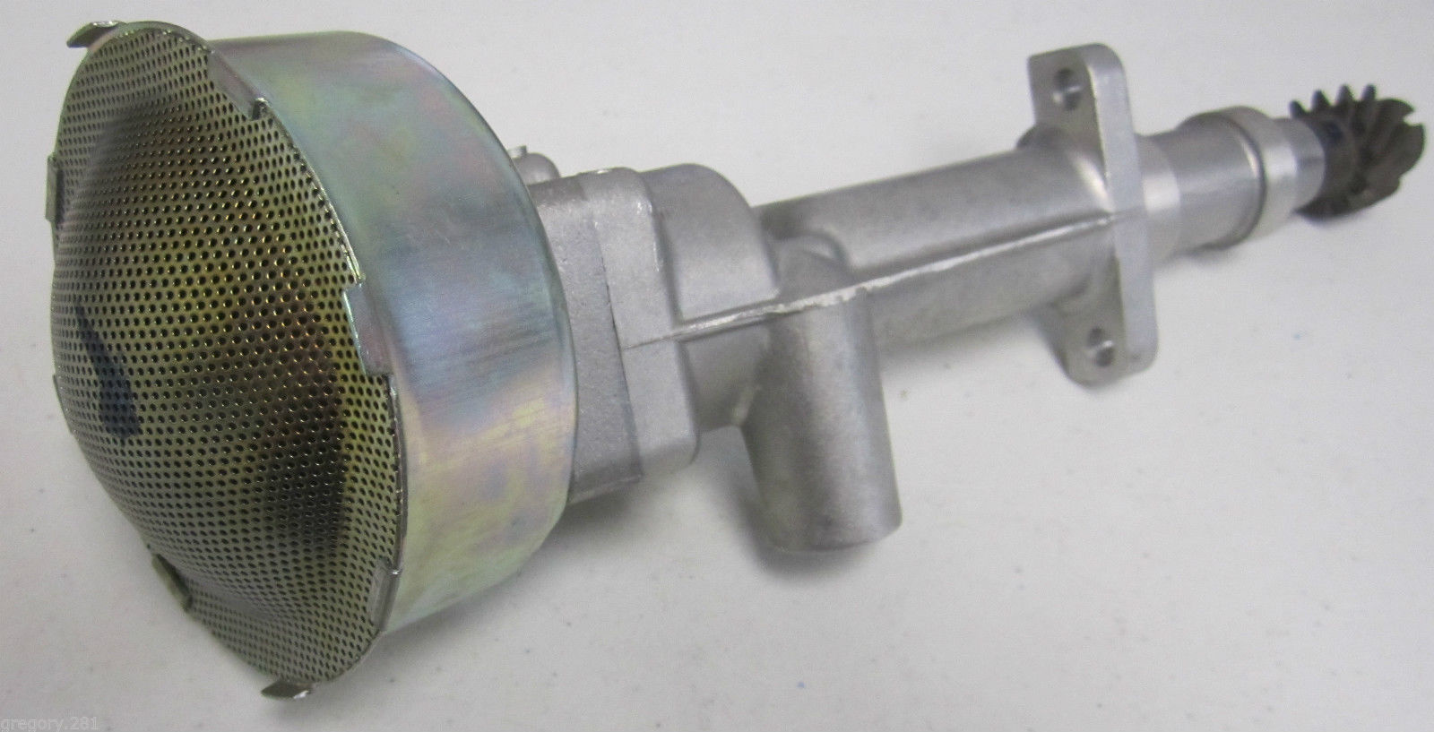

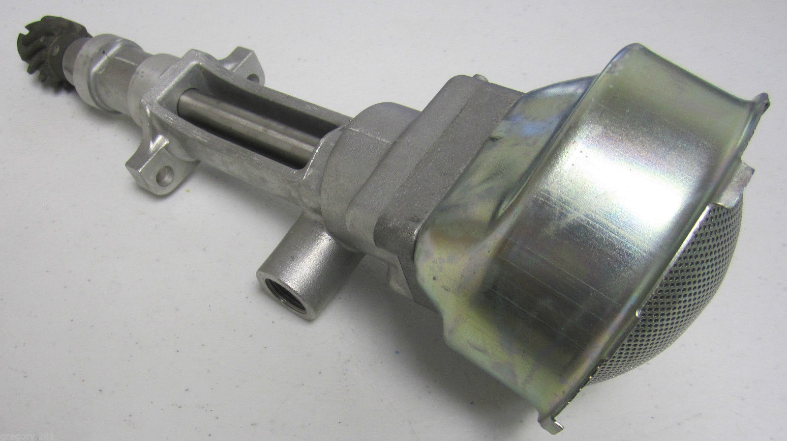

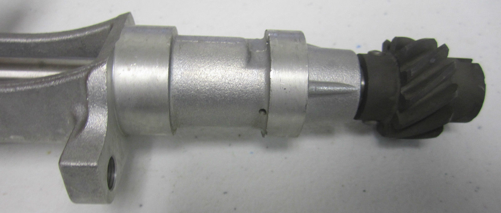

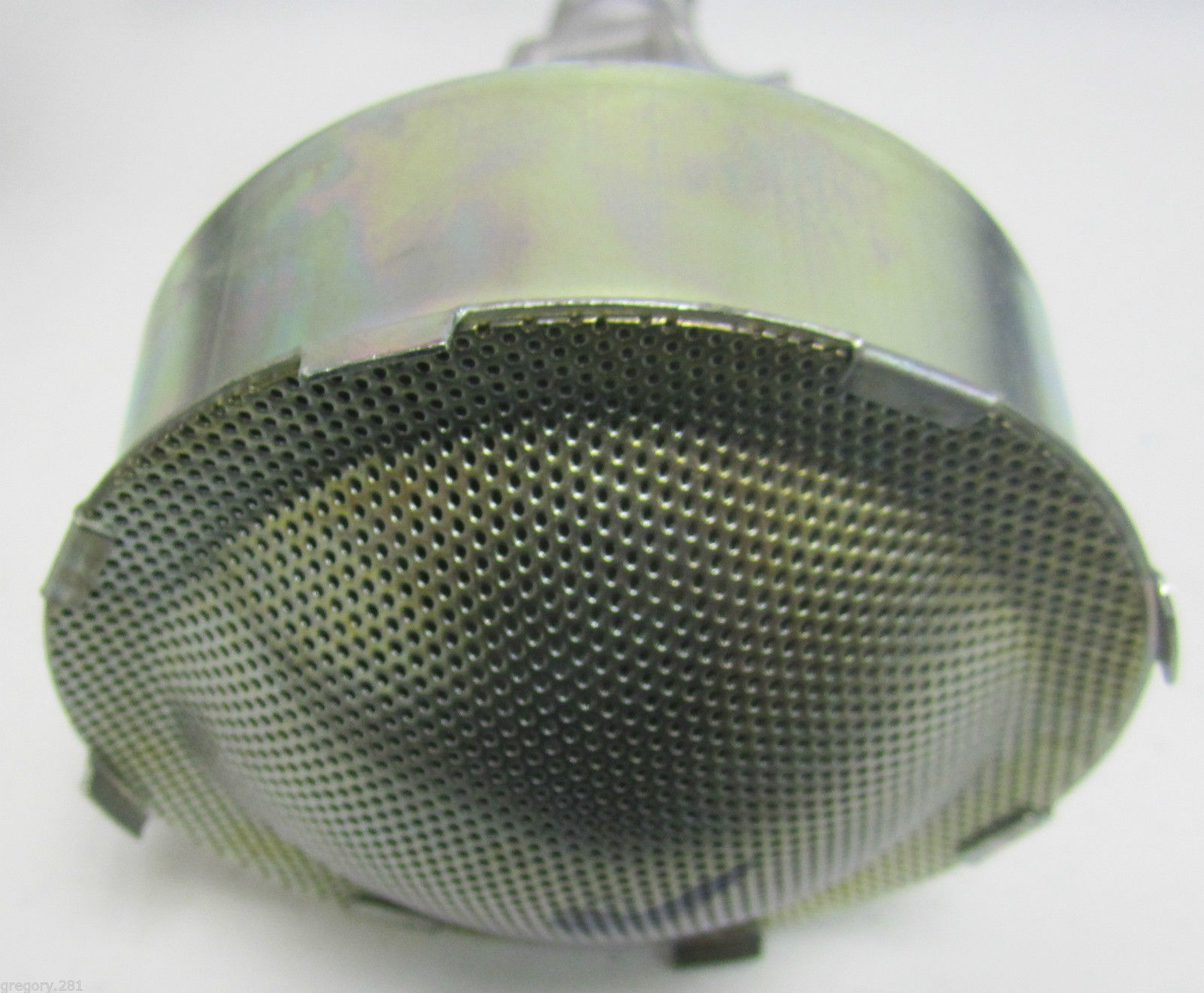

Here are the photos from the Ebay Advert:

eye wise they look identical ..hows the length ??? and how did you go with the other bellett in Darwin cheers davo

Hi Neil.
I've gone through all my books and here is a list of part numbers.
KR10/20. G130. 13100-078. G150. 13100-158.
PR20. G150. up to '66. 13100-158. '67 on (5 brg crank) 13100-203.
PR90. G160. up to '65. 13100-142. '66 13100-163. '67 13100-203.
KB20. G160. 13100-605. (GM. 94021866).
All above numbers are Isuzu except for the KB20 where I have the GM number as well.
When GM came they started using their own numbers.
Chevy. LUV in the USA. using the G180 Series I. 94021252. Series II to IV. 94022618.
As Davo has indicated the length may be a governing factor. I know Isuzu when it went from the
G130 to the G150 the oil pump and oil galleries were changed internally. That G180 pump listed
is for a SOHC the same as Pom Bellett's and my GT convertible. Assuming that Isuzu used the
same for the G161SS and G180S.
Hoping that this info' is of assistance.
