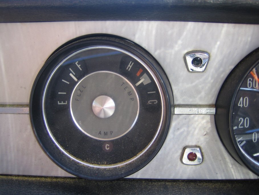

Anyway, this is where my gauge sits now:
The radiator shop dudes reckoned that at the bottom of the white block was about 70-ish degrees, while the top of the white block (right under the hot section) was 90 degrees. With the cleaned system and new thermostat, the needle now sits somewhere in the middle of the block - about 82 degrees which is spot-on for the thermostat, but it's a fair way up the gauge and doesn't leave much lee-way if it IS overheating! I mean, if it's at 90 degrees, that's ok, but once it goes over, there's not much warning coz by then it's right in the HOT zone!

The only thing I can add is that my 1500 engine sits at exactly that spot on the gauge, maybe a little lower but still in the white. On the drive to the nationals last year she would over heat to the bottom of the red block if I sat on much more than 100kph but that was a pretty hot long drive.

BTW, did you take that photo while you were driving?

Dave, I would not be putting a great deal of faith in a 40 year old Temp gauge. You can get some really nice looking after market gauges which discretely hang below the dash and give you an extremely accurate reading before every thing go's wrong.

What you are observing is the problem with putting the temperature sensor for the dash gauge in the radiator, and not the engine itself.
The sensor is in the exit side of the radiator, so it is telling you the temperature of the coolant after it has passed through the cooling fins, and at its lowest temperature before it goes back into the engine. The thermostat is meant to allow the engine temperature to quickly come up to operating temperature, then open up and send the coolant through the radiator to maintain that temperature. A low temp thermostat in summer weather will open all the way and allow full flow through the radiator until the engine is turned off and the engine cools. In cooler weather, or with a higher temp thermostat, the flow will be slightly varied, restricting flow through the radiator to keep the temperature up. Meanwhile, the gauge on the dash only tells you what the temperature is on the cool side of the radiator. The cooling ability of the radiator is going to be relatively steady, so whatever the inlet temperature is, it will cool X number of degrees.
The dangerous part is when the thermostat fails in the shut position, the gauge never shows any increase in water temperature, and the driver finds out after the head is warped when the car comes to a halt at the side of the road.
If you changed to a different temperature thermostat, then it will be opening and closing at a different temperature, and you should see the needle on the dash at a different position.
With a fuel injected car, you could hook up a scan tool and read the temperature sensor in the engine that the computer uses to determine the actual engine temperature. Short of a test gauge and hooking up a test sensor, that's not an option with a carburated car.
It's summer where you are, so it might be worth the time to remove the thermostat, drive the car, observe the needle position, and take notes. Then, maybe try out the original thermostat, and take notes. And compare with the new thermostat.

Yes I was driving. At about 60km/h according to the weird factory-or-aftermarket-metric-cover-that-goes-over-my-imperial-speedo-and-leaves-the-odometer-in-miles!

I don't think the gauge is at fault (factory-fitted position of the sensor aside) and when those guys had a thermometer in the coolant it stayed in the white zone even with when up to 90 degrees (max).

Anywhere in the white is supposed to be ok though mine rarely run above 1/2 way, though I have run at "just touching" the red line for several thousand km (Florian).
The Bellett temp sender sits at the engine water exit. The sender needs to match the gauge - I think there are 3 or more variants (early ones work backwards in newer gauges).

hi dave here i am new but have checked in the68 model i have both books 68 says divisions of th thermometer indicate the cooling water temp between 50degrees to 110degrees celcius or 122to 230 farenheit in normal driving the thermometer pointer indicates within the mid section of the division which corresponds with the temp range between 70 to 85 celcius or 158 to 185 faranheit this all quote page 15 in the early model manual page 20 says about the same adding .......when the indicator is far away from this position ,then check the causes and in the hardbound full workshop manual (lucky arnt i ) itsays the usual things which you know timing ,thermostat,and finally leaks into water jacket hope this helps regards dave
