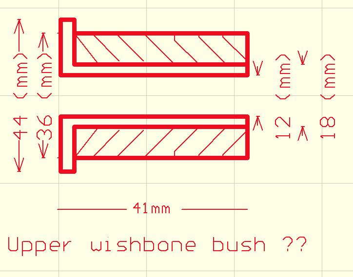

is this how your measurements come out (upper only)
[angle lines are the bush material itself]
later edit: changed picture

Mon Dec 21, 2015 9:38 pm
Your top and bottom red lines don't exist along the length of the bush, just across one end, but otherwise looks good.
Mon Dec 21, 2015 10:26 pm
yes, i realised that after posting the drawing
are there 2 per pivot?
Tue Dec 22, 2015 12:14 am
Ok revised drawing looks good. Two bushes per arm.
