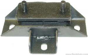

Chevy Luvs start with 1972, maybe later than the KB design.
This is only allowing one image attachment per post.
This is the Luv transmission mount.
File comment: LUV Transmission Mount

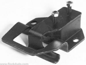

And the Luv motor mount.

Those engine mounts posted by JT are the ones I used on the Wasp.
Looking at them now, they are slightly different to a Bellett one, but nothing a small trim and a new mounting hole can't fix.
In that pic, the "loop" of steel and the "tab" under it aren't on a Bellett mount, so they could be removed. Also, from memory, the holes in the Luv mount were too wide for a Bellett. The hole at the foreground of the pic will line up, but the other hole doesn't, requiring a new hole to be drilled and the extra steel on the plate to be removed as well.
The gearbox mount looks very, very Bellett. The only difference I can see is that a Bellett doesn't have the extra "tab" that is on that mount in the foreground of that pic. Again, a quick removal is in order.
Dave, as for the 5 speed question... They actually mount the same. My Wasp has a DOHC 5 speed and uses a Bellett box mount on the Wasp chassis, and my race sedan has a Gemini 5 speed and uses a Bellett mount as well. Mr Isuzu kindly made the later box's so that a Bellett mount would bolt straight to a DOHC/Gemini box, even though the DOHC/Gemini mount looks totally different to the Bellett one.
