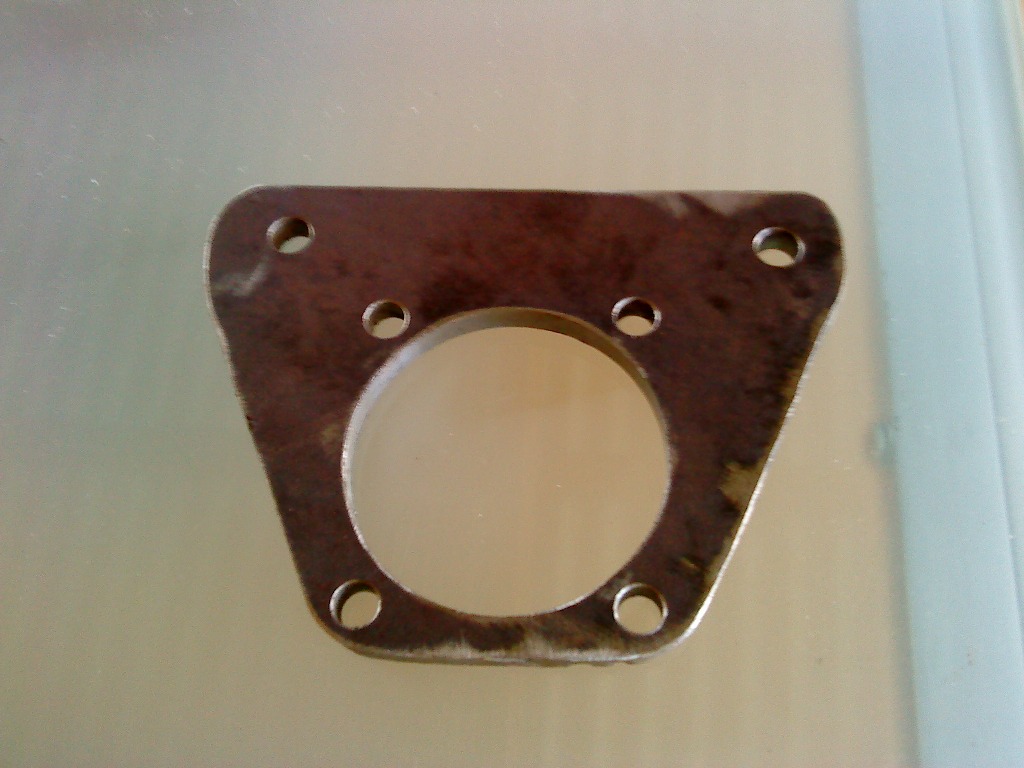

I picked up the brackets and discs on Monday. Got home and realised i forgot to tell them that the caliper holes should be 12mm. Well I now have 3 stuffed (were new) 12mm drill bits. The brackets are not made of mild steel, so back to the shop to get the holes reamed out. The steel is some alloy that is used on hard wear surfaces and earth moving bucket edges. All is fitting up well. But my calipers do not resemble the ones that are in the piccies that I put up. they are alloy. I just hope the 14" wheels fit. Or it might be of to the local shopping centre carpark for some wheels LOL

I have not got the brackets back from machine shop. I forgot to ask for the caliper holes to be 12mm. I stuffed 3 new 12mm bits trying to ream them out. Then I found out the engineer had used a steel called Bisalloy, it is used in highwear areas such as scraper blades and rock buckets. So I am now waiting on the call to pick them up, so I can workout where the machining has to be done.

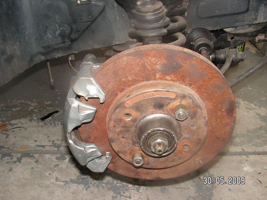

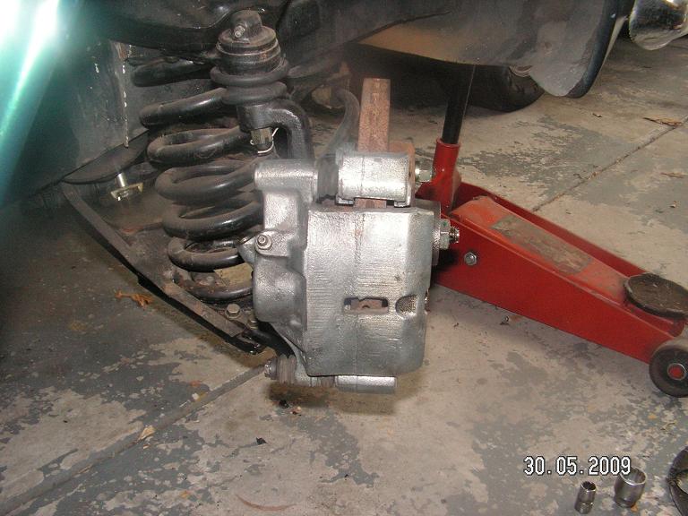

The sage so far. 2weeks to get 4 holes reamed ou to 12mm. Now back to get some machining.
Piccies below of the dry fit. Have to get 1.5 mm machined off the caliper mounting area. This is mainly to get the caliper more central, but also to give some clearance to the wheel as the caliper does just touch the rim.

Yes I will need them. Quite possibly Commodore but i will have to wait and see once the clearances are worked out. Also longer brake hoses. The brackets are back at the machine shop getting milled down to 9mm Because they supplied me with Bisalloy instead of mild steel. They cannot be washed down to size. The steel used is extremely strong about 6 times stronger than mild steel of the same thickness.

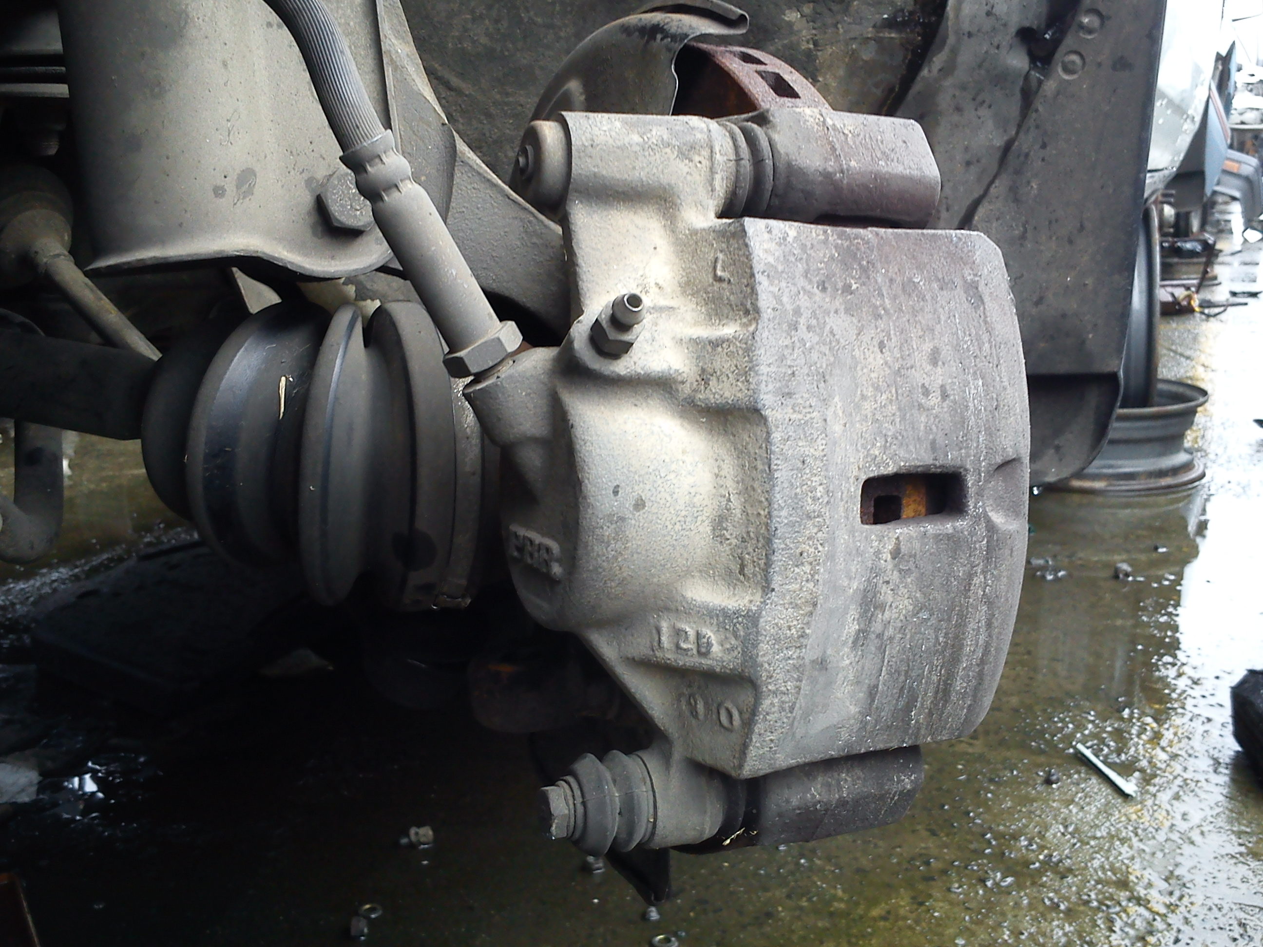

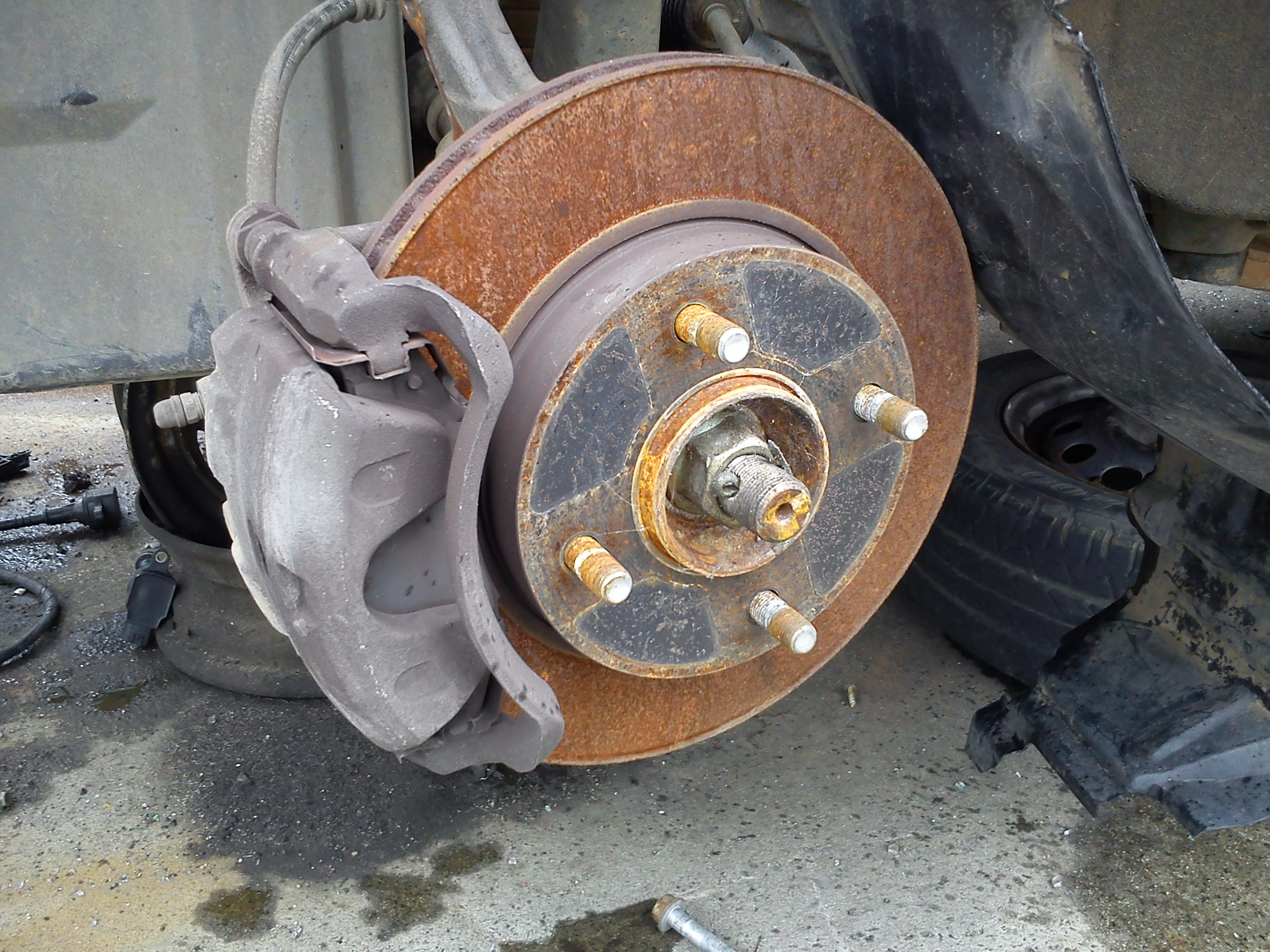

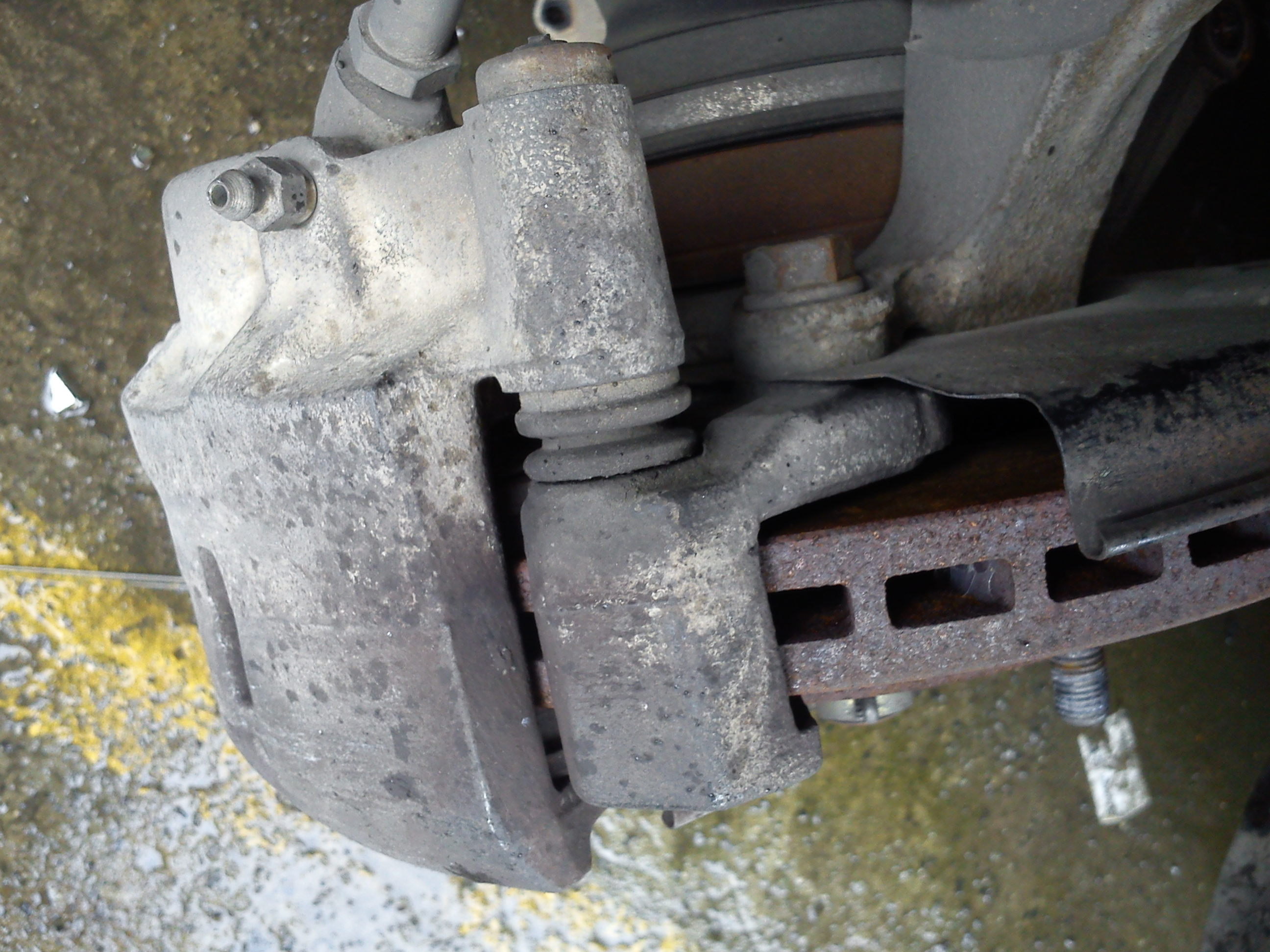

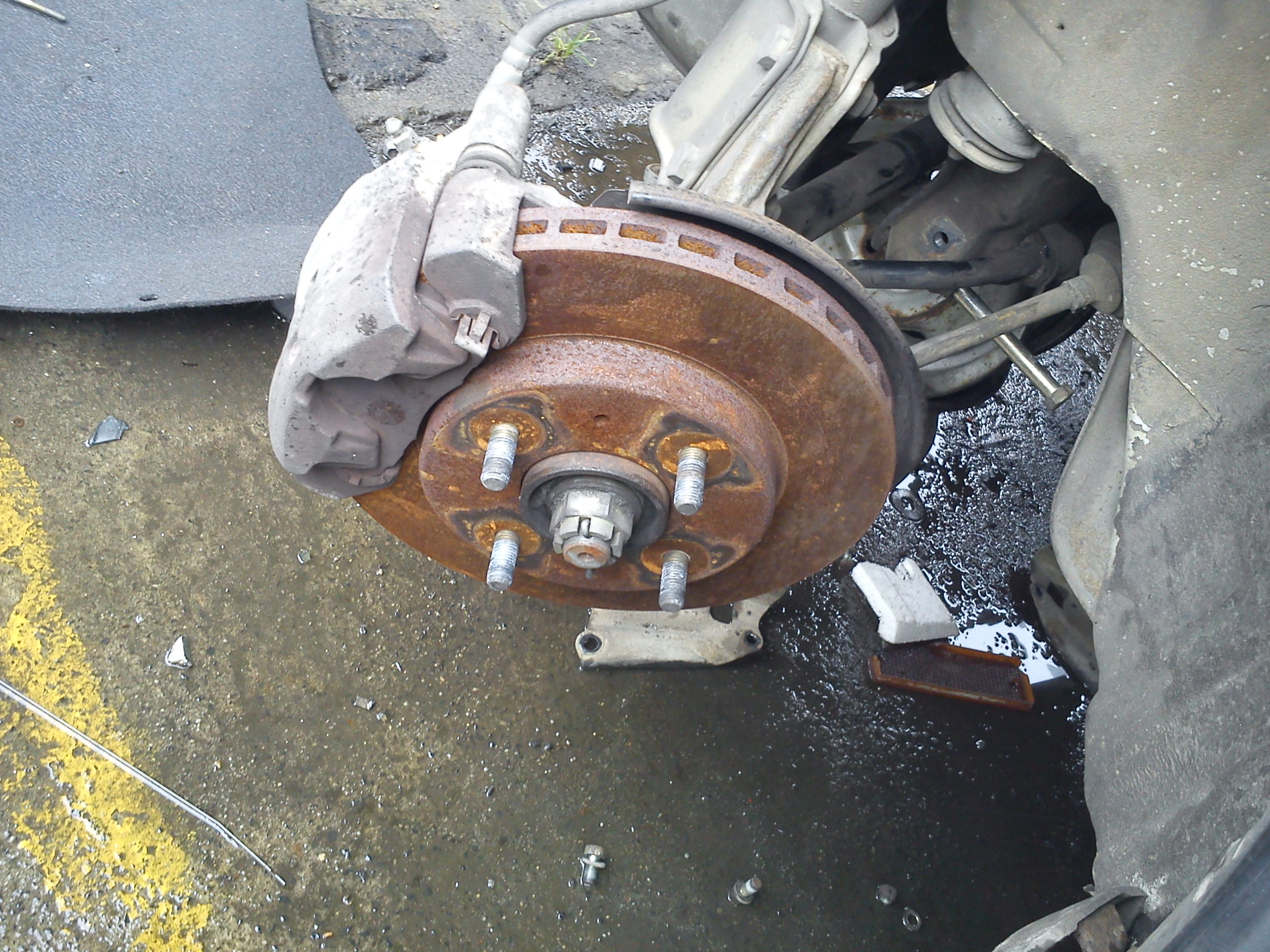

Gents, been reading this thread while back and went past a wreckers today so decided to see what TP magna disks etc look like. The calipers seem to be different to that shown. Hard to tell, but maybe larger ?
File comment: marked as PBR
File comment: rego sticker for model ID
