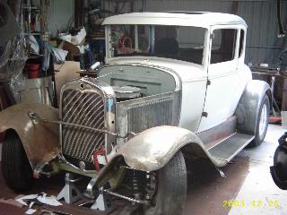

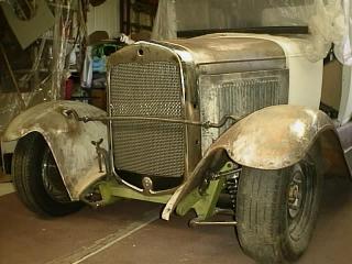

OK HERE IT IS. I STARTED WITH A BODY ONLY AS YOU SEE. NO REAR PANELS, BOOTLID ETC.. NO FLOOR Typical for these cars, rust all round the bottom 100mm has to be replaced with metal. Bullet holes etc......... Remember, these cars had a wooden inner structure with a lot of the body nailed to it ! All replaced with steel tube now.. That big hole sin the roof use to be a material nailed to wood also. Now filled with steel and ssunroof from an early Nissan Micra. Just to keep the thread "Bellett"  In the background is a white GT I was putting the Turbo Piazza motor into.
