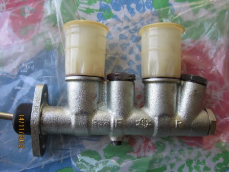

Bellett Sweden wrote:
You can a tleast go and buy one, so it's not here, we must find the master cylinders that do not exist...
Most of us here get them re-sleeved in stainless steel. Its not super cheap but should last 'forever'. Mine is below, looks like new now.
Most of the other internal parts can be found locally.
Merry Christmas
