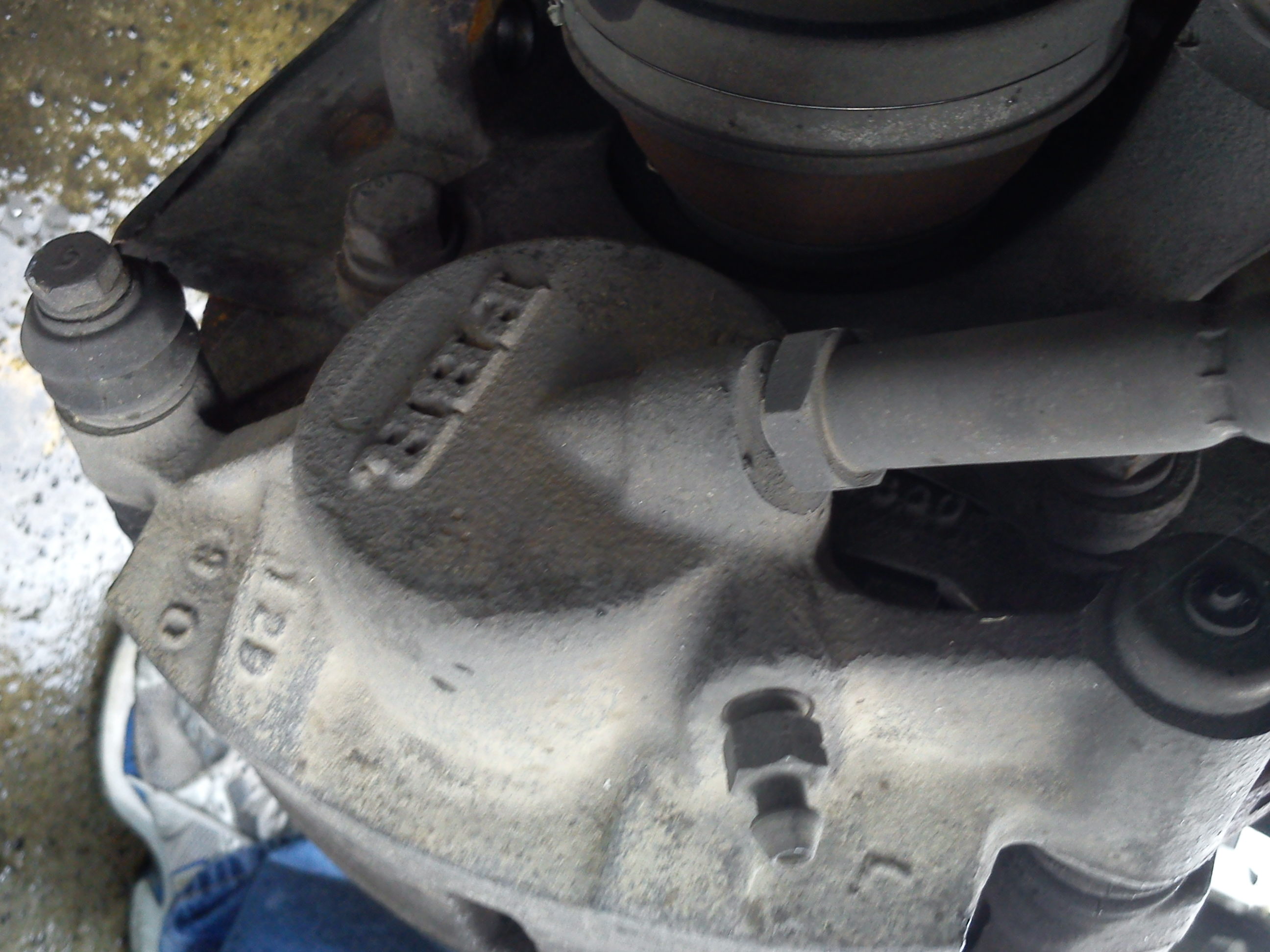

Didn't have a tape measure with my but all the rotors appeared about same thickness so the calipers might 'work' with Magna rotor.
All pics are just what i saw, NOT tried or measured !
File comment: Hyundai

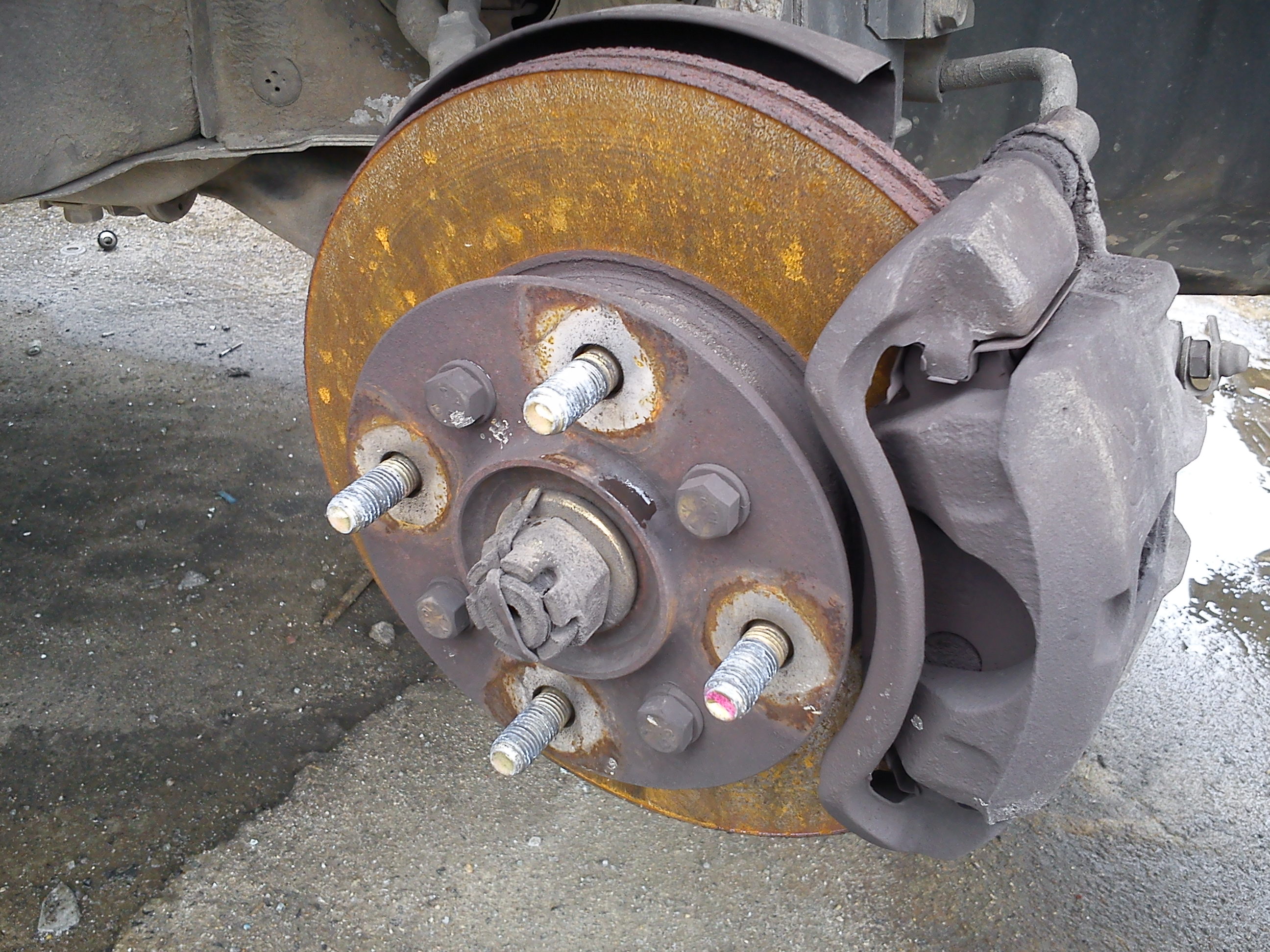

rotor does not slip over the hub.
Not much time to do anything more, it was raining also.
File comment: Rotor does NOT slip over hub

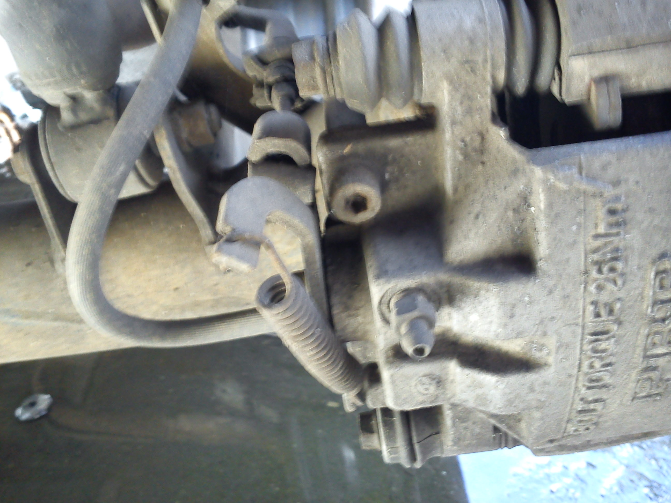

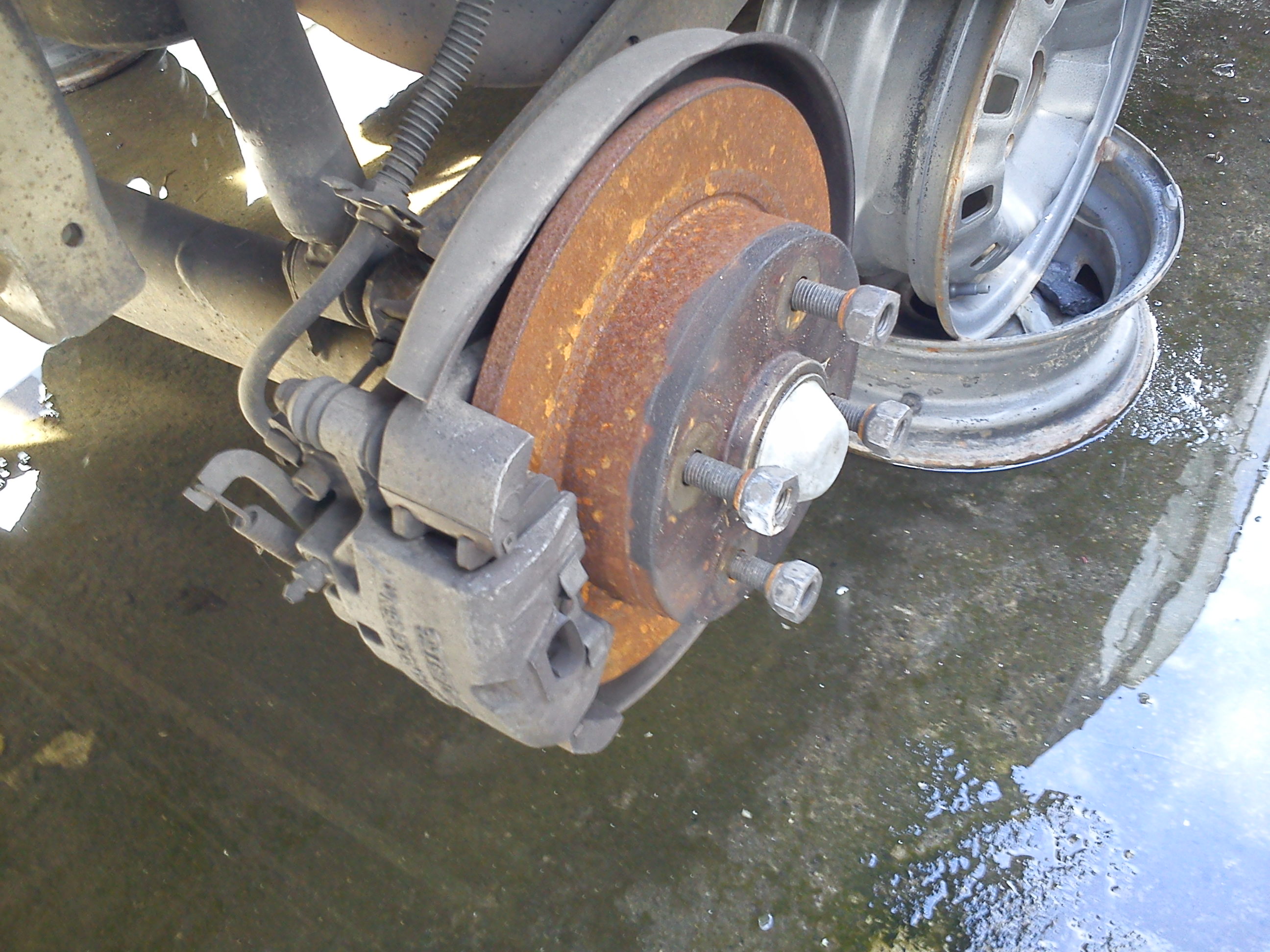

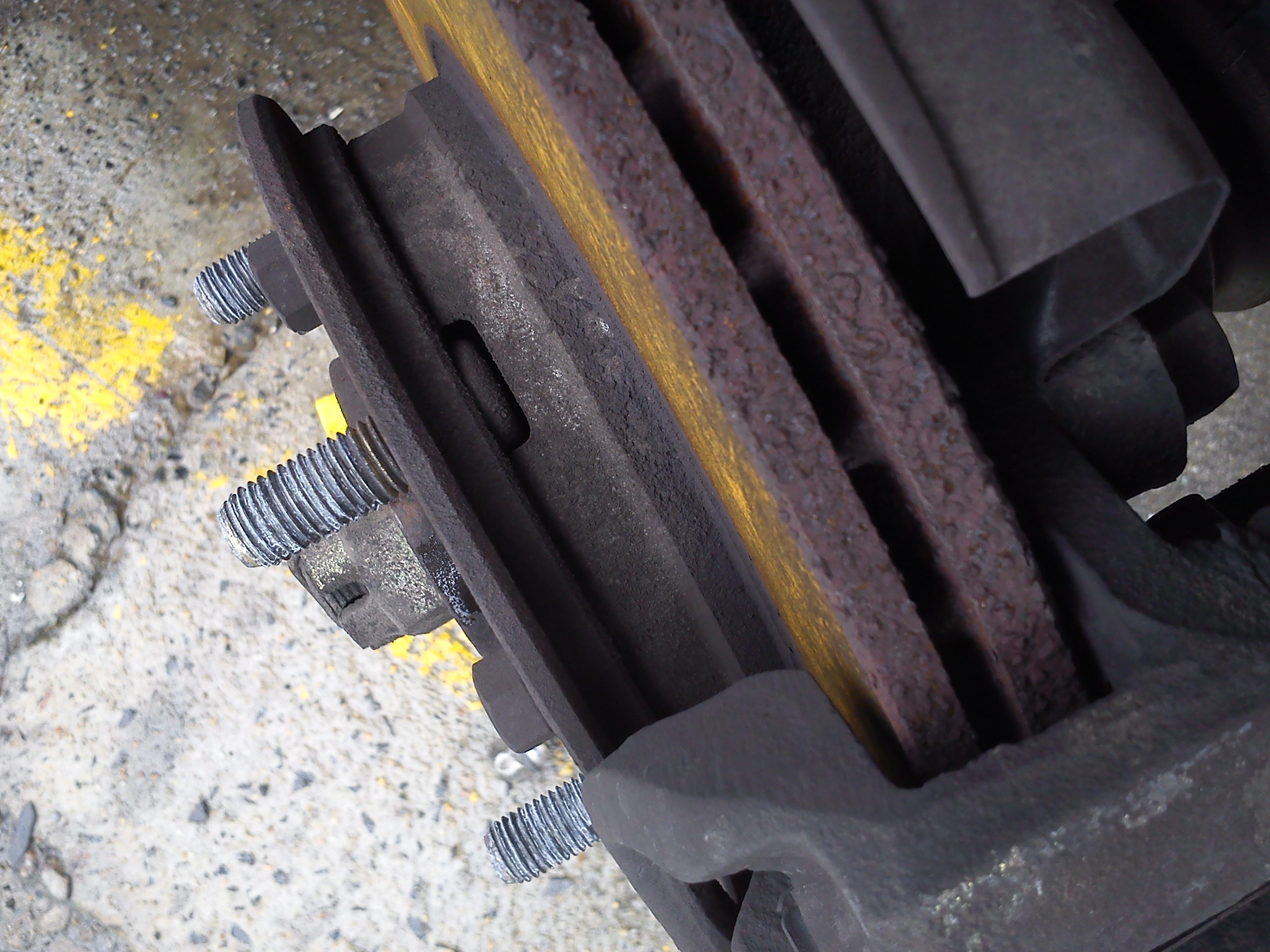

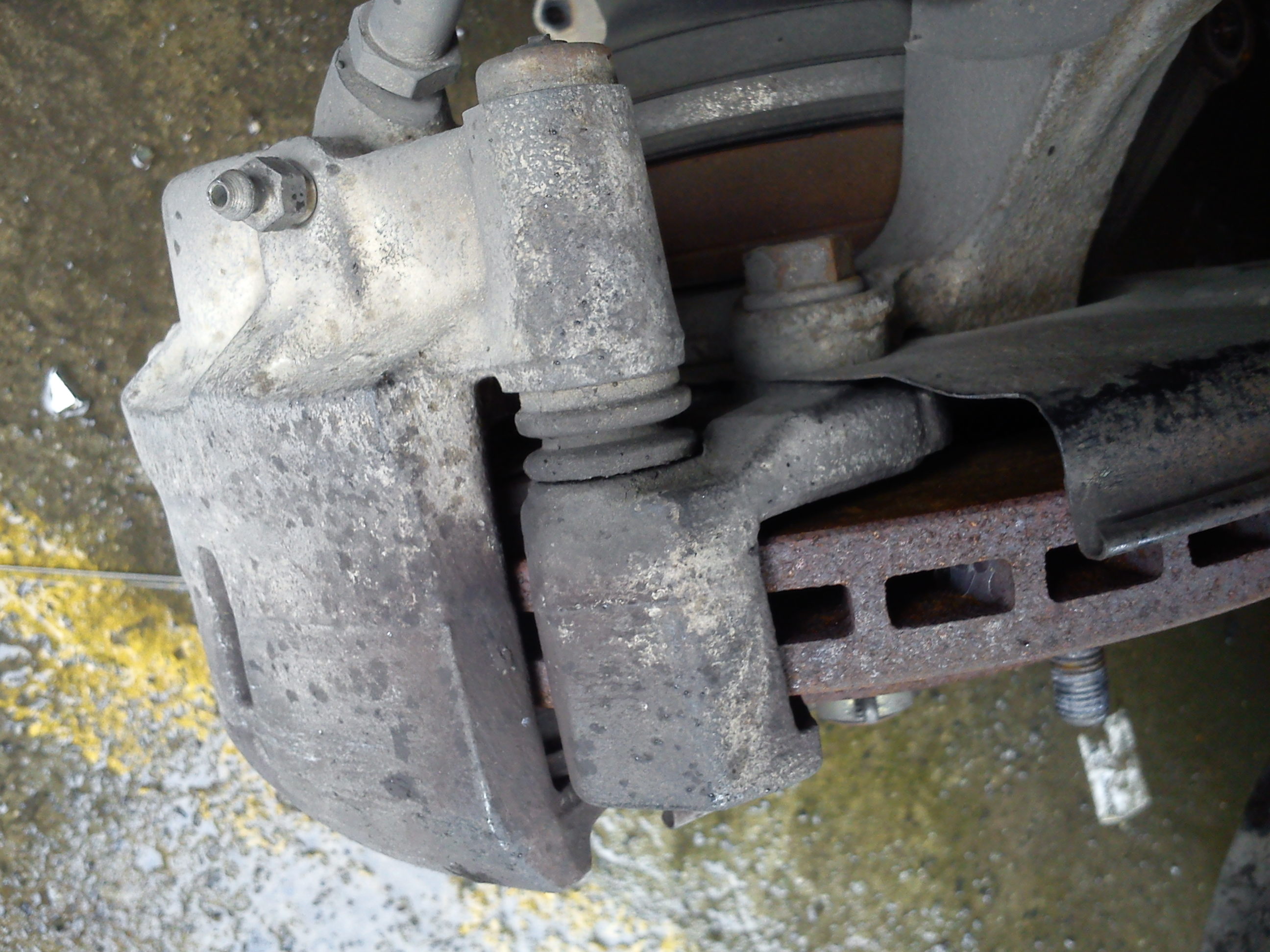

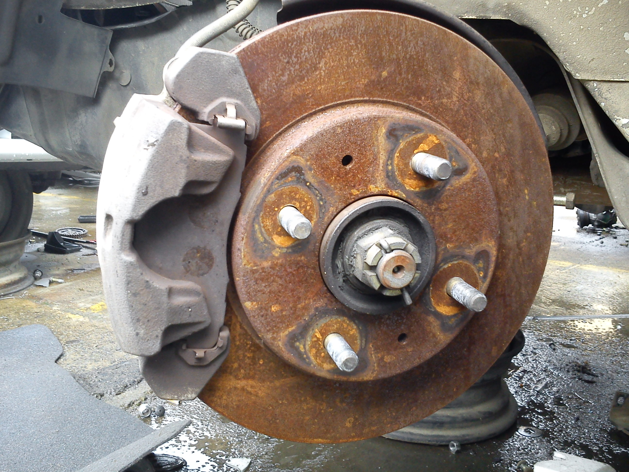

Here are some pictures I took last saturday (sad isn't it) of the Magna brakes and note they have rear disks also. (may vary) It might help you to ID something over there perhaps. The "PBR" brand is local by the way.
From memory, the front rotor is 22mm thick. Rear is 10mm.
I would tend to use the same caliper setup if i was to do this also. Whatever caliper you use, you need to make sure that it does not project forward too far. The project on these pages using the turbo engine has Ford rotors which have a much higher hat section than the Magna.
I would prefer to put front and rears on to get a matching "set". Note the rear handbrake cable exits for and aft. Some creative thinking would be needed to adapt to the standard Bellett H/B cable.

rear of TP Magna

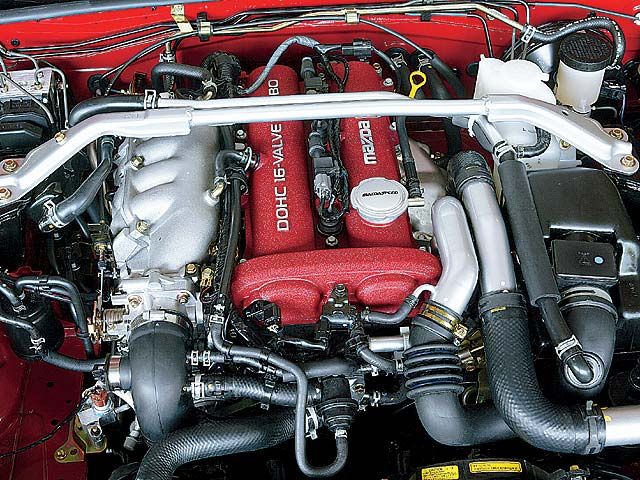

Is it Possible ? Or at least look like it.
