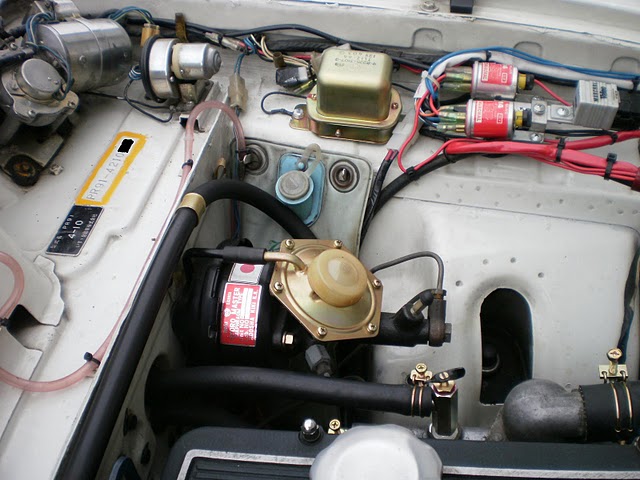

OK, that's going to be what this is. (picture below).
Is it set up with only the front brakes receiving power? It has separate reservoirs for front and rear, and piping. That would require two boosters, right?

all GT-R's had them, as did SOHC GT's, and alot of other jap cars from the day, so they are common enough and not a true guide of whether a car is a genuine GT-R or not tho.
i have one here to put in the "GT-R'd" orange sedan that looks exactly the same, but it's from a mazda 1500SS.
they only work on the front brakes.
the rears are plumbed direct from the master cylinder, and also have a proportioning valve under the back seat to prevent rear brake lock-ups.
the 35 page GT-R brochure i have here, printed in october 1969, shows an exploded view off all this in detail.
