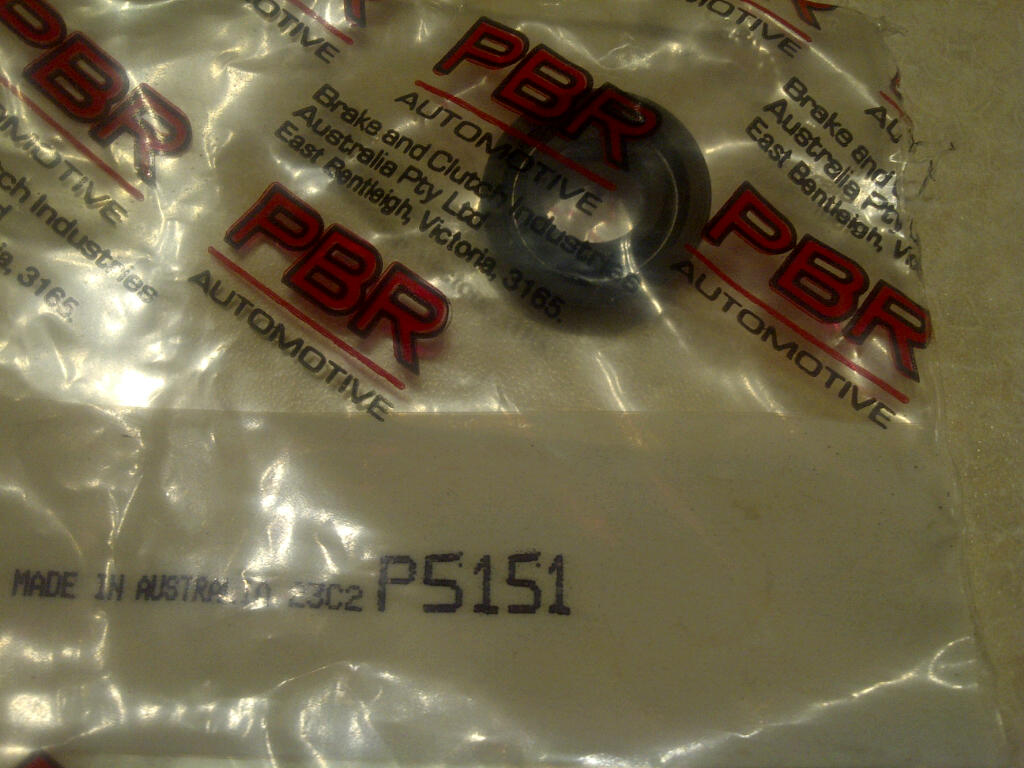

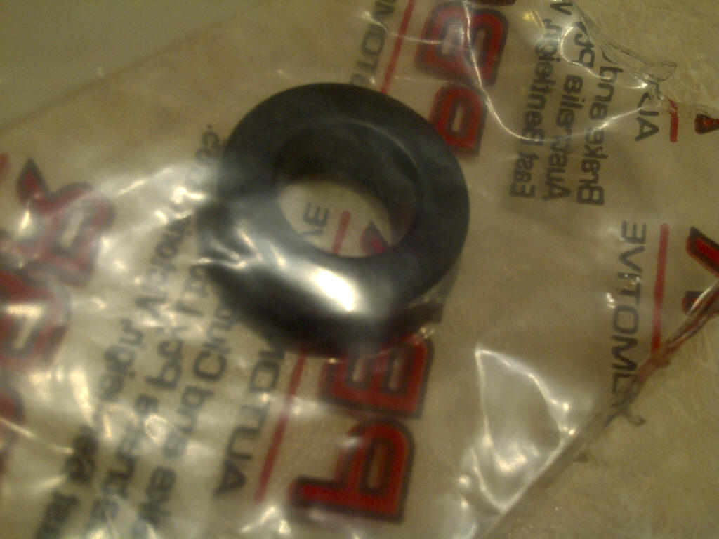

Front seal P6121
Rear seal P5151
Cyclinder Kit Master K7308X
below is pic of rear seal

Also googled pbr trying to find part number p5151 but nothing seems to come up - dont understand why as i can see p5151 printed on the packet of the photo that oz toffa posted.

update on part numbers. PBR have changed some things.
P6121 Front Seal $5.00 each
P8348 Rear Seal $4.20 each
cheaper than when i last bought some??
on shelves and seems like plenty of stock.
one set on the way to Jeff as soon as i have his address. Probably send in a CD case.
