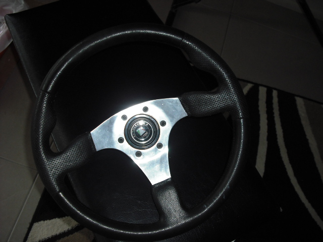

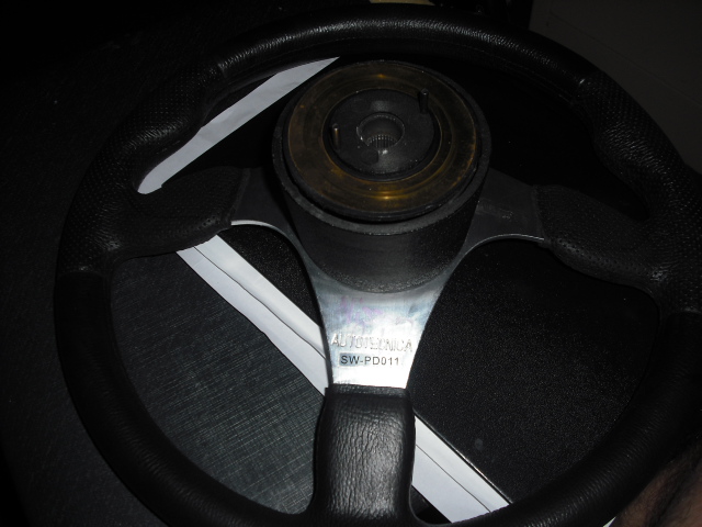

PICKED UP THIS WHEEL CAN GET THE SAME IN WOODGRAIN ...TROUBLE IS THE SPLINE THIS MODEL IS SW-PD011 WHAT OTHER LATER MODEL CARS WOULD HAVE A BELLET SPLINE .....???? WHATS THAT ...NONE... AH WELL $20 LOST WILL LOOK GOOD ON THE GARAGE WALL CHEERS DAVO

early RX7 also I think Mazda 323.

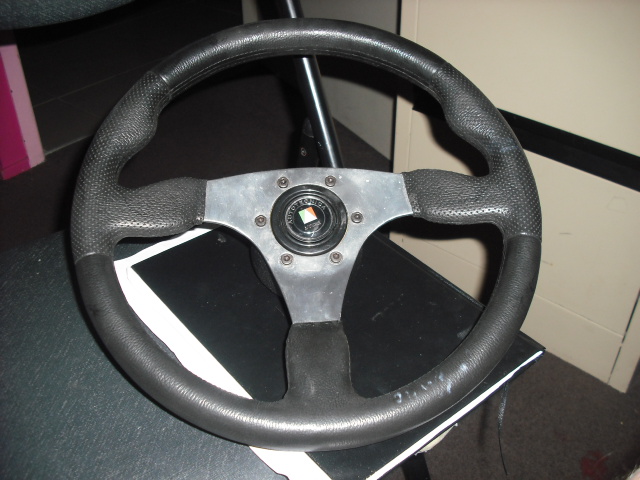

sorry the pics cheers davo

Looks like a standard six bolt boss bolted to the wheel.
Someone in Australia was selling the HKB bosses for the Gemini several years ago. It is the same from Bellett through Trooper.
It looks like they are almost all the same, solid aluminum, 12 threaded holes for the two different six bolt patterns, ribbed plastic cover, made in China, a fraction of a degree off the factory wheel when bolted on so the rod ends need a small adjustment.

JT the boss kit is rx7 until around 68 then it is gemini spline. rx7 series 1,2,3 are the same spline it's the depth that changes. Davo's car is mid sixties teardrop so it will be rx7 unless the shaft has been changed which i doubt as it had a early gt wheel in it.
JT the bellett of yours is later model with strip tail lights so gemini should fit.

its an Australian wheel its down under ......its upside down to show the coding of the wheel ....cheers davo ...and thanks greg for your imfo

all the early Mazda stuff is the same as each other. RX2 3 4 5 and early 7. 121 323 929 were the piston engined versions so they're use same too. Bellett's pre strip tailight model used this spline.
Strip tailight and later used Gemini spline. Column shaft is 1.5mm smaller in diameter than earlier Bellett's. TX to TG Gem's were all the same spline too
