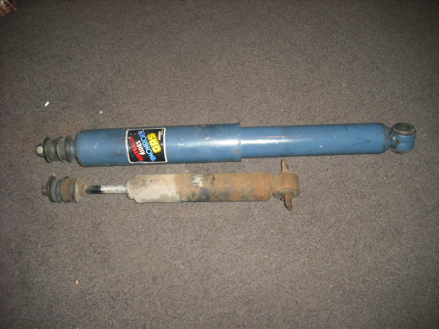

hi guys I bought some Monroe gas shocks to fit to my 90 ????? got me beat look at the size doesn't look right to me they are supposedly ht/hk shocks ....love to hear your comments ..davo the small shocks are not pulled out ...help me please cheers davo
| Tue Sep 23, 2014 12:03 am |
BULLITT
pics .....
GTtoo
Joined: Sun Feb 01, 2009 2:51 am Posts: 1034
Davo !! The ones you have bought just don't look right. And if you could fit them you'de have the first PR90 HIGH RIDER ever  The bought ones also look second hand. I bought newies on special at a super cheap auto place, i think i was lucky at $60 a pair. Just take your old ones in and they will match them. They were Monroe and they were gold and looked very similar to the old ones, that's all i can remember. Oh, and they are just a little fatter than originals so you need to file out a few mm out of the lower front wishbone hole to fit them through. I think there is a thresd on here about Bellett replacement shocks also. B.

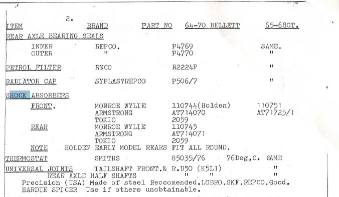

GTtoo wrote: Davo !! The ones you have bought just don't look right. And if you could fit them you'de have the first PR90 HIGH RIDER ever  The bought ones also look second hand. I bought newies on special at a super cheap auto place, i think i was lucky at $60 a pair. Just take your old ones in and they will match them. They were Monroe and they were gold and looked very similar to the old ones, that's all i can remember. Oh, and they are just a little fatter than originals so you need to file out a few mm out of the lower front wishbone hole to fit them through. I think there is a thresd on here about Bellett replacement shocks also. B. and....... Repco have 20% off i think this October, so might be worth waiting. Those definitely look wrong [very fat and too long] and very s/h. Also missing the bottom mount 'bar' below is part of BCCV interchange list........ see also the threads on here for part numbers.

I got kyb brand last time they fitted without any modification. I will look later and see if I can give more info? cant remember which car they are in.

I used Pedders 8001 'comfort gas' in Stock for $186 pr. in the front of the Sport.

Hey Davo they are rears and you need fronts for HR on.

Depending on how much u lower it will govern what ones u fit..... HK T G Holden ones are fine if it's at or near standard height. Lower it like mine and u need shorter HQ ones, or u'll punch the bottoms out of the longer HK's. What Geoff said is rite too. U need Holden FRONTS all round, and is best to get "sports" ones for the front and "standard" ones for the rear so it handles..... Well as best as it can without suspension work.
