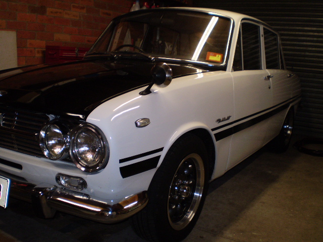

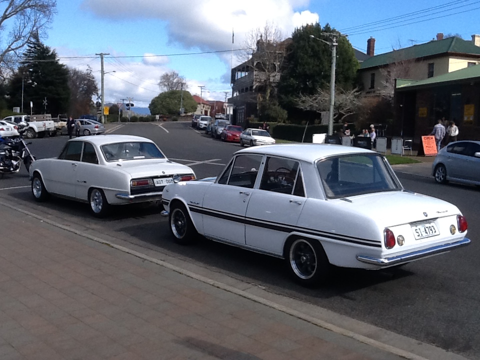

My Bella run Performance Superlites 14 x 6 x 114.3 with offset 18mm (Aussie made)
Same as on Rod's GT in photo
Fits real well with 185x60x14
James

My Bella runs 14 x 6 with offset of 18mm but Superlites can come with 24mm offset as well
My advice is run more +ve offset rather than less and adjust with spacer.
The more offset you run the more the weel rim is in towards the inner guard
The less offset the more it will want to come out of the guard or in case of the rears, sit on the tyre = not good
Hope this helps
James
