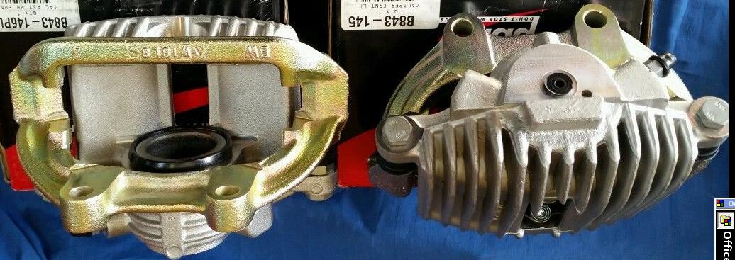

New caliper looks Commodore.
GT rotors and hubs are clear drilled. They use bolts and nuts.

VL turbo and early V8 models had an alloy finned caliper but that's not it. I have a set here on my hotrod.
They have much deeper fins on top.....
what's interesting is that the earlier Commodores used a 22mm thick disk, the TP Magna uses 24mm.
