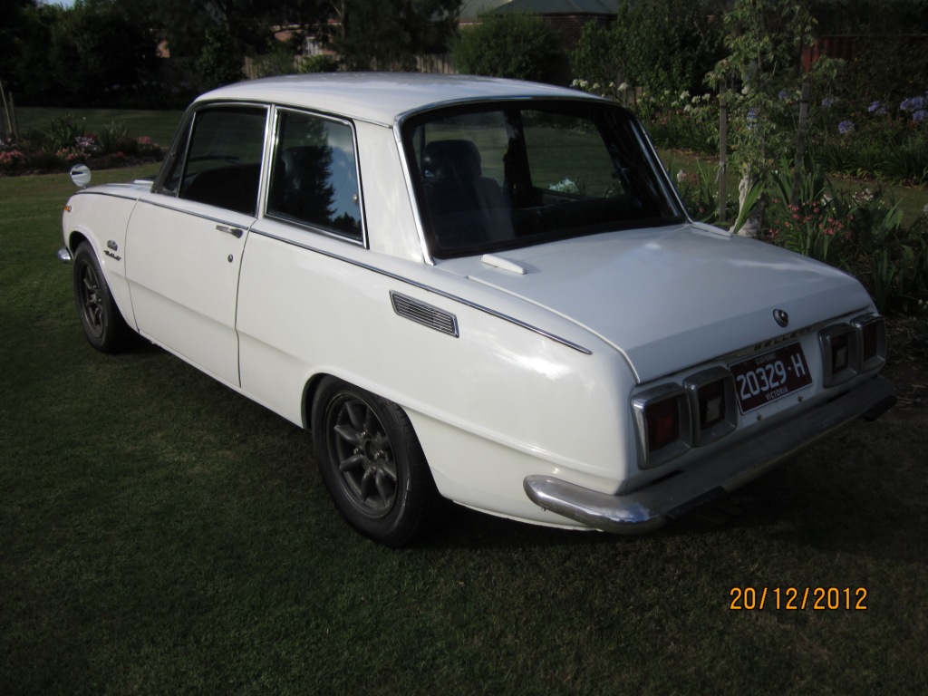

Hi, I am not an expert here but it might help also to tell us what size are the alloy wheels you have fitted. Width and offset especially.
Have you tried rolling the car forward after fitting the wheels? It's common for the wheels to sit like that after you have jacked up the car. The rear should drop down after rolling the car.
It does appear you have very wide wheels though and a lot of positive offset. My own car (below) for example has 5" wide alloy rims. I think you can fit upto a 6" wide wheel if the offset is correct.
But somebody more expert than I will no doubt reply soon with details to help you.
By the way, the front of a Bellett usually sits higher, from the factory. Most owners here fit a lower spring.
