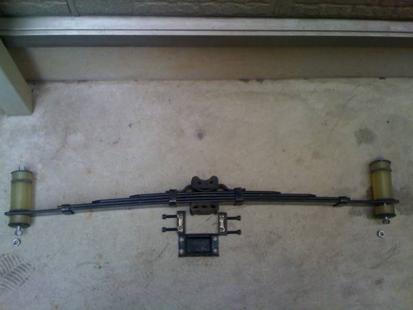

Camber compensator, performance leaf spring auction on Yahoo
Posts: 543
http://page9.auctions.yahoo.co.jp/jp/auction/k121409244
It seems to say this is a Stage 3 rear spring.
The English language shop manual calls this a "leaf spring".
Triumph owners call it a camber compensator.
I think I remember some kind of aftermarket shackle assembly for early VW Beetle suspension.
For those unfamiliar: On swing axle cars, the rear end can lift in cornering and allow the rear suspension to droop. It's called Jacking or Crabbing in different circles.
The spring puts some upward force on the rear suspension arms and prevents them from drooping when the tail gets light.
Belletts came with one of these leaf springs as original equipment to prevent this from happening.
Triumph went back and added one of these springs to their design.
I have seen larger versions of this leaf spring described as performance upgrades. This auction adds a little more detail, they were apparently sold in different grades to match the need of the user. I have also seen some descriptions of adding or removing spacers from the end links to change the action of the spring on the arms.
We have a big leaf spring company in town, and I had planned on looking into making one of these things in a larger size just to see what it would do. This one looks like it has four leafs. The originals that I have seen have a single leaf.
Does anyone know any spring rates for either the originals or the performance versions?
File comment: Performance upgrade camber compensator.

We use a second leaf out of a parts car stiffens them up.
Sun Mar 07, 2010 3:00 am
we make our own from units out of other cars too.
race car has 2 and a half under it.
Sun Mar 07, 2010 3:11 am
Posts: 205
Car(s): 66 GTPR90
Doesn't every one have a works stage three 4 leaf under their car, used to be available x Japan $106.00 landed

Currently negotiating, researching getting several different versions made.
Sun Mar 07, 2010 5:07 am
Has anyone tried to find replacement rubber/nolethane bushes that fit?? or can be adapted.
Sun Mar 07, 2010 10:36 am
the centre rubber bushes no off the shelf nolathane that i can find yet, still working on matching up the outer round rubbers in nolathane style bushes.

Mine runs with a single leaf 9mm thick. It was developed by Arthur and a suspension crowd in northen subs of Melbourne. I can't think of the names. (help Brett) But coils are also stock height and around 420lbs rating. And adjustable Konis.
Peter
Thu Mar 11, 2010 10:01 am
Thanks Peter, we were going to try a 6mm and an 8mm leaf with just about zero arch.

mine runs a 4 leaf spring but im not sure on what the rates are...all i know is that its super low!
