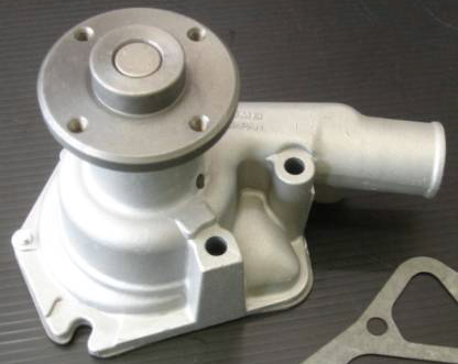

Hi again, is this the one for a PR91?

Have found a source for new water pumps.
Stanmore Auto Spares
03-389 4555
245 Stanmore Rd Christchurch
I believe he has access to 8 as of 22 May 2009.
I found him through Trademe and paid NZ$83 incl shipping from Christchurch to Bay of Islands NZ.
I'm expecting to receive my pump in the next week.
Will post to confirm.
Hope this helps.

Water pump arrived today. It's a new pump made by GMB in Japan www.gmb.jp . Part number GWIS-13a stamped with number 7y05.
Really pleased I could get a new one and will get it fitted this weekend.
