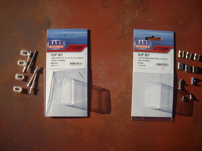

Hi all.
Gary Carter is having trouble with side strip clips letting go, so today he tracked down some replacement clips from Rare Spares. We tried them and they are spot on.
2 sizes, one for each style.

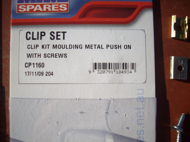

These are for '64 to '66 (early) sedans - Teardrop.

Both are Holden fitment, so common as in Aus. (Overseas, ask and I'll mail you some)

hi matt what a great find no more superglue or bluetack thanks to gary regards dave in qld
Tue Sep 07, 2010 10:08 pm
Brilliant find, and well done.

To update this thread, I made some enquiries today regarding these clips. They are no longer being produced as a set so whatever is on shelves is the last.
However they may be purchased individually for what works out as roughly the same price. I just ordered 34 clip+rivets at a total cost of $68. This will do the whole car (1967 sedan)

I used some of those plastic ones on my 1966 sedan but had to trim the little wings off!
Only noticed that after I'd already put one on... it was hard to trim off without trimming off the paint, let me tell you.
Then the strips still moved fore and aft, so I stuck a blob of gunk (can't remember what; may have been silicone) on each one just to stop them moving around.
Pretty sure they were the same clips, but!
Wed May 29, 2013 1:44 am
DONT PANIC MR MANNERING STILL AVAIL.... BMC 1001 IS $8.10 PACKET OF 4 AND THE CP1160 WHICH IS NOW MB0006 IS $10.65 PACKET ...ALL GOOD CAN HAVE THEM IN A WEEK CHEERS DAVO
